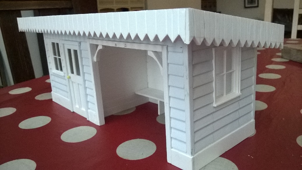

My wife's away this weekend, so the kitchen table's covered in tools, materials and half-finished models, and the air stinks of glue - it's a glimpse of the chaos I'd live in if I wasn't married. The upside of all this chaos is that I'm getting some modelling done - starting with Tom's building.
Yesterday evening I added some more details and the moulded cladding, and this morning I made a few tweaks to the roof, oh, and added a door knob - we're getting there:

Re: Tom's station building
Post by philipy » Sat Jan 19, 2019 10:11 am
Looking better and better, Andrew.
How have you done the shiplap cladding?
Posts: 5729
Post by Peter Butler » Sat Jan 19, 2019 10:35 am
philipy wrote: Sat Jan 19, 2019 10:11 am Looking better and better, Andrew.
I absolutely agree with that, it is a lovely structure with great character.

philipy wrote: Sat Jan 19, 2019 10:11 am How have you done the shiplap cladding?
I cheated! It's moulded sheet, I purchased it from Glendale Junction who very helpfully cut the sheet in half for me to keep postage costs down. They don't do online shopping as such, saying they prefer to speak to customers - and their customer care is very good. The sheet's very thin and easy to work with - I "Butlered" it with course sandpaper to give some grain texture...

I really love the little station Andrew, the colour at the moment looks good enough or something similar, but yellow is what we all want to see.
Love the veranda work on the roof, are you going to put a light in it. Also mate what did you use for the doorknob, or did you buy it.
Post by tom_tom_go » Sun Jan 20, 2019 9:52 am
I have used large domed rivets for door knobs, they can be chemically blackened!
Post by Andrew » Sun Jan 20, 2019 3:23 pm
The doorknob on this one's a pin pinched from the sewing drawer. There's a name for them I think, but I've forgotten what it it...
No, no plans to add lighting Rod, I wouldn't inflict my electrics on Tom! The roof will be removable though, so the inside could be detailed and illuminated at a later date.
