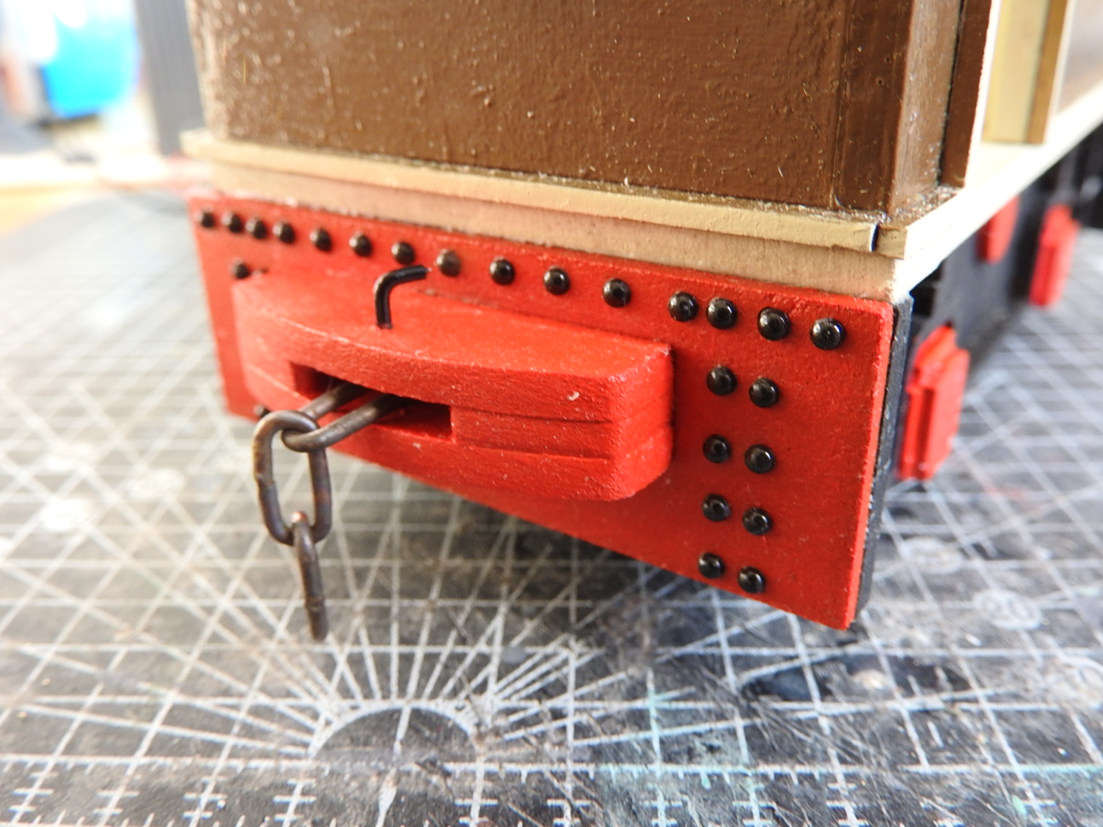

Well I was disappointed with the water only and just the same with adding vinegar. I did just try only vinegar, but Anne hated the smell of it.
So I did what Tom suggested, I did leave them a bit longer though, they started glowing red
Here they are, the top two needed some more heat on them.
I am more then happy with them.
Thanks to all who helped with my question.

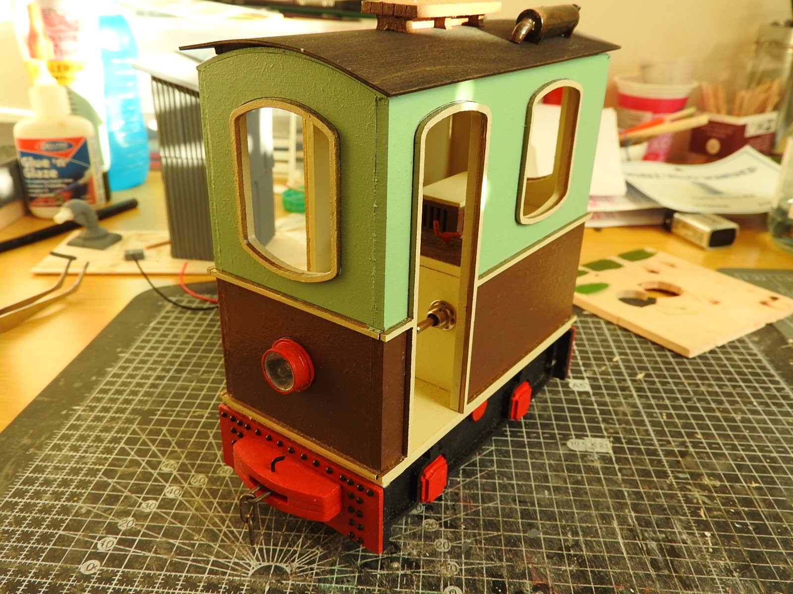

The chains are now on the little Wittenberg Schafer Loco,
They look ok I think. Shame about the little the windows not fitted, but I have run out of the glue I use to fix glazingβ¦..And the loco needs finishing with some varnish and other little things I am going to put on it.
