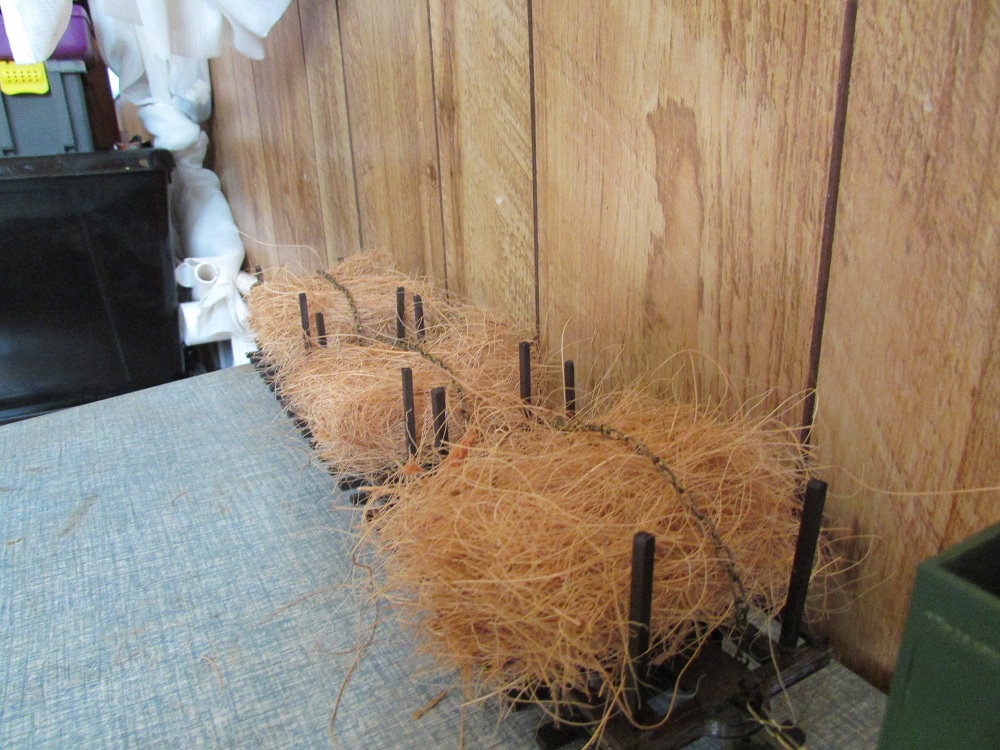

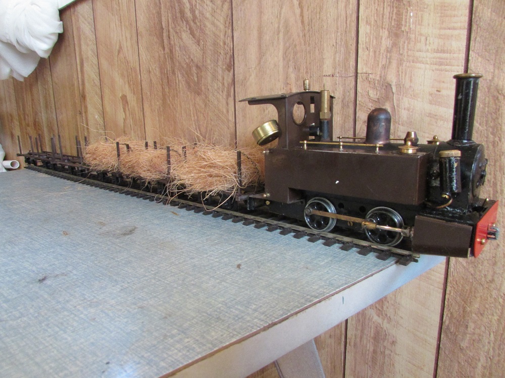

I'm pretty new to 16mm railways and with only a modified mamod loco thought I better make a few small wagons to run. Of course being Australian and with many old cane railways close-by, I opted to build cane wagons. With the recent purchase of a cheap 3D printer I wondered whether i could build the wagons with the 3D printer, thus making them fairly cheap. The first lot of wagons designed consisted of a main frame, 3 boards, 4 up-right posts, 4 wheels and 4 bearings all being 3D printed, with brass rod as axles being the only non-3D printed parts. A rake of 10 was printed up taking about a day or so and assembled. it was found however when testing them that due to being only light plastic they were too light and flew off the track in all directions (partially due to the extremely tight mamod track curves). Even with lead weights added to the wagons they were still fairly dodgey. After a while I gave up on the idea of completely 3D printing the wagons and decided to use balsa wood for the boards and uprights. This was found to improve the wagons somewhat, however when lead weights were added a rake of 15 wagons will go around the tight mamod track at relatively quick speeds. At the beginning i was skeptical about whether 3D printed o gauge wheels where feasible or not (since i coud not find anything on google about anyone making any) but in the end they seem to work pretty well considering they cost less than 1 cent to make. Anyway i just wrote way too many words so here's some pictures.
3 wagons loaded with coconut fiber as cane and 3 unloaded wagons behind the mamod loco

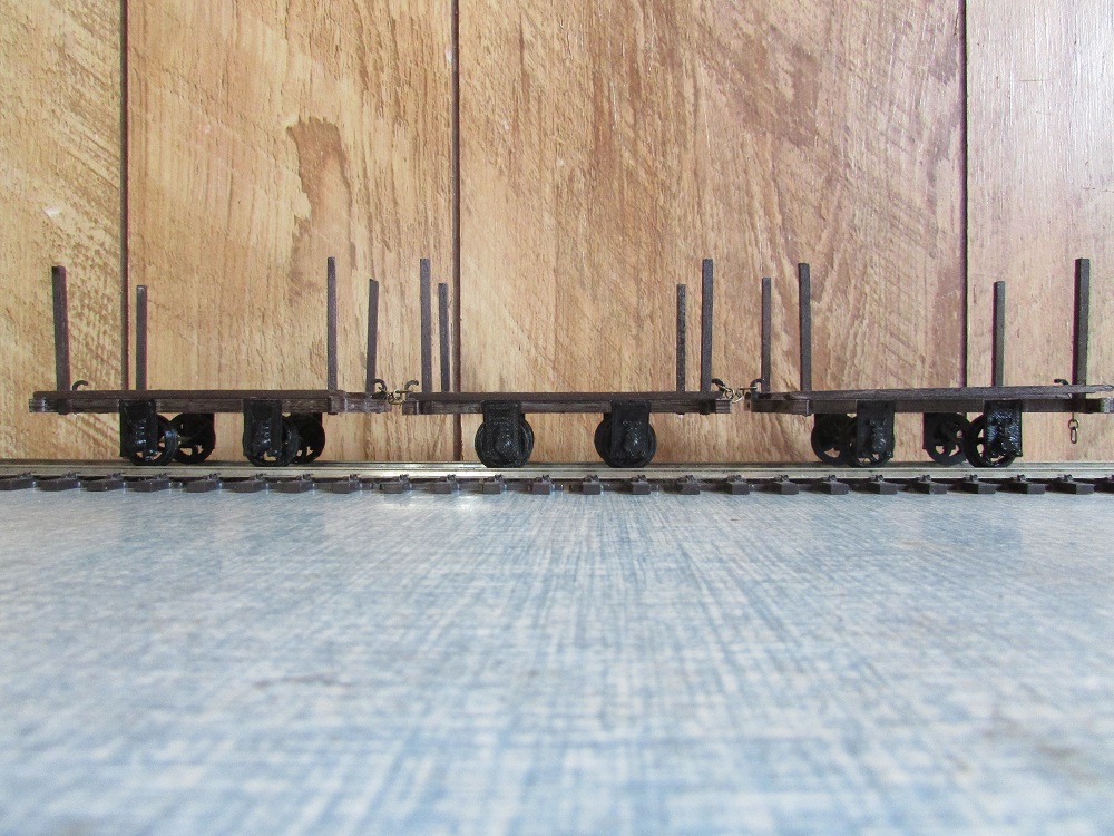

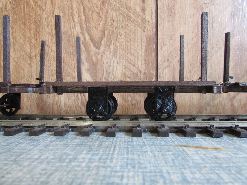

Side view of some wagons showing the 3D printed wheels and bearings/axle boxes (i didnt realise the wagon furthest to the right was broken until afer the photo was taken...)
