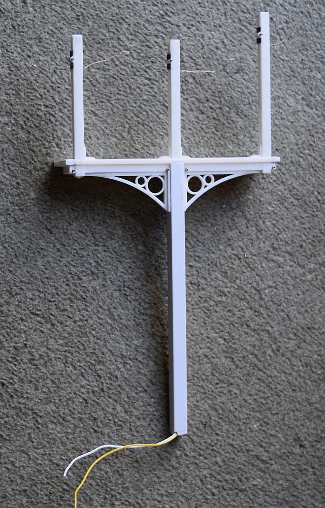

I decided that I would 3D print the gantry, top posts and fancy support brackets as one pair of items, a front and back, but this didn't work because the dimensions would only just fit on the printer's build plate and I had adhesion issues at the extremities. So I removed the support brackets and finials from the drawings and this gave me just enough leeway for it to work. Tbh, they were not my finest prints even so, but some filling and filing sorted them out.
The other thing I did was print a groove in the centre of the posts and gantry. I had noted in Rik's blog that he commented on not thinking soon enough about power supplies for the lamp LED's, so I designed in the internal cableways from the beginning and then laid in the wiring before gluing the two half's together.
The brackets were then printed separately, again as front and back pairs.
For the main post I had in stock some 10mm and 8mm square styrene tube which I acquired years ago from China in a job lot assorted bundle. I know the post should be tapered and also should be a bit thicker, but I wasn't going for a scale model and the overall effect looks Ok to my eye. Anyway, to give it all a bit more rigidity I slid a length of the 8mm inside the 10mm and dribbled solvent into the fine gap. I don't know how far capiliary action took it but it seems rigid enough and I was glad of the additional wall thickness later on when it came to fixing things to it. This main post was then glued to the underside of the gantry and the support brackets added each side.

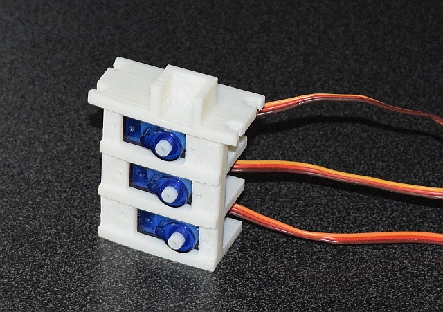

Whilst working on the turnout servo's previously, I had designed and printed a servo mount :
and now a bit of playing around with Sketchup gave me a nice neat stack of three, one above another and each offset sideways by about 2mm, plus a mounting socket for the signal post correctly positioned above to hold everything in line with minimal deflection. As an unplanned bonus it also subsequently allowed the whole thing to stand upright whilst working on the rest of the signal.

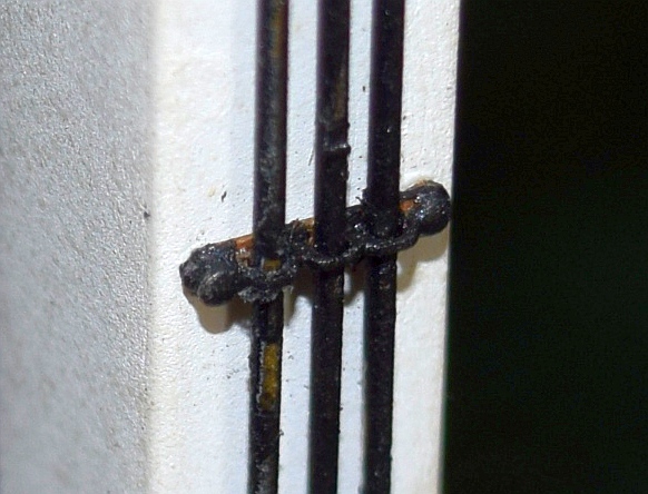

Now came the moment of truth - connecting the vertical rods to the servo's! I Confess that it wasn't easy to get them set up and I had to rebend the bottom of the first rod a couple of times. The servo arms are located on their shafts with small splines and of course they were always just not quite holding it where I wanted. The other problem I found on the long vertical rods was that the mechanical resistance in the system caused them to flex when being pushed and they clearly needed to be restrained.
In the 'bits box' I found a length of 1.5 x 1.5 T-section brass and I drilled 3 x 0.8mm holes in the leg of the T, at 2mm spacings. I then carefully opened these holes out to get a loose sliding fit for the 0.8mm rod. A 10mm long piece was cut off and 1.5mm sections filed flat at each end, and fixing holes were drilled in these flats. This triple hole guide was then slid onto the vertical rods and pushed up the post to the centre.
Just holding it in place with a finger and operating the servo's, showed that it worked and did restrain the rods, but somehow it didn't look quite right, and I decided that it actually needed two of them, so I made another! Whilst on the post I drilled through the fixing holes and loosely inserted pins to hold them until I was ready for permanent fixing.

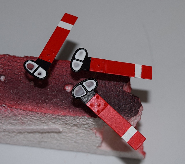

The proper signal arms were next made of brass and nickel silver sheet ( I happened to have a small piece of the right thickness N/S) basically following Rik's method from his blog, but I used brass rod rather than copper wire for the spectacles. Getting ahead of the timeline for a minute now, for the spectacle 'glasses' I had originally intended to use coloured acetate sheet, again as per Rik. However I found a very ancient pot of 'KristalClear" in the cupboard which, with a small drop of water added, proved to still work, so I used that. For anyone who doesn't know it, KristalClear is a very refined PVA which as it's name suggests, dries completely transparent. All you do is dip a cocktail stick in the white liquid and wipe it round the inside of the frame to wet it, then drag the stick flat across the opening in contact with the edges, and it leaves a thin film behind, right across the frame.
Leave it for an hour or two and it dries to a clear film. These can be coloured using permanent felt tip pens. ( I also did a partial experiment, and I think it might be possible to use ordinary PVA glue to achieve the same effect for signals, where it doesn't matter too much if the 'glass' is not completely transparent).
Ok, at this point I removed all of the rods and cranks and sprayed them with rattle can grey primer, followed by matt black. I also gave everything else a couple of coats of white primer. Eventually spraying everything with a coat of satin varnish to even out the finishes. The signal arms were also given the standard red front with white stripe and white rear with black stripe.

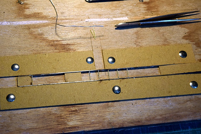

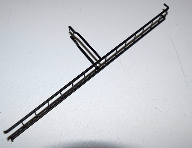

To construct the ladder, I gave a thorough clean to a length of rail twice as long as the ladder, and tinned one side. It was then folded in half with the tinning inside and the soldering iron applied in 2 or 3 places along its length to tack the two sides together. Using my Minicraft drill in it's vertical drill stand I put a 0.8mm hole through the rail webs near one end. I then moved it along by the rung spacing distance and drilled again. I knocked a pin through the first hole into the wood underneath and moved the rail along so that the second hole was on the pin, ensured that the drill was lined up in the web ready for the 3rd hole and put another pin through the first hole. I then drilled the 3rd hole, moved the rail along so that the next pair of holes were on the pins and drilled the 4th hole, etc.
All the drilling took only a few minutes. I used the soldering iron to split the solder tacks and and then cut the folded end leaving 2 identical ladders sides. I decided to pre-cut the rungs from the 0.8mm brass rod, so I drilled a hole the correct depth into a piece of wood and simply poked it in and cut off flush, until I had enough. A simple jig was made of 2 pieces thick card drawing-pinned to a piece of wood at the correct distance apart, with removable card spacers to keep the sides from accidentally moving inwards during soldering.
The whole lot was soldered together and then cleaned up. ( Psst... Tom, all done with an 18watt iron!). The tops of the ladder sides were bent over to sit into holes drilled horizontally into the edge of the signal platform, the bottoms were bent out sideways to create fixing anchors and horizontal stays were made to hold it to the post in the centre. These are soldered to the ladder and pinned and glued to the post. Including making the jigs it all took about a couple of hours, and I'm pleased with the result, which looks even better after a couple of coats of paint!
The ladder was not fixed at this stage and removed for safe keeping whilst the rest of it was being worked on. Similarly the safety rail round the gantry which was fabricated from brass wire, and painted, but kept separate.

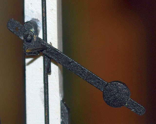

I had it in mind that the balance weight arms were missing from my grand design. Early on I did consider making them work as Rik did, but with all of the cranks and direction changes I was concerned anyway that play in the joints and rod flexing would mechanically smooth out the bouncing, and putting another three joints in the system might be too much. In practice this doesn't seem to be as much of a problem as I feared but who knows what wear will do in future. So, if they couldn't be made to work as part of the mechanics, I thought about cosmetic versions. I made arms and brackets in very much the same way as Rik's version. However the operating rod holes I elongated into slots. I then soldered small L-shaped pieces of 0.5mm brass wire to the vertical rods and slipped the slots over them before fixing to the post. The balance arm now goes up and down in tandem with the signal arm but the slot allows the rod to still move vertically instead of being pushed sideways which a simple hole would do, as it would follow an arc.
Up to this point, everything was still loose until I was sure no modifications were required, but I could no longer put off the evil day.
However it still bothered me that fixing the cranks by bending the axle ends would make life very difficult if any repairs are ever needed. Then just at the last minute I discovered that the 0.8mm rod will just about take a 14BA thread. Not a proper full thread but enough to run a nut on and a dab of black paint then just holds it enough to stop it coming undone. So, now everything was put together and tested before finally bending the signal arm axle rods to hold the backlight blind, very much as Rik's blog shows.
