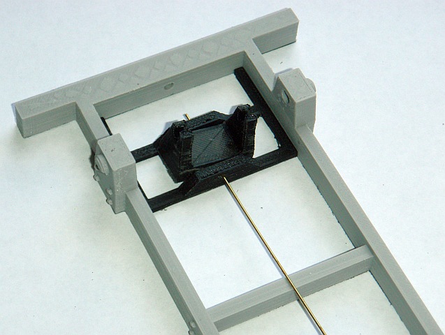

I started with the chassis and integral axleboxes.
This gave no real problems until I did a trial fitting of the wheels. I had some SwiftSixteen wheels in stock and 3mm steel rod for the axles, but the problem I discovered was that the solebars were too rigid to flex outward and allow the axles to drop into the holes printed in the axleboxes, as I had planned!

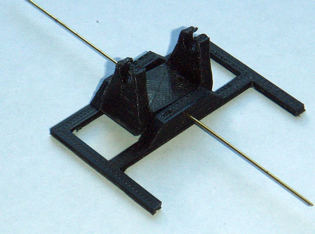

I thought that I was going to have to rethink and print the axle boxes as separate items and then glue them on, trapping the axles on the way. Then I had a flash of inspiration and remembered that Swift Sixteen wagon kits have their axles running in brass tube held in a triangular mounting which is fitted to the underside of the vehicle floor, between the solebars, and that is easy to replicate as a 3D printed item.
In order to keep it central when fixing, I added two extensions on each side to hold it central and square to the solebars.

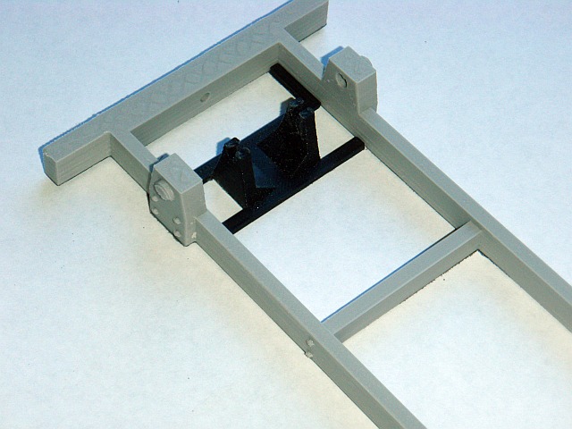

However, having done the trial print (above) to check viability, it dawned on me that it didn't have to be a big solid lump between the wheels so I removed the centre section, just leaving two relatively thin holders for the brass tube.
That seemed to be fine, but when fitting it to the frame (still on the computer 'drawing board') just to check things before finally printing, I accidentally slid one a couple of mm further along than the other, and that gave me yet another idea! So I added a couple of lengthways extensions to sit behind the headstocks, thus ensuring that both ends are exactly the same distance from the end, and square and central.
We've all seen rigid chassis 4-wheel vehicles lumping and bumping through pointwork and uneven rail joints and I've often thought back to my P4 days and wondered why nobody uses 3-point suspension in the larger scales. Well, looking at my axle holder, it dawned on me that the computer could easily split it into two so that one part could rock inside the other, similar to the etched brass units used in the smaller scales.

Phillip - a touch of genius with the extra alignment bars to ensure a correct, square, equi-distant fit - and I like the fact the centre lump is cut away

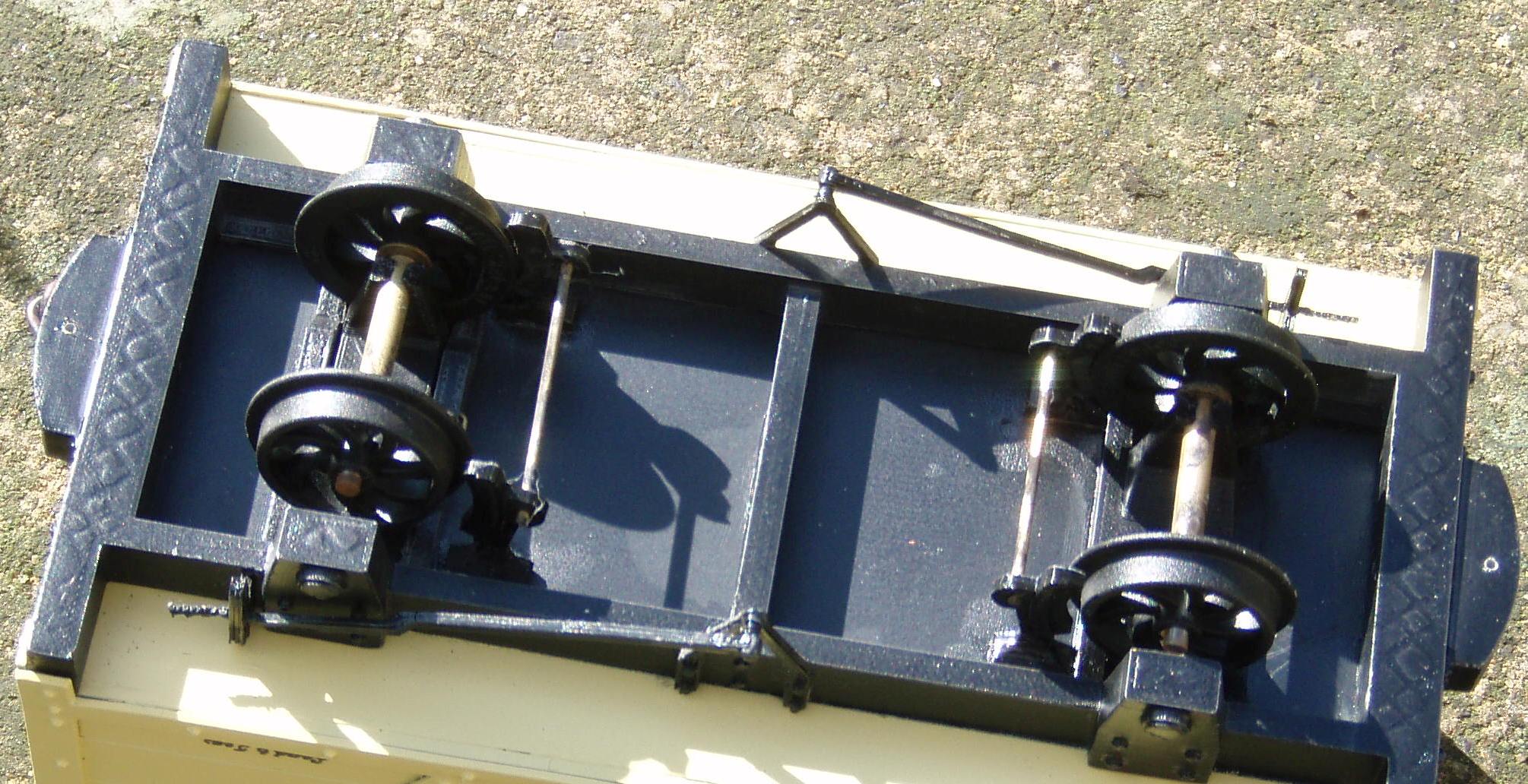

I like the compensation arrangement. Does it work on both ends or just one?.
- Posts: 6046
Re: A P.O. van for the E&D
Just one end. The whole point of the system is that effectively it creates a "3-legged stool" effect. At one end you have both wheels on the track and at the other end the vehicle is supported only in the centre so the wheels go up and down independently of the body orientation.Gralyn wrote: Tue Mar 13, 2018 4:04 pm I like the compensation arrangement. Does it work on both ends or just one?.

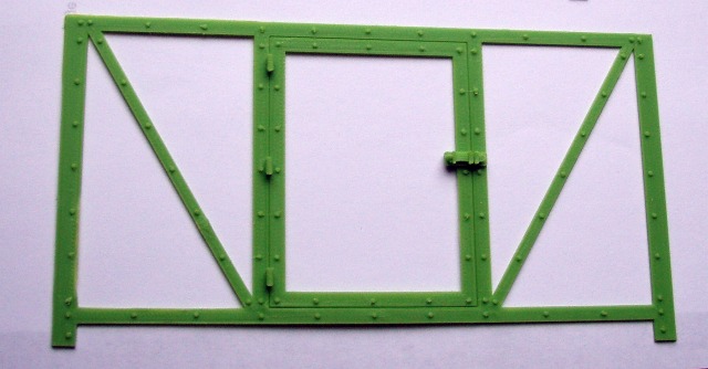

The next step was to draw and print the van strapping. Both sides and both ends are identical, so only need one drawing each. The straps are 1.5mm thick and this did cause problems of adhesion to the bed in some places. The net result being a rounding of the lower square corners, which required some careful filling with Squadron White once fitted to the body shell. The strapping print also included the bolt heads, door hinges and the door fastening bolt, all of which printed perfectly, much to my surprise.

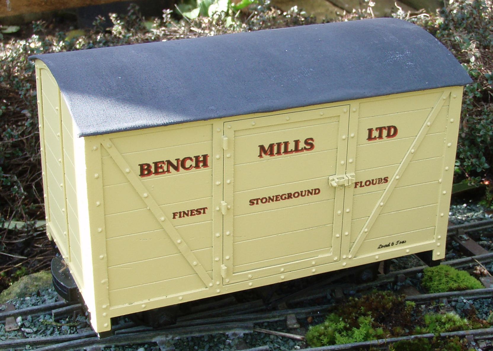

The chassis was sprayed black. The body was sprayed a cream colour and then glued to the chassis.
The roof is a piece of thin ply, glued on and covered with some fine weave cloth then painted dark dirty grey to simulate tarred canvas.
Having done all that, the two wheel assemblies were finally glued to the floor of the van, between the solebars.
I was fairly pleased with the end result, but looking at it I felt there was something missing..... brake levers! So, back to the drawing board. I wasn't very hopeful about printing these because the V-hangers and brake levers are very fine. It took me several goes to work out how to get the printer to cooperate, but the end result is fairly acceptable. I'm not sure how robust it will be and its probably not the best way to do it ( I think next time I'll use brass strip for the levers at least), but all part of the learning curve. Once the brake levers were glued on, it became fairly obvious that there was nothing for them to do, so Brake Blocks and hangers had to be drawn and printed.
The final touch was PO livery.

Nice combination of old and new modelling techniques. And nice end-product. It’s a shame that P.O. vans were rare on narrow gauge, there is something about a train of P.O. wagons that is very attractive.

Wonderful to see your thought process in action producing well designed items to a satisfactory conclusion. The finished van is a triumph and a great prototype for many to follow.

A brilliant design process Philip, and a very professional looking end product. The way it evolved from one step to another, the detail, the livery, everything just perfect. You have been busy.

The model has come up very well. I also thought Post Office when I first saw the heading, as the nearest equivalent here in Oz was known as an advertising van.philipy wrote: Tue Mar 13, 2018 1:30 pm Some months ago I drew up a van for complete 3D printing, but having done an experimental partial print I came to the conclusion that it was not really the sensible way to go, requiring far to much cleaning up.
That's a much more rational use of rapid prototyping than I usually see. Too many people get hung up on printing a one piece body and the result is a model where it is impossible to get a good surface finish.
