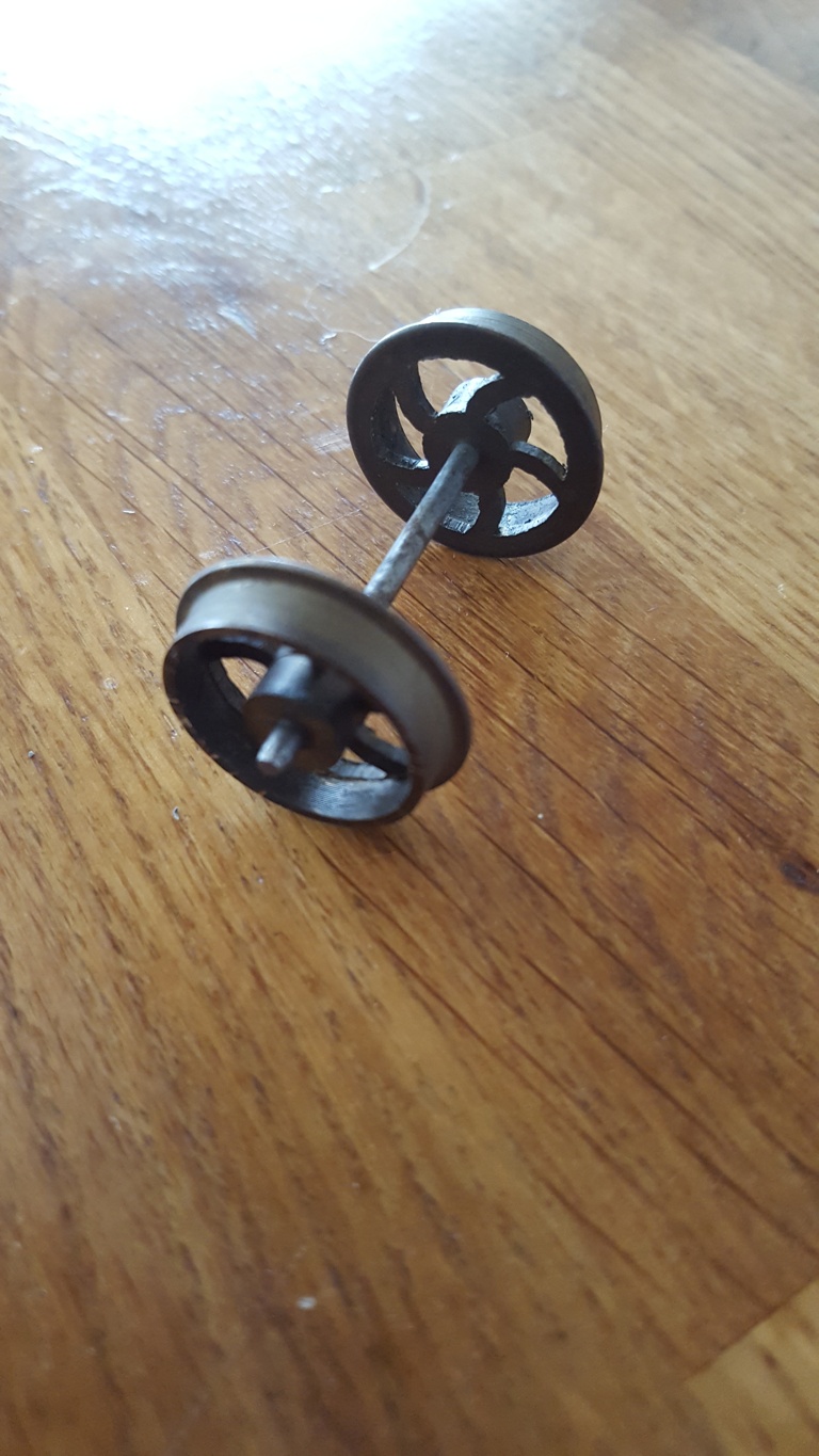

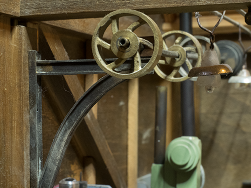

Hi, this may not be the answer you are looking for.
I wanted a redundant lineshaft in the Rylston Light's workshop. As this was originally intended as a simple stage for photographing models I had a "low fidelity" approach to background detail on the basis it is mainly blurred. I sort of lost the way and added more and more detail but a lot of the original background is still a bit rough and ready. I tend to avoid photographing them directly. But this is the RLR lineshaft:
The belt pulley (sans belts as it is supposed to be redundant but left in situ) is actually a curved spoke wheel with the flange removed. These were 3 supplied by Ron Grant many years ago (I seem to remember). He would sometimes supply a single extra wheel in an order for no apparent reason! I accumulated 3, but never the 4th that would have allowed me to use them conventionally. Wasn't there a song long ago "Three wheels on my wagon but I'm still rolling along"? For younger members google it and you will realise that not all music from the sixties was golden.
But back to the plot:
I turned the flanges down on a mini-lathe, but if you don't have access then plastic wheels, such as from Slaters or Cambrian, should file down easily. Of course I havn't solved a running line-shaft; from your previous projects I'm confident you will :-))
As an aside the industrial light-shade next to it is the tip of a ballpoint pen pushed through a cup washer! I don't normally allow photographs of those to be seen too clearly in public either!

Thanks Andy. That looks like a good solution, though it would be good to have different diameter wheels. Maybe I could mix 0 scale wheels with 16mm scale.

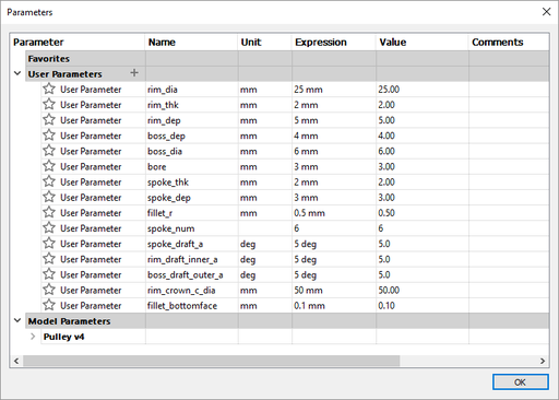

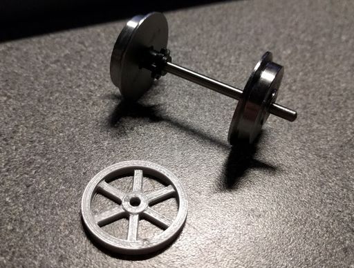

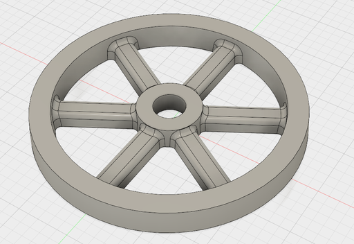

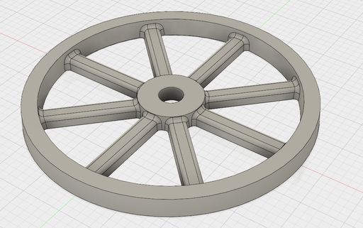

Mostly as an exercise in learning CAD, I've drawn up a parametric pulley in Autodesk Fusion 360.
The model is only for half a pulley, you would need two 3d prints to make a complete pulley, but this way avoids overhangs. It does have a crown and draft angles so I guess in theory it could be used as a pattern for casting too.
Pretty much everything is a parameter that can be changed and the model automatically rebuilds with the new dimensions: So by default you get a 6 spoke 25mm dia pulley: But by changing a few numbers you can get an 8 spoke 35mm, or whatever you want. Just have to be a bit careful in allowing enough room for the fillets between spokes. You can download the fusion 360 file and an .stl for the 6 spoke 25mm one here. Fusion 360 is free for hobbyists and small companies, but is a bit of a hassle to set up with logins and such, so if anyone wants a couple of .stl files exporting so they can print one themselves or send off to another company, just give me the dimensions and I'll send an .stl over.

Blimey, that's good. Philipy has offered to print them for me, I just need to work out what sizes I need.metalmuncher wrote: Wed Mar 07, 2018 6:57 pm Mostly as an exercise in learning CAD, I've drawn up a parametric pulley in Autodesk Fusion 360.
You can download the fusion 360 file and an .stl for the 6 spoke 25mm one here. Fusion 360 is free for hobbyists and small companies, but is a bit of a hassle to set up with logins and such, so if anyone wants a couple of .stl files exporting so they can print one themselves or send off to another company, just give me the dimensions and I'll send an .stl over.![]()
