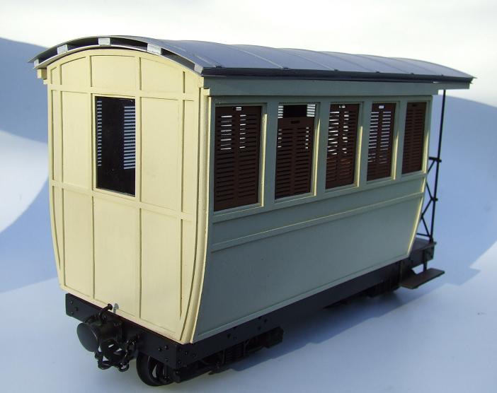

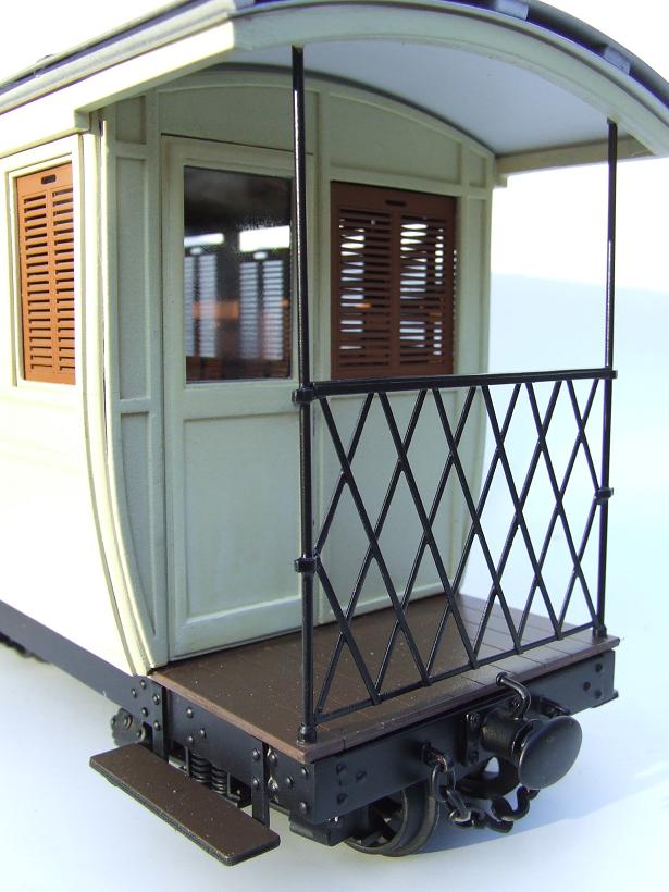

Construction of the model was mostly from parts I could draw and cut out on the laser cutter. The underframe was assembled from parts cut in perspex. It was detailed with lace pins for rivets. The bogies which look to be correct are Swift Sixteen's DHR pattern -assembly of these is simple and detail and running are excellent. The balcony rail was assembled from sheared 0.5mm nickel silver. This was soldered together on top of a printed plan extracted from the drawing. The coach body with its tumblehome sides needed a press to be assembled in. This was formed from 2 sheets of thick aluminium. The 3 part 1mm mount board sides were dampened on the glue face and glued up with PVA. The formed side was kept in the press for 24 hours. They come out formed and firmly laminated. There are slots in the middle layer to accept the droplights. The construction of the ends is similar.

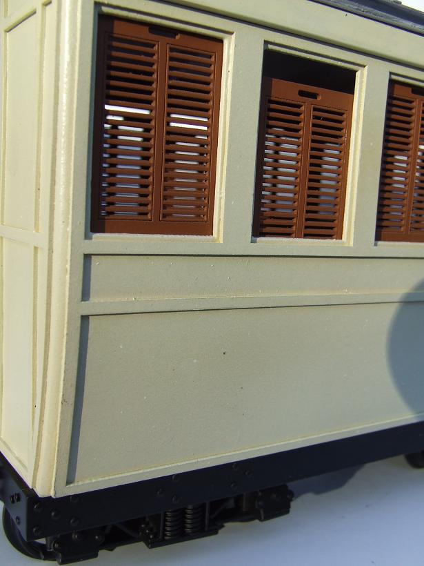

These pieces plus the double thickness floor are given a couple of coats of car primer, this being used instead of shellac. Assembly is with gel superglue. The interior of the coach is fully detailed with two bench seats. The droplights are made in 3 layers of thin card. The 2nd and 3rd layer have the slots in them raised by 0.4 and 0.8mm. This gives the illusion of a venetian shutter angled louvre. Simple to do with the computer art work and laser cutter, near impossible to do quickly any other way! Only the door and end window were glazed on these coaches. The panelling (pre-primed) was applied with PVA then the coach was well primed again. The roof is made from two preformed aluminium roofs separated by perspex strips.
Assembly was with super glue(next time I will use rapid epoxy(super glue is too brittle). On the underside of the inner roof are the ribs that the roof had. These are used to retain the roof on the coach body. Painting is a mixture of Halford's car, and Tamiya acrylic. The finished coach has had a couple of coats of Gameworkshop, clear coat.
The choice of building this coach is quite sensible, since the GLR coaching stock is all of the same shape and general design. I think it will be a simple matter to generate drawings for all the coaches in the train at the start of the post. With a bit of luc,k at Statfold barn, there might be enough photgraphic information to build the luggage and brake van.
Lessons learnt - mount board is a wonderful material to use with a laser cutter, perpex varies a lot in its ability to be bonded. Aluminium does not easily glue with superglue. Tumblehome bodies should not be avoided, you just have to bend up some 1/8" aluminium and buy rather a lot of bulldog clips.
