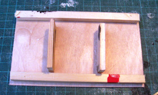

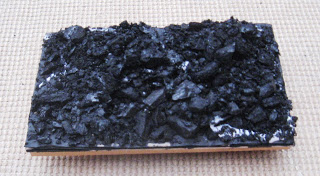

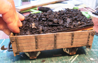

I've made my coal loads removable so I can run down the line as full and return as empty. The real coal is glued with PVA on to a plywood platform mounted on blocks .....
..... so the load can be removed easily

ge_rik wrote: Fri Jan 05, 2018 8:34 pm I've made my coal loads removable so I can run down the line as full and return as empty. The real coal is glued with PVA on to a plywood platform mounted on blocks .....
