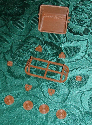

There is a website called Thingverse which is a repository for all kinds of objects which folks have drawn and printed and then put up for free distribution. Most of the model railway stuff is for the smaller scales and/or the US and Europe, but I did spy the files for a Hudson type skip wagon and it's been in the back of my mind for some months. With the bad weather forecast for this weekend I downloaded the files yesterday to see what I could do. Basically, as drawn it seems to be designed to match LGB, so the first job was to rescale everything, which was only a few clicks to tell the software I wanted everything reduced to 72%, to get it to a nominal 16mm scale.
It's quite slow printing, the chassis and tub took about 5.5hours each, plus the 4 axleboxes about another hour, the coupling blocks about 30mins and the 4 wheels just over an hour. Normally items are printed at about 20 or 30% solid, which speeds things up and saves material, however I wanted this to be capable of taking some rough handling so I increased the fill to 70%, which explains some of the printing time. The wheels I actually printed at 100% solid. I'm not sure about using the wheels i think I might replace them with 'proper' ones, but they do look surprisingly good profile and actually round, although how well they roll remains to be seen.
Anyway, here are the components, roughly cleaned up, they still need a bit more attention before they can be glued together.

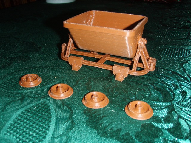

...and here it is clipped together in a dry run, but without the wheels
I calculate that the material cost is approx Β£1.50 plus axles and new wheels if I decide to change them.
