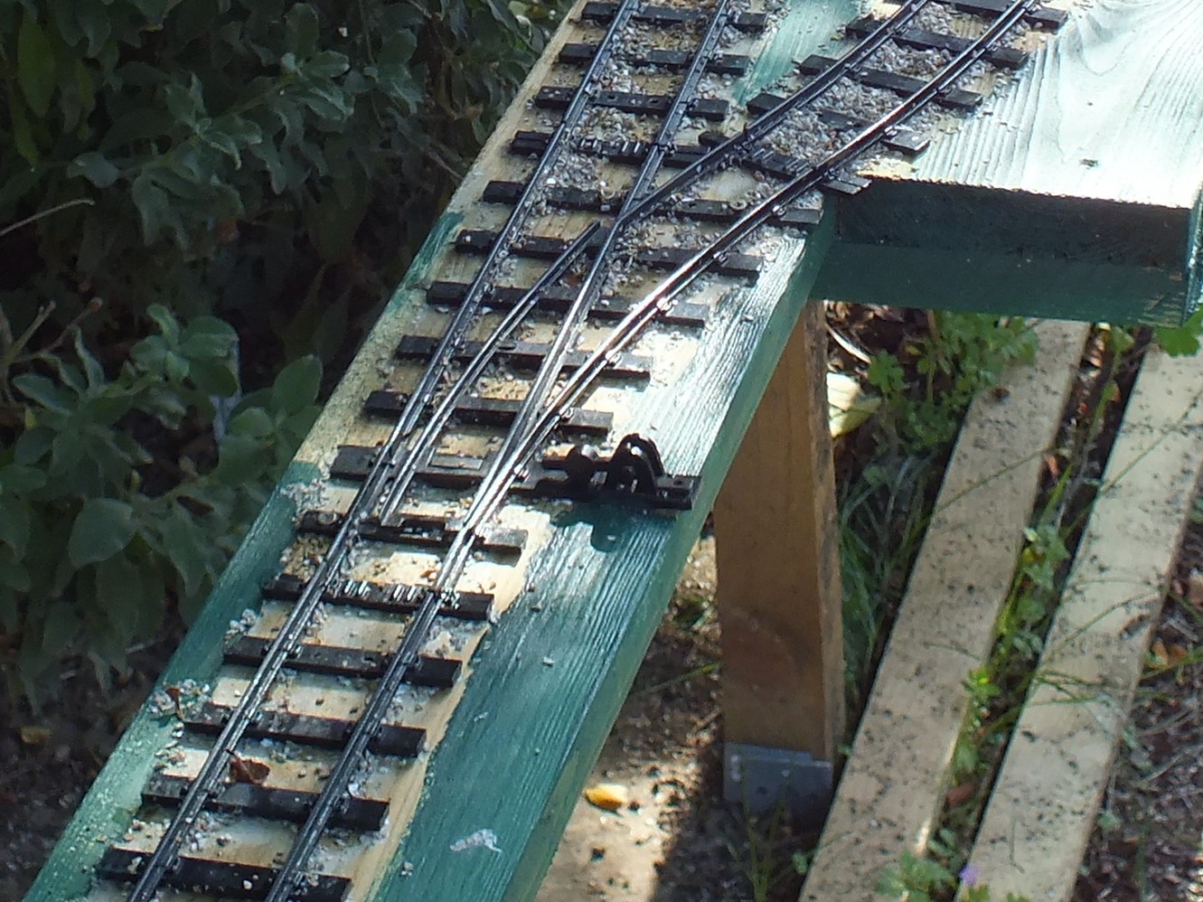

This is the point in question. Its the MSS version of the Mamod track point.
As you can see it is off the ground by 2 feet.
What do you think?

Hi Dave, in answer to your question, ..... yes it can be done. However, if your question is... Is it a good idea?..... then my answer would be, no!
Outdoor layouts are exposed to all weather conditions, electrical systems prefer dry ones. In order to operate your points with servos you need water resistant ones as used in model boats, you need switches to make them work which must be waterproof if located outdoors, you need a transformer to a provide a voltage compatible with your servos and finally you need a mains supply from your house or shed. If you think you can provide all of these then go for it.... I fitted about ten on my railway and immediately ripped them all out again.
My preferred solution was to fit either rod or wire-in-tube control systems with the levers placed in convenient locations around the layout. I found that I was often in the wrong place when a point needed changing and having a central control panel inside my shed was a real pain. Like your railway, mine is also raised on boards so access to the underside is easy enough to fit concealed WIT. It is also cheaper to install and needs little or no maintenance.
I have a rod operated point about 4m away from its lever and WIT ones reaching more than 2.3m. Bicycle brake cables I find are most suitable for this.
I hope this is useful information despite the fact it isn't what you wanted to hear.

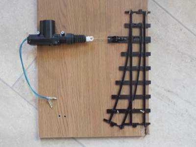

I have now recieved the car central locking servos.
Big, chunky and waterproof. I fixed a new point to a test board with the servo at 90 deg to it.
After a minor adjustment the servo changed the point every time.
I will be mounting the servo under the base board when I install it outside, but that can now wait for next season.
I have used a two wire central locking servo. Reverse the polarity of the two wires to alter direction. It runs on 12v dc.
I hope this gives food for thought. These servos cost around £3.50 each.
