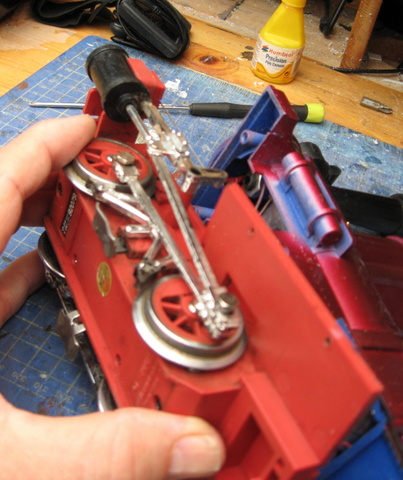

Part 2 - Disassembly

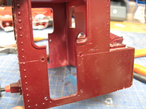

Having dismantled a few of these in my time, before long the Otto was in pieces on the workbench

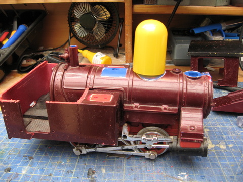

Part 3 - Hack it about a bit
Easy, I thought. All I have to do is chop the cab in half and the job is done!
Hmmmm..... I thought. It's OK, but it don't look right!
I could maybe add a dome - perhaps that would improve matters....?
Being a cheapskate, I filched the top off a bottle of sun tan cream which was actually the same size as the original dome - but a bit more dome-shaped.
Nope ..... not sure about that!

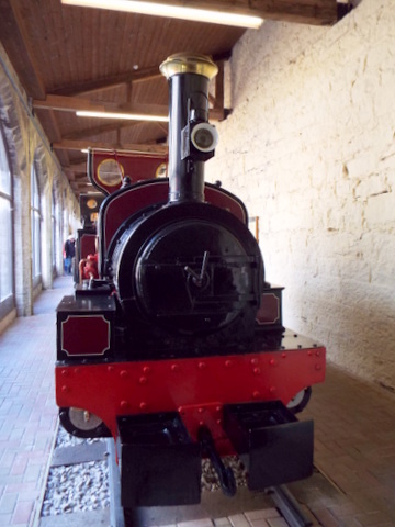

Part 4 - Back to the drawing board
At about that time, I happened to pick up a copy of Ivo Peters' OPC book on narrow gauge railways (The Narrow Gauge Charm of Yesteryear: A Pictorial Tribute; Peters, I; OPC; 1976) and in there were some pictures of the Ironstone Railways around Kettering - which included some pictures of a couple of Black Hawthorn 3' gauge 0-4-0 saddle tanks ...... which really caught my eye (Plates 89, 90, 99, 101, 106, 107, 108).
eg see
https://youtu.be/YVTQhpkAITo?t=984

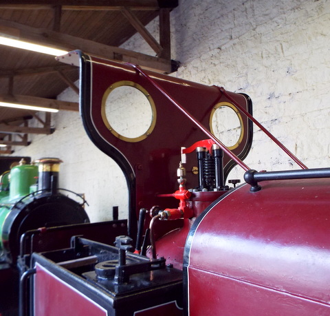

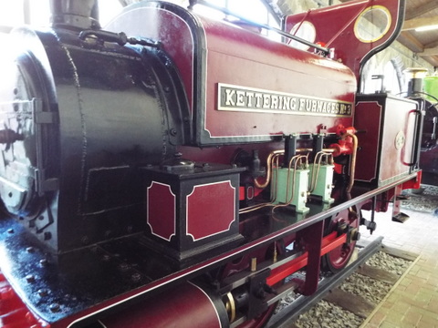

After a bit of research I discovered that one of them, the imaginatively named 'Kettering Furnaces No. 3" was preserved at Penrhyn Castle - about an hour and a quarter's drive away. So, armed with my Box Brownie (or similar) I hot-footed it over to Bangor.
I decided to take around 70 photos from every conceivable angle. Never had a real loco to base my bashes on before!

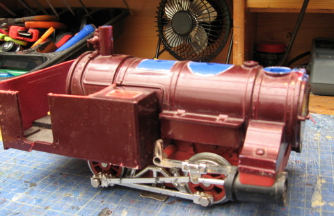

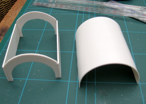

Part 5 - Out comes the razor saw
So, back at base, the razor saw went into mad frenzied action.
...... and the tanks (now to become the bunkers) were shoved back a bit .....
....... and a saddle tank was fashioned out of plasticard.
My bashes are never exact scale models - I like to think they are 'inspired' by the originals and so rather than getting the micrometer and rivet-counter out, I tend to do things by eye. This is progress so far.
As you can see, there's still a fair bit to do. That cab-front/spectacle plate is the next highly distinctive feature. I think that'll have to be brass sheet if it's to survive the maulings and occasional earth-plummets which happen on the Peckforton Light Railway.

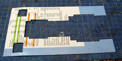

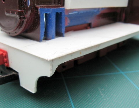

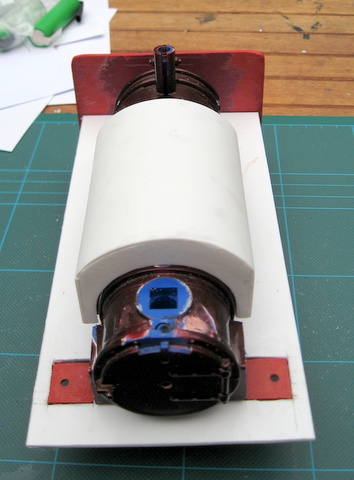

Part 6 - Running plate
A bit more progress. Decided the running plate (and footplate) were more important than the cab front as so much else depends on it.
May not look like a lot of progress, but actually took quite a bit of prototyping before I got it (more or less) right. Where would we be without cereal box cardboard?
You may have noticed that (for now) the side tanks have gone. I realised that, if I was to retain the clean lines of the original, these needed to be raised as did the footplate. Now I've got the datum line of the footplate/running plate, I can get the other bits looking right.

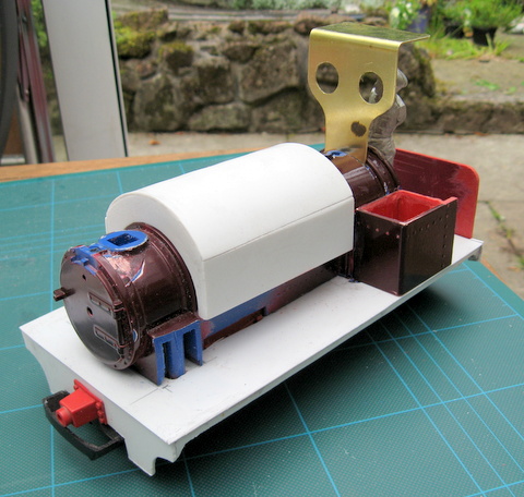

Re: Otto bash

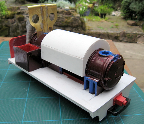

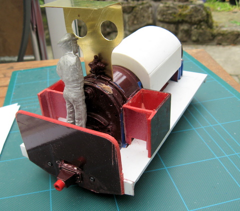

Part 7 - Making a spectacle (of myself!)
A couple of jobs needed to be done before I could make a start on the spectacle plate. Firstly, I needed to finish off the running board. It needed a 0.5mm thick 'plate' over the entire surface, and the sides needed some reinforcement. At the same time, I added the front buffer beam, which required some remodelling of the original buffer beam and coupling mount.
I then needed to re-affix the side tanks (ie the new coal bunkers). These required a fair bit of work before they could be fixed into place. They needed to be lopped off at the bottom, they needed to be opened out at the top and they needed around 1mm shaved off the back so they wouldn't overlap the sides of the running plate.
I could then start work on the spectacle plate, which had to be fashioned from brass sheet. As I had only a 2" wide sheet of the right gauge to hand, this dictated the width - besides which it looked in proportion with the original. It was marked up, drilled and filed to shape.
Although it's correctly proportioned in terms of the prototype, I'm not convinced it looks right on the Otto bash, which is a fair bit wider than Kettering Furnaces No.3
I'm now wondering whether to make a wider version. I think a bit more cereal-box cardboard prototyping is on the cards (sorry about the pun!)
Re: Otto bash
I can see what you are saying Rik about the spectacle plate. Sometimes as annoying as it is you get a better result if you start again.
- Posts: 7992
Re: Otto bash
While awaiting fresh supplies of brass, I thought I'd take a look at what the spectacle plate might look like 10mm wider. I think this is better proportioned for Otto.
