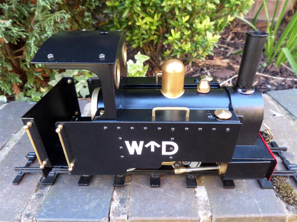

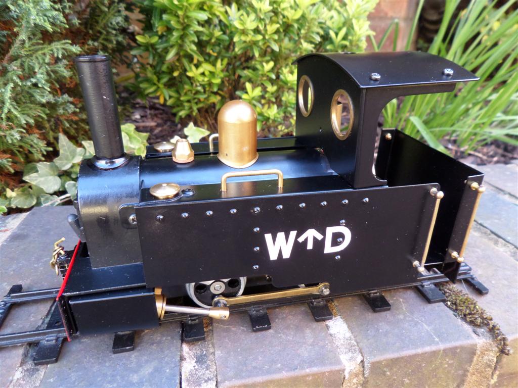

Just as you suggest - purchase a 'low cost' Mamod SL or MSS loco and do it up a bit - that's what I do. Here is one I made earlier (from a standard MSS tank engine):
- Attachments
- SAM_0813 (Large).JPG (133.02 KiB) Viewed 6594 times
- SAM_0816 (Large).JPG (132.51 KiB) Viewed 6594 times
- SAM_0815 (Large).JPG (128.56 KiB) Viewed 6594 times

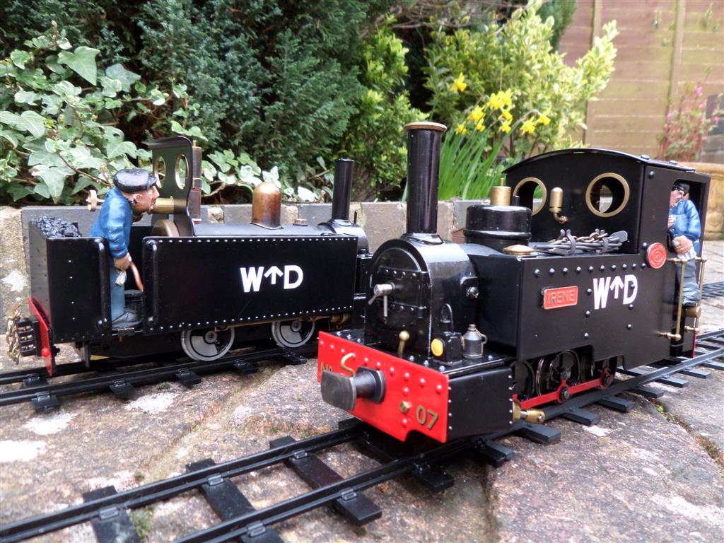

Group shot of two other Mamod based WD Engines:
- Attachments
- SAM_0706 (Large).JPG (165.59 KiB) Viewed 6594 times
