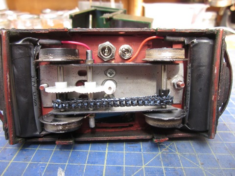

Deltang receivers were developed to run off li-ion batteries and so offer some protection against over-discharge by default. You could buy 10440 li-ions with built-in protection from eBay but some of the 'bargains' on there tend to be lower quality (and hence higher risk). I'd be inclined to go for a couple of tabbed 10440s from Ecolux - eg https://ecoluxshopdirect.co.uk/hq-ecolu ... tag-s.html - as you can be sure of the quality of his batteries. You'd need to buy a 1S protection board such as - http://www.ebay.co.uk/itm/151964194269 - but it would be dead easy to wire up and would give you plenty of protection. I would recommend a decent intelligent charger though, such as the iMax B6 - http://www.ebay.co.uk/itm/132059016298. It can be a bit intimidating when first out of the box (the instructions are largely incomprehensible), but once it's set up (I could help you with that), it's a doddle to use - and gives peace of mind that the charging will be done safely.
BTW - I power my IP Simplex with two AA sized li-ions (14500) wired in parallel - again from Ecolux. It's a tight squeeze but possible - and they give a longer running time than AAAs. More info on my blog - https://riksrailway.blogspot.co.uk/2015 ... mplex.html . I even managed to squeeze a couple of (very cheap) soundcards under the bonnet) Rik
PS - I haven't included a protection board in my simplex. I rely on the Deltang Rx to protect against over discharge, a fuse to protect against short circuits and the iMax B6 to protect against over-charging.
