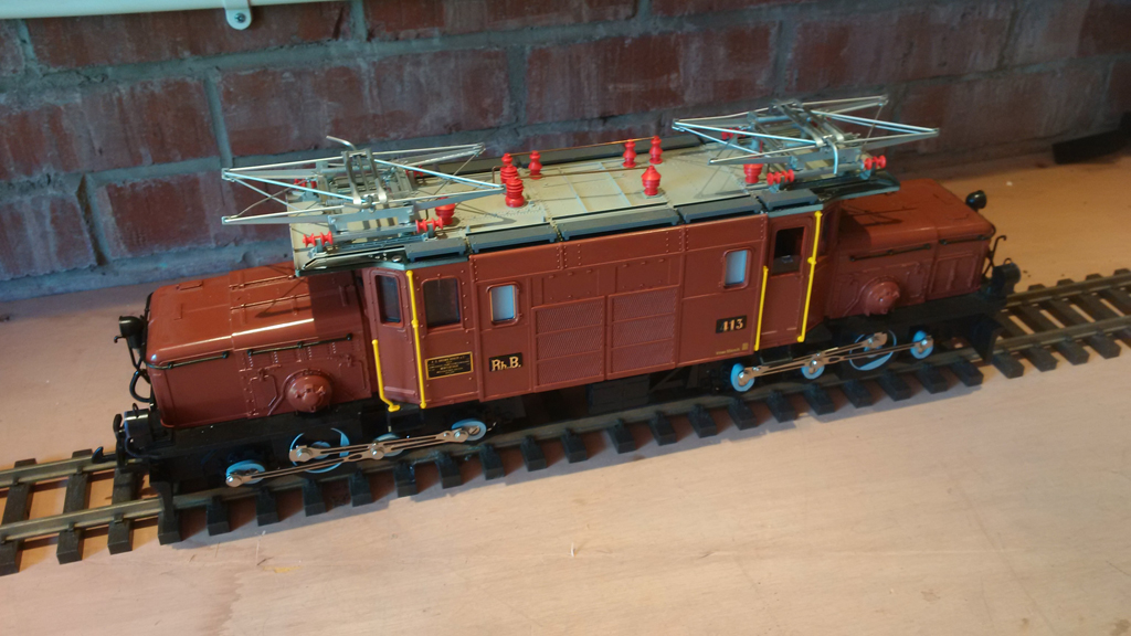

So i bought this for a bargain price of £150, listed on ebay as just 'Train For Garden' - Brilliant!

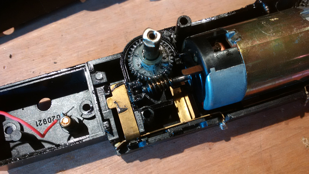

Tracing the wires back it is clearly one of the older / original models for DC only before the days of all of this digital going on.
I have so far stripped it down as far as opening the two motor blocks up to discover that the motors are direct feed from the track and then the wires come up into the body for lights, pantograph power etc.

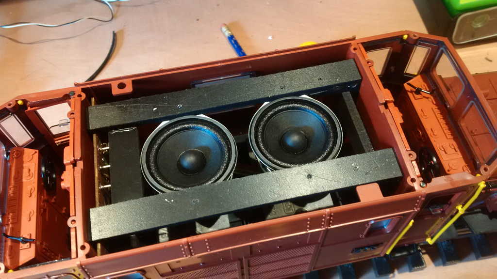

Build a frame to hold the speakers (out of foamex board)

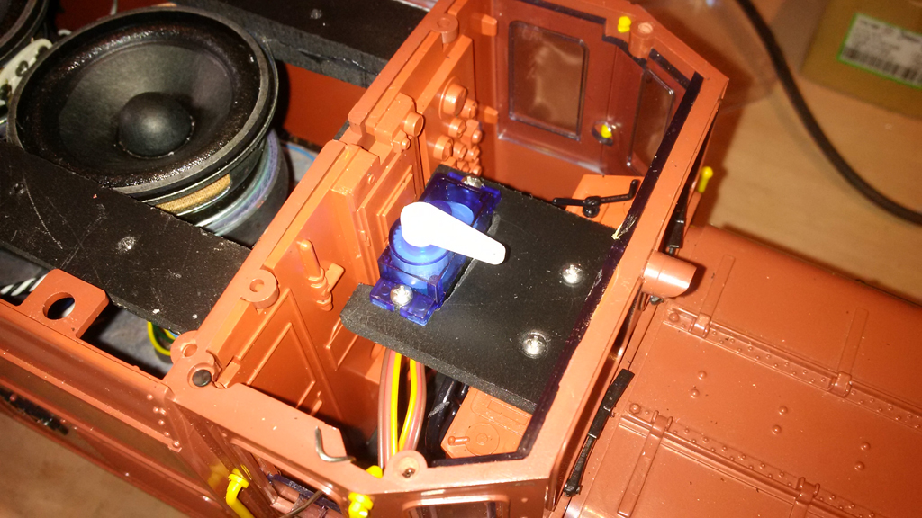

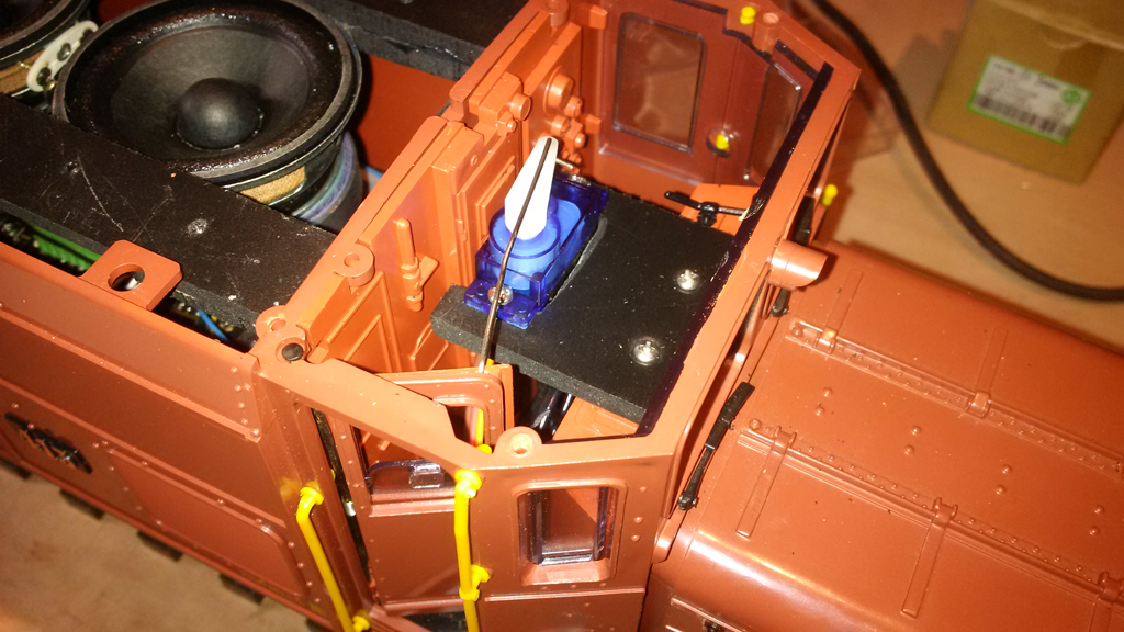

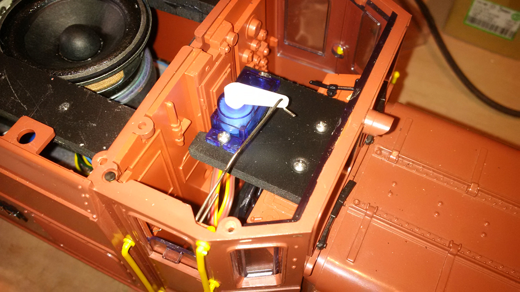

For my next trick we are having opening doors with servos.
Servos £5 each from a robotics website and a paperclip does the job for the connecting rod.
Servo In Place Door Open Door Closed (I still need to program the CV's of the chip for servo positions etc but that's pretty straight forward)

Nice idea of the door opening, but wouldn't it be nicer to hide the servo in the locomotive, beside the speaker? With a simple 90 degree angle you can transfer the movement. This way you keep the cab clear of mechanics, since the windows are big enough to give sight to the inside of the cab easily. You can then also use the same servo to open a door on the other cab too.

Re: LGB Crocodile Upgrades, DCC, Sound, Lights, etc
Thats was plan A but then i decided i just wanted to get it working!
The black plastic plate that it is all sitting on is just held to the drivers control panel with a single screw so easily removed if needed.
