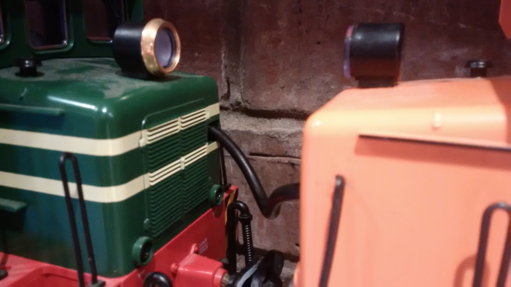

Now begins my attempt to improve two LGB Schoema locos purchased from ebay.
So far i have:
  • Replaced / fitted Zimo MX695 DCC chips
  • Fitted capacitors to the decoders to help them get over dirty track and plastic frogs
  • Tried Masooth automatic un-couplers (removed as didn't find them to be reliable)

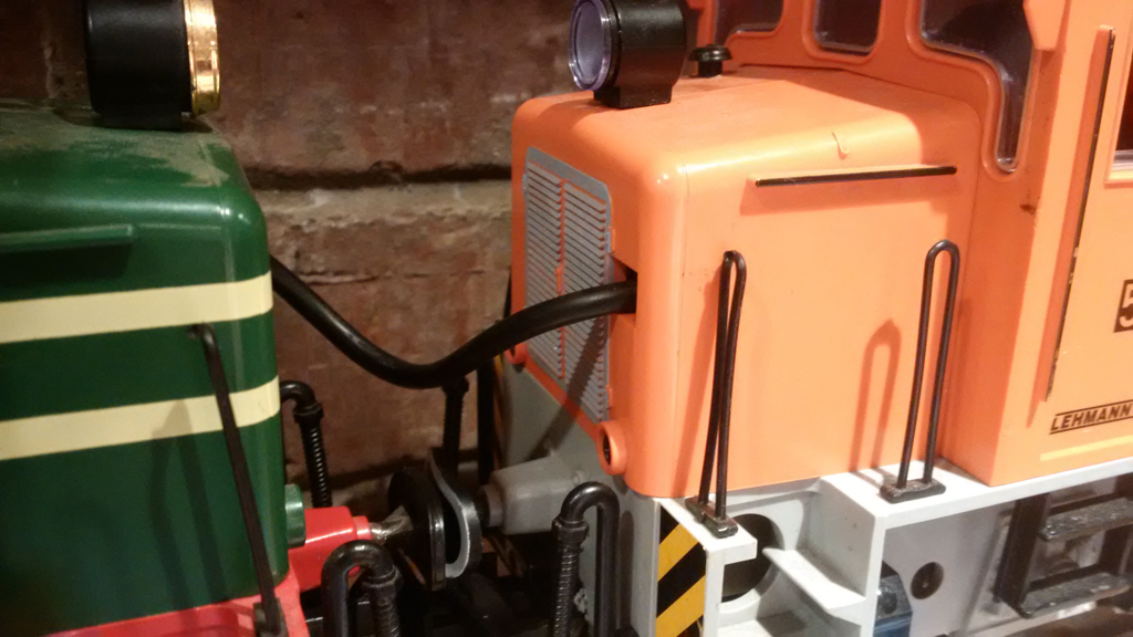

Just completed:
as pictured, linking pickups from the two together so they can get over dirty track and plastic frogs even better.
They now run as well as the Ge 4/4's
Next step is smoke generators and improve the lighting then maybe some sound.

Nice clean lookin' connection !
I see your lite-coloured unit has the same detail problem as our cleaning loco'. The headlight rings just don't want to stay on. Maybe a small dot of paint on the inside of the ring will hold the loose ones in place. Will try that when i get back ...

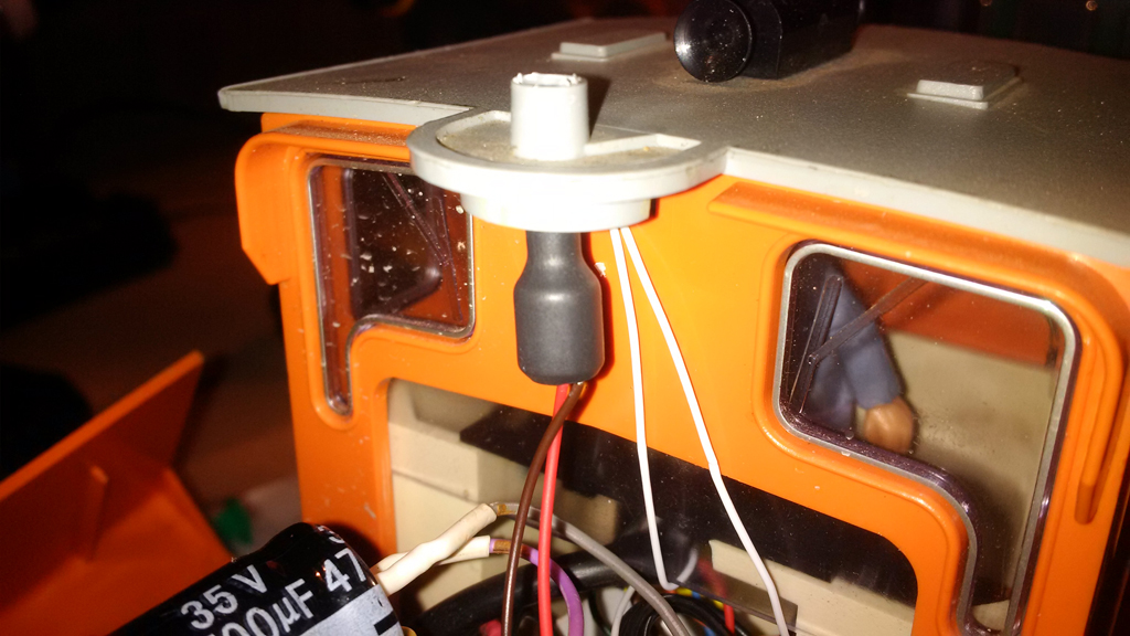

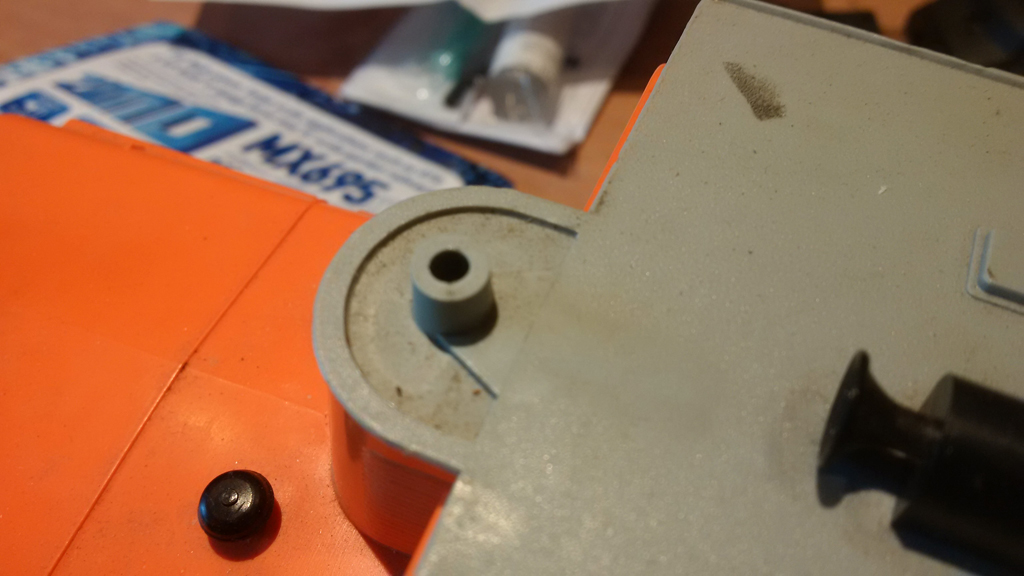

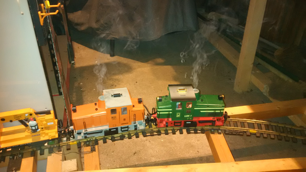

Smoke generator fitting (one in each loco)
Remove black plug from top of chimney
Hole is too small so drill bigger (4.5mm in my case)
Push the smoke unit in place
Result
stevenfitch
Posts: 223
Location: Northumberland UK
Re: LGB Schoema Consist - Improvements
Post by stevenfitch » Wed Apr 26, 2017 9:42 pm
...and a video of them too.
https://youtu.be/_6J_C7ReB34
