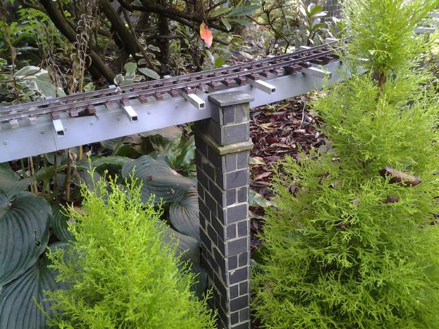

I applaud your determination to use real slate to make structures and have done so myself, BUT..... avoid silicone like the plague! It is not an adhesive and will certainly de-laminate when it gets wet.
When you cut slate it has a light covering of slate dust which is what any bonding agent will stick to, in time this will become separated from the block and your work will fall apart. If possible use something to coat each block, I use SBR and allow it to dry, before sticking them together. I have found a hot glue gun quite good for this but sometimes you need to reinforce that too, possibly with cement or waterproof tile adhesive spread inside the structure.
I hope this helps and you don't have to rebuild your structures, especially as we are approaching wet and cold weather.
This water tower is the first I made this way and it lives outside in all weathers.
