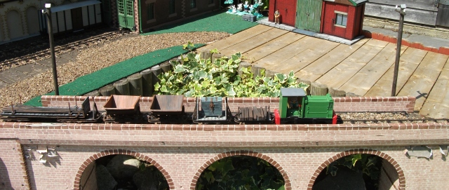

The original three arch bridge was made of plywood in 2008. I took a lot of care in treating the timber before priming and painting it, finishing off with varnish. But still the damp got in and made a mess of the paintwork, and it has started to rot the timber. Some may say 7 years is not too bad.
A couple of pics to show the state it was getting into. I used to use it as a stage to take photos of rolling stock.

The replacement is made of Foamboard with stone joints pressed in, painted with B&Q stone paint sample pots. Looks quite bright at the moment, but I expect that it will tone down in time.

That viaduct looks very good indeed and as you say I am certain it will tone down a bit over the next few months. You could try and help it with a wash of very dilute black paint, but patience is a virtue as they say, let nature take its course.

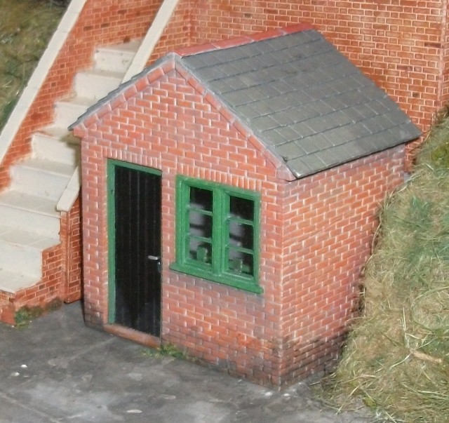

An early effort to see what I could get brickwork to look like was this little weighbridge hut in 7mm scale, done for the Fareham & District Model Railway Club’s Fairhaven Town layout. Its a bit rough, but it was interesting to work in a smaller scale just for a change. The brickwork behind is embossed plasticard.

Posted: Fri Nov 20, 2015 10:08 am
I guess you mitre the corners so that no exposed core is visible? Also, it makes a big difference to the overall appearance by showing rising damp and algae on the lower part of the walls...... very realistic!

No Peter I don’t mitre the corners, I just stick together in a butt joint, although I do scratch the butting surfaces in order to improve the ‘grip’. I can just about manage to get square edges, but me doing lot of 45° angles would test the amount of board I have in stock. I also think that getting the external corner of the mitred joint to look acceptable would be a problem for me.
I make what was the end/edge of the board a little proud of the adjacent face, and file/sand it down to match the adjacent surface – this is done after the solvent glue has completely gone off, generally the next day. By little I mean about a fingernail thick or less.
The cut with a knife edge of the board looks very similar to the face of the board. The cut and sanded edge or core does look very similar to the lightly sanded face of the board – I go over the all the faces with a foam sanding block prior to painting anyway. After painting, most times, you can’t see the joint – as with most things, it gets better with a bit of practice.
A lot of the surface indentations (dents) etc. are done before sticking the panels together, it is easier to work on a flat surface and it also reduces the amount of stress this puts on the joints when finishing off later.

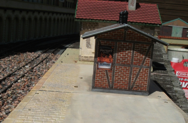

The POLA Station has been sitting there all alone for a few years, and so I thought it was time it had a bit more platform (in Foamboard). A ‘typical’ Germanic railway building was also knocked up with Foamboard walls and Plasticard roof and details to populate the platform (plus a cast metal ticket machine – I can’t remember if this came with the original Station Kit of was obtained separately). The doors, suitable marked Damen and Herren, face the platform edge, so cannot be seen from the normal viewing side – still I know they are there, much like the internal timber roof structure which you can’t see from any angle.

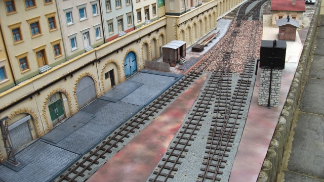

To finish up before the worst of the weather, some more areas around the Station Yard area were covered in Foamboard sheets. Mostly only 2 mm thick, this material was obtained as scrap from a local signmaker. Hammered with a small bit of paving stone to put random dents over the surface and then just a few passes with different coloured spray cans to tone the colour down a bit.. Adding a couple Locating Bases for the Water Tower and Coal Stage - these are not at left out at present, but then we have no Steam Locomotive on the FBGR roster at this time.
We have started to do some ballasting, not bad £10 for three 10kg bags from Mole. It has to be washed before spreading and is fixed down with diluted PVC.
With Winter now upon us, the completion of the Ballasting will have to wait for the Spring, and in the meantime, I have been looking at the state of some of the Fence Buildings and Retaining Wall, and will start to take them home, one or two at a time, for repair/refurbishment and repainting.

The ballast make such a difference and completes the picture. Certainly the weather is not the best for attempting this job but it will be worth waiting for Spring so you can continue.
Great pictures looking along the length of your railway, the structures set the scene beautifully.
