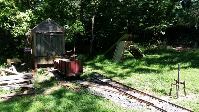

View of the turnout with siding, shed, the two carts and plenty of junk.

If only I had the room. I do like what you're doing there as I find I am getting more and more drawn to the industrial side of railways. Keep the progress pictures coming and good luck with the loco.

I actually loved the picture of the points you made that you didn't post up on here, really impressed with them. Cracking work and well done :D

Fantastic; how green am I?
When I looked at the first two pics, it didn't immediately register what I was looking at, it wasn't until I looked the 3rd one, the wagon in the shed, that I realised that I was looking at a 'real' railway! Good luck with the loco project - looking very business like already.

Took some updated photos showing the switch in detail. The points are made of simple angle iron, and the frog joint is just bent out of the rail, not cast or anything.
These pictures also give a better look at how the track is actually put together.
Turnout with lever in the foreground:
The points and linking bar beneath:
From downhill side, showing the frog joint and guard rails:
