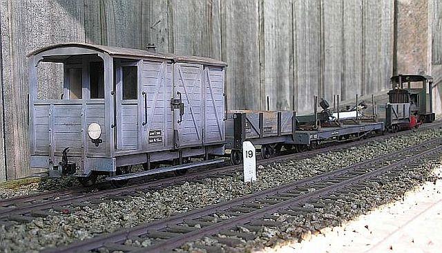

As the S&T branch had "mislaid" the blueprints, they had to get the other signal to complete new drawings, and build the new one. :lol:
After a little bit of maintenance the signal was returned to its place via a flat wagon on an S&T special working requiring full line occupation for the afternoon.

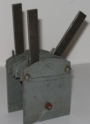

Post by LNR » Fri Jun 10, 2016 10:35 am
Finally got the lenses cut and glued into the spectacle frames, and a chain wheel at the base for the control wire.
Tonight my fingers, hands, and back are aching from hacksawing, milling, and filing the necessary pieces to fabricate the lever frame. Because McKenzie Holland levers have a bend at quadrant plate level to allow the levers to stand vertically when normal, the blanks had to be cut out of a large piece of 1/8th M.S. plate. The lever blanks have the tongue on the front for the release tangs, to be fitted before shaping the final lever. A curved plate will sit between the levers.

No wonder everything about you aches Grant, that is great work and clearly labour intensive.
My brain would be included in the list of aches if I was asked to produce something like that, and then I would give up!!!!

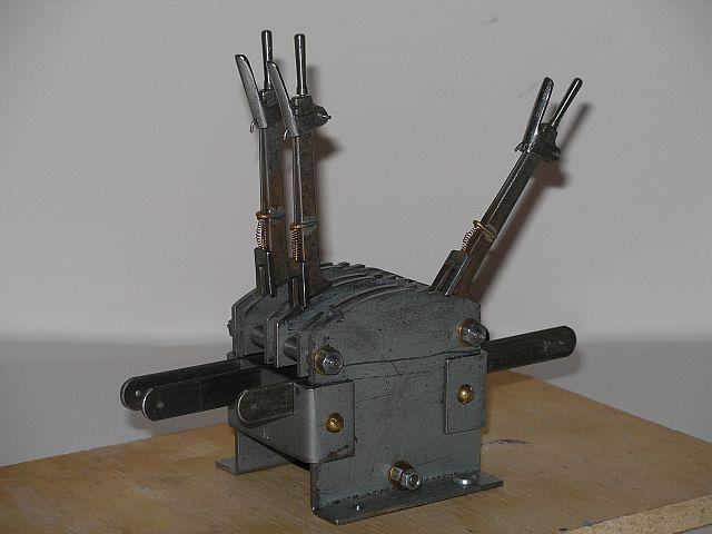

Post by LNR » Mon Jun 13, 2016 12:15 pm
Starting to look a little more like signal levers tonight.
Now for the fiddly bits.

LNR:118507 wrote: Now for the fiddly bits.
Good heavens! I thought the bits you had already done looked fiddly!!! :)
Wonderful stuff
Rob

Except for the curved plates between the levers, I think the frame is finished now and ready to paint.
It was to be two reds, and a black lever, but looking into the real thing, and checking it with my own situation, I can see certain shortcomings. If situated at the end of the platform as a starting signal, it will be right in the road of me manually controlling any loco out of the platform and through the points onto the main line. So I think it's back to the idea of a home departure signal out near the footbridge, with the lever interlocked with the junction points. I have an idea of Staff Locking it too. Trouble is being chief of everything, once driving an engine out of Leawarra, I can't be there to do much Signal Box work, as I have to change the points and pull the mainline signal off at the ground frame. Compromises, compromises! Shall mull this over while my fingers get some feeling back.

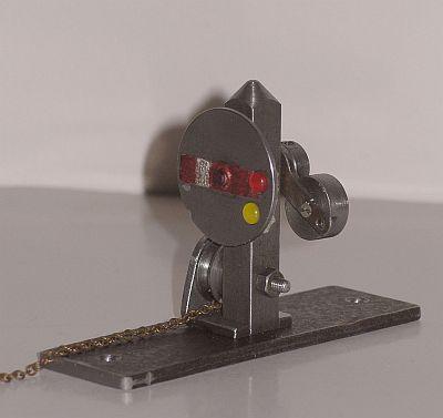

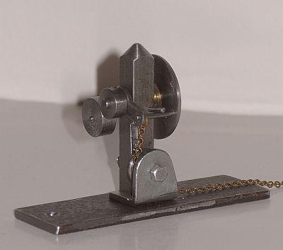

Post by LNR » Tue Jun 21, 2016 9:04 am
Started knocking up a lower quadrant two position dwarf signal today, still to make up a lamp for it (yes I'm aware the lense colours are incorrect, have run out of green LED's ).
Image Image
That's two levers in the frame taken care of, maybe one will have to be white for the moment.
Posts: 6075
Post by philipy » Tue Jun 21, 2016 9:47 am
Beautiful work, Grant. I envy you both the skills and workshop facilities you obviously have.
Posts: 8052
Post by ge_rik » Tue Jun 21, 2016 8:02 pm
...................... Gobsmacked! Lost for words.
All right, found some .......
What wonderful pieces of miniature engineering
Trying to find an emoticon for 'envy' - this is the nearest I could find.
:glasses3:
:envy:
Posts: 1905
Post by LNR » Wed Jun 22, 2016 12:32 am
Thank you both for the nice comments.
Philip, while I couldn't live without a lathe, the work is mostly hacksawing ,filing drilling, tapping and so on. Basically turning bigger pieces of metal into smaller bits.
It keeps me off the streets :lol: :lol:
