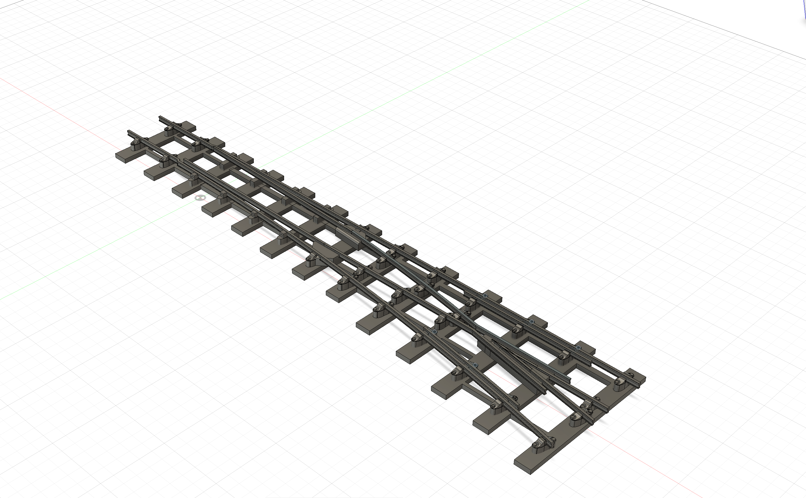

Post by Trevor Thompson » Sun Mar 15, 2026 9:14 pm

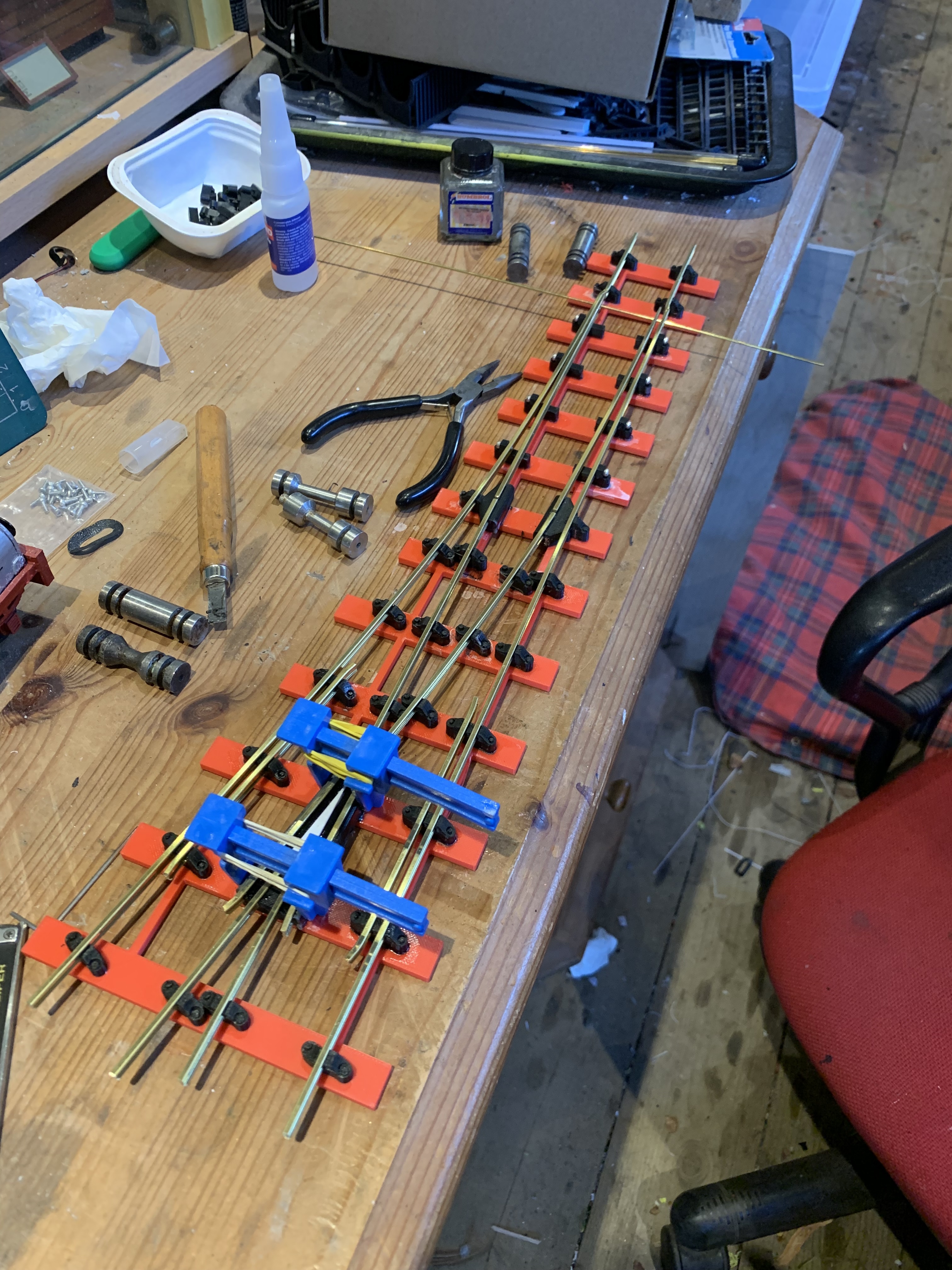

I have a couple of points that sometimes cause problems. Not so much with my stock but with occasional visitors stock. So having decided to replace them I thought it was a good opportunity to experiment.
I have been trying for some time to recreate victorian deep ballasting but the shallow depth of ballast over the sleepers always comes free and falls off. Of course the ballast can also interfere with the operation of the points. So I wondered if using thin sleepers , and deeper chairs would solve both problems. The ballast should be further from the rails, and it might be thick enough to stay put.
So a development of my point design using printed sleepers:
Screenshot 2026-03-06 at 12.03.08.png (1.09 MiB) Viewed 49736 times
The first point with the rails fitted:
The sleepers are printed in two sections. The chairs which support the point blades are printed onto one sleeper unit. The frog unit is printed onto the other sleeper unit. The majority of the chairs are printed as individual chairs, and bonded to the sleepers during assembly (that allows me to use roller gauges to set the gauge accurately).

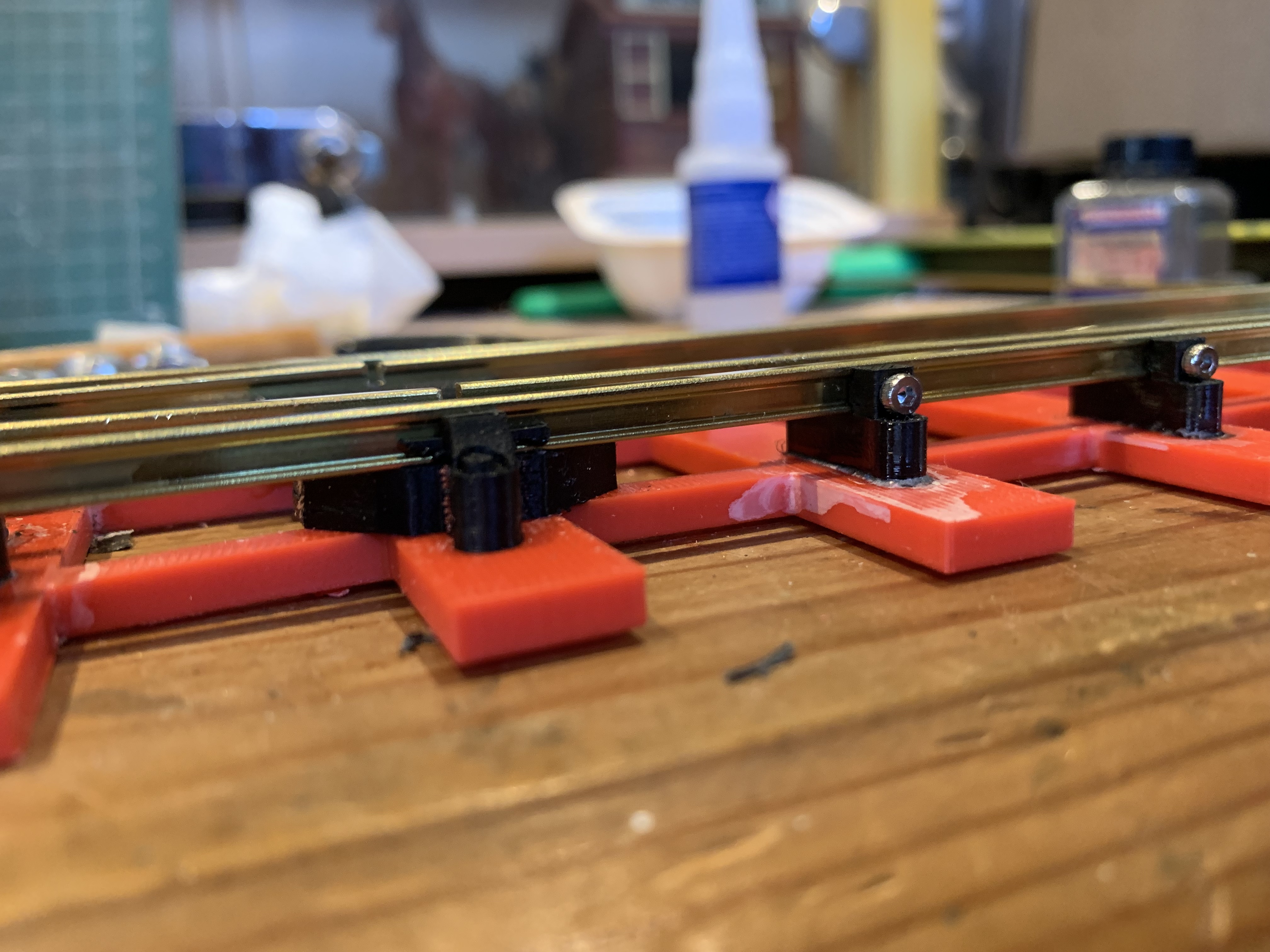

and a view from the side to show how the thicker chairs, and thinner sleepers:
Just need it to stop raining so I can instal it!

Post by Trevor Thompson » Tue Mar 17, 2026 9:34 pm
ge_rik wrote: Mon Mar 16, 2026 7:10 am Ingenious! I like the blue clips, too, Trevor.
The frog unit is in 3 parts. The main part (which holds the rails coming away from the frog) is printed as part of the sleeper unit. The wing rails sit on the outside of this unit and are held to it by two strips which are glued on after fitting the wing rails. The blue clips are holding it all together while the glue sets.
Those clips are really quite useful - as long as I don't accidentally glue them to the workpiece!

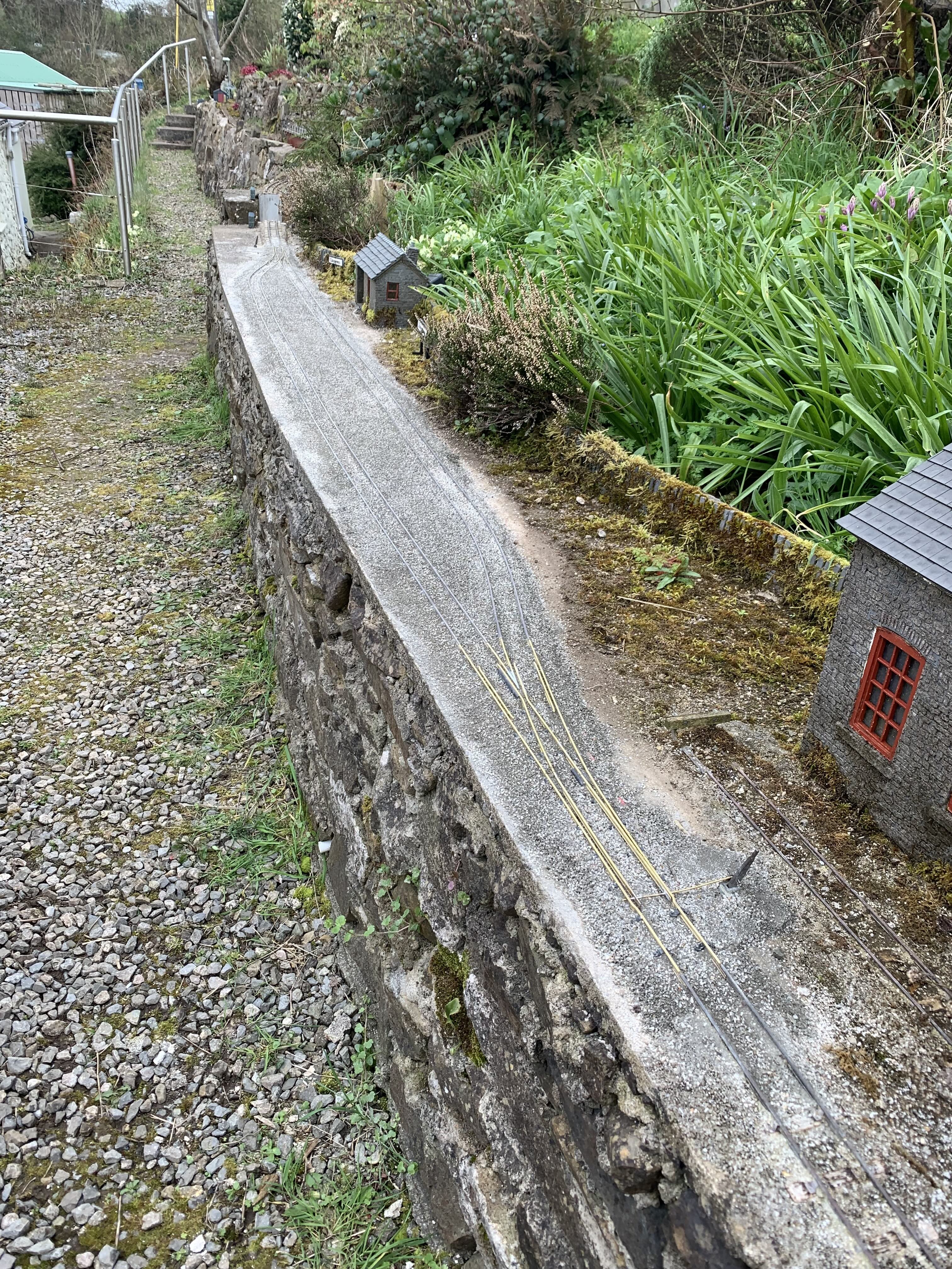

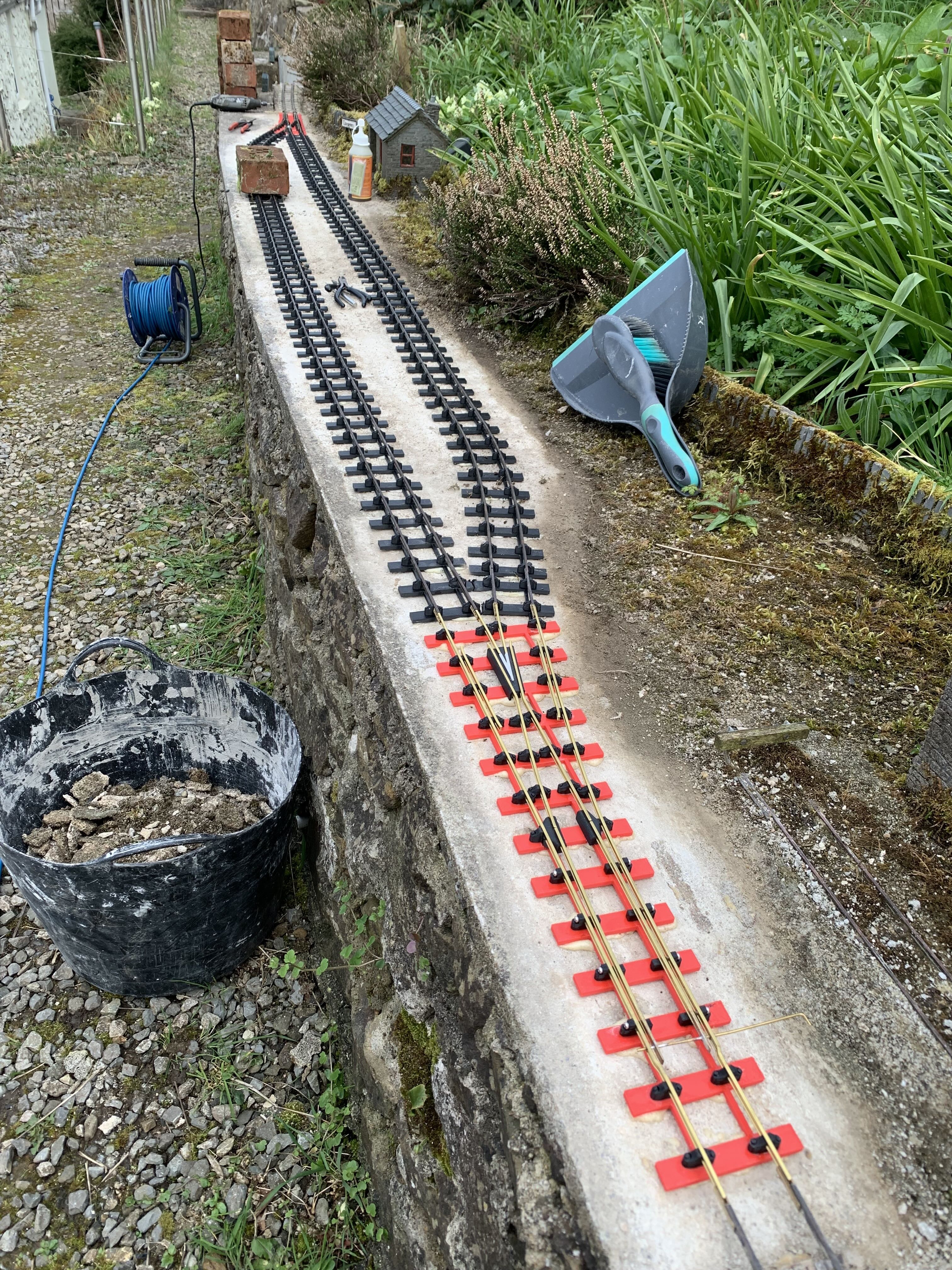

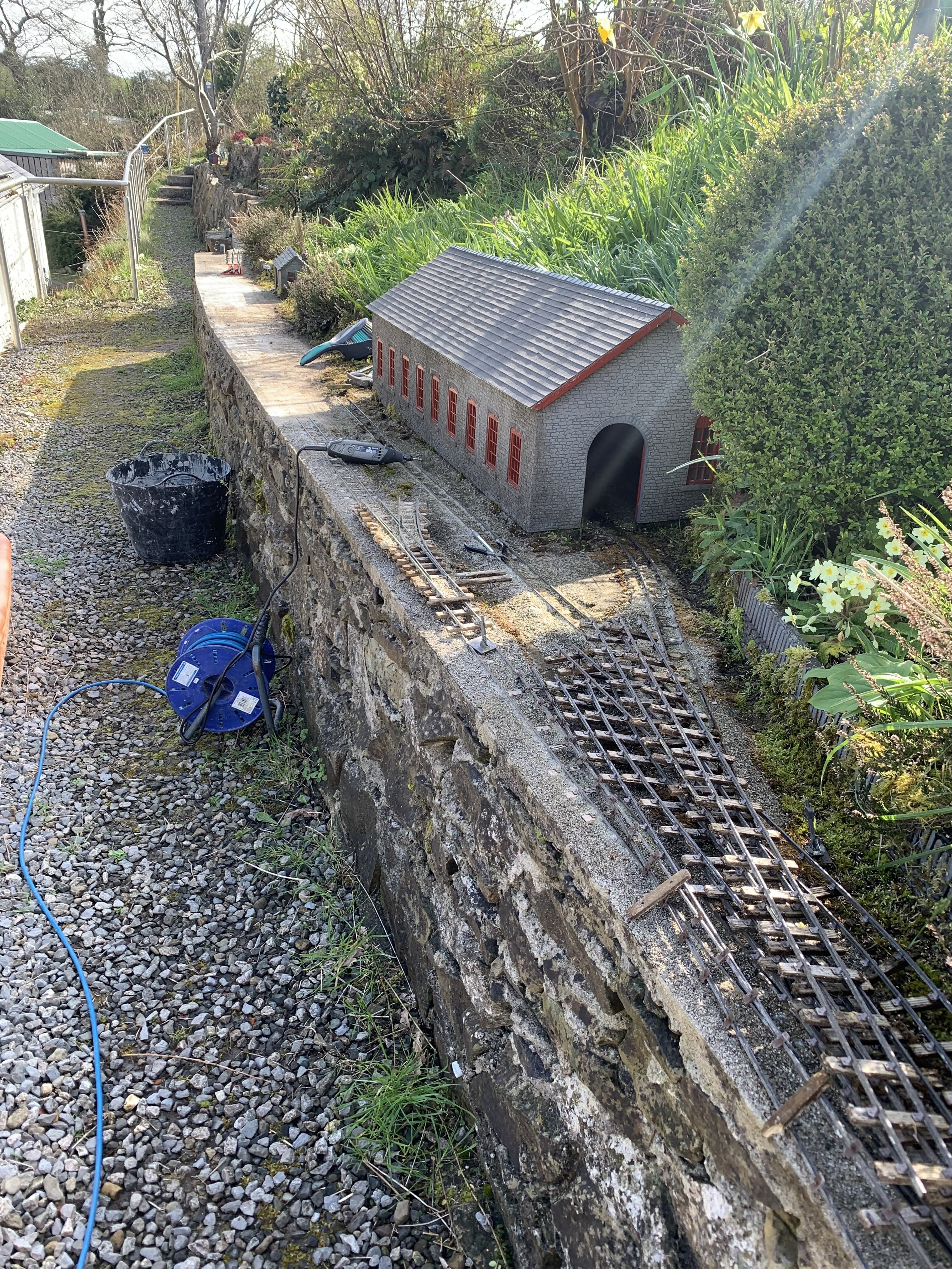

Post by Trevor Thompson » Wed Apr 01, 2026 5:53 pm
I have been able to get away from domestic duties for a few hours, and since it stopped raining over a week ago, I have been sorting out track.
The two points and the station loop removed:
I might try to recover the points for future use, but I can certainly reuse the rail from the lengths of track.
The new in place:
That is the original rail with new printed sleepers with integral chairs slid into place.
and finally ballasted:
The rail is sitting proud of the ballast and the sleepers are well covered, so it may well work as intended!

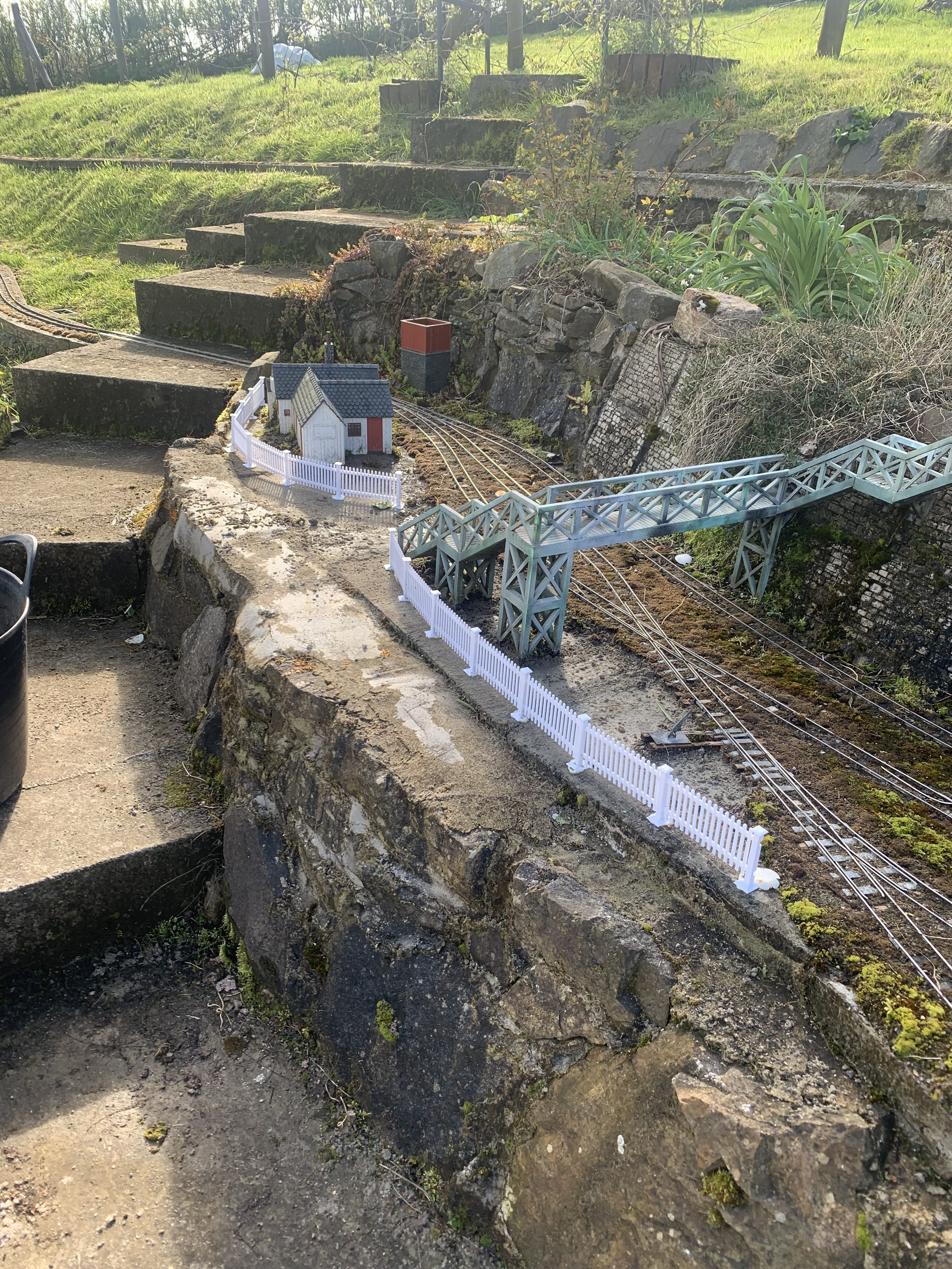

I am working my way up the line sorting out the damage caused during a long wet winter.
Most of the 3 D printed "scenery" - such as buildings - have survived outside since they were built. This station building has been out there for something like 5 years. However the fencing around the station at Tan - y - Bwlch had been damaged by last years heavy crop of apples falling onto it. So it has been redrawn reprinted and relaid:
The files for the fencing will be in the 3 D printing section shortly.
The next task is to finish the railings around the viaduct.
