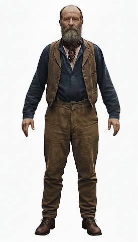

Thanks for the info. I've been doing some playing myself and I'm quite pleased with how far I've got, with your hints to guide me.
After previously not getting very far, thanks to Durley I think I'm now starting to get a handle on the Google Gemini-->Meshy, workflow. So for anyone else who might be struggling, this is what I've done. I'm sure there are other/better ways of doing things so please shout if you know more than me ( not difficult!).
First of all, go to https://gemini.google.com
Then for me, the key clue was starting with the instruction to Gemini to produce a "photo realistic" image. So my initial Prompt was "Please design a photo realistic British Edwardian period workman. Age 50 years, 5feet 9inches tall, with a full beard and going bald. Open neck shirt and neckerchief "
This is what it gave me ( Gemini rendering):
I then told it to remove the spanner ( which I hadn't asked for) and to show his legs and boots. This it did, but the boots were calf-high with trousers ending above them. It looked like it was trying to use Edwardian "huntin' 'n shootin" type boots, so I had to tell it to take those off and replace them. It said it had done it, but actually nothing changed and I had to tell it to remove the boots and replace them, before it did what I wanted.
At this point I then told it to remove the background, which gave me the figure on a plain white background,

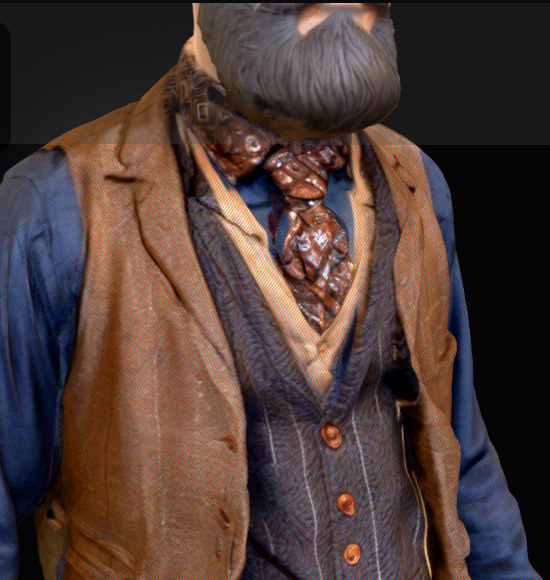

I downloaded this and then uploaded it into Meshy. Meshy currently gives the option of using V6 Preview or earlier 'legacy' versions, so I went for the V6. The rendition was pretty good apart from one thing - it insisted on tying his neckerchief as a collar and tie. It also added what appear to be a second waistcoat and a jumper!! ( Meshy rendering)
Screenshot 2025-09-23 08.18.59.png (605.97 KiB) Viewed 7209 times
Only by going back to Gemini and removing the neckerchief then saving it and importing again could I get him with a simple open neck shirt. I assume that it was getting confused by the beard and neckerchief, somehow.The other minor snag was that Gemini had positioned his hands quite close to his legs so Meshy actually joined them together. Another trip to Gemini to move them slightly and reimport, cured that one.
