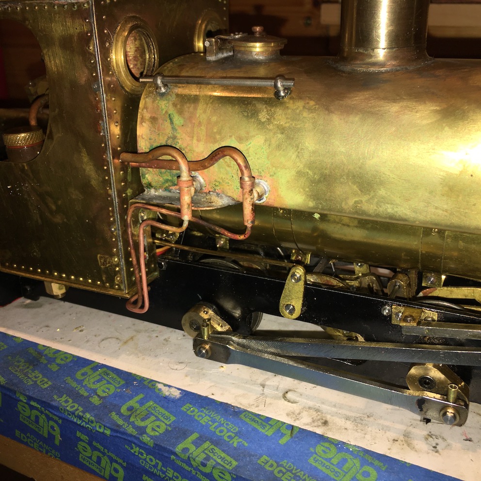

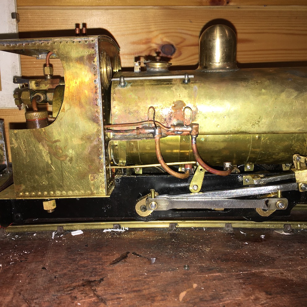

I have been making an attempt at making the injectors on the side of the water tank. I have photos of Linda and I can see that the injectors look nothing like the ones on the drawings for Charles.
It is difficult to make out exactly what and where the pipes actually run. I know how an injector works ( having unsuccessfully tried to make injectors for K1) but that just seems to make the photos more difficult to make out!
So here is my attempt. It doesn't really match the photos but it is a start:
I am sure that you will be able to guide me to better photos - and perhaps even explain what pipes are going where!!!!

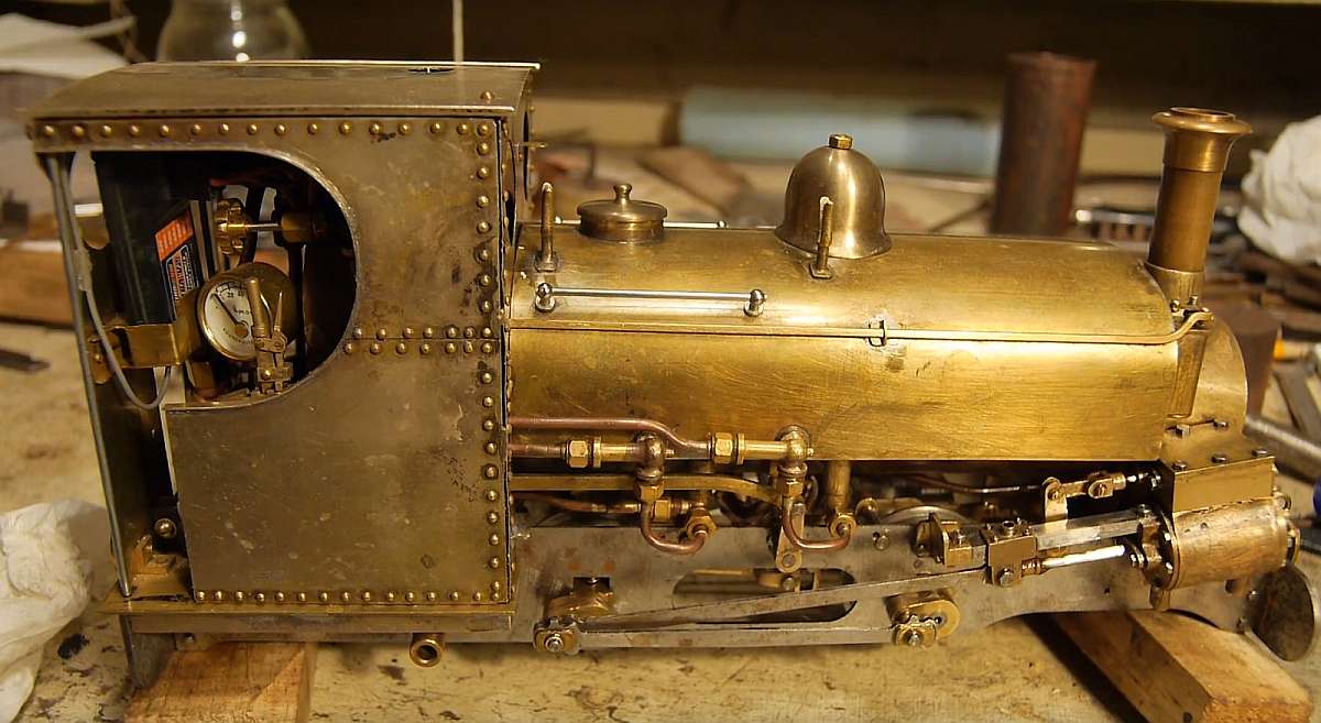

As an inspiration, here is a screen grab from a Youtube video I have linked in one of my previous posts:
don't know how good it is and not sure whether he actually uses if functionally? rather than just cosmetically?

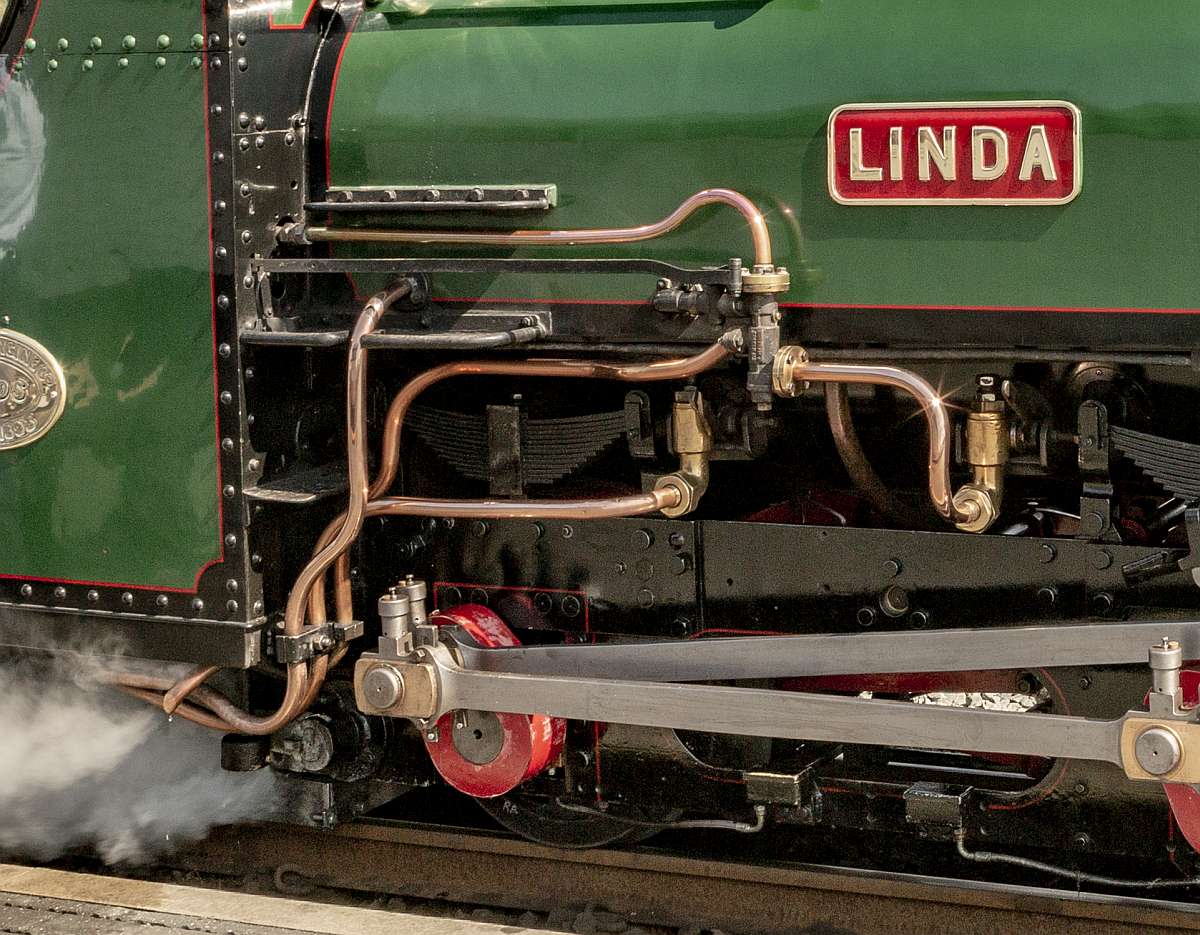

and... here, resonable picture of full size thing:
Would love if someone knowledgeable explained the whole thing to me as well :mrgreen:

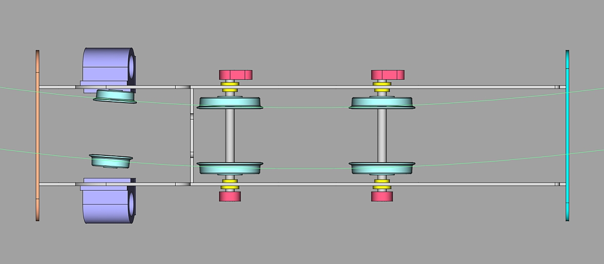

TonyW wrote: Thu Nov 05, 2020 11:14 am ...The tightest curve on the FR main line is Tyler's which, with a radius of 157 feet, works at about 2.5m radius in 16mm/foot scale and larger than the average curve found on most 16mm lines.
I did a bit of 3D CAD modelling to check things, and it would be perfectly feasible to run it on 1.2m (or 4ft) radius.
So not really that extreme? althought I guess something like 1.5m (or 5ft) would be better?
I am not suggesting this for Trevor (as I know he hopes to run on tracks with smaller radius), but for anybody else who is reading and would be interested.
Sorry for the thread creep :mrgreen:

bambuko wrote: Wed Nov 11, 2020 6:07 pm
That is actually interesting. No need to apologise!

bambuko wrote: Wed Nov 11, 2020 5:54 pmWould love if someone knowledgeable explained the whole thing to me as well :mrgreen:
I might know a bit...
Linda as first converted for FR use:
Basically, still in Penrhyn condition with two injectors mounted on the side of the saddle tank.
Your later/current picture shows only one injector (the front one) still remaining on the tank. The back one has gone and has been replaced by a pipe that runs to a larger injector mounted under the cab floor. By flicking some valves this injector can be fed by either the saddle tank or the tender tank. The small one on the tank side only works off the saddle, not surprisingly.
Tony Willmore
bambuko
Posts: 212
Joined: Tue Dec 12, 2017 12:11 am
Location: UK, England, North Devon
Re: 16mm scale "Linda"
Post by bambuko » Wed Nov 11, 2020 7:55 pm
Thank you Tony,
that's very good explanation and helps understanding things a lot :thumbright:
One other thing I have noticed on your photo, is that it seems that in original/Penrhyn condition valve gear lever was on the RH side? (and getting in a way of the piping :P ).
This is reflected in Keith Bucklitch's plans an both Trevor's and Gandy Dancer's (see youtube link in my earlier post) models.
All the photos I have of both ladies in the later/Ffestiniog condition seem to have moved it to LH side?
TonyW
Posts: 1357
Location: North Wales
Post by TonyW » Wed Nov 11, 2020 8:23 pm
The driving position was swapped from the right to the left-hand side in the 1960s ... putting the injectors under the fireman's control for the first time.
Posts: 1202
Location: South West Wales
Post by Trevor Thompson » Wed Nov 11, 2020 9:49 pm
That really explains quite a lot!
I wondered about the driving position and the differences in the reverser gear. I couldn't understand why the plans show the reverser on the right hand side and the photos are the opposite!
Also that explains the injectors. The original situation is as per the drawing for Charles - and I can understand the arrangement (I think). The water comes directly from the tank side. The steam supplies come from the cab where there have to be valves to operate them. The overflows are easy to spot, and the clack valves are in the side of the boiler below the tank.
I might just modify what I have done to fit in with this. Nothing I have made can't be modified!
Thanks

Trevor Thompson wrote: Wed Nov 11, 2020 9:49 pm Also that explains the injectors. The original situation is as per the drawing for Charles - and I can understand the arrangement (I think). The water comes directly from the tank side. The steam supplies come from the cab where there have to be valves to operate them. The overflows are easy to spot, and the clack valves are in the side of the boiler below the tank.
I was wondering where the water valves were, but close inspection of Tony's photo shows they are part of the fitting where the injectors are connected to the saddle tank. The water control rods can just be seen running back into the cab.
TonyW
Posts: 1357
Post by TonyW » Thu Nov 12, 2020 3:55 pm
At that time, they were standard Hunslet injectors. The water valve is actually part of the injector body and is no more than a taper plug with a cross hole. I won't post an image link but you can see exactly the same type of injector on Lilla here: https://upload.wikimedia.org/wikipedia/ ... t_2011.jpg
Click on the image to make it bigger.

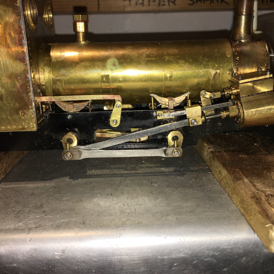

Post by Trevor Thompson » Fri Nov 13, 2020 9:00 pm
While I am waiting for some fine copper mesh for a gas filter to arrive I am adding the details. The bits I missed off - while I prioritised getting a working loco. I have modified and remade the dummy injectors and their associated piping. This is a bit more like the prototype:
I am going to have to change the reach rod to make it a bit more realistic. The rear injector pipe and clack valve are preventing the reach rod moving properly. Also I think the bit of bent brass rod is flexing as the servo arm moves, resulting in lost travel, and I think that might be why changing from ahead to astern doesn't quite work half of the time. So two reasons to modify it. That is a job for tomorrow!
The only other detail which I know I missed off are the dummy springs. So while I am working in that area I will make springs and fit them. I have four top leaves left over from K1 - so there is a starting point. Instead of the working springs on K1 these will be dummies!

Post by Trevor Thompson » Sun Nov 15, 2020 6:23 pm
A start on the springs. One spring assembled and another three as blank spring leafs. I made the centre piece by milling some hex rod. Yet to add the rods which on the real thing connect to the chassis. In this case the centre of the spring will be bolted behind the chassis.
