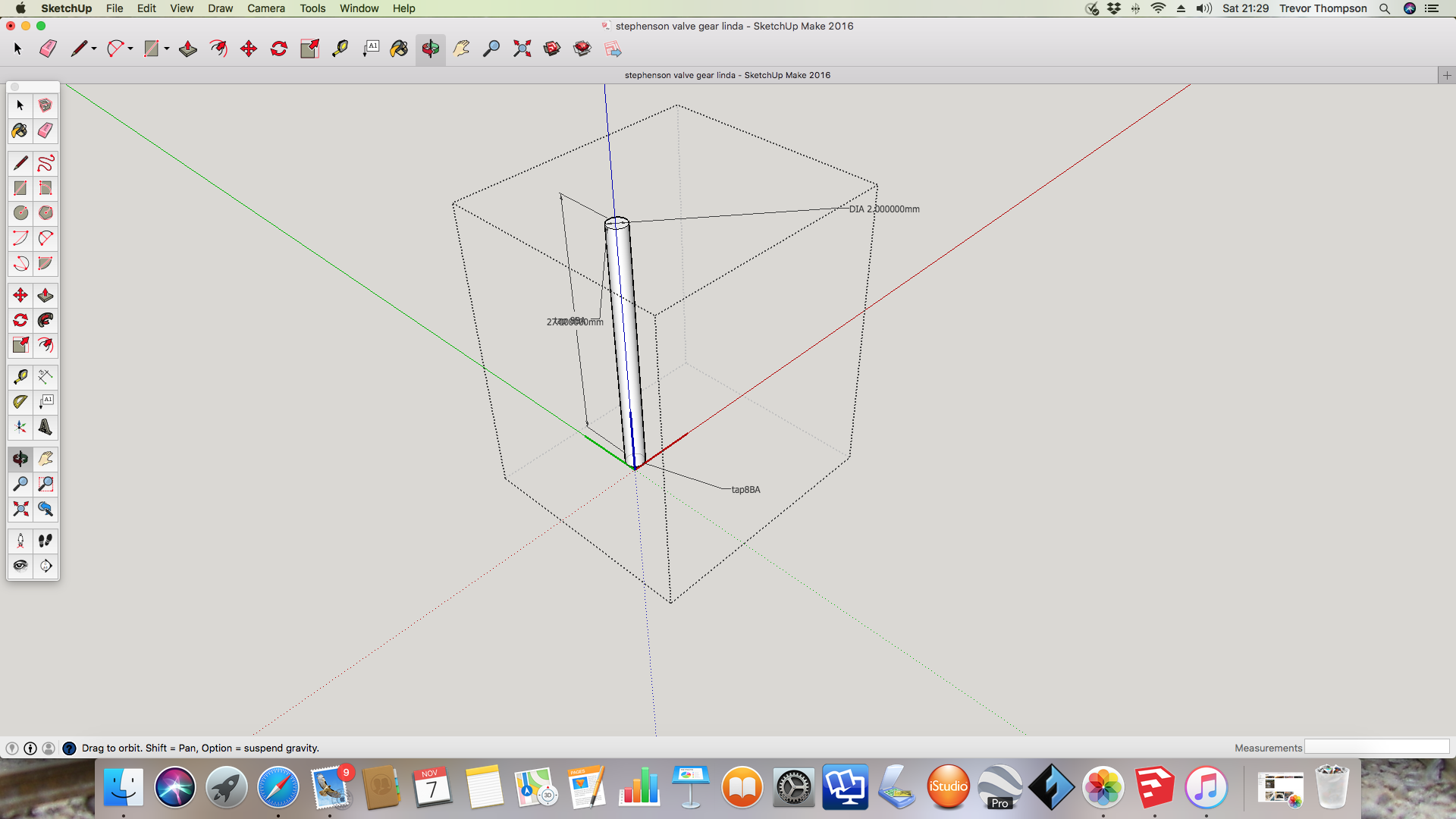

So I am not the only one who struggled with his software. I keep putting in the relevant dimensions for my attempts at valve gear and it always seems to end up off the screen!
So it isn't a matter of being thick!

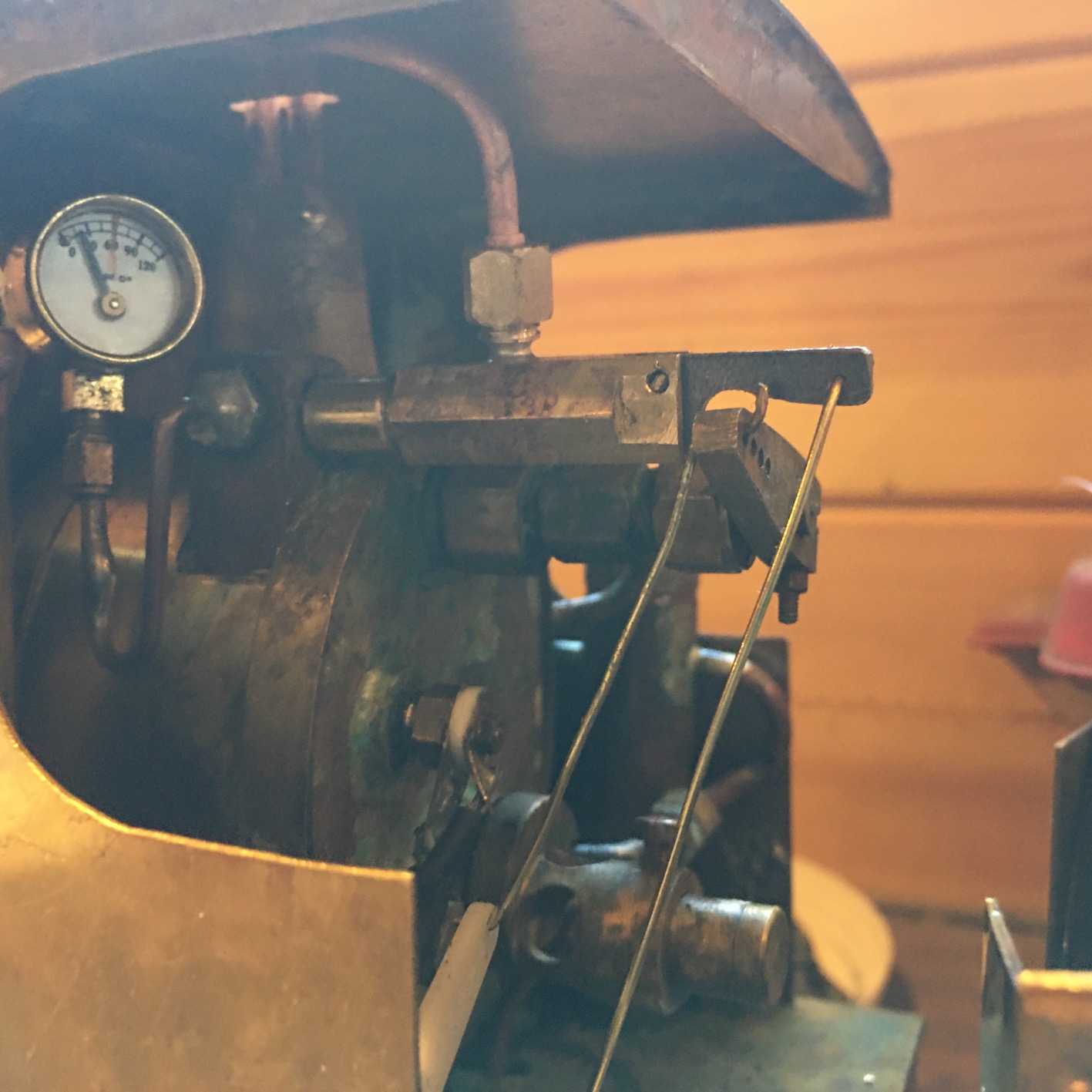

I have made the steam whistle described in "Steam trains in your garden". Two out of three attempts worked.
I tried the whistle valve from the same book using an M5 tap as suggested in the text but repeatedly failed to get the tyre valve to seat. So I changed the design to make the valve body in two parts, screwed together (M6 threads). That enabled me to make the seat for the rubber seal more accurately ( with a centre drill) and wedging the valve into position between the two parts. That worked. So a whistle and valve:
and the valve in position on Linda:
It is a bit of an odd end result. I had already fixed the servo for the whistle under the cab floor, and the whistle valve was longer than I anticipated, which resulted in having to cut away the underneath of the operating arm to avoid it hitting the regulator when it was closed. I could have rotated the regulator - but i am reluctant to move things that work as they are. Anyway the regulator and the whistle all work like this!

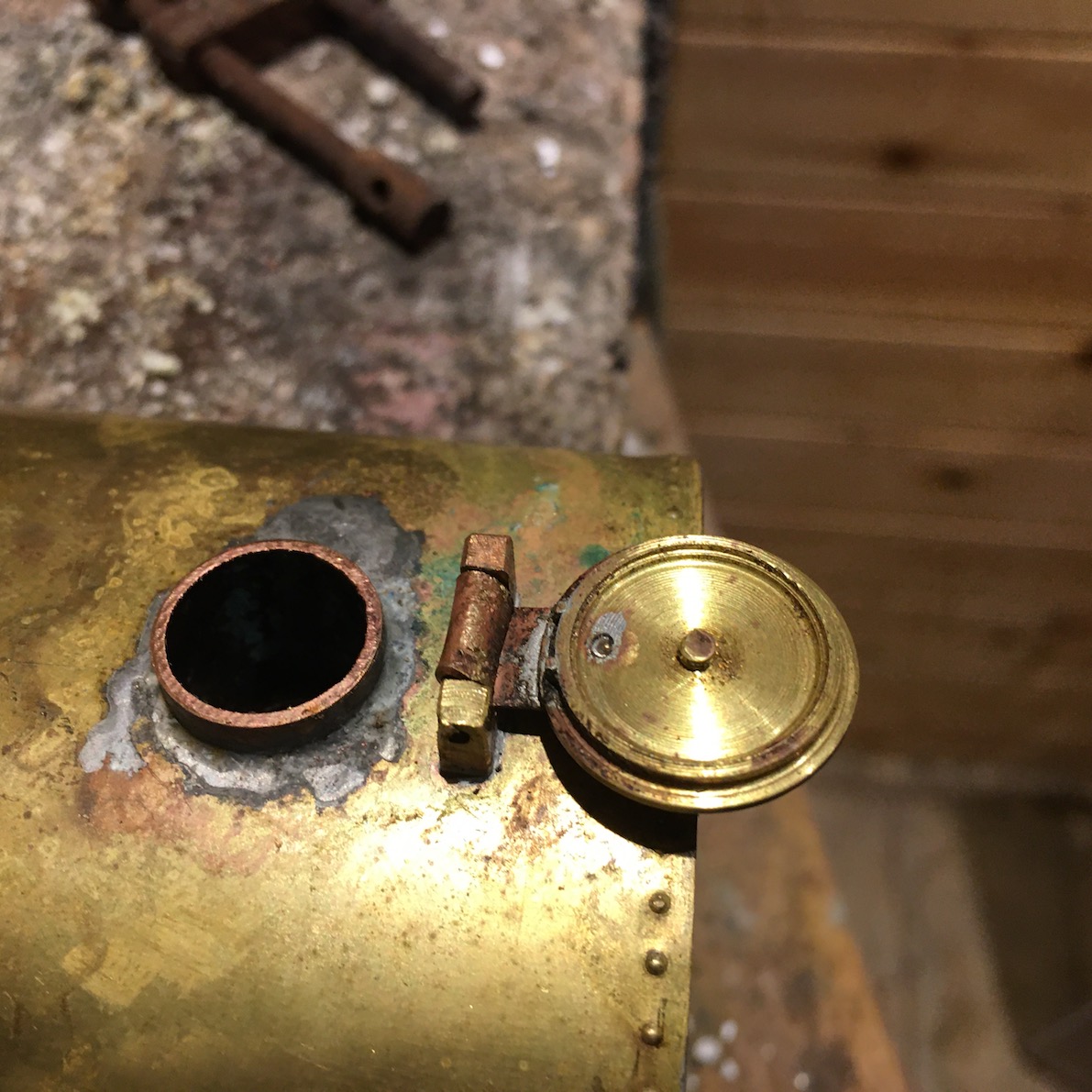

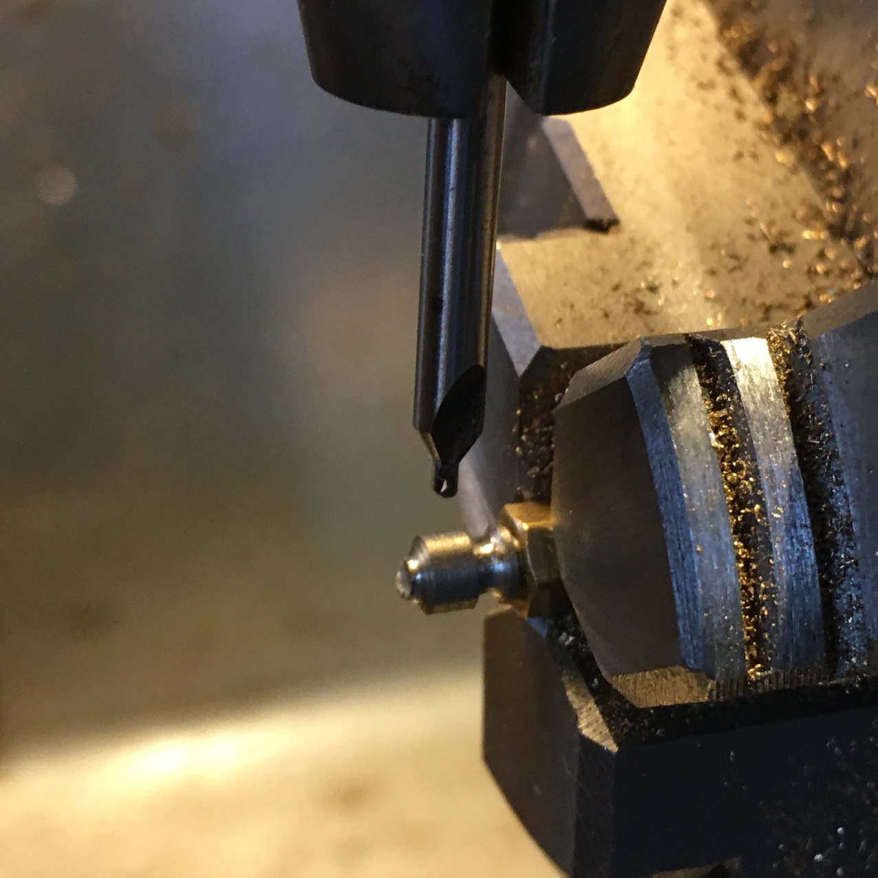

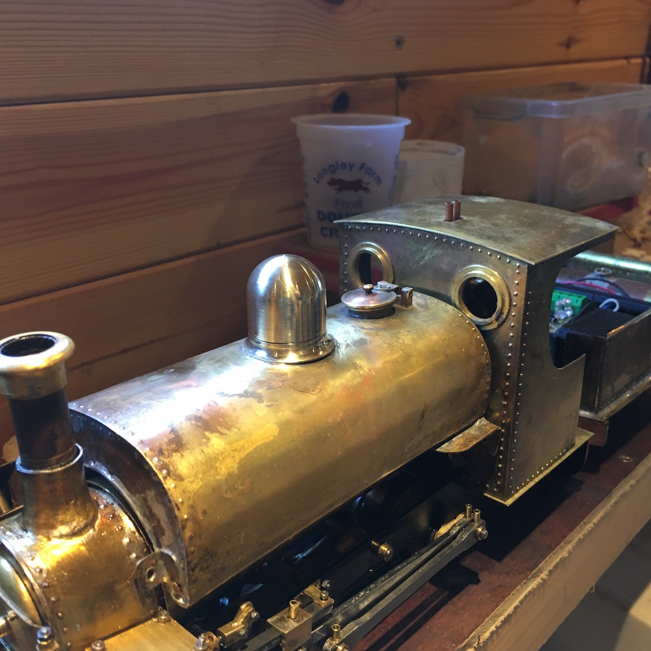

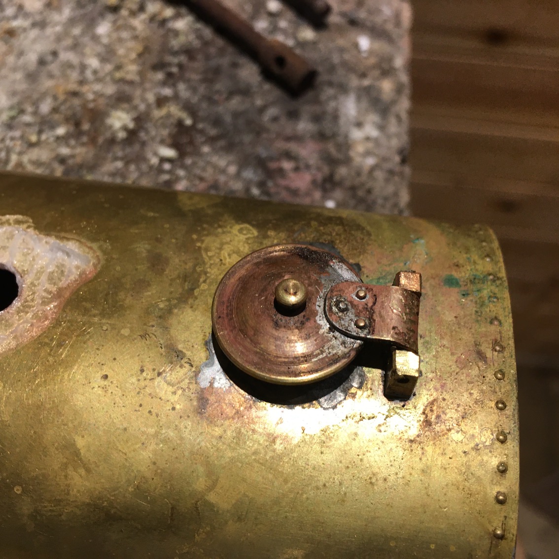

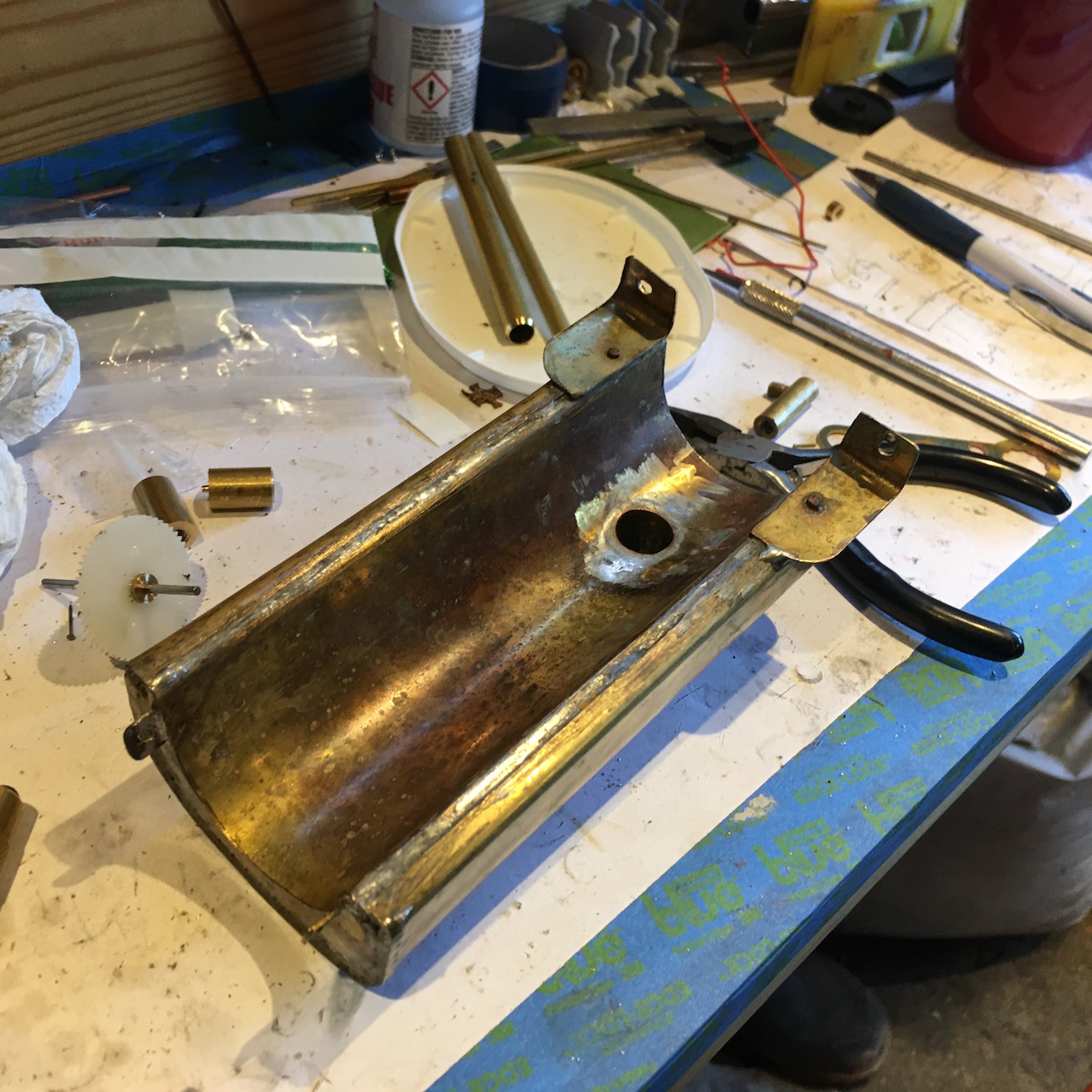

I have been working on the water tank. Adding the details. I didn't make the water tank to the drawing - I actually made it so that it had a bottom and would hold water if I decide to fit an axle driven water pump. The cam to drive it is already there so it might happen. The underside of the tank:
Firstly the filler lid : I shortened the filler valve so it didn't poke out of the hole.

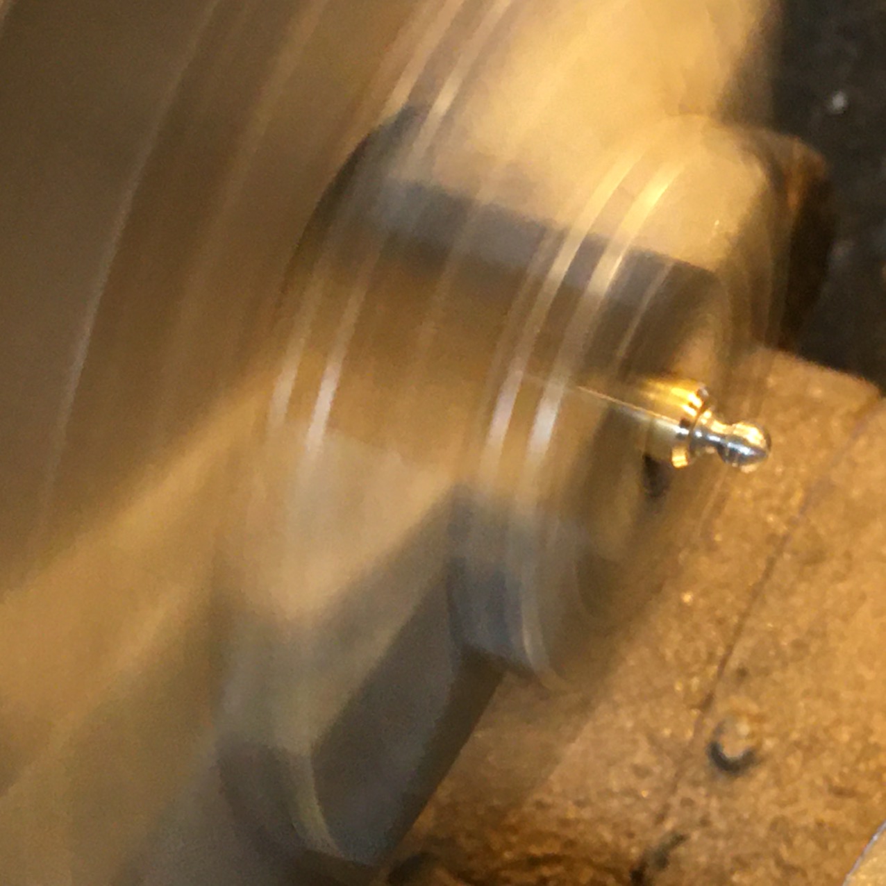

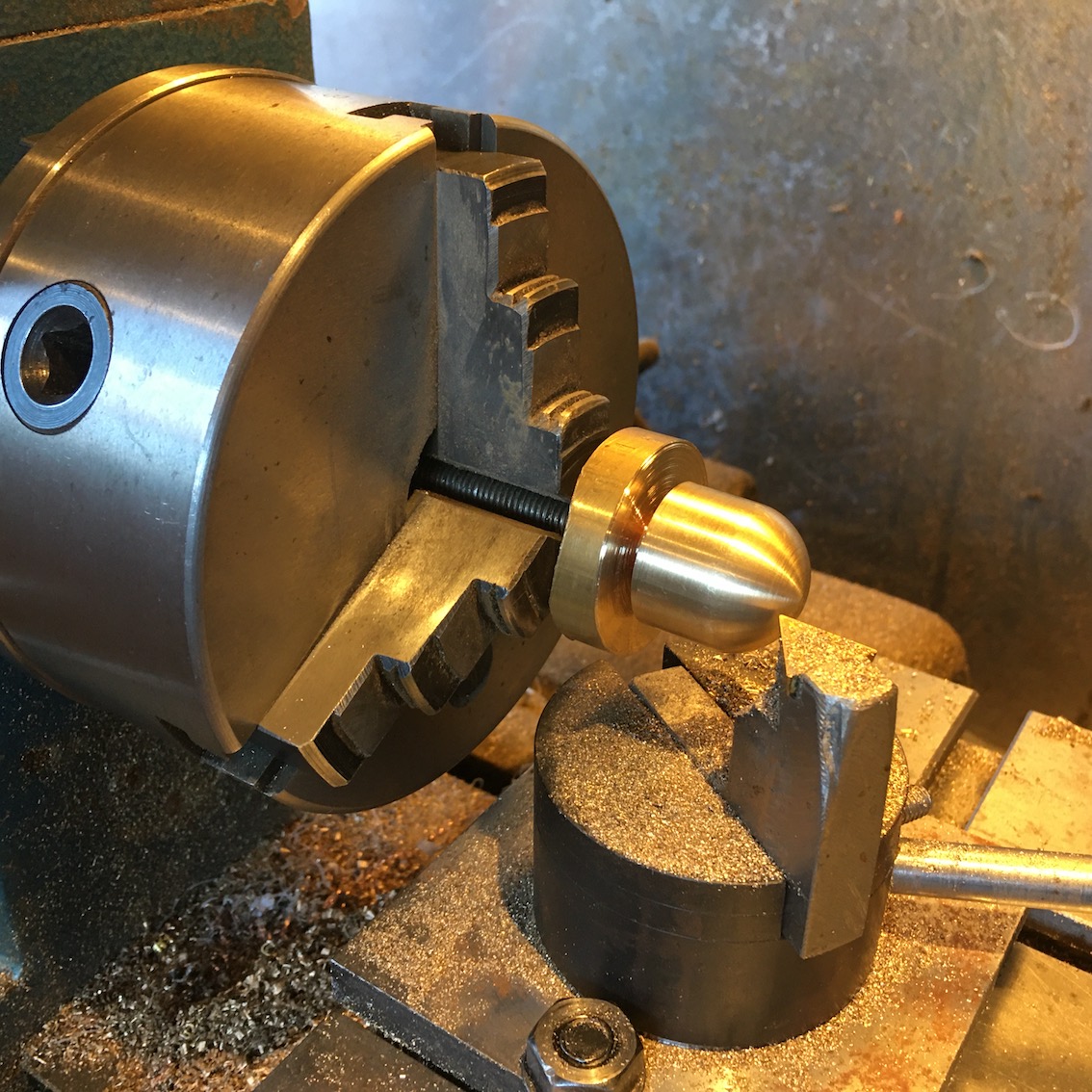

and the dome. This is my home made ball turning tool, which I used to make it:
As the tank might hold water and the real tank filler already has a filler valve poking through it, I made the dome in two parts, so the top part can unscrew to fill the real tank. So the lower section soldered to the tank:
and the top section with a length of M8 studding in it (the studding was used to hold the dome in the chuck far enough away from the chuck to allow the ball attachment to work) In the background you can see the weir pump from K1 awaiting modification.: and finally the water tank back on the loco:
Handrails and dummy injectors yet to be made.

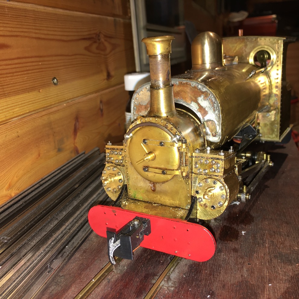

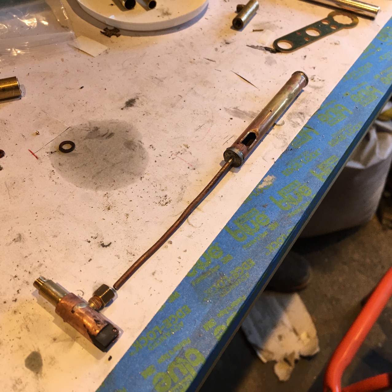

Todays progress is limited. I spent most of it repeatedly dismantling the burner and cleaning the jet!

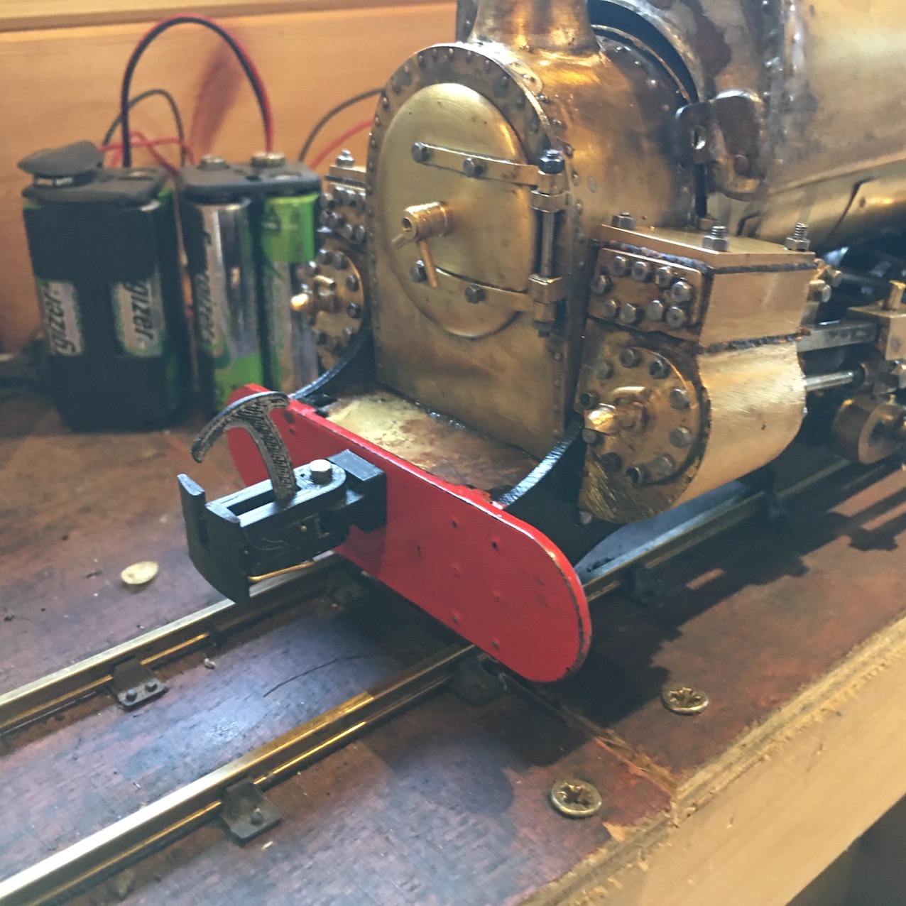

Anyway I have fitted the 3 d printed couplings with a view to running outside with a train in tow:
I wondered if the problem with the jet was the rubber hose which connects tender to loco. I replaced it. No change. So I now think it is the new gas which I got from screwfix. I emptied the tank and cleaned the jet yet again. So need to get a gas canister from a different source to check if that makes a difference.
As an aside I can confirm that the rubber hose takes the full gas pressure even with a blocked jet, and with a propane/butane mix.
Anyone else had problems with dirt in gas?
Back to drawing up the valve gear.

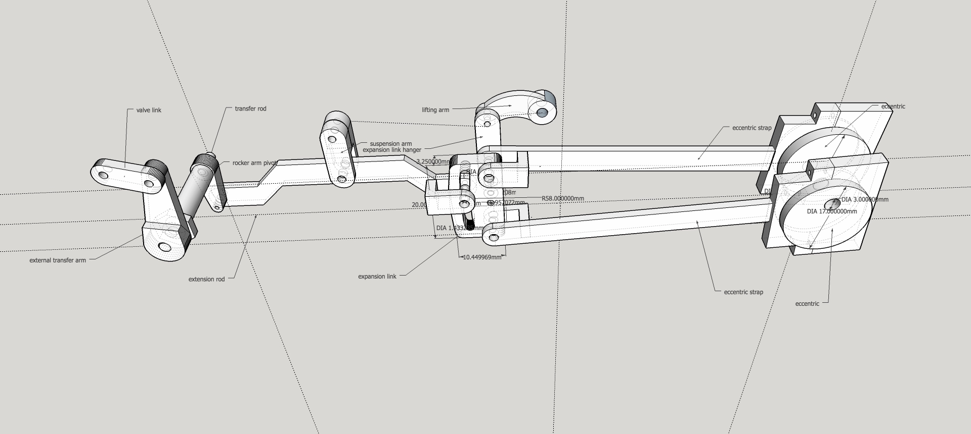

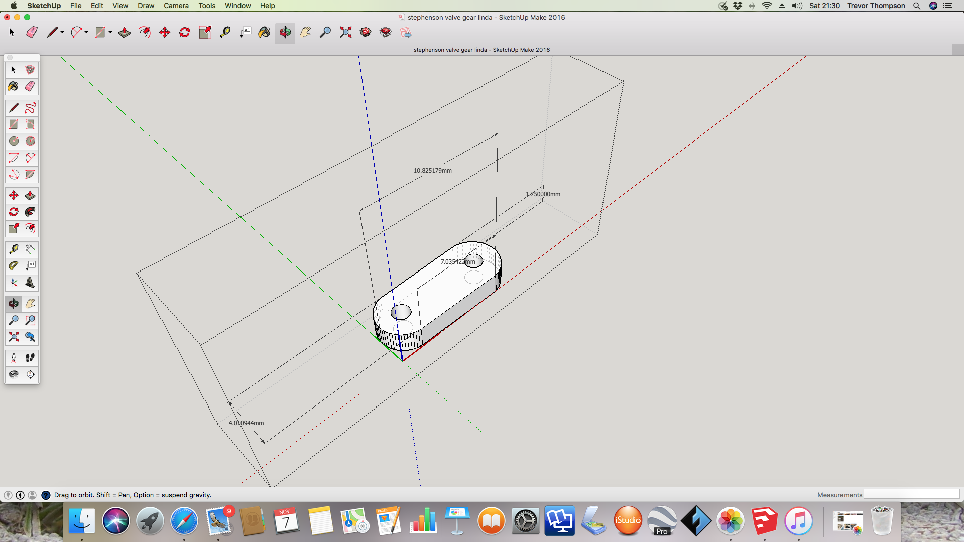

some drawings for the valve gear as requested:
Firstly a general arrangement to name all of the parts and show where they fit together. This is for one cylinder of course. The same things are repeated for the other cylinder and the eccentrics are 90 displaced from this set.
Individual component drawings follow
- Posts: 1202
- Location: South West Wales
Re: 16mm scale "Linda"

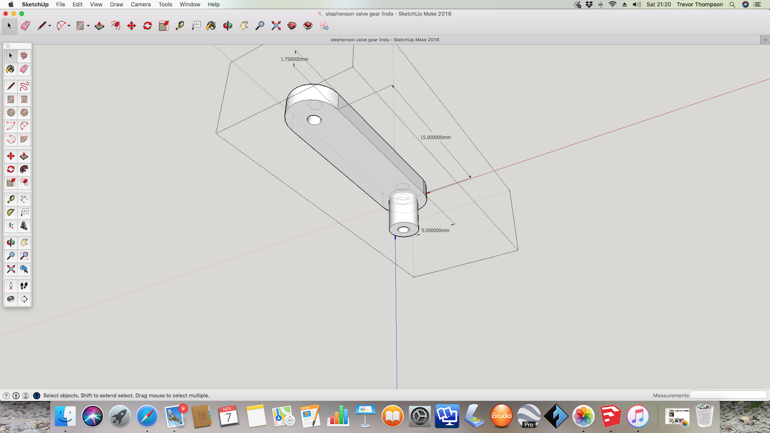

The eccentric:
The centre for the axle is offset from the centre of the eccentric by 3.5mm.

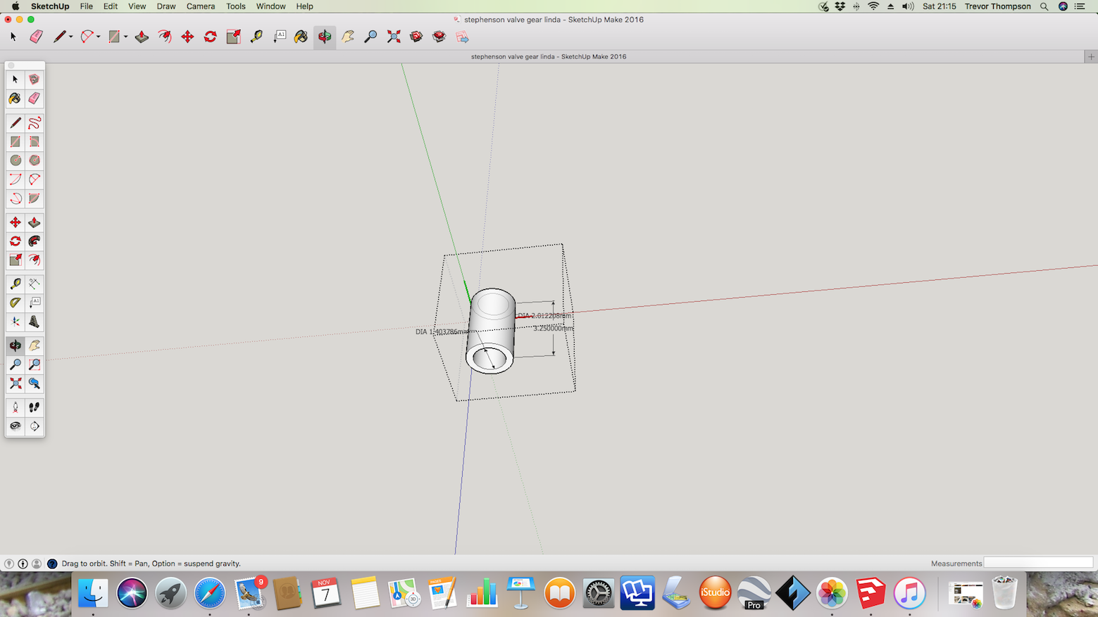

The eccentric strap:
- Posts: 1202

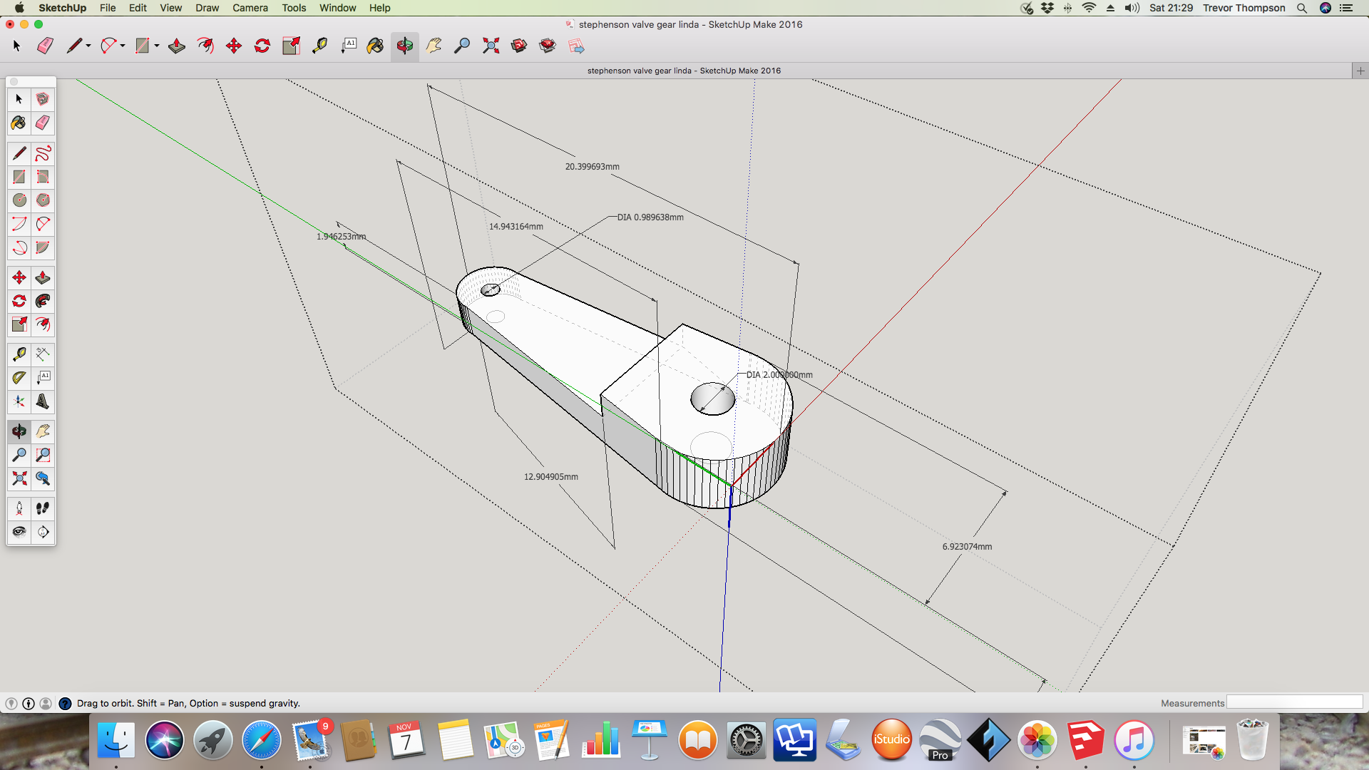

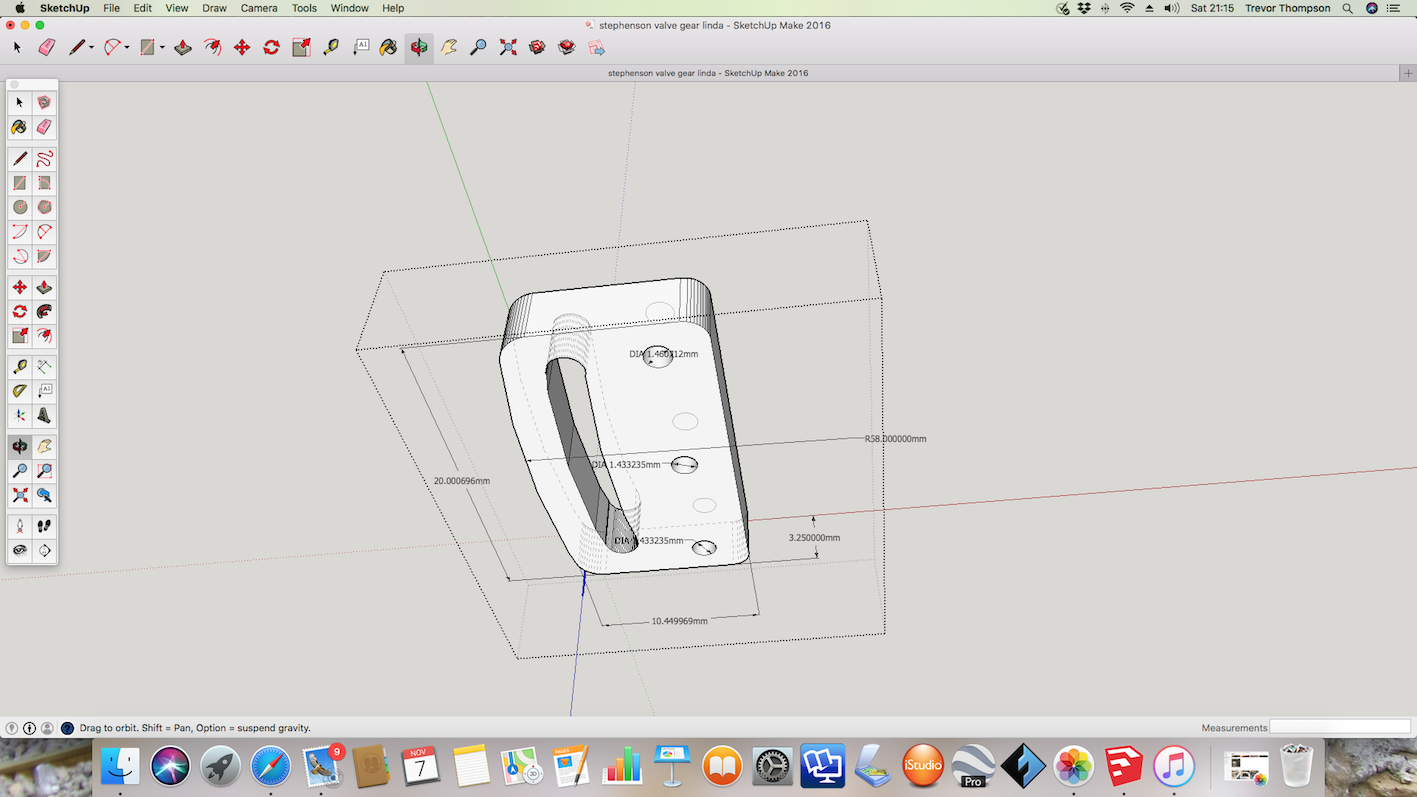

Expansion link:
and die block:
and die block:

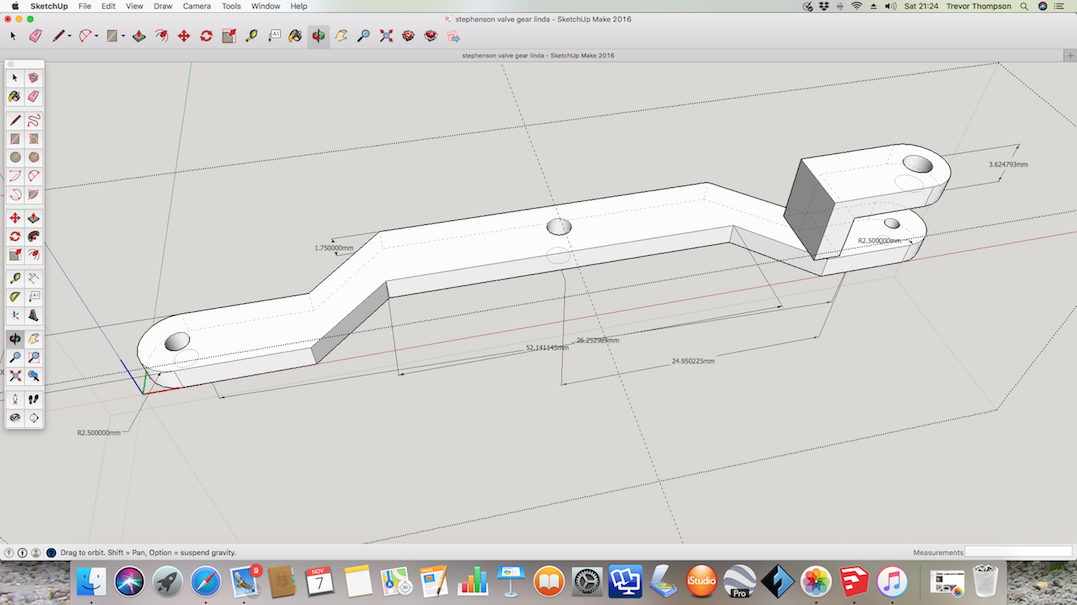

link block hanger:
and extension rod:
and extension rod:

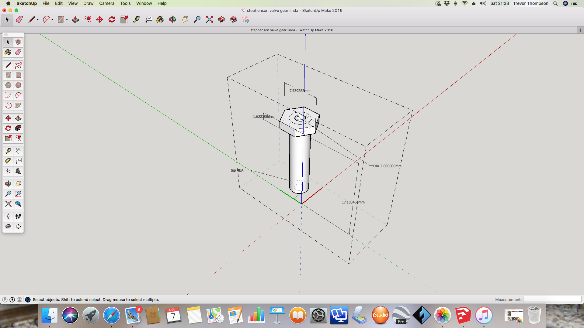

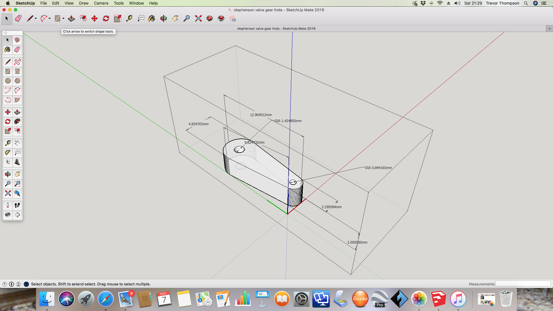

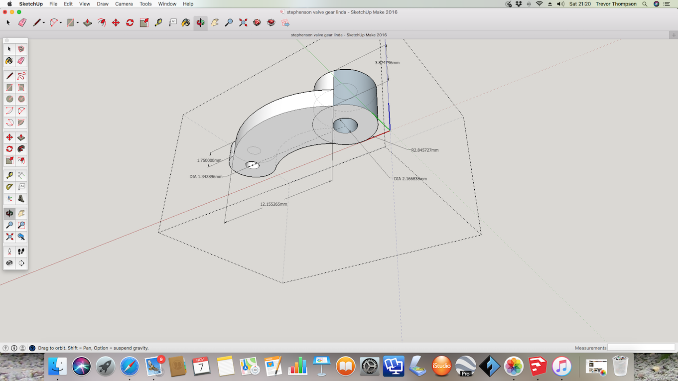

Some notes on the valve gear. All the pivot points are tapped 10BA and pivot on 10BA bolts. Where possible lock with a 10 BA nut. The only exception to that is the rocker arm where both ends are tapped 8BA. Each end will move if it isn't pinned. The outer end is permanent - the inner can be dismantled. I use 10 BA bolts with 11BA heads throughout.
I hope that the dimensions are readable. Having drawn it in sketch I then had difficulty exporting it without catching loads of unwanted dimensions - which is why I ended up with screenshots. If the original sketch file is of use I can post that as well.

Thank you for posting details of your gear.
With the exception of extension rod, which is a bit challenging (but still usable) all of the drawings attached are perfect.
One immediate question is about eccentric.
I am assuming that 3mm dia hole for axle is not quite what it is in reality?
I will have more deatiled look at it and come back if I have any questions.
BTW - I am assuming that steam and exhaust ports in your design are as per Charles of K. B. ?

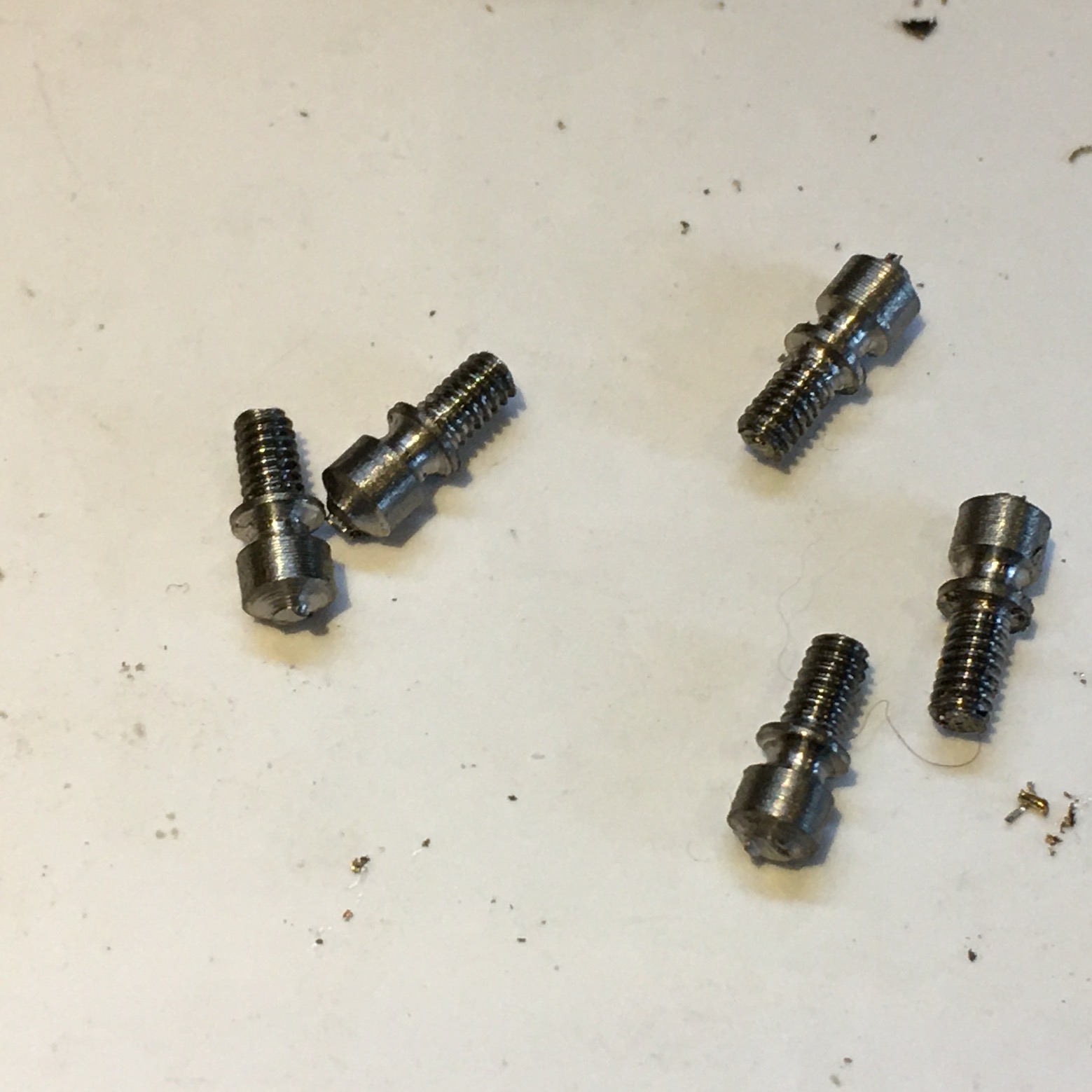

I make my own handrail knobs:
The first stage is to mount stainless rod 4mm diameter in the chuck and turn down the end and tap it 6BA. I then cut a grove either side of where the ball will be created. Then saw the part free, (it is too small to part off reliably) Repeat 6 times:
Next stage is to set up the rotating table and convert the machine to milling form. Centre for the hole and drill 1.5mm:
and back to the lathe and set each one up in a mandril and file to a ball shape. (To small to use the ball turning tool reliably)
And finally after fitting onto Linda. Holes drilled, tapped and the knobs secured with locktight. The one on the smokebox:
