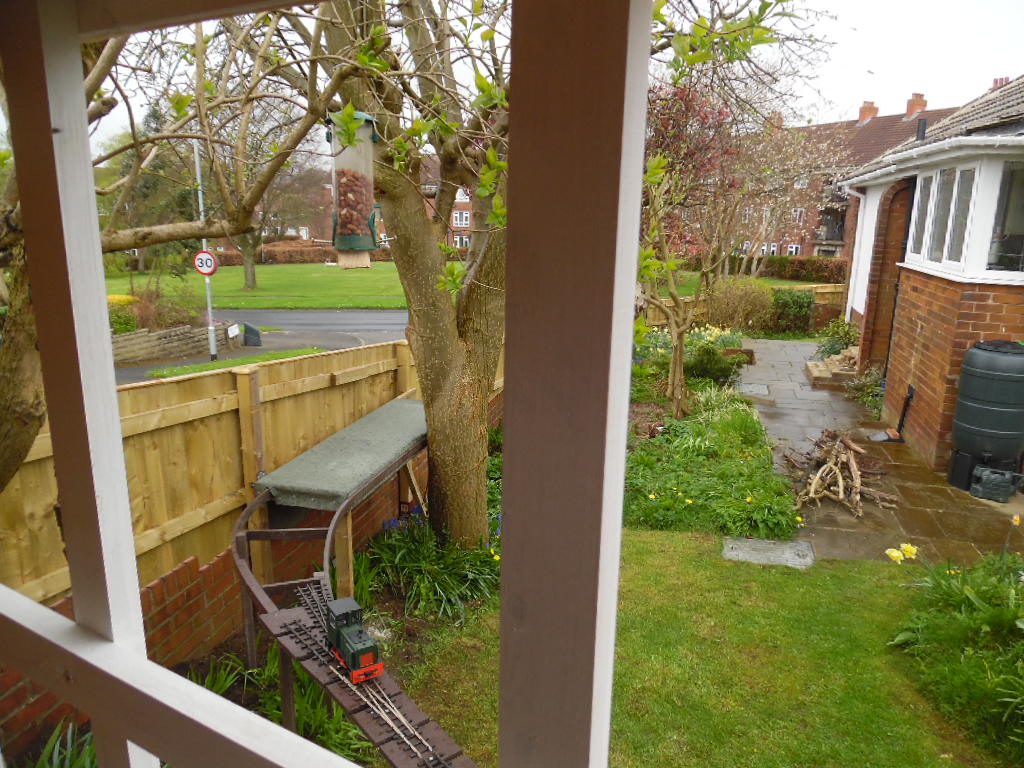

Rain stops play so I'll close with a couple of views from Hollycross Signal Box, where we find the diesel ticking over on the newly laid pointwork, in typical signal box surroundings of bird feeders, wind chimes and rain! It also shows the side garden which I hope to broach with an out and back loop in the future, watch this space.
Looking the other way, all's quiet and still but the flowers add some colour to an otherwise dismal day.

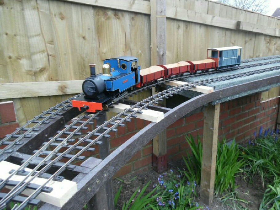

Your track bed construction looks really good. It's clearly been built accurately and carefully and the benefits of that shine through. I'm looking forward to seeing the trains running over it.

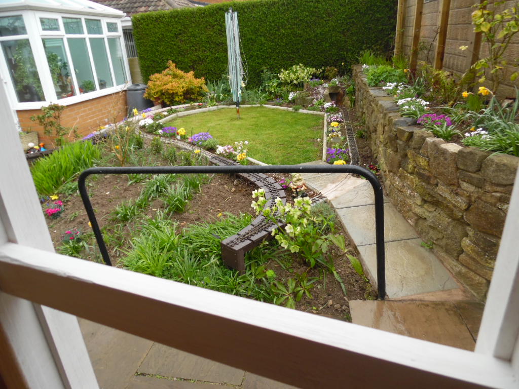

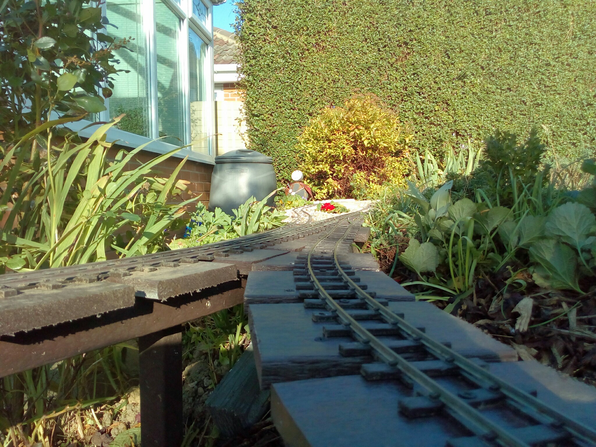

A little further! I need to sort out ordering more Filcris before too long but the lads have cracked on regardless and all 3 roads are connected up and secured on temporary battens. It wont be too much of a job to pop the top deck sections in place, and then re-jig and secure the track at a later date. I may ease the curves a little bit at the same time but will wait for a nice day when I can get a loco in steam and do a few run throughs beforehand. Starting to all come together a bit now, the Gaffer will be pleased!

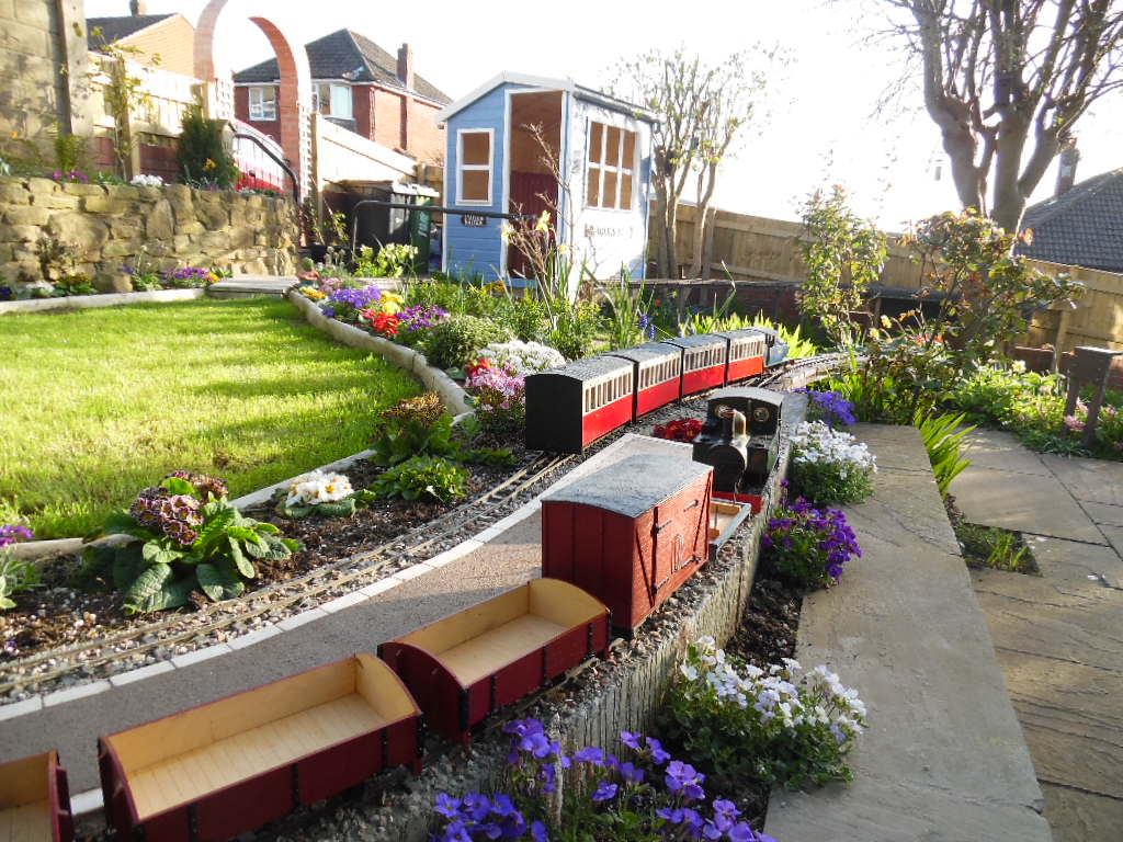

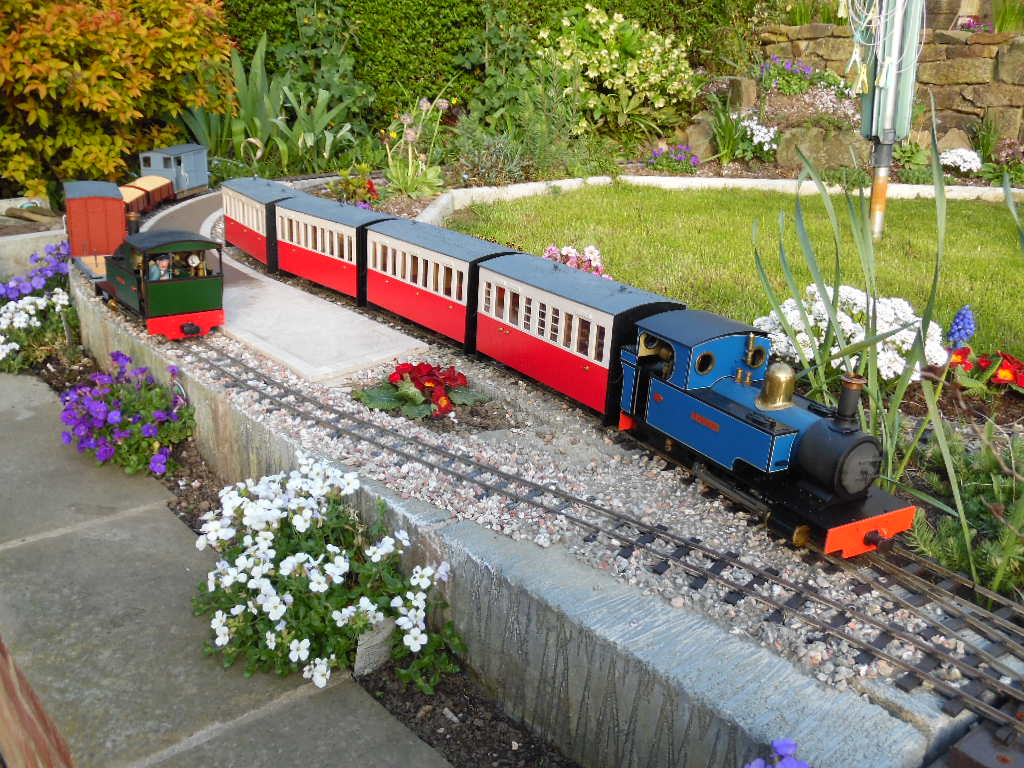

The afternoon Passenger gets underway from the (very) recently laid Hollycross platform, as Albert waits to follow with a Goods train, providing of course he manages to get some pressure up...
Looking the other way, you'll see the recently documented steaming bay and THAT tree in the distance, so get an idea of the general layout of things. Cheers for now!

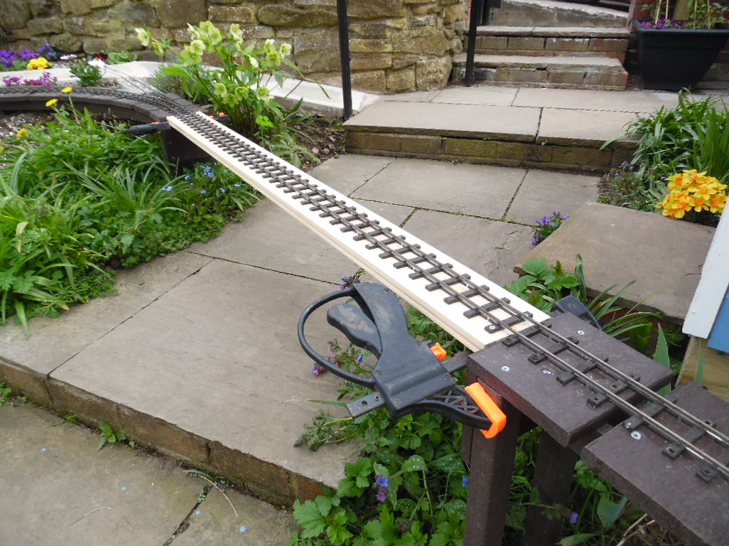

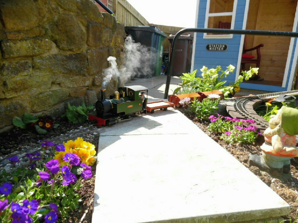

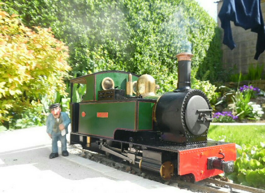

Well, a very bright, sunny day yesterday turned thoughts towards raising steam, so the gap between the two sections was bridged (very!) temporarily to allow NOBBY to have a trundle round with a few wagons. It wasn't long before inquisitive neighbours turned up resulting in an Easter egg! and quite a few free plants for the garden. Nice one!
And guess who had to get in on it all!.....

Even the very temporary bridge looks solid , apart from the clamps that is..

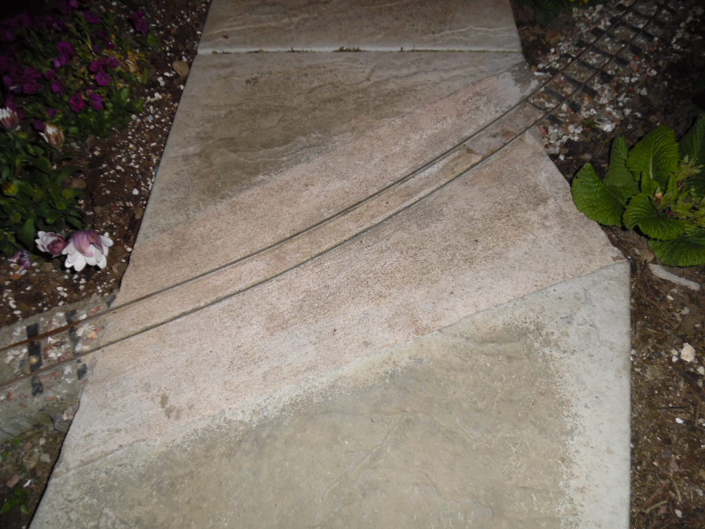

Fantastic! Your line has really become a part of the landscape. I particularly LOVE the shot of the level crossing over the path.
Re: The Hollycross Railway Company!
I like the idea of trains running over a patio.
Have you placed rails inside the channels you have cut in the paving slabs?

As I've said elsewhere, I just tend to get stuck in without too much planning then just 'make it work'! The temporary bridge is a bit of spare floorboarding bought for the roof of the summerhouse I built. It does look a bit precarious but was actually also resting on some screws too so sits quite stable even with the train rattling across it. When I do the bridges 'proper', they'll be a lot more secure! The crossing is shown in the very first photo back on page 1, or at least the relevant breeze block is shown. Then scroll down that page and you'll see that any stones I dug up were thrown either side of it as hardcore for the path that followed. I laid the flags on a sloppy cement base, tapping them down to be 'as near as' level with the track railhead either side. I then simply threw cement into the gap between the flags, covering the track, smoothed it off with the trowel, ran a screwdriver against each rail to form the flangeways, and waited for it to dry off. When it was nearly set, a damp sponge and old paintbrush tidied it up and the result is as seen. Easy really! As the ladies in the BOOTS advert say, Ta Da!!

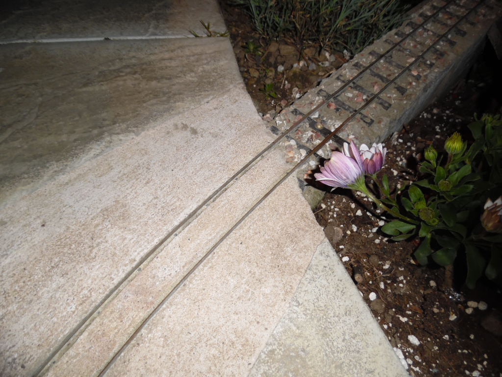

Just nipped out and grabbed a couple of piccies if it helps. The flags are cheapy ones as seen in all garden centres/DIY places. I bought half a dozen, 3 were used in Three Flags Tunnel, self explanatory!!, The others formed the path and crossing, one being cut diagonally with an angle grinder to go either side of the track. You can just make out the chairs which hold the rails in place. I noticed too, that the train actually rumbles as it crosses the path, the wheels crushing any dust that's settled in the flangeways. Brings a tear to me eye it does....

Brilliant, thanks for the pics - I can see what you have done now

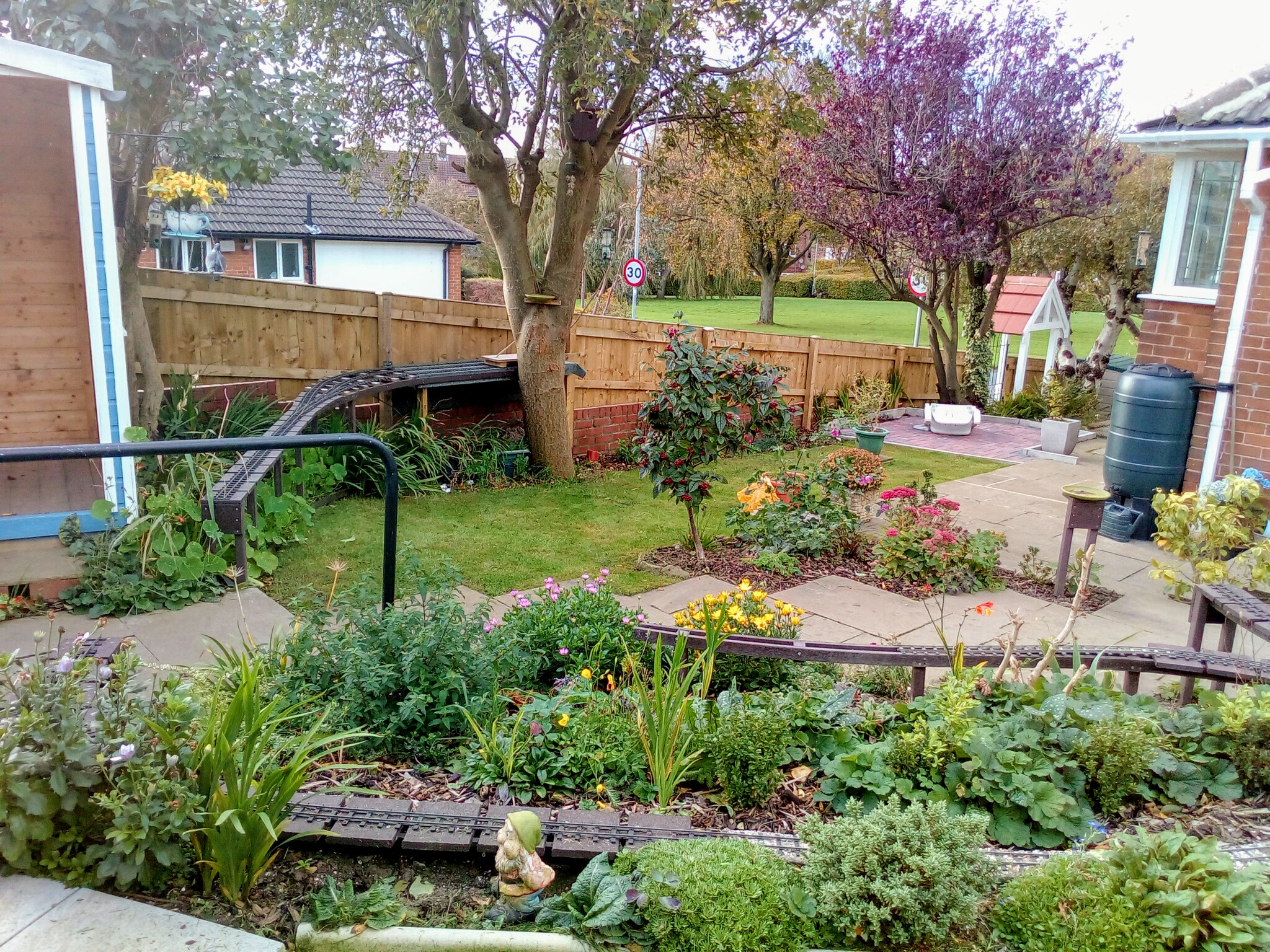

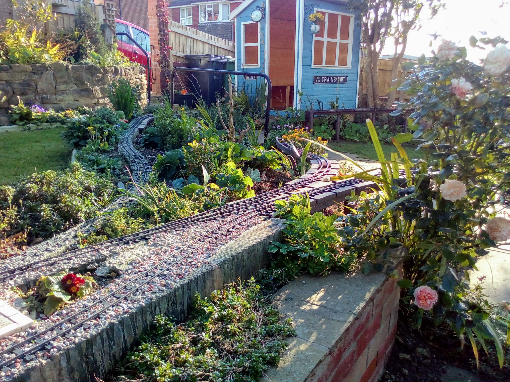

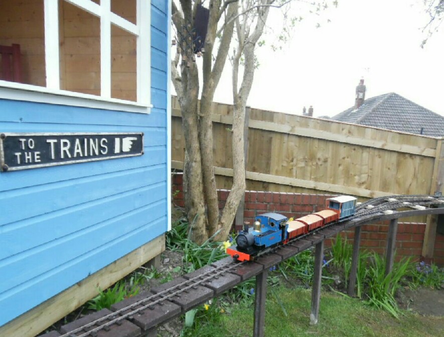

but back with a BANG now, hopefully! The line got pretty much left alone for a while, and its the wrong time of year really to be doing much to a garden railway but...... Just to bring things up to date, I have laid in the top part of the out and back branch line which WILL reach the front garden eventually. The photos show it starts its descent immediately after Hollycross Station Junction, and the ruling gradient is 1:45....ish. As I said earlier, trains will have to work on the way back!
Further news is that the strawberry patch 'disappeared' and was turfed and a small block paved area provided from where I can watch trains make their way down and up the gradient, whilst enjoying a drink of something suitable.
The branch line will be basically below the main line and run parallel to the wall. The bottom fence rail behind the seating area roughly marks the bottom of said gradient, and from there, the line will cross yet another bridge over the steps from the bottom gate and go round a loop in the front garden before tackling the climb back up. It says here...

That's definitely a railway garden. Good to see you back.
- Posts: 8037
Looks like you've made clever use of a difficult site. Will follow the next phase with interest.
Very nice, the plants have defiantly matured in the later pictures and it seems to help the railway blend in to the garden.
