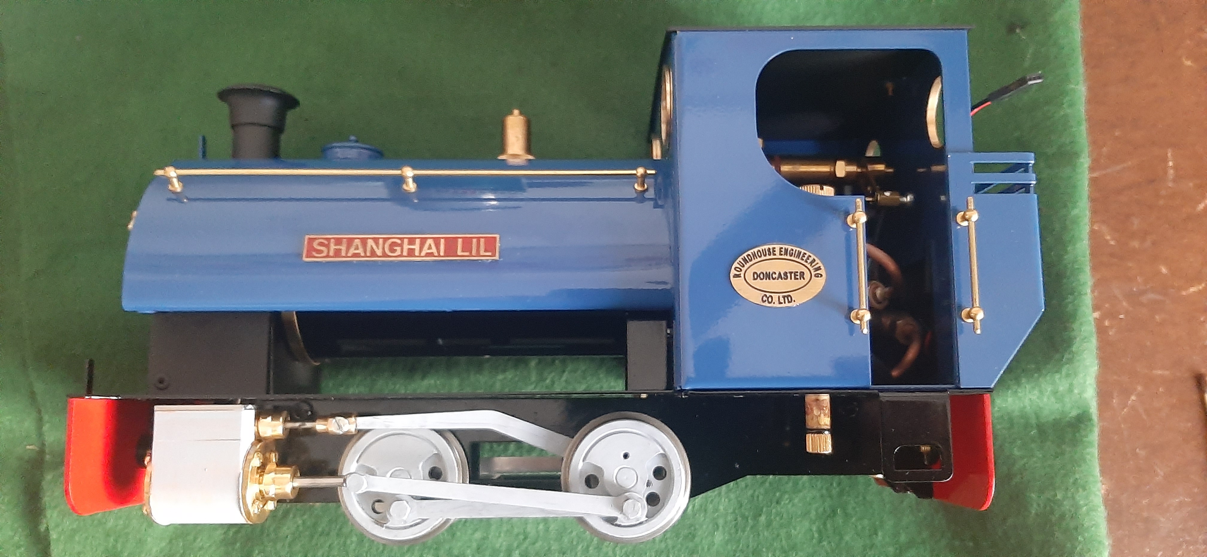

I want to paint the connecting rods red and paint the wheels and cylinder blocks black.
Does anybody know of a suitable paint on etch primer for this purpose.
Thanks in advance.
Chris.
Precision Paints do a 2 pack etch primer in black. I think there's a 1 pack version as well. I like the name, by the way.

Lonsdaler wrote: Fri Jun 05, 2026 10:21 pm
Hi thanks for the headsup
I did have a look at the web site ,but they have discontinued the 1 pack due to a short shelf life .
Re the name of the loco . I have had the name plates lying around for sometime waiting for a suitable recipient. I originally thought the name related to a colonial locomotive, but was pleasantly surprised to discover the name relates to the character " Shanghai Lily " played by Marlene Dietrich in the film Shanghai Express

In my experience, any etch primer sprayed into the lid of the can and brushed on seems to work - long as the loco is thoroughly degreased.

Old Man Aaron wrote: Sun Jun 07, 2026 12:02 pm In my experience, any etch primer sprayed into the lid of the can and brushed on seems to work - long as the loco is thoroughly degreased.
Nice loco. The colour suits it, and red rods will, too. :thumbup:
Thanks Aaron. :thumbup:
Thats the way to go . I have sprayed into the lid of a rattle can paint in the past to touch up models . Thanks for reminding me. I have a stock of reasonable sacrificial paint brushes and some primer . its probably the most economical route as well.

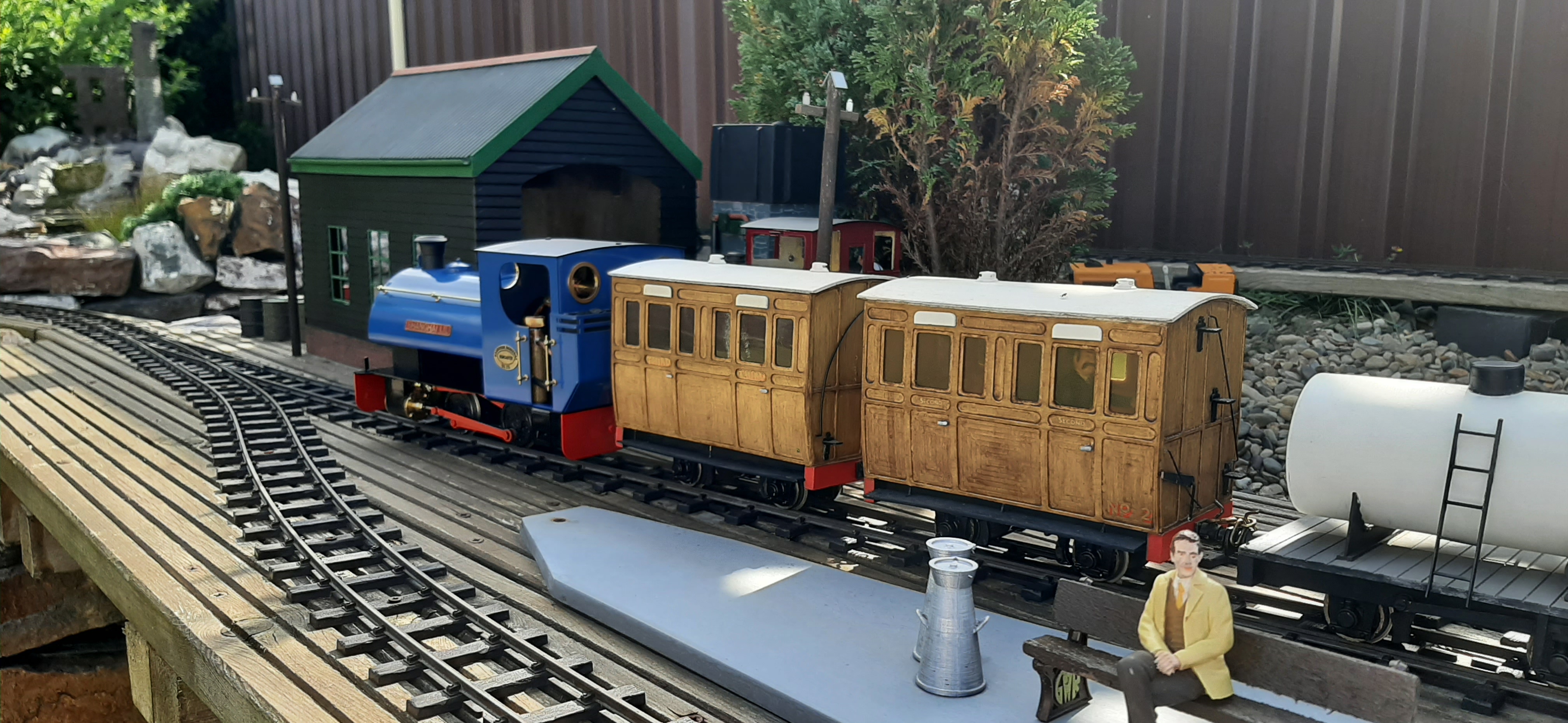

With the slight drop in temperature I bit the bullet and made a start on doing the paint job on my loco .
I prepared the surfaces to be painted using cotton buds soaked in IPA (Rubbing alcohol) to degrease the wheels ,cylinder blocks and motion rods.
I have just applied the etch primer to the surfaces using a paint brush . It says the primer can be painted over in 2 hours ,but I will leave it overnight in order for me to regain my composure! It was quite daunting slapping primer onto a new Roundhouse loco !

Thanks Aaron for your knowledgeable input and reference to cylinder block temperature.
Once I was happy with the primer I painted the wheels and cylinders with black engine block paint. It was a much harder job to do compared with applying the primer. I decided to ditch painting the motion rods with the red engine block paint and went for normal Humbrol satin enamel.It should be fine as the rods won't get as hot .
I have placed tool boxes towards the cab end of the loco as Roundhouse advised not to locate them near the smoke box as they might melt as they are white metal castings. Just waiting for the paintwork to cure before I can give it a run.

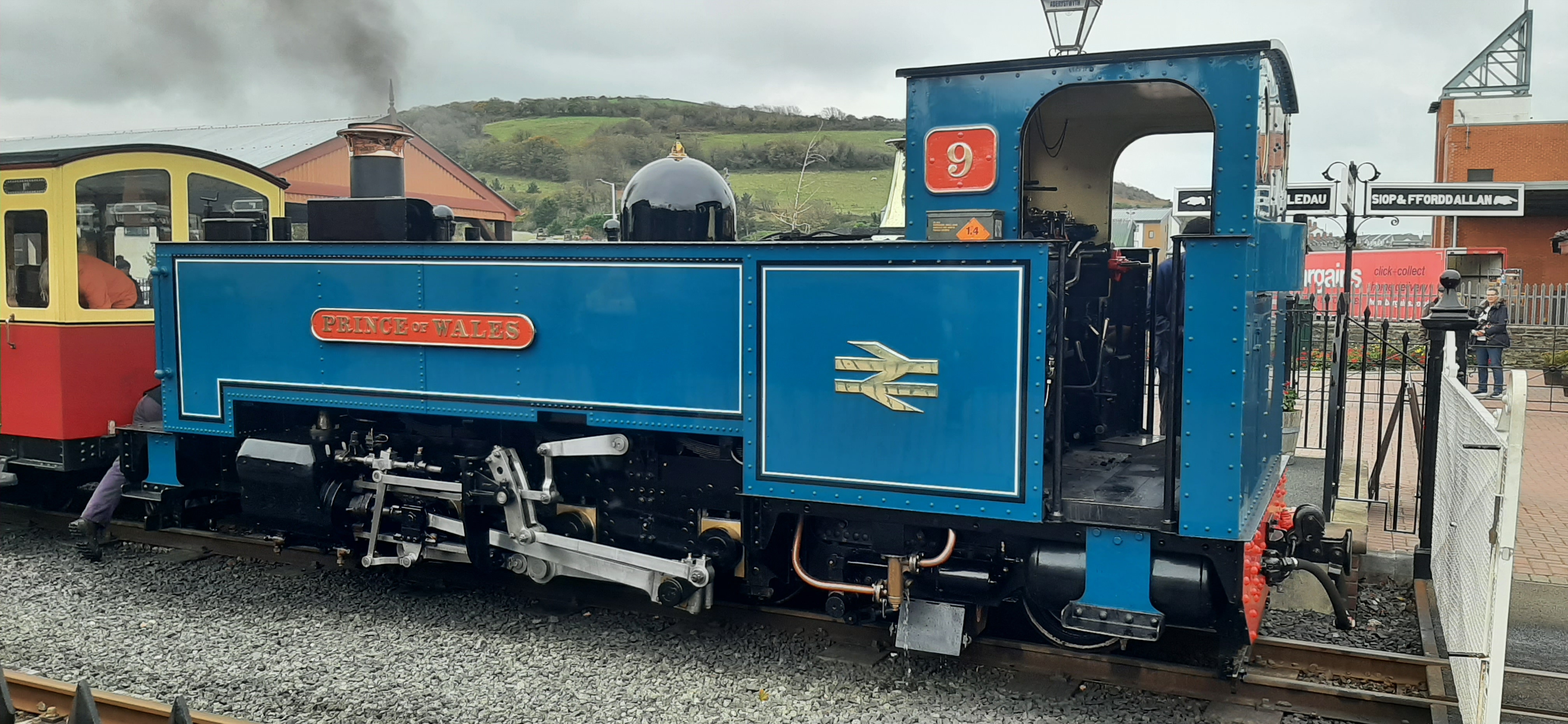

Thanks Phil . Almost as dubious as this colour scheme?
8)
Yr Tren Nesa Wedi Mynd
Posts: 6069
Re: The Preseli Mountain Railway.
Post by philipy » Fri Jul 24, 2026 5:26 pm
Preseli Chris wrote: Fri Jul 24, 2026 4:48 pm
Well, protypical or not, that was(is) verging on the criminal, IMO!

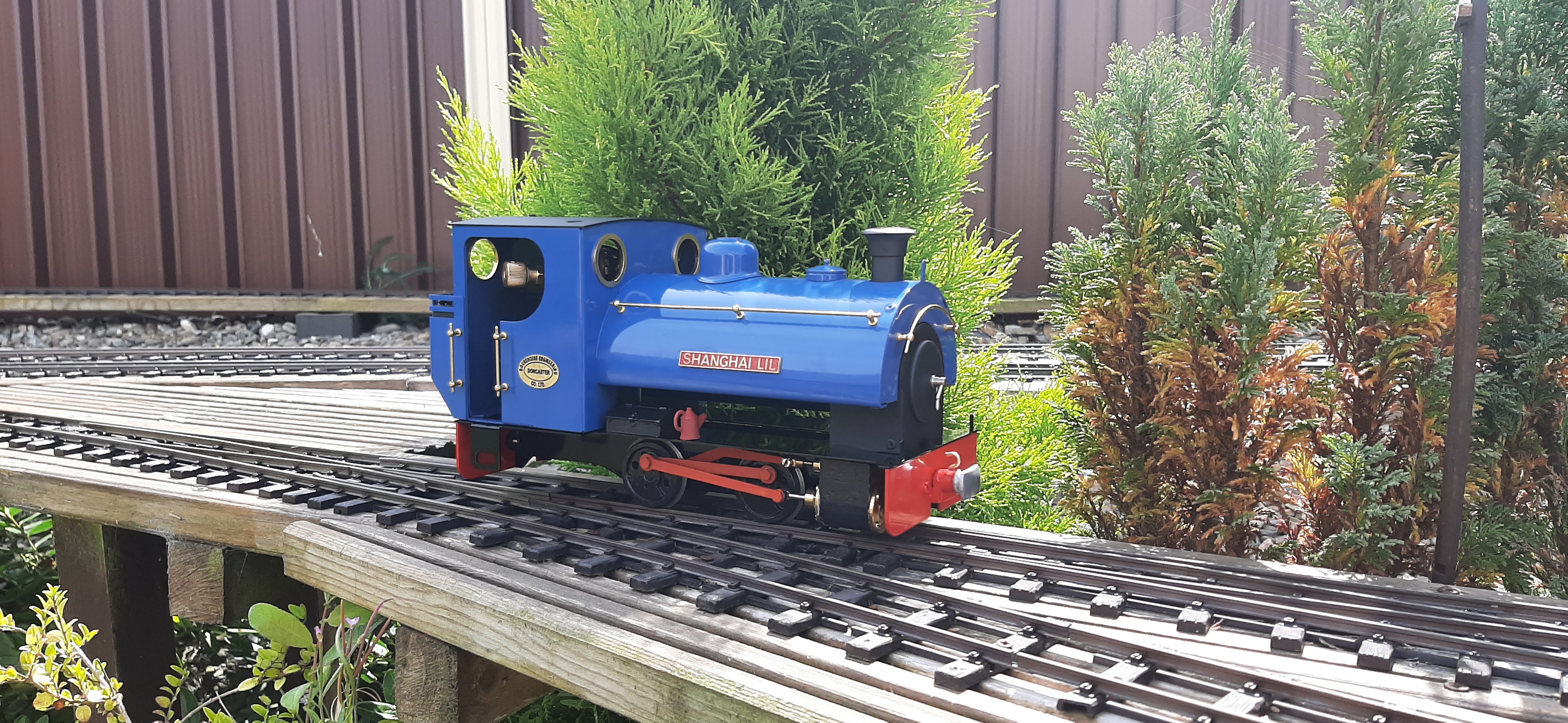

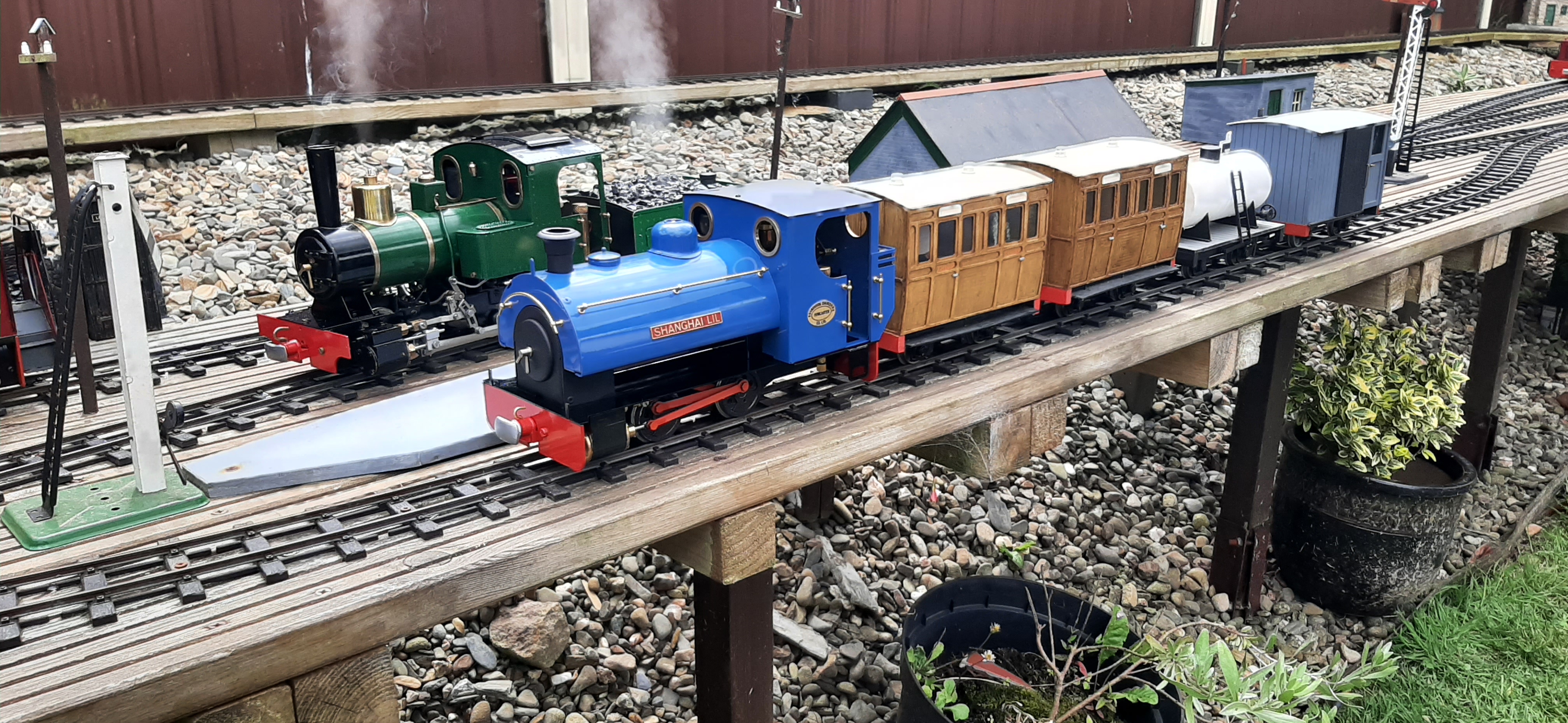

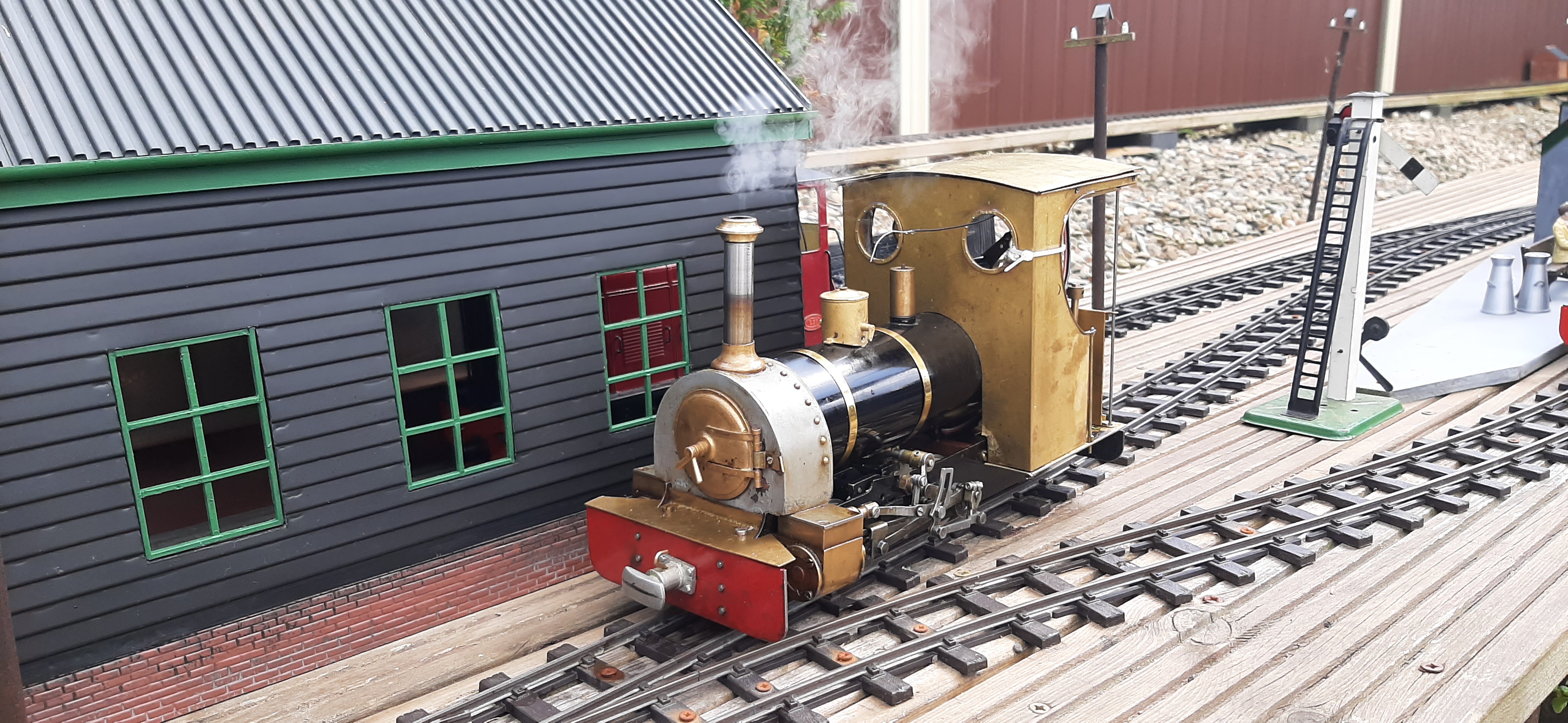

Post by Preseli Chris » Sat Aug 01, 2026 6:40 pm

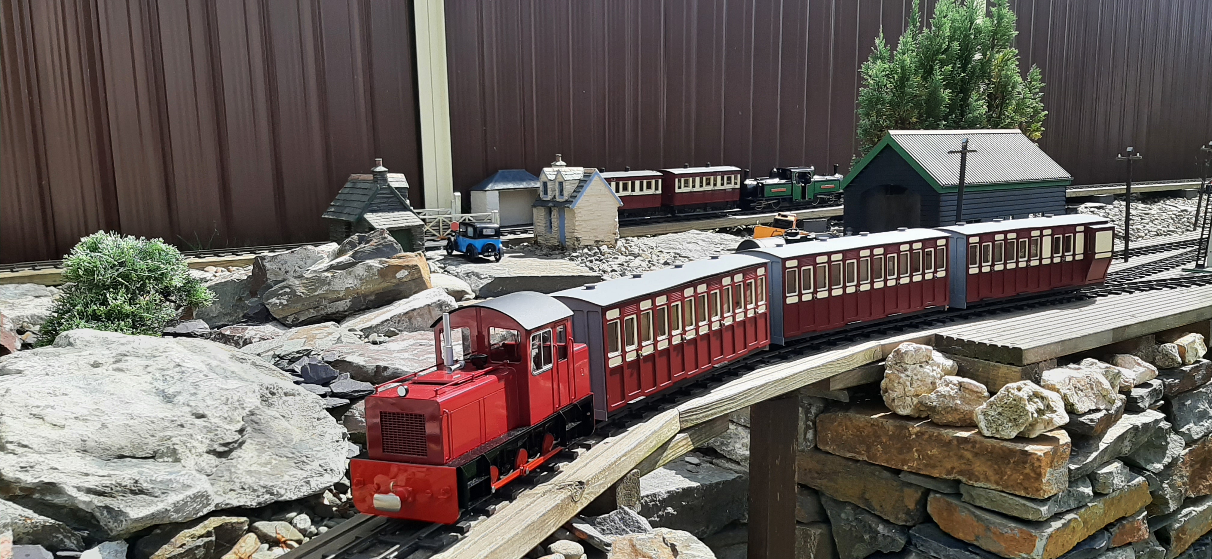

Had a small gathering to celebrate the fourth anniversary of the PMR. How time flies !
The weather was perfect for running trains.

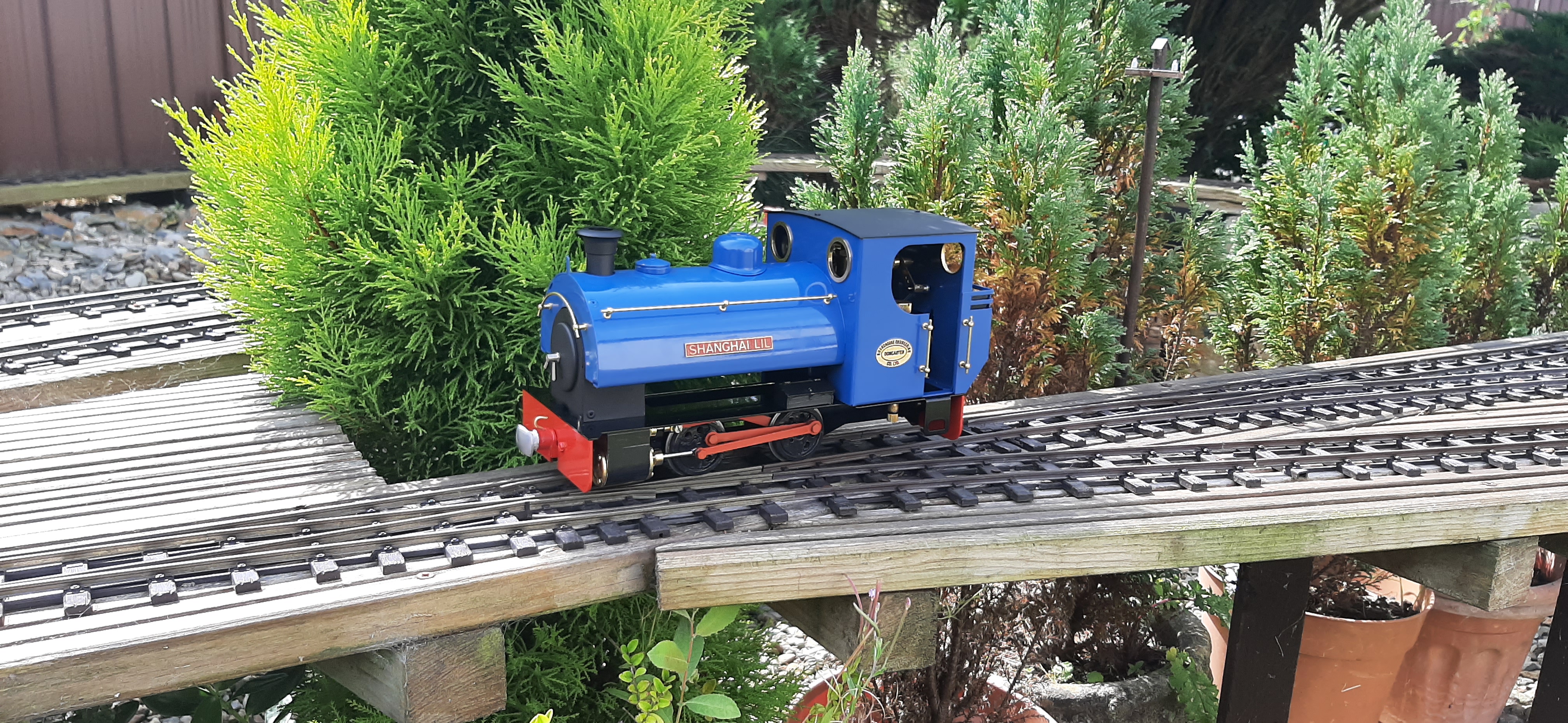

Post by Preseli Chris » Sat Aug 01, 2026 6:45 pm
Shanghai Lil made her debut appearance and was well received. I was a little concerned with the paintwork surviving the heat but all was well.

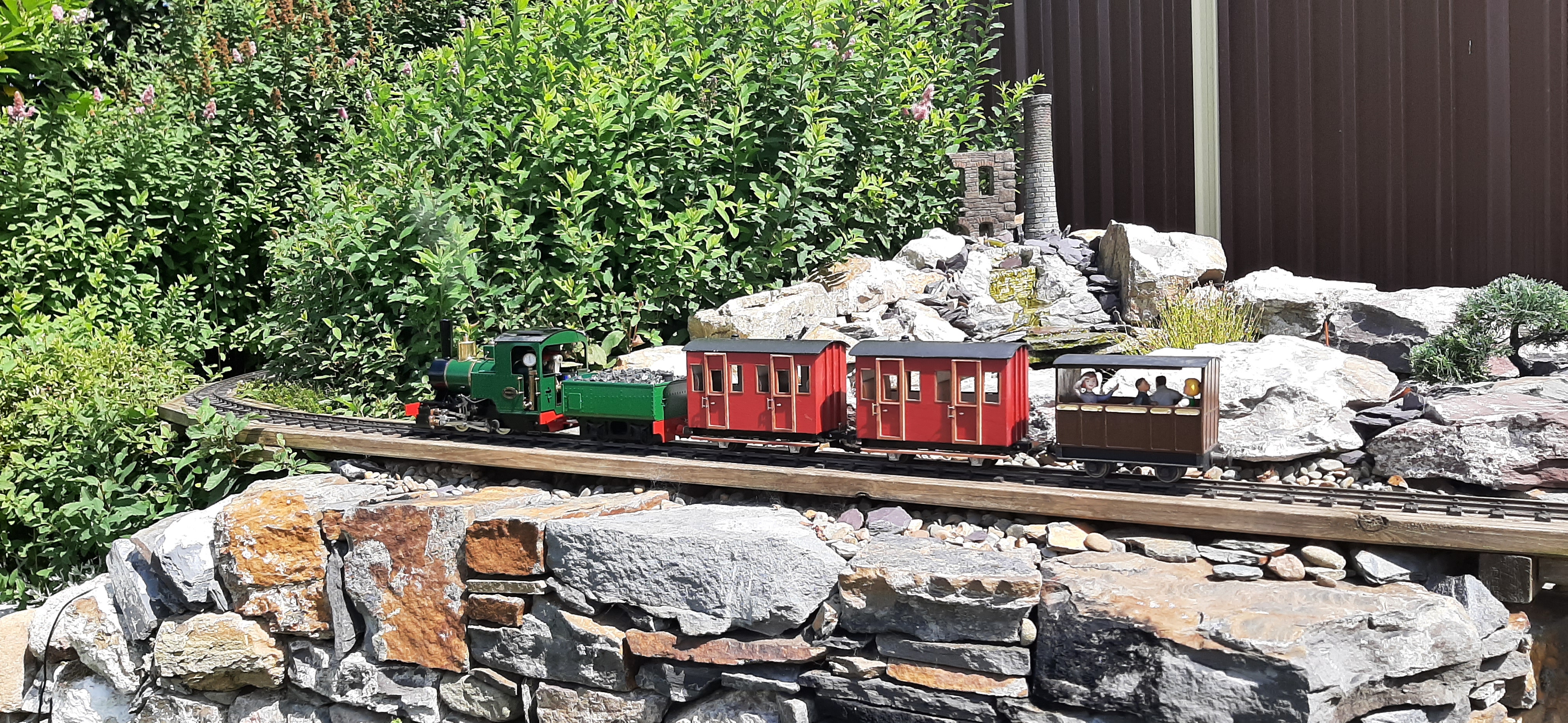

Post by Preseli Chris » Sat Aug 01, 2026 6:54 pm

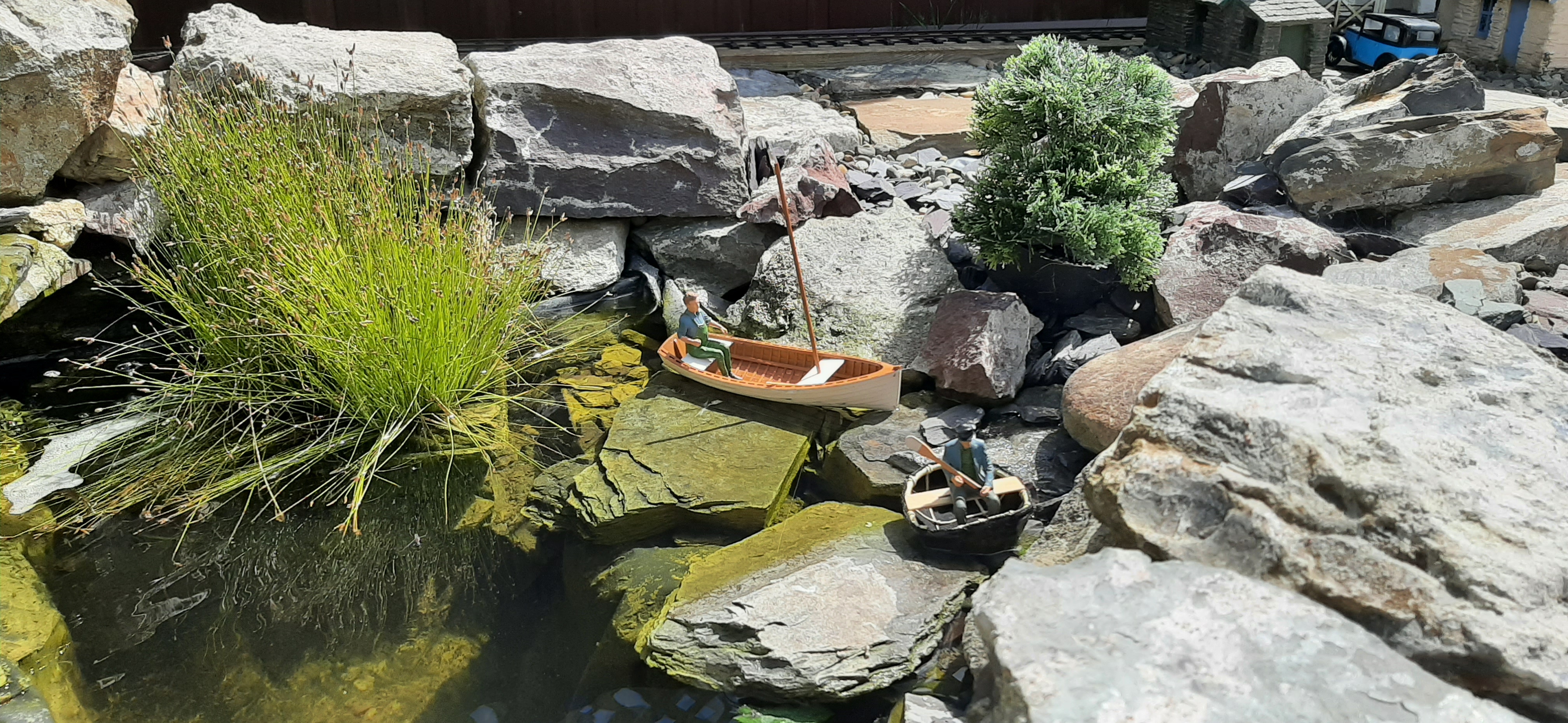

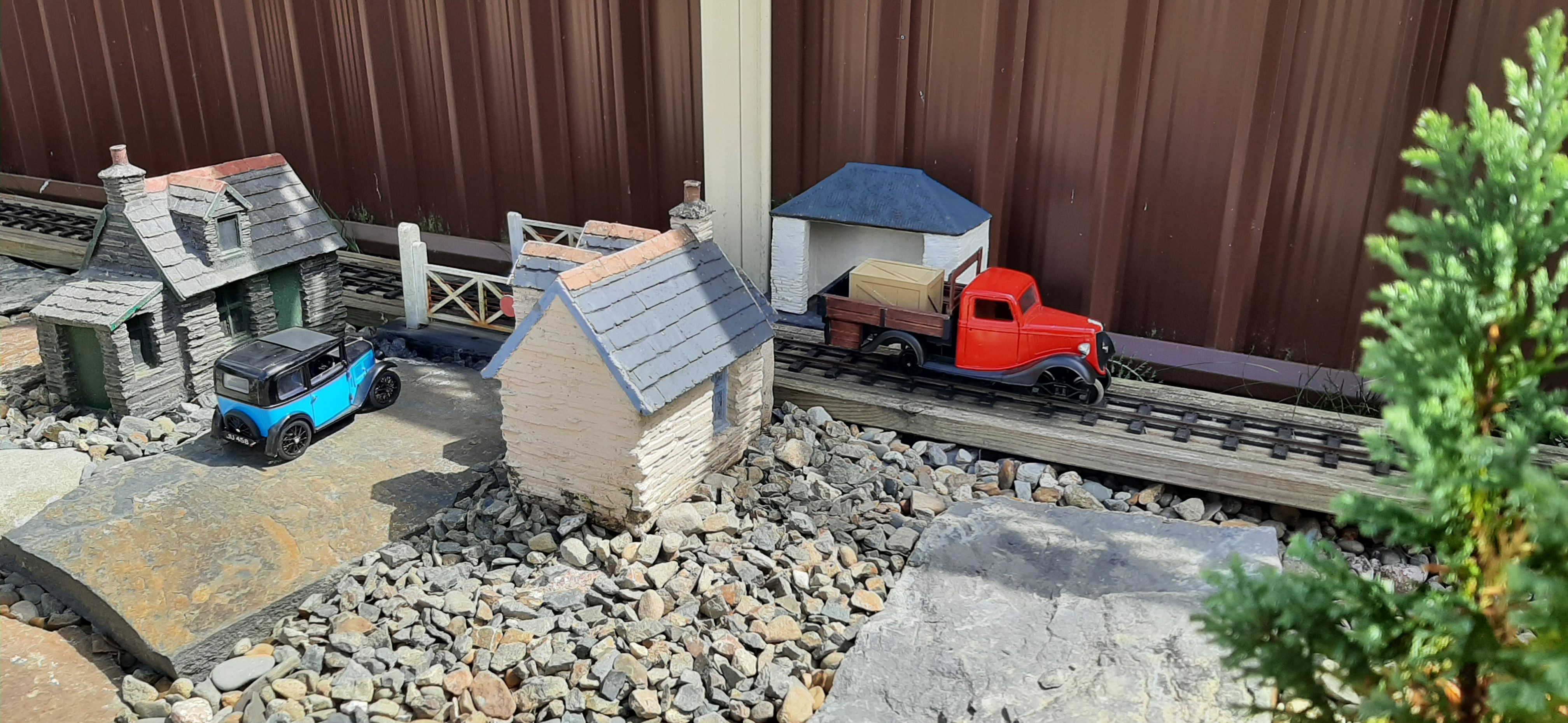

The pond has survived the heatwave, though the plant is a little sun bleached. I have been gifted a couple of concrete all weather buildings which I have touched up with sample pot masonry paint.
