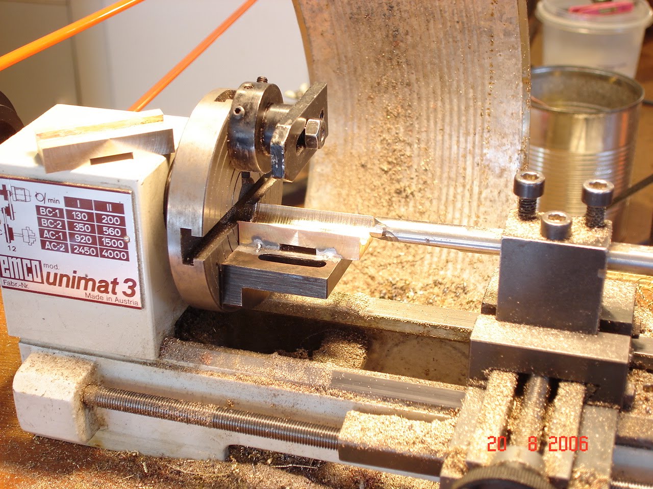

Here's my early set-up Rod, the motor had died so I used a long twisted belt connected to the original motor pulley held in a bench drill for power - much better than the original! I used this lathe set-up for the first 3 locos

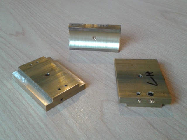

Boring the port piece to solder to the round cylinder tube for the large De Winton

Interesting photo Dave. I assume the stuff fixed to the top of the Face plate is to balance the load. Novel way to power your lathe. Presumably with a small lathe it is a case of light cuts to not overload it.

That's it, Don, it's counterbalancing. It was a successful way to power the lathe with more power - 1/4 hp good speed range and none of the intermittent running that the original motor needed.DonW wrote: Sun Aug 25, 2019 8:04 am Interesting photo Dave. I assume the stuff fixed to the top of the Face plate is to balance the load. Novel way to power your lathe. Presumably with a small lathe it is a case of light cuts to not overload it.

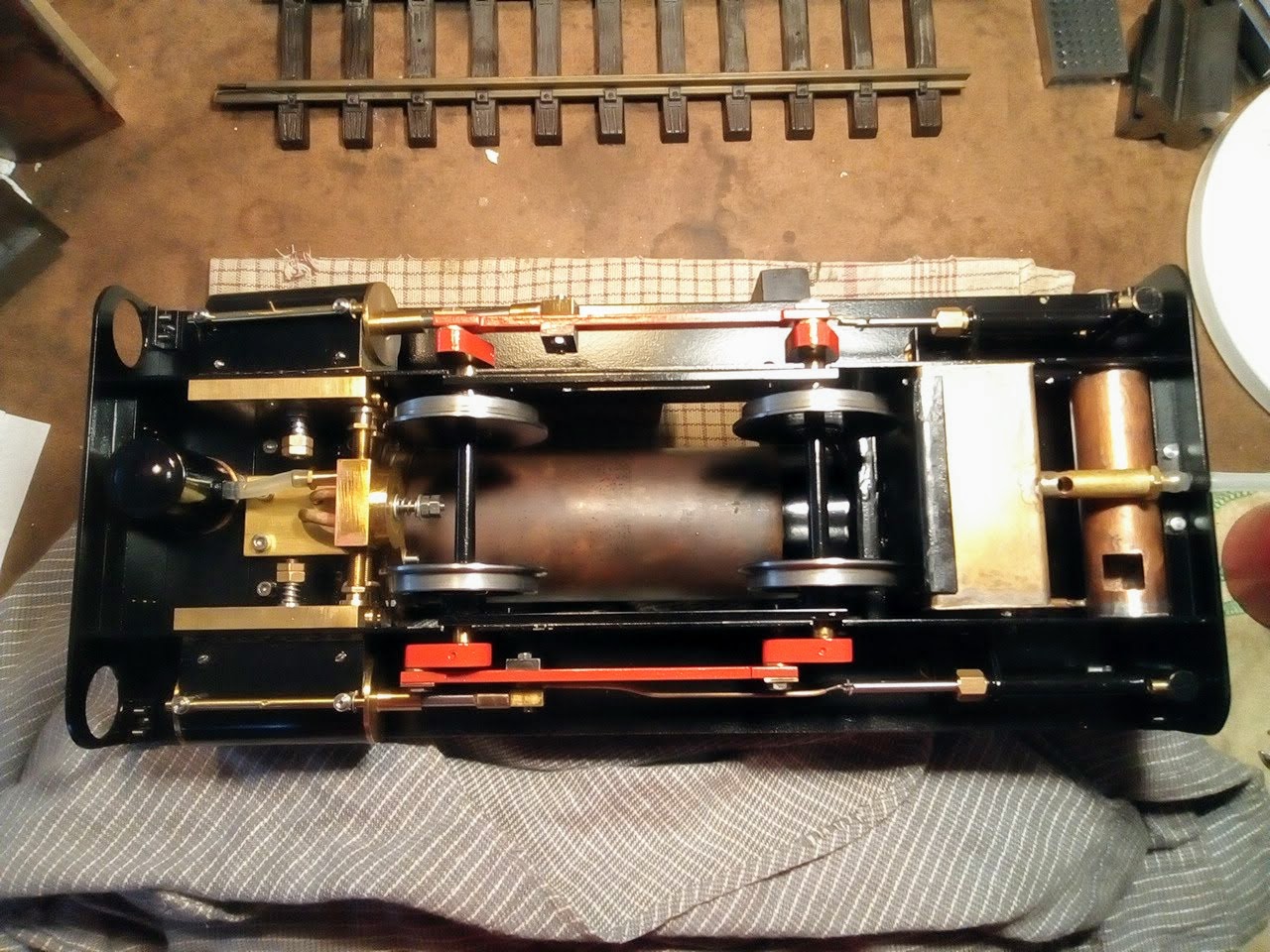

As LBSC would say, the loco is on the Erecting Bench!
Some painting has been done with spray can and brush - some old enamel from years ago that now takes an age to dry.

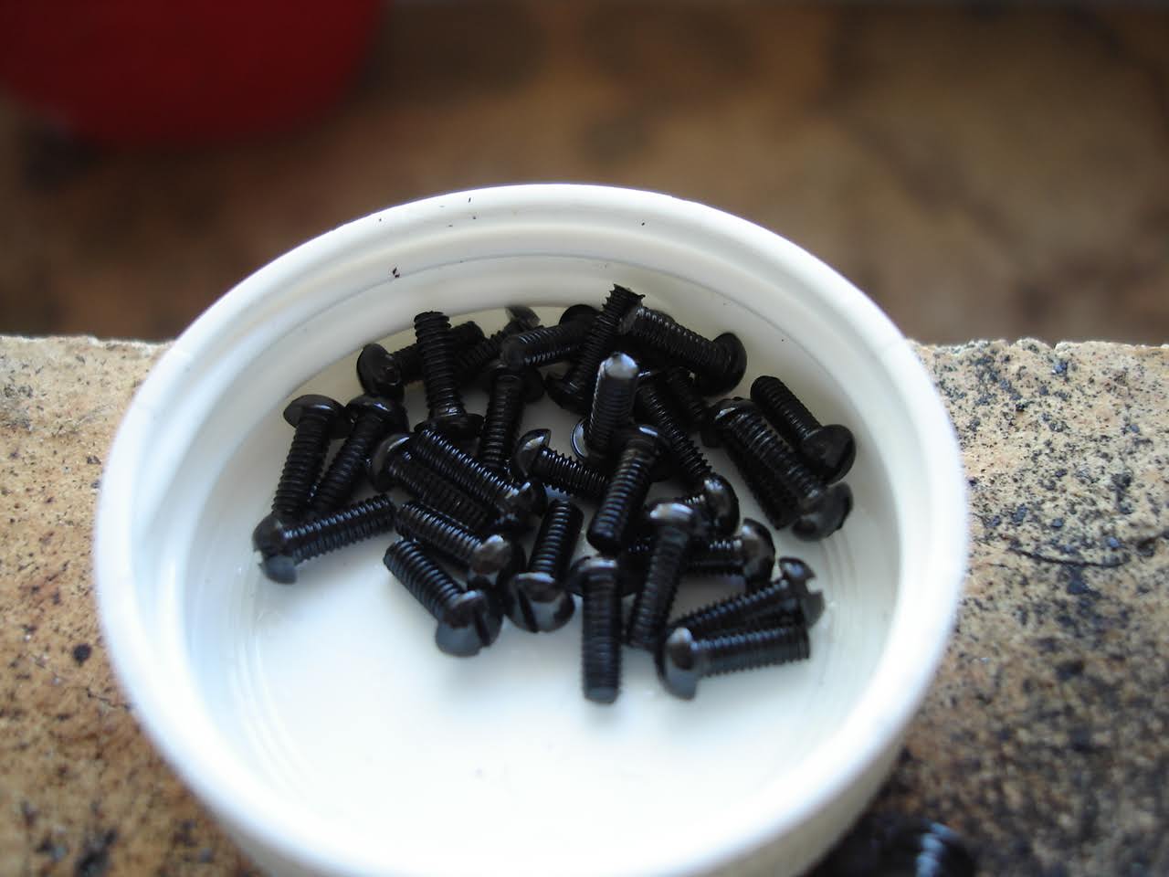

I'm assembling the loco with oil blackened roundhead 8BA screws. Today I oil blackened the chimney so that I wouldn't have to paint it. The finish is pleasing, and the distortion from heating has caused it to fit better

That looks great, chemically blackening shows off rivet detail and plate work far more crisper than when items are painted.

Stunning work Dazza. Everthing is so neat and precise. As Tom says the oil blackening has worked really well.

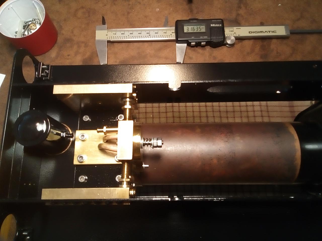

Finally got the big loco plumbed-in, water and steam leaks sealed, and semi painted. When I saw how clean and nice the smokebox interior was while building I knew I wouldn't coal fire it, so it's gas-fired
It needs the suction fan for lighting, and steam blower to keep the fire going in the right direction. The big cylinders need their draincocks
Here we are water pump testing, and successfully pumping water into the boiler

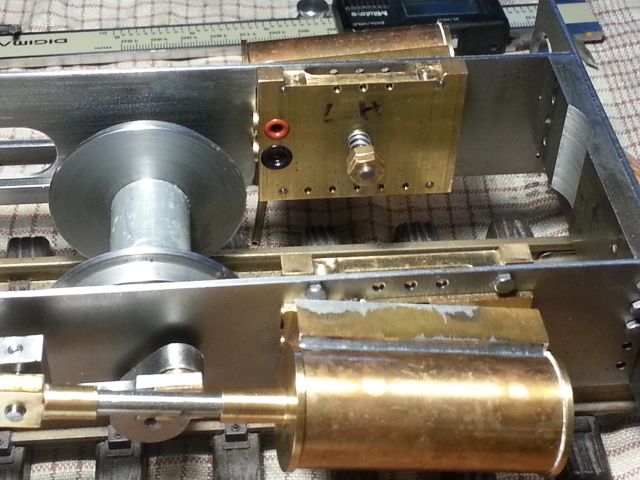

I've just re-read your build thread, and as everyone has said it's a beautiful job. Could you explain the plumbing of the cylinders please? I understand they are double acting and reversible, but how do you keep the exhaust going up the chimney? My tiny brain has tried and failed to work it out. I ask because I have an idea for my first attempt at scratch building a loco with oscillating cylinders.

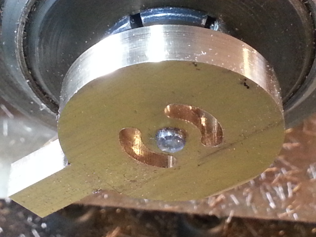

I hope this picture helps There's the rotary reversing valve which is fed by the steam pipe from the boiler and discharges into the exhaust pipe that goes up the chimney. There are two pipes on each side of the rotary valve feeding to the cylinder port blocks. Each port block has two long drillings that supply the two port holes at each end of the port block. Either top or bottom ports can be steam or exhaust. Looking at the side pipes coming from the rotary valve, the valve connects one of the two sets of pipes to the steam supply and the other to the exhaust. When the lever is moved the other way the steam and exhaust connections are reversed. The steam has to move the pistons before it can travel to exhaust. The valve body has 4 holes, 1 for the steam, 1 for the exhaust, these are the horizontal holes. Then the upper and lower holes are for the pipes to the cylinders. The curved grooves in the rotary part connect the exhaust and steam to alternate cylinder pipes

Ah ha, thanks Dave I see it now. It's a such simple and elegant way of doing it, and didn't Mr Kalashnikov say "simplicity is underrated", or words to that effect. You have inspired me to have a go!

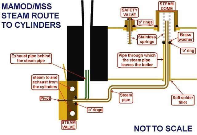

I'm a big fan of this picture showing how Mamod did it Tom, it's lovely engineering

Sorry to barrage you with more questions. How are the pipes between the rotary valve and the port blocks fitted? Are they a fit, silver soldered or threaded and o ringed in some way?

It's fine Tom, it's been really quiet lately. That was the tricky bit, the pipes screw out from the valve housing and are sealed at the port blocks by O-rings
