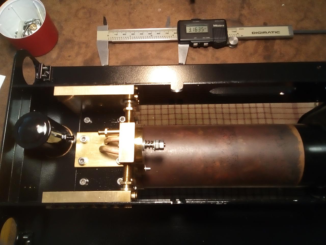

I've just re-read your build thread, and as everyone has said it's a beautiful job. Could you explain the plumbing of the cylinders please? I understand they are double acting and reversible, but how do you keep the exhaust going up the chimney? My tiny brain has tried and failed to work it out. I ask because I have an idea for my first attempt at scratch building a loco with oscillating cylinders.

Post by dewintondave » Sat Oct 26, 2019 5:17 am
Thanks, Tom!
I hope this picture helps
There's the rotary reversing valve which is fed by the steam pipe from the boiler and discharges into the exhaust pipe that goes up the chimney. There are two pipes on each side of the rotary valve feeding to the cylinder port blocks. Each port block has two long drillings that supply the two port holes at each end of the port block. Either top or bottom ports can be steam or exhaust. Looking at the side pipes coming from the rotary valve, the valve connects one of the two sets of pipes to the steam supply and the other to the exhaust. When the lever is moved the other way the steam and exhaust connections are reversed. The steam has to move the pistons before it can travel to exhaust. The valve body has 4 holes, 1 for the steam, 1 for the exhaust, these are the horizontal holes. Then the upper and lower holes are for the pipes to the cylinders. The curved grooves in the rotary part connect the exhaust and steam to alternate cylinder pipes
Best wishes,
Dave

Post by Tom the blacksmith » Sat Oct 26, 2019 11:12 pm
Ah ha, thanks Dave I see it now. It's a such simple and elegant way of doing it, and didn't Mr Kalashnikov say "simplicity is underrated", or words to that effect. You have inspired me to have a go!

Sorry to barrage you with more questions. How are the pipes between the rotary valve and the port blocks fitted? Are they a fit, silver soldered or threaded and o ringed in some way?
Best,
Tom
dewintondave
Posts: 697
Location: New Zealand
Re: Wild Rose ~ Quarry Hunslet
Post by dewintondave » Mon Oct 28, 2019 12:35 am
It's fine Tom, it's been really quiet lately. That was the tricky bit, the pipes screw out from the valve housing and are sealed at the port blocks by O-rings
Best wishes,
Dave
