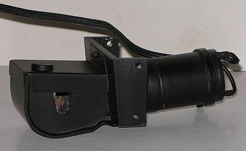

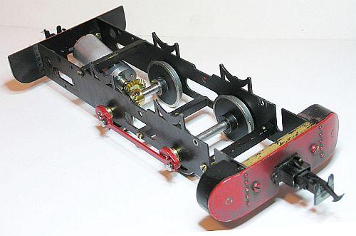

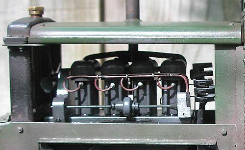

As mentioned above, a complete mechanical and part electrical rebuild was called for, after killing the battery of the Pet/Mech loco. First clean and strip the old setup.

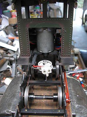

The old 540 motor can be seen which drove a worm gearbox through a toothed belt drive. Overall reduction was 41:1. Next machine a new boss to mount bevel gear to axle ( 1/4" diam. Roundhouse axles don't leave much room for a boss with grubscrew) and position new 34:1 gearmotor to see what's required for a mount.
Motor, gearbox, mount and bevel gear cover made and painted.

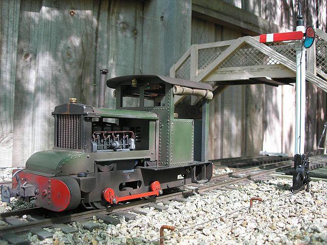

Replace most old wiring, build a new "engine", now horizontal instead of sloping at 30deg. and now has a fan, fuel lines. throttle linkage etc.
Add a couple of sand boxes and gear to hide the cutout in the Katie frames, and it's all done. Runs a 1amp fuse instead of 7.5amps, and been running for 5 days and still haven't charged the batteries.

Incredibly tidy work Grant, you are so particular about detail and it shows in the end result. Superb engineering and finish.
Post by tom_tom_go » Fri Mar 10, 2017 4:07 pm
Great looking loco Grant, want one!
Post by Soar Valley Light » Fri Mar 10, 2017 7:46 pm
Great Stuff Grant. I really like the look of that loco - and I'm a died in the wool steam man! The last picture in particular is simply stunning!
Posts: 1905
Post by LNR » Fri Mar 10, 2017 10:50 pm
Thank you all for your comments, apart from a few additions the loco hasn't changed much, but has become far more practical to use.
Andrew, I'm a one eyed steam man too, I never realized how important this loco is to my railway until I was without it. Apart from a run every other day, it transports stock down from the shed, shunts and makes up trains, it has definitely moved up a notch or two in my respect for it.

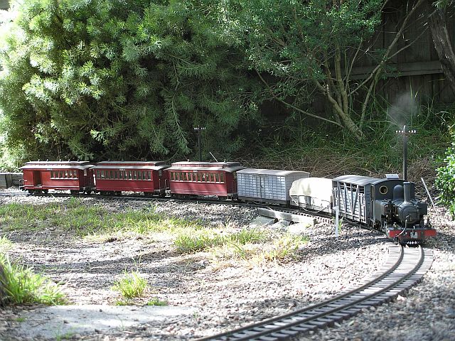

Some shots from today.
Leaving Warringine.
Fri. 31-3-17 3.JPG (139.69 KiB) Viewed 8915 times
Arriving Nayook.
Fri. 31-3-17 10.JPG (121.99 KiB) Viewed 8915 times
Cuppa time.
Fri. 31-3-17 12.jpg (115.7 KiB) Viewed 8915 times

Excellent photographs Grant... wonderful stock and good composition. As all landscape artists say, light is the most important thing to capture an image and you have it in bucket loads!
Posts: 8052
Post by ge_rik » Fri Mar 31, 2017 12:28 pm
Peter Butler wrote: Fri Mar 31, 2017 11:29 am Excellent photographs Grant... wonderful stock and good composition. As all landscape artists say, light is the most important thing to capture an image and you have it in bucket loads!
Ditto - really like that shot of the train on the curve

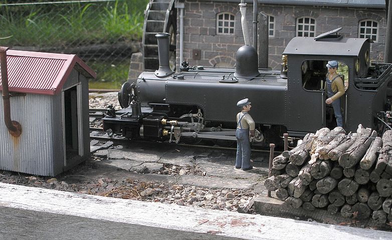

Post by markoteal » Fri Mar 31, 2017 2:47 pm
Great pics Grant - in your 'tea' shot, where did you source your staff from - not sure I've seen those figs before????
Posts: 1905
Post by LNR » Fri Mar 31, 2017 11:57 pm
Hi Mark,
the bloke on the ground is the Bachmann figure who carries a lamp, he's had about 10mm added to his legs. The driver was given to me, so I don't know the source. Someone might know who he represents (movie figure?) he originally looked like this.
Railway Folk 013.jpg (14.58 KiB) Viewed 8789 times
He's been in surgery since then.
