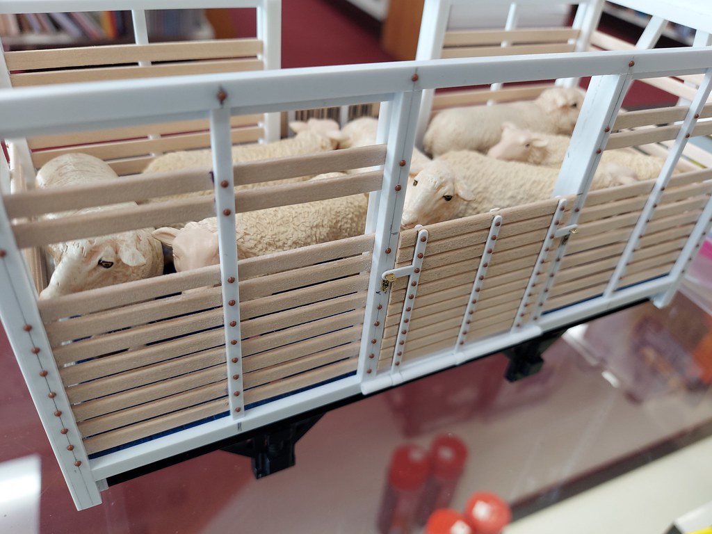

Got back to working on the cattle wagon today, first thought of the day was a load. These little Papo sheep seem to fit pretty well... and well they followed me home.
All and all they fit pretty well in the car.
Next step was the roof. I started with a basic square framework (no photos sadly), made myself the top roof center, then proceeded to plank with styrene.
Still a little nervous on actually sheeting the roof, but still coming up with ideas on that. I think I'm going to use 0.02 or 0.03 styrene sheet for the main layer. The planking should only act as a base. I will likely put a sheet of tissue paper with glue over the top layer of styrene for a canvas texture.
Overall though I am happy with the fit. The roof just clicks right into place. The sheep may need to go on a diet, as this car is getting pretty heavy. I think the upper doors are next once I finish the roof.

Personally I'd be very wary of using the really thin styrene sheet to cover the planks. Unless you plan to just tack it at the edges there is a real danger of it distorting and bubbling from the solvent over that large an area. I tend to use 1mm ply ( model boat shop) to do that job, and then cover it with fine weave cloth to simulate canvas.
Posts: 5723
Re: Wagon Scratch Bashes
Post by Peter Butler » Wed Apr 13, 2022 10:54 am
philipy wrote: Wed Apr 13, 2022 8:34 am That is looking better and better!
Ditto.... I find curtain lining material the most suitable for roof covering. It has a fine weave and looks just right after painting.

Got a chance to get back working on the car, now completed the roof. (I still may do some detailing). First job was to finish up all the planking.
I ended up using the 0.02in sheet, 0.5mm, pretty sucessfully. I used a medium CA superglue in lines to give the glue a chance to vent.
Overall I'm very happy with the fitment. The whole roof just drops into place. I may have to modify my sheep yet, as the whole car is starting to get pretty heavy. Was looking for some 1/24 scale sheep plastic kits at work, but so far no dice.
Not a bad idea, but I already had styrene lined up. May try using basswood on the next car, but will look for some fine weave for this one.

Absolute work of art, that. You might have to use a dremel to hollow out your sheep from underneath, I think Rik did that with his livestock wagons.
Posts: 8024
Post by ge_rik » Sun Apr 17, 2022 11:16 am
Old Man Aaron wrote: Sun Apr 17, 2022 4:03 am Absolute work of art, that. You might have to use a dremel to hollow out your sheep from underneath, I think Rik did that with his livestock wagons.
Well remembered - that's exactly what I did. I seem to recall hollowing out the palm of my hand at the same time :shock:
