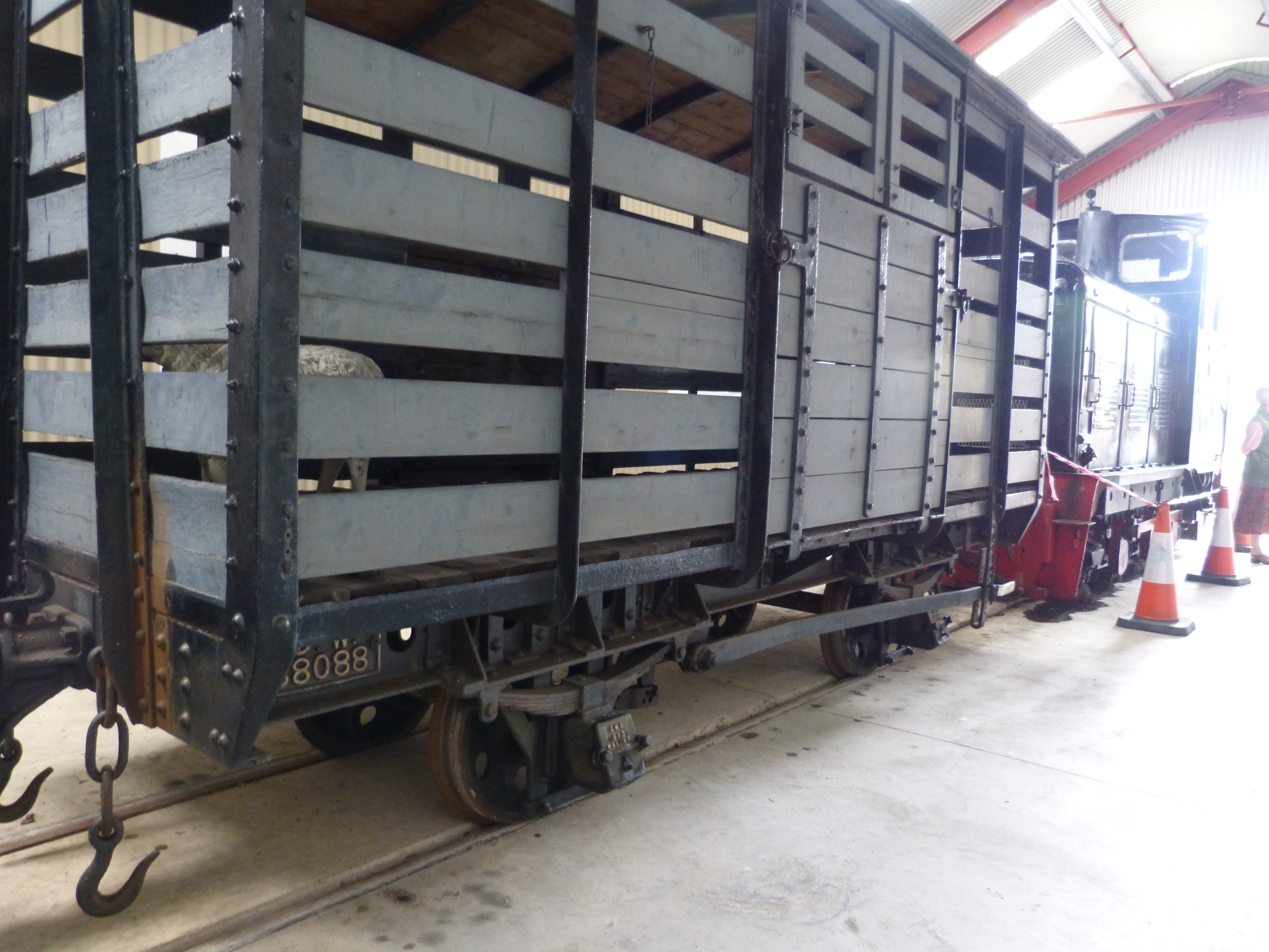

You may have some images already, but these are of one of the originals, photographed in Welshpool in 2016.
My daughter is reading an information board, not staring at the wall!
WLLR Cattle waggon 2
WLLR Cattle waggon
WLLR Cattle waggon

Also, thanks for the reference photos. Vale of Rheidol also posted a decent amount to their facebook page on the rebuild as well. I think I'll be formulating a full plan soon.
