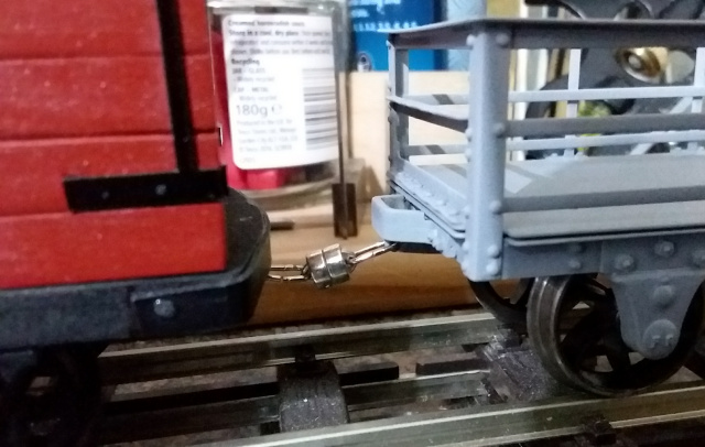

Firstly, I have now completed the Slaters slate wagon kits, an IP wooden slate wagon kit, and have scratch built a Ffestiniog 2 ton coal wagon. My next jobs are to R/C my PDF Baldwin and scratch build more wooden slate wagons.
Trying to couple and uncouple using the small hooks and loop couplings is so fiddly however with the wagons being so close together. I just don't seem to have enough hands (or patience). Looking through my bits collection I came across half a dozen pairs of Timpdon magnetic couplings that I bought at Stoneleigh about 8 or 9 years ago. So i replaced the hook and loops with these magnets and was amazed how powerful they are. Just push the wagons together and the magnets flip up and grip together. A sharp pull and they come apart. They hold my six wagons together perfectly, even with a gentle snatch start on purpose to test. Here is a close up of one pair.
Not being able to find any more on line I was wondering if anyone knew of a supplier or had any knocking about that they would be willing to sell. I would love to see how many wagons I could pull using them.
David.

River Lin wrote: Mon Mar 02, 2020 7:29 pm Not being able to find any more on line I was wondering if anyone knew of a supplier or had any knocking about that they would be willing to sell. I would love to see how many wagons I could pull using them.
The ones Timpdon sold look like a magnetic clasp used for jewelry.
Ebay would be the cheapest source I imagine, but you'll have to plough through a lot of designs to find something suitable. Using the search term 'magnetic clasp' I got close to 15000 hits, mostly in China.
Another source might be craft shops, as some of them carry jewelry making supplies. Jewelry trade suppliers do stock them, at about ten times the price from China...........

A quick check of our local electronics store (Jaycar) reveals rare earth and Ferite magnets of various sizes, some with mounting holes.
Re: Slaters 2 ton slate wagon
Posted: Wed Mar 04, 2020 8:02 am
Magnetic jewellery clasps on eBay
https://www.ebay.co.uk/itm/181568440017
These are £2.49 for 10 or £7.99 for 50 - UK supplier
There are different styles available so might be worthwhile doing some more digging

I have been doing some digging around and have found a few that may be possible.

My Baldwin and train so far with magnetic couplings.
https://youtu.be/qvaU1HbW6eM
It was tested on my local model engineers outdoor track earlier today. The couplings are strong enough to stop the whole train if I hold back the last wagon. I am definitely going to get more to add to the three new wooden slate wagons that I have just cut the materials for. I wonder how many wagons I could pull in total before the train gets too heavy. The 1st truck is a scratchbuilt FR coal wagon in which i am going to house the batteries, receiver, sound card and speaker under a false coal load. The blue box in the second truck holds the batteries at present and a manual speed controller.
