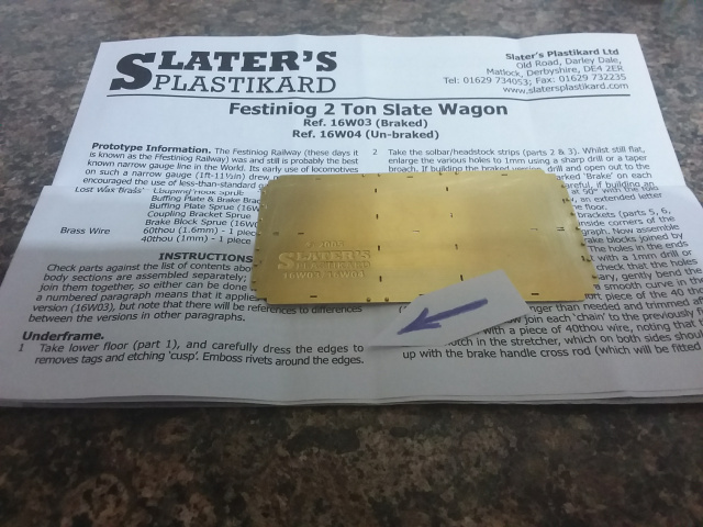

Hi all.
Not having posted on here for a while I thought I would share my latest build experience in real time.
I opened the box at the weekend, checked the contents (looks great quality) and had a 1st read of the instructions.
Today I have cut out and cleaned up the lower floor and drilled 22 holes 0.8mm diam for the cosmetic rivets. I could emboss rivets if I had the appropriate press which I don't, or stick on little nail art jewels but i don't thick I could keep them inline. Having a small supply already of 0.8mm brass rivets I have decided to use these. So I passed the rivets through the holes, trimmed them off on the back and fixed them with a little superglue on a pin before filing flat. This didn't take too long once I got going.
22 rivets done. Next is to rivet, bend and fix the sole bars underneath.

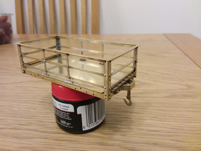

I have spent quite a bit of time on the wagon over the past 10 days. Although I glued the underframe rivets in place I tried soldering the rivets in place on the wagon body and I feel I did quite well. I took this decision because I wanted to solder the body together and was not sure how heat would affect the glue. It was a lot of rivets to solder but once I got a rhythm going it didn't seem so bad. I have a good soldering iron, side cutting pliers and I was advised by a local society member to try Laco flux which I did to good effect.
Here are a couple of pictures of the wagon before i fit the running gear. The axle boxes will be bolted through the sets of three holes visible in the sole bars. I also love the look of real rivets. Still looking for a loco though. David

Very nice looking detail David, just shows there is no substitute for doing it the right way. I have a mantra when modelling "if all else fails, do it like the real one". Mind you applying the many hundreds of rivets required on a loco could be rather tiresome. That slate wagon will look perfect when finished. Dare I ask how many you intend doing?

I know it will be a short train initially but I have 4 kits on my work bench and that is a lot of riveting and soldering :-)
David.

Looks good, nice neat soldering. You can't beat metal for simulating metal in a model that open. Polystyrene can come close, but wood isn't even a starter.River Lin wrote: Fri Nov 29, 2019 5:46 pm Here are a couple of pictures of the wagon before i fit the running gear. The axle boxes will be bolted through the sets of three holes visible in the sole bars. I also love the look of real rivets. Still looking for a loco though.
Glueing metal together isn't a good idea at the best of times if you can solder. Glues have little heat resistance and don't mix well with soldering. Anyway soldering goes faster, give or take time to treat the odd burnt finger.
I agree with Grant, I'd also have done it that way for this model, as it's a metal body and there aren't a lot of rivets.
I draw the line at doing long rivet runs on loco bodywork that way though, which is why I built a rivet press to use in the small mill. It would also fit my old bench drill, but it has too much slop in the quill to be usable for this.
It might seem daunting at the start, but the trick to batch building is to just bite the bullet and start. Then try and do a bit more whenever you get a bit of time. If you work out a given step on model #1, it then goes much quicker on the others and before you know it they are all finished.

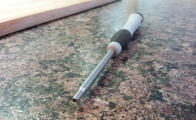

I use what I know as a 'nut spinner' with a little 'blu-tack' in the socket to hold the nut as I thread it onto the bolt and tighten it. This works well for me. David.

Ah! yes that would make it easier.
I'm still using my fingers for that sort of thing, even occasionally with some blue-tac on them

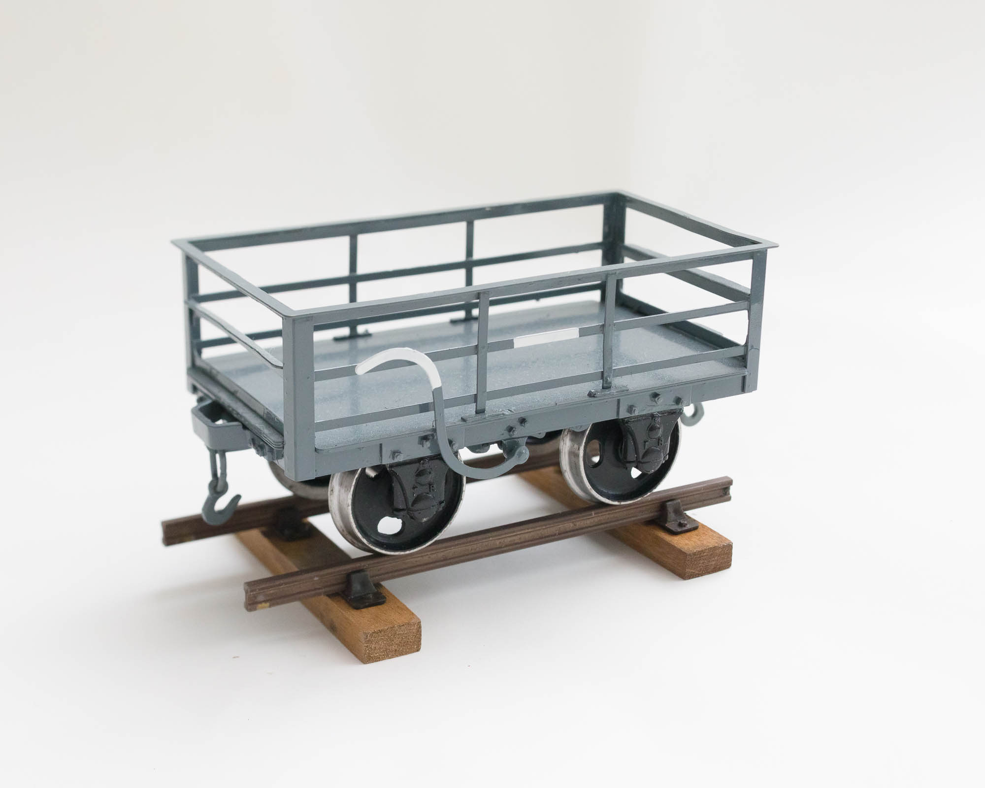

An interesting thread and sorry to comment late to it. It seems to take a long time to get permission to join this forum.
I thought this kit, well the braked version in my case, would be a nice gentle reintroduction for me to return to 16mm modelling after a very long gap.
Looking at this thread; Great soldering skill on your model.
The choice of fixing the axle boxes with nuts and bolts is a good move. Although the supplied square head bolt heads are prototypical, they're a real faff to glue up and can't ever be removed should maintenance be needed in future.
The rivet dilemma is something I considered and chose the other method, I punched the rivet etches with an automatic centre punch. I think it may have been a bit too subtle once painted compared to the practice of drilling out and replacing with 'real' rivets. It will be interesting to see how painting your wagon will tame the, what some might consider as, slightly over-scale appearance, especially when compared to the real museum piece in your photo.
Worth noting that the braked version of this kit adds a significant addition of complexity to the construction. Getting the whole 'brake chain' assembled, fitted and not fouling the wheels is quite challenge I would happily have avoided if I'd known what it would involve.
Mine's been given a coat of Phoenix etching primer and gloss mid-grey enamel, with the start of detailing for a Maen-Offeren quarry wagon not quite yet complete. Once I've practised a bit, I'll weather it down to something less new and shiny too. I think I'll also have to get some unbraked ones to make a more complete rake.

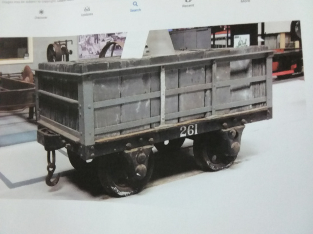

That looks very nice indeed! It took me a second glance to realise it wasn't a real one on display in a museum!
