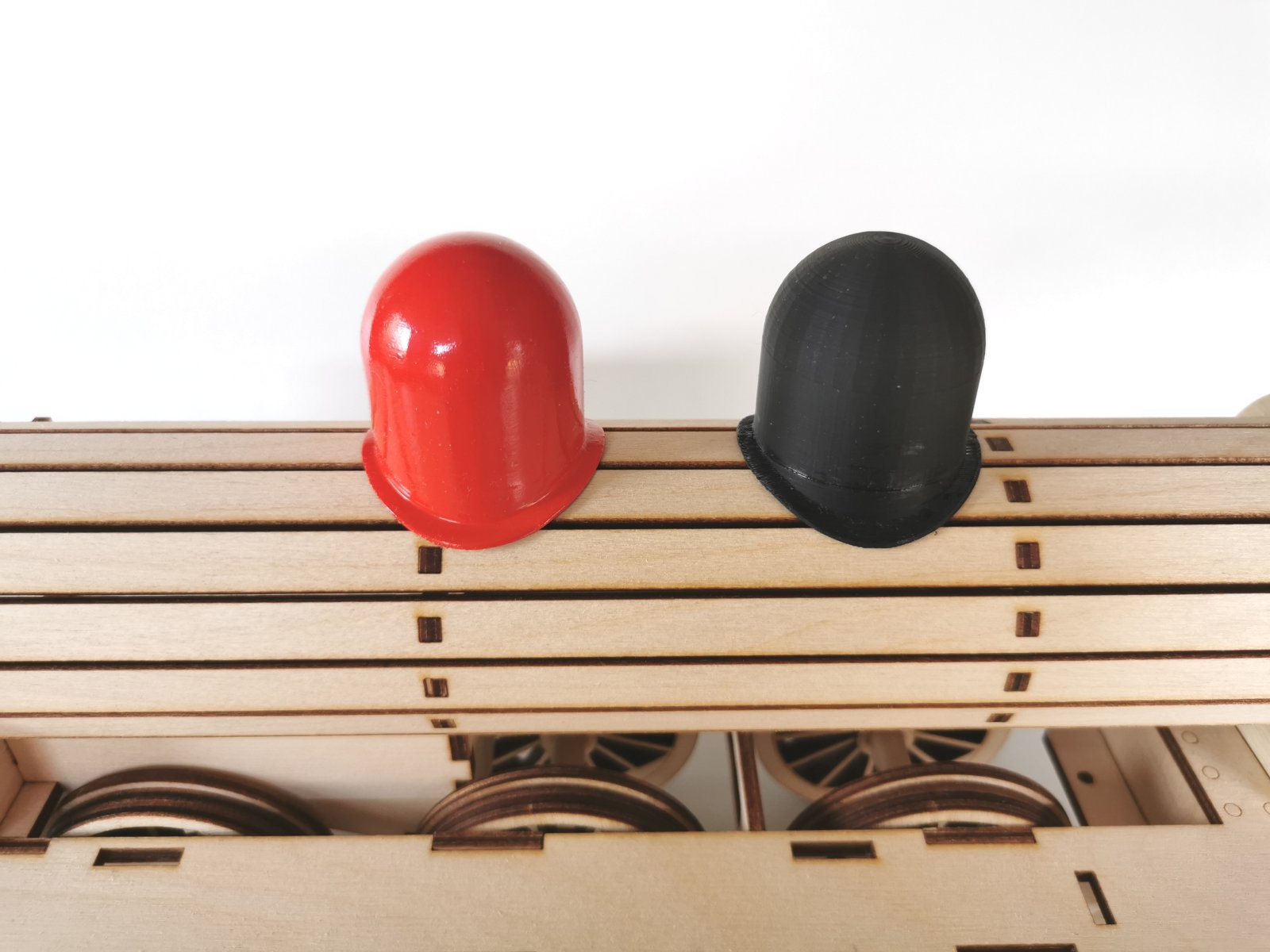

been 3D printing some bits, initially wanted it to be just wood as all the laser cut models I have done in the past are all wood apart from maybe a perspex windscreen say on a model car, but realized some 3D printed bits would be more practical and look better especially for steam dome and chimney, which I have already done as can be seen from my early picture of the initial mock up.
Tanks caps & steam valve
The Steam valve
The one above is on the "cosmetically" restored meenglas but from columkille inside museum and other pictures I have seen the base seems to have been red not black so I will print another one later, also want to add bit more detail to it around bottom nuts etc.
Also printed another steam dome and sanded it then painted it red, took about 5 coats after the plastic primer but looks well.

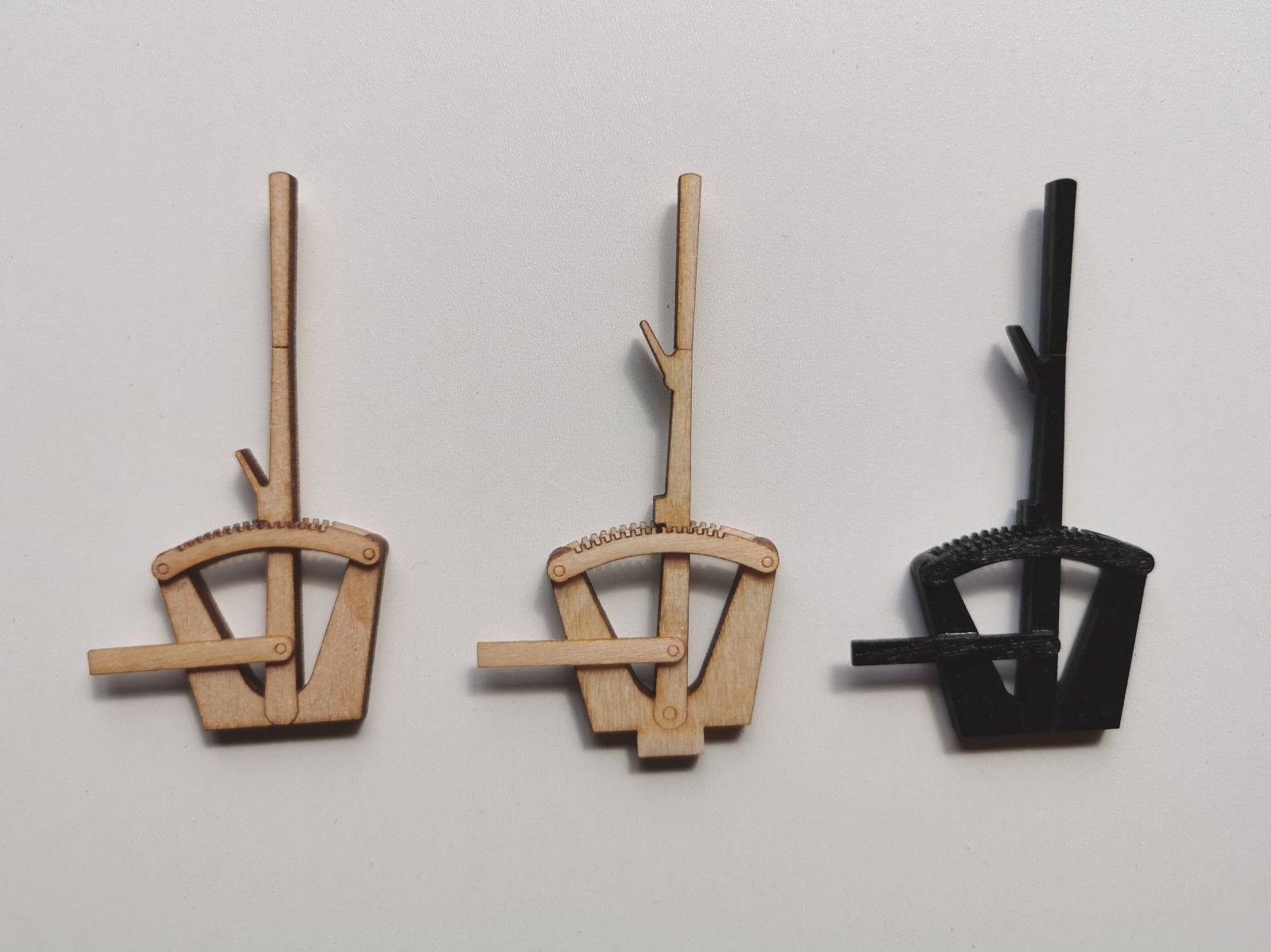

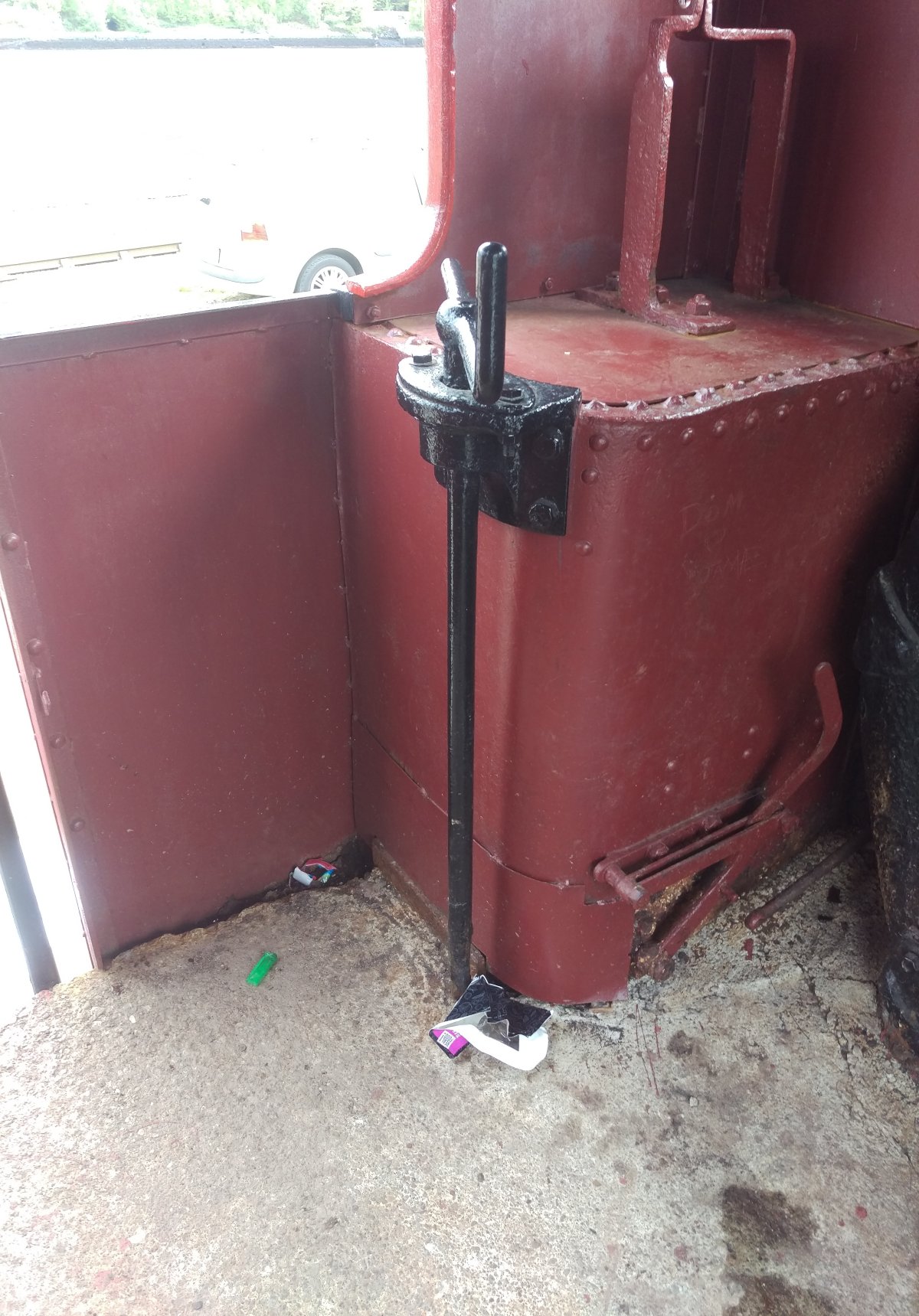

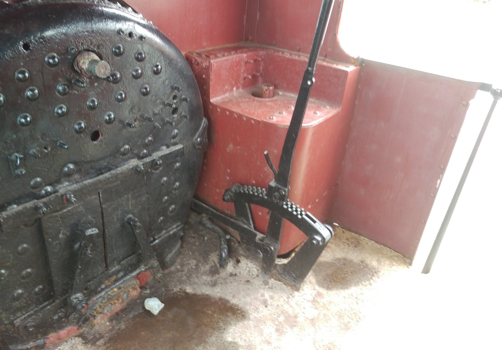

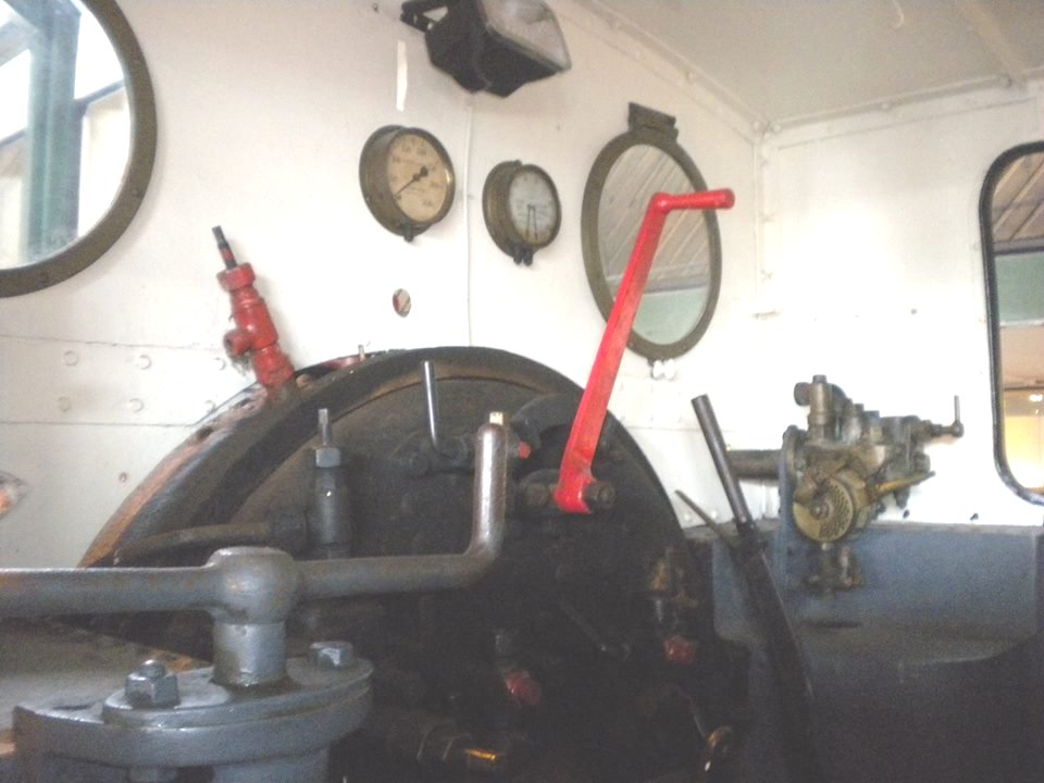

Some details for inside cab, regulator, reversing lever and brake are the obvious ones for now
Discovered differences on reversing lever on meenglas and columbkille in regard to locking lever, no idea yet which drumboe had so I done both plus one for my painted version.
Brake is easy enough just bit 2mm dowel, same as used for hand rails each side of door.

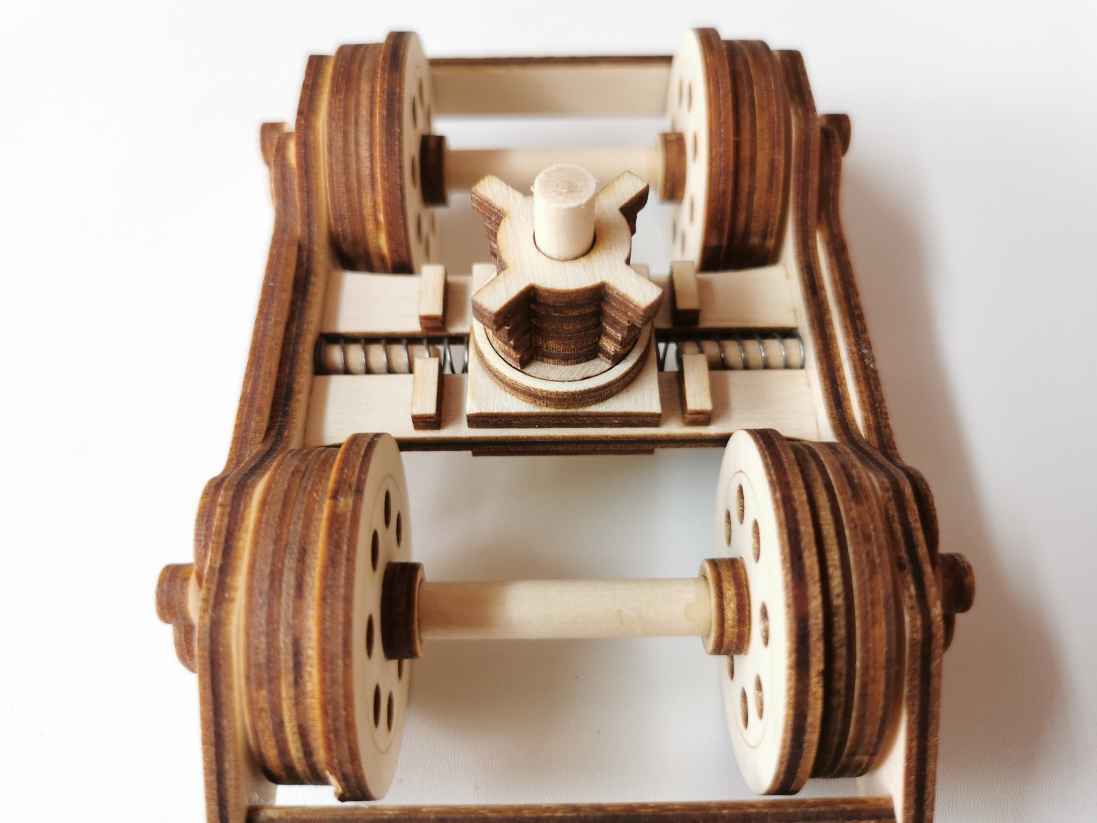

Made up some of my own lasercut LGB R3 curves to test and apart from problems with rear bogie which I will mention shortly the front pony truck is limited by cylinders, but it does just fit PIKO R5 which is bit larger in diameter at 2486mm, so this looks like the minimum radius track without doing "non scale mods".

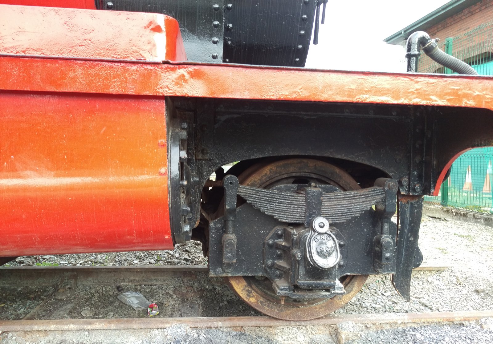

But discovered I made a design flaw on rear bogie, :error: I just have it swiveling in the middle which obviously dosnt work for going around curves, as initially this was just going to be a static model and it didnt really matter, now that I put so much time into getting all the linkages etc working, I would like to get as much of it right as possible.
I did see the springs each side on the bogie in prototype picture below, but didnt really look to see why, as never studied it much but now I realise the whole bogie could move side to side which make sense :oops:
So doing a redesign of my rear bogie tonight !

Post by SeamusOD » Sun May 10, 2020 1:08 pm
New design of rear bogie, basically done as the prototype the bogie rotates in the ring on the centre plate which also can move side to side, there is about 3mm movement each way with the stops in present position but on next one I will move them out another 1mm. The cross shaped support pillar will be fixed to chassis, bogie pivots on the 6mm dowel.
It tracks well on curves now, minimum at the moment is PIKO R5 at 1243r will need some mods to front pony truck to get it navigate a LGB R3 might look at that at later stage.

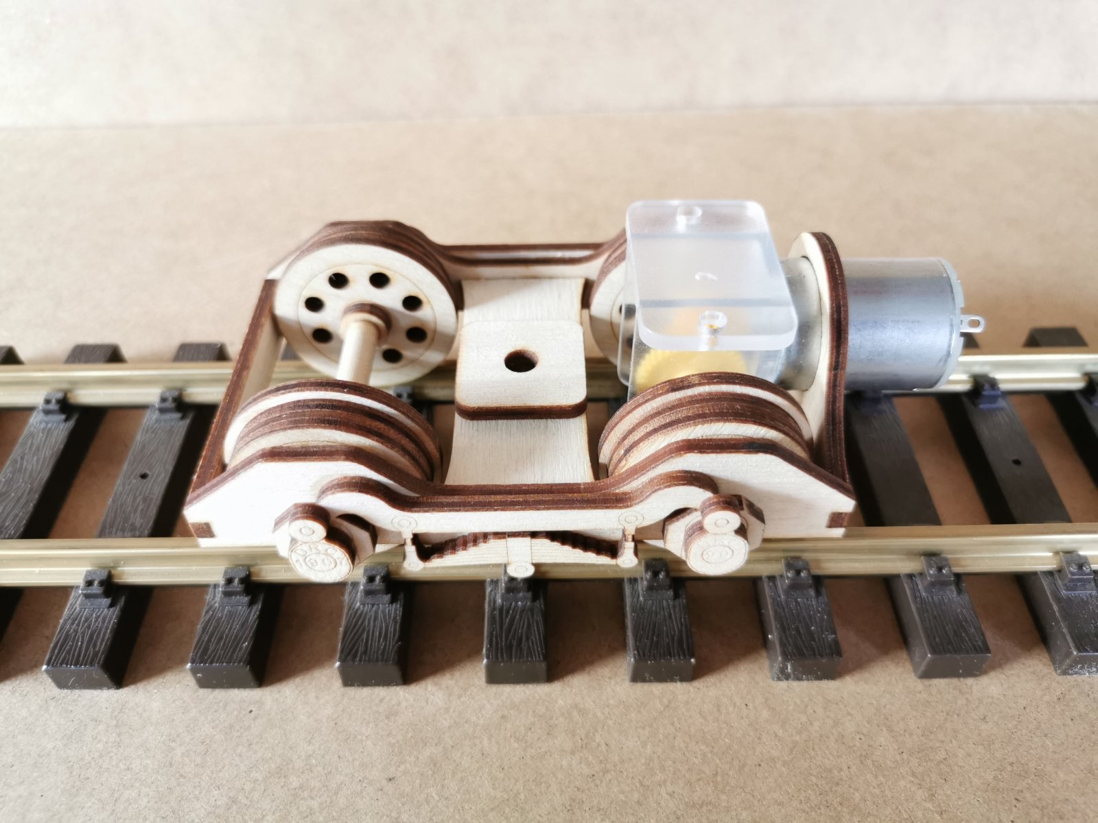

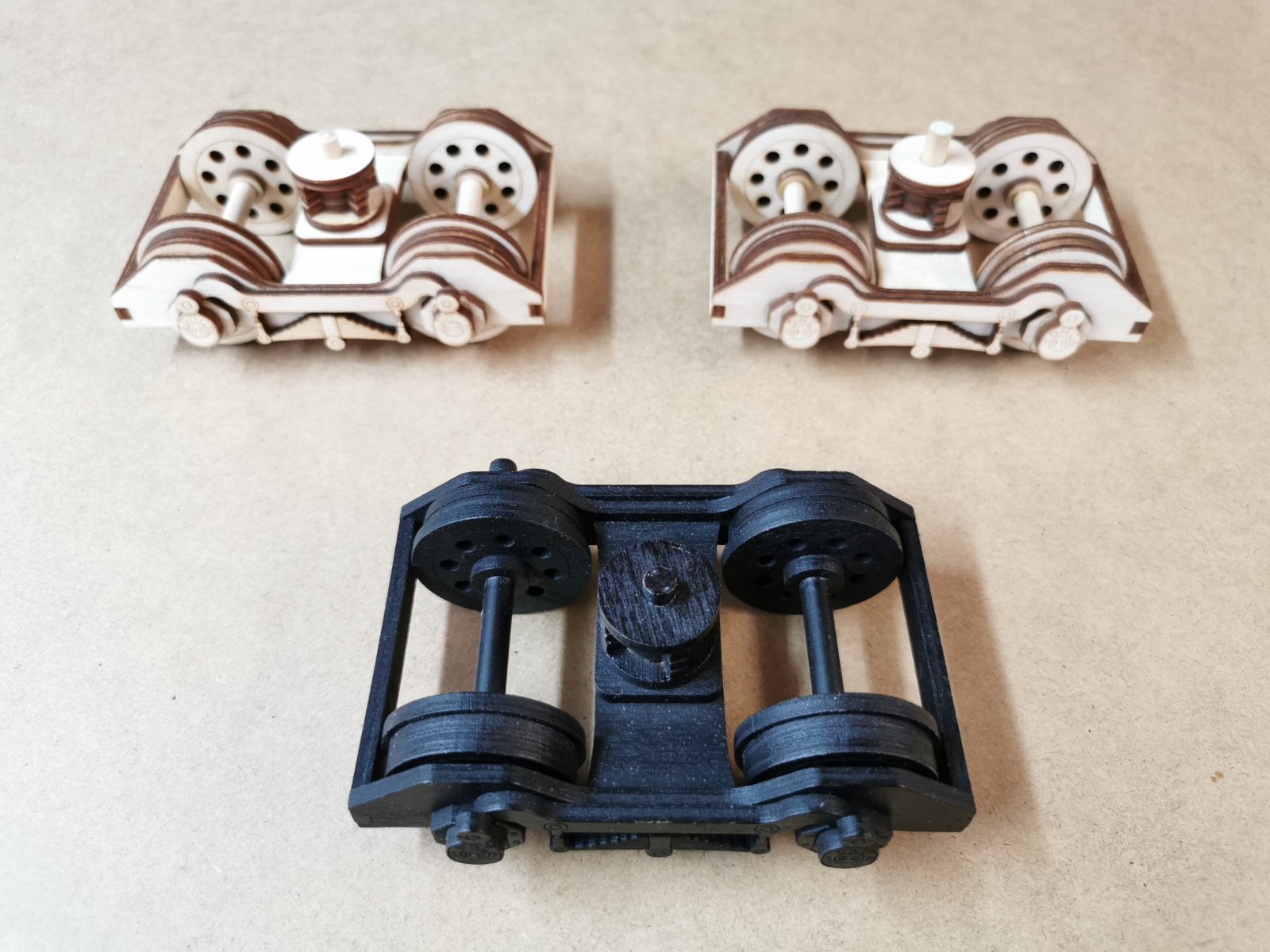

Post by SeamusOD » Sat May 16, 2020 4:01 pm
As I have now re-designed the rear bogie I have a few of the old ones, which I think will be ideal for a coach or rail car, had a plastic motor and gearbox lying around so made a end plate to suit seems to work well on 4.8v
