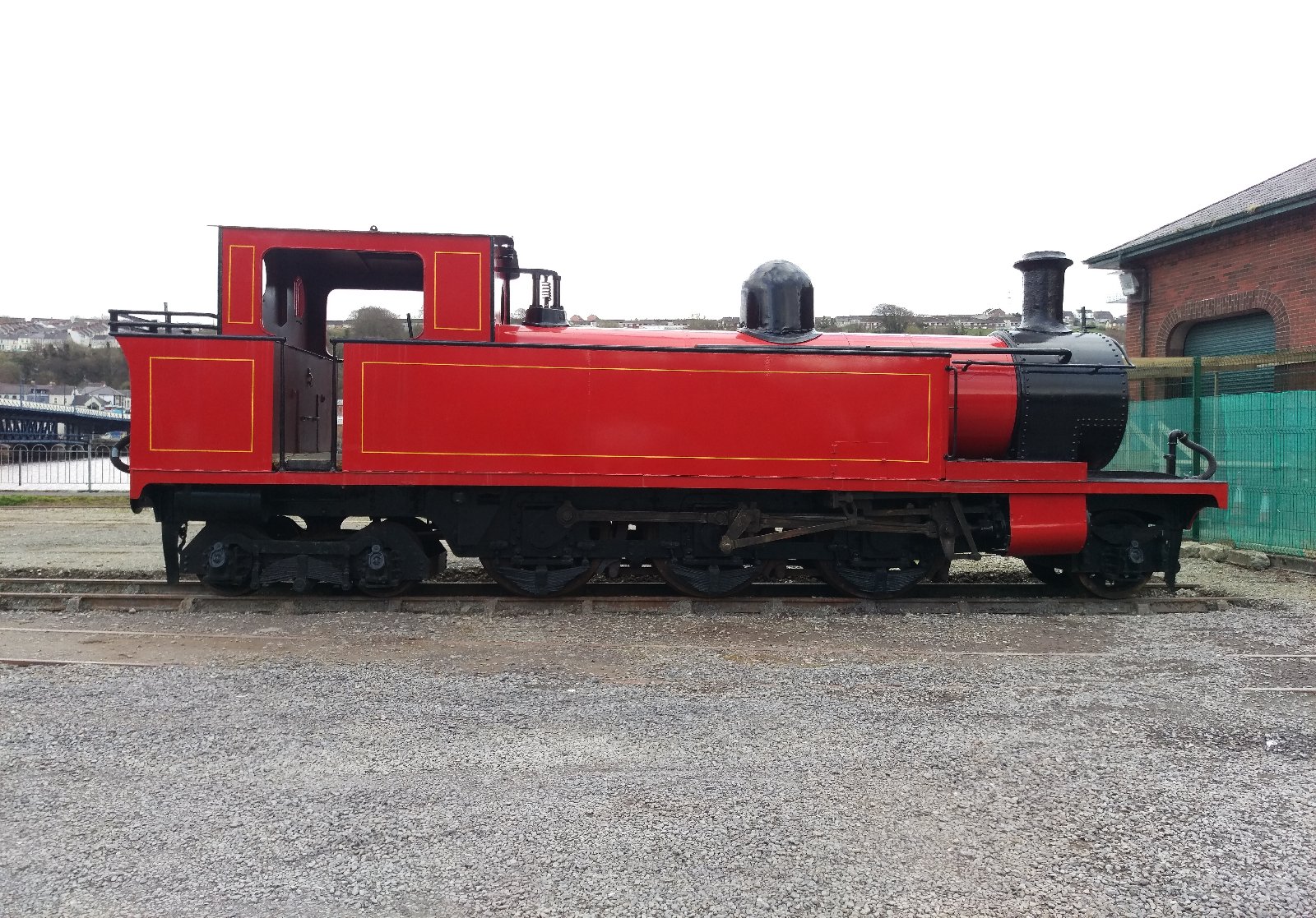

2019 is the 60yr anniversary of the closure of the narrow gauge railway in Donegal and this has spurred new interest for me personally in the Donegal railways.
Likewise with this 60yr anniversary the Donegal Railway Heritage Centre www.donegalrailway.com are trying to raise funds to get the 4-6-2 Class 5 Drumboe back on display at the museum, initially as a cosmetic restoration, but ultimately back to steam which would be amazing to see. So to help I am working on a a 15mm scale (3ft narrow gauge to 45mm track) version of the Class 5's initially all in plywood as I can do it on my laser cutter, which will be available as a kit and generate some funds for the Drumboe project.
Drumboe at the moment is in bits at the railway preservation society in whitehead, but one of her two remaining sisters Meenglas has just came back from a cosmetic restoration and sitting outside the foyle valley museum. below For Narrow gauge these are a big locomotive over 30ft long, and I think around 44 ton.
Having access to meenglas allowed me to go and take loads of pictures and measurments which I have drawn up everything in autocad initially fullsize then scaled down to .0492341 1:20.3 or 15mm scale, having it drawn fullsize allows me to scale it any size really, and having them as proper cad files means down road I could get it made in metal.

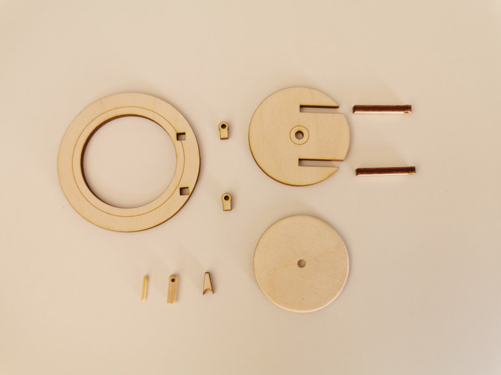

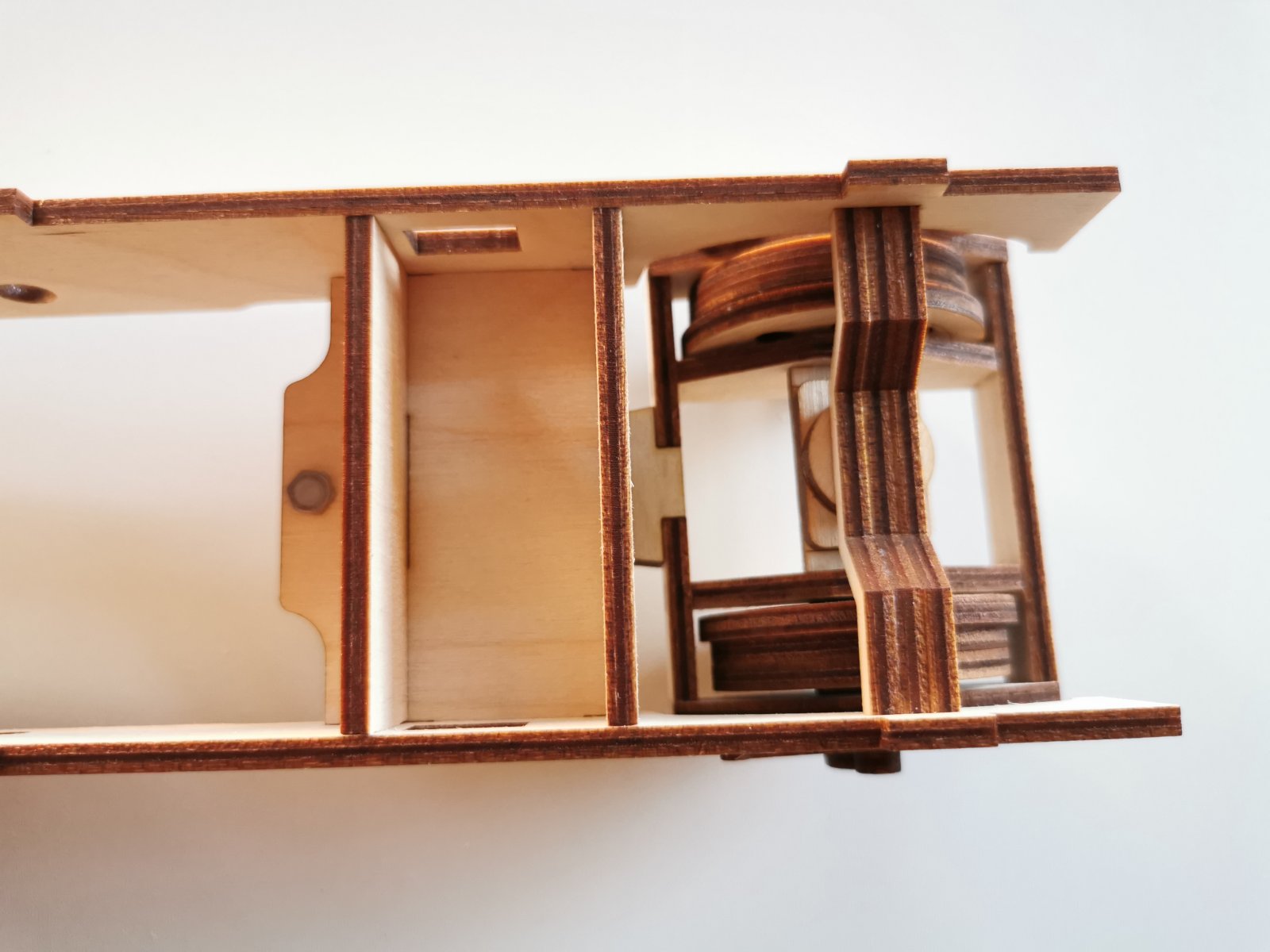

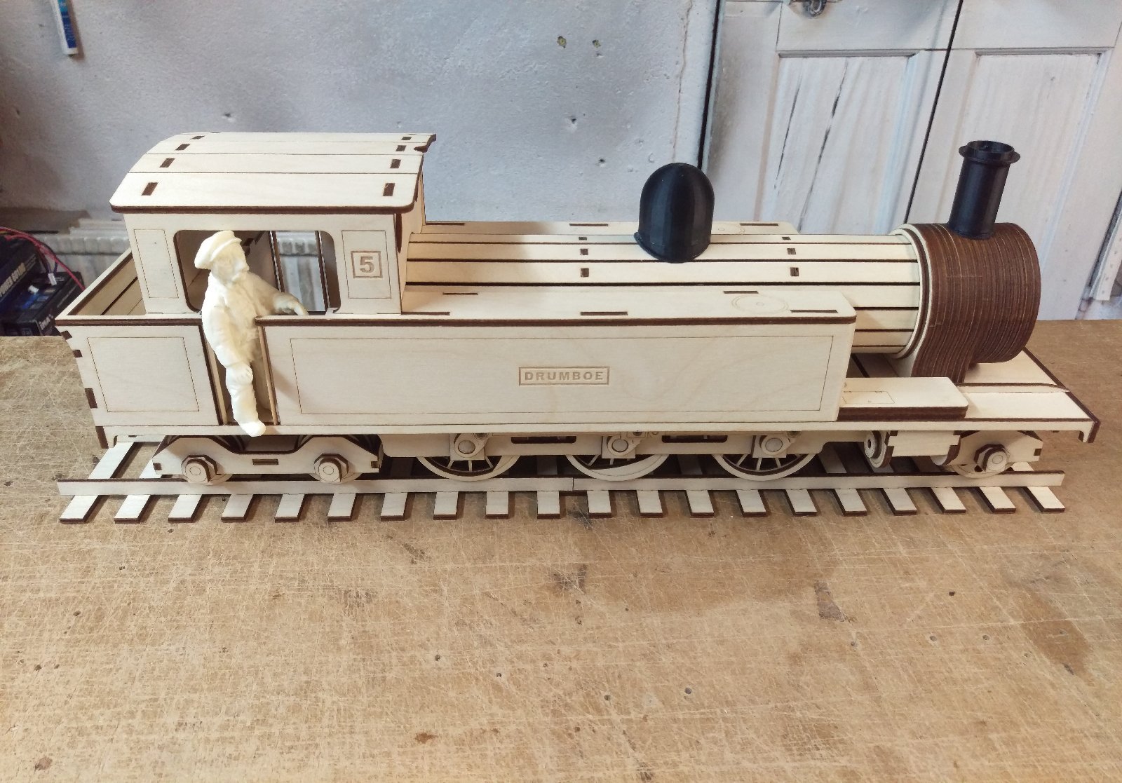

This is my first mock up it was rushed together to have in time for a event at the museum a month or so ago, its the basic framework, wheels etc just temp fixed in place, not much else I could do with this type of construction for the boiler, think it will be ok for a static model, in the meantime will look out for a suitable tube about 55/56mm dia, for a full painted one that might roll one day.
smoke box is made up of 15 rings, steam dome and chimney I just 3dprinted for speed but I think might stick with 3dprinting for these especially for the steam dome as I have another made with bigger flare and painted red and it looks fairly good.
There are other details I think will be more practical to 3d print rather than laser cut so its probably going to have both materials rather than initially intended all wood.

Re: Donegal Railway Class 5 Drumboe 15mm scratch build
It is a big beastie. Must have been quite a bit of work. How do you do the boiler if you are laser cutting wood?
Don
I typed this in then the picture above appeared when I submitted it. So it is a series of strips. I supposed you could then roll some paper round them to get a smooth shape?
Don
Not really many other ways to do it other than like smoke box and series of rings, but yes you could wrap it or I think better try to find a cardboard/plastic tube or wooden hand rail same diameter.DonW wrote: Thu Sep 05, 2019 11:26 pm It is a big beastie. Must have been quite a bit of work. How do you do the boiler if you are laser cutting wood?

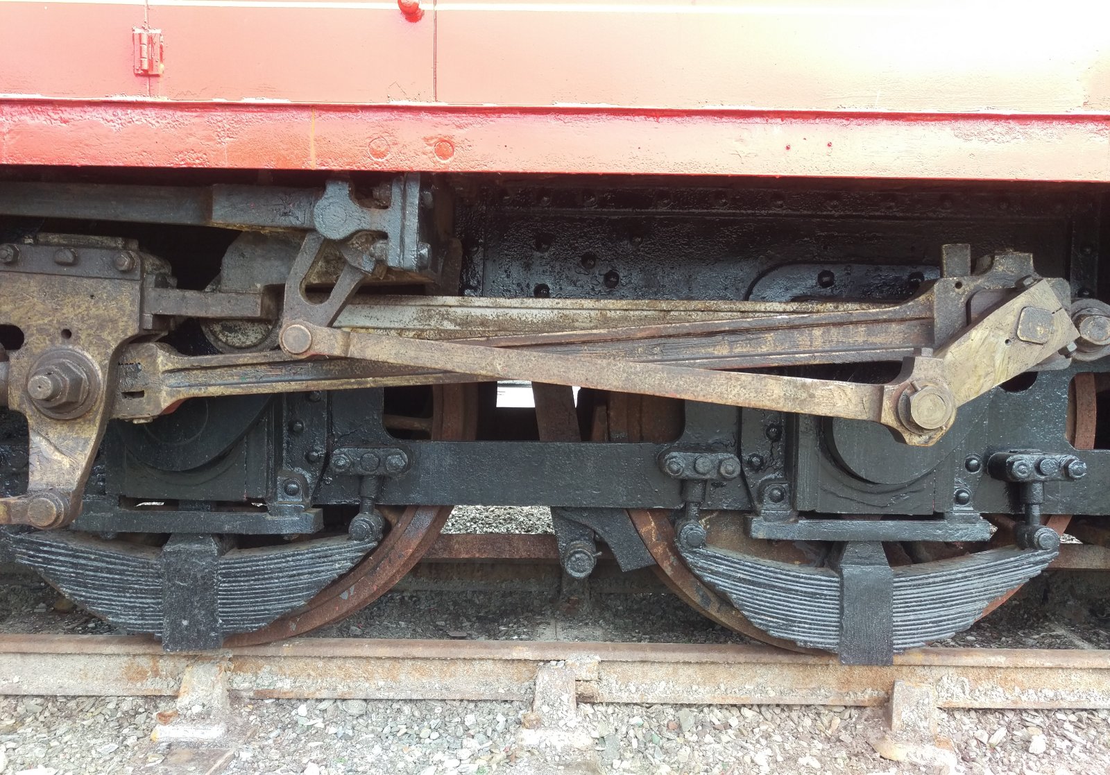

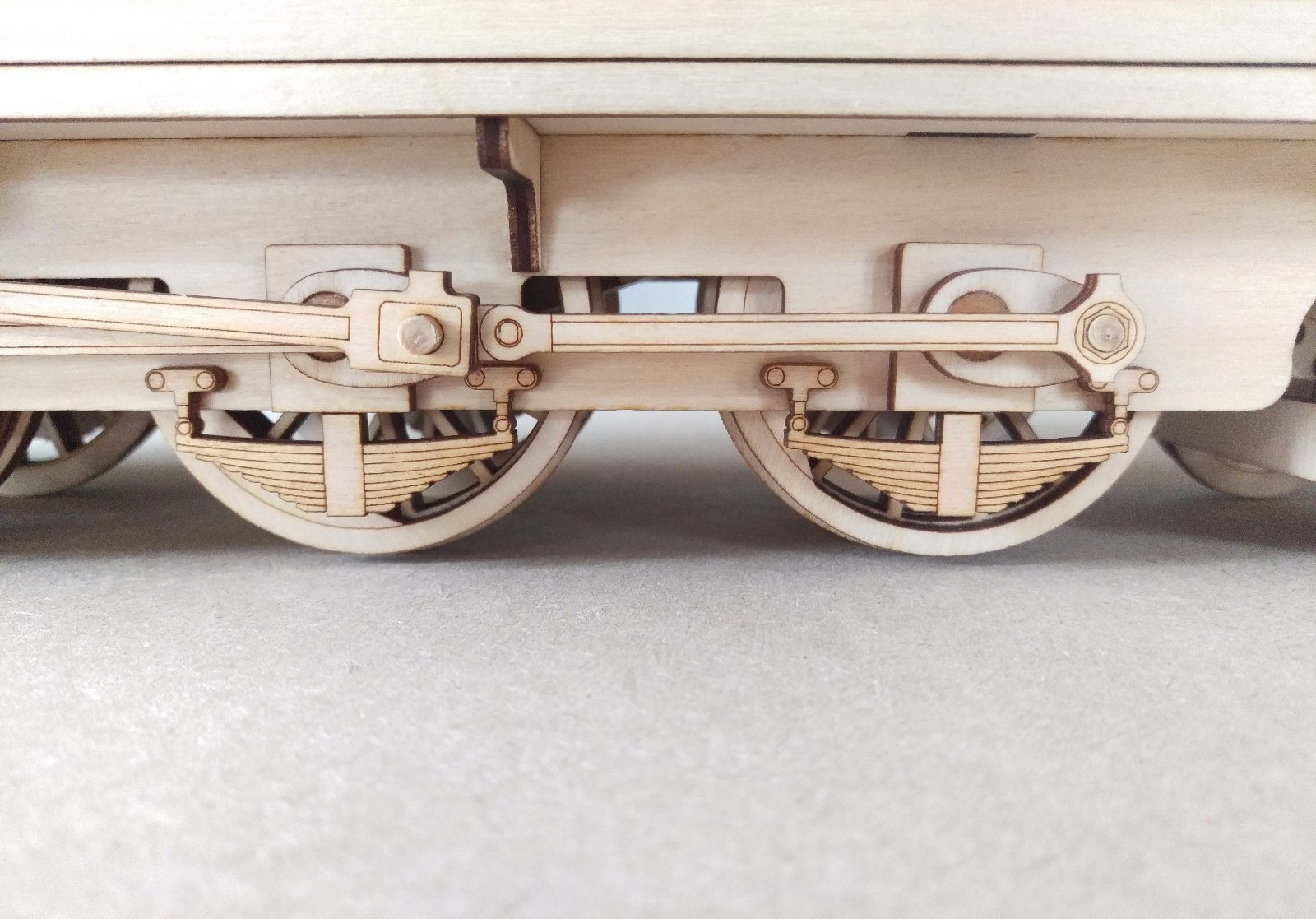

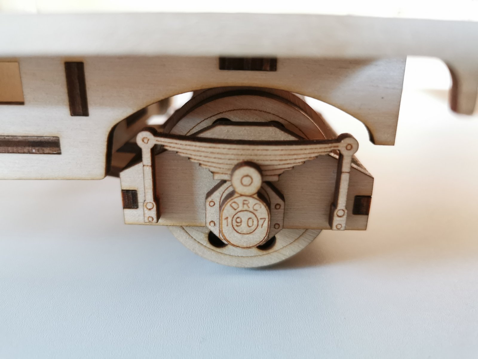

Been working on adding the suspension springs and other details to bogies and main wheels

Wow! That's stunning. I wish I had a fraction of your expertise - the possibilities seem endless.

I agree, it's looking wonderful! The detail's amazing... Having done just a little CAD myself, I'm VERY impressed with those lovely curves on the bogie...BertieB wrote: Mon Sep 23, 2019 10:47 pm What an attractive locomotive. Extraordinary construction too. Terrific.

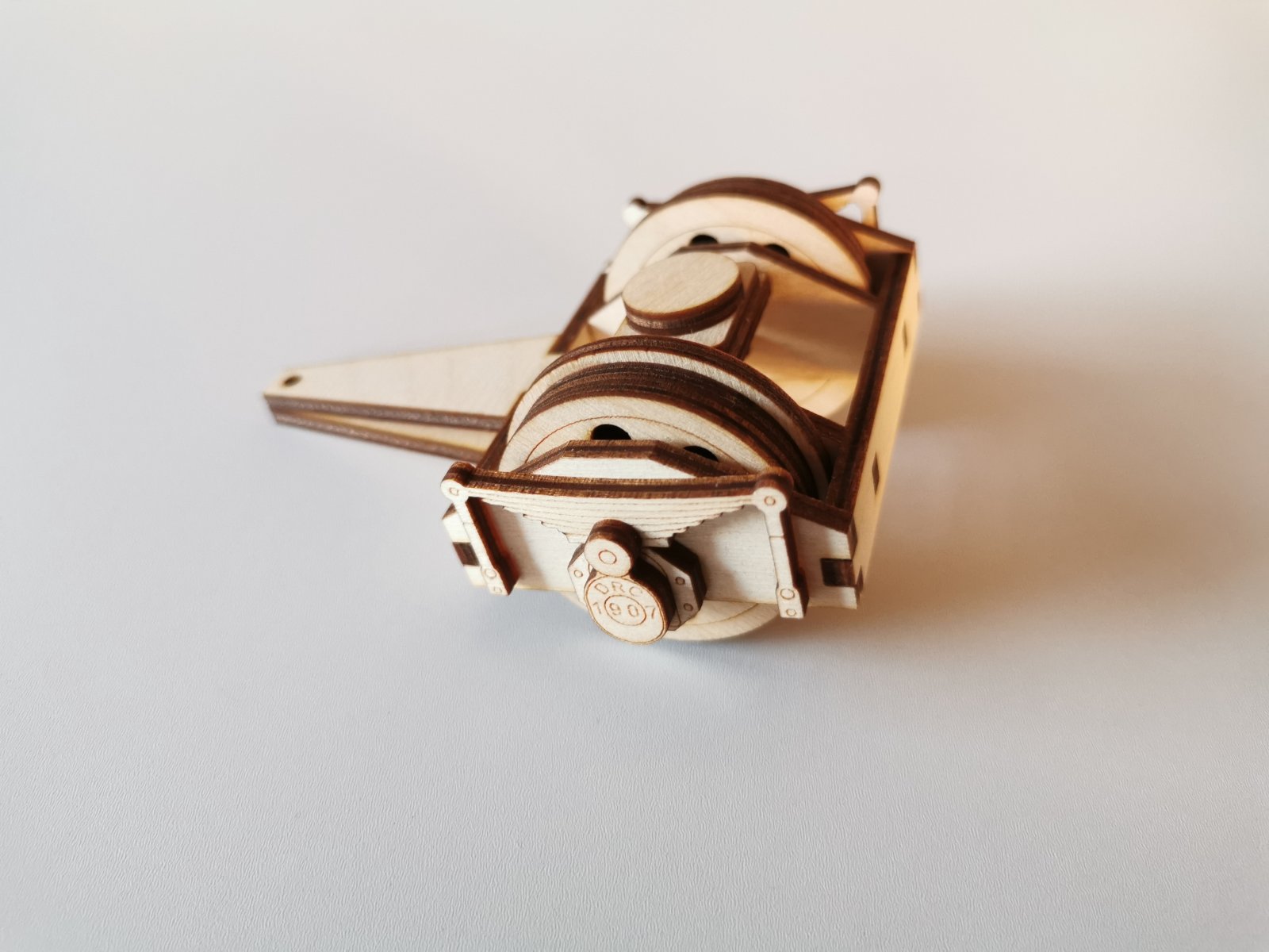

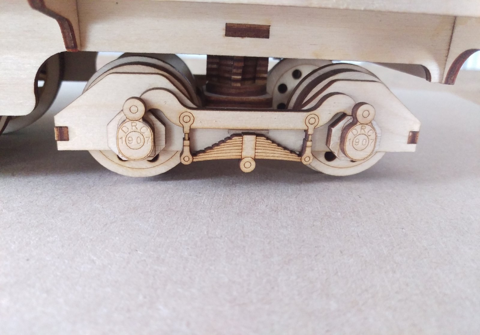

Back again, been at this on and off since last post but been working on it everyday for past two weeks so I can get it finished now being a good time, during C19 lockdown
To catch up I was last working on the suspension bits and below is the front pony truck, with its suspension and axle cover done. Wheels on it are bigger than the ones on rear bogie. Fronts are 2'9, rears 2'3" on Fullsize, model are 41 & 34mm, Fullsize mains are 4' model 59mm. You can see pivot arm and bump stop (dont know proper term) plus in bottom picture the pivot point on the chassis and cross beam where the bump stops slides from side to side. Figuring this out took about 3 visits to the prototype Meenglass as it is sitting fairly low at front, dark& rusty and hard to see get good pics.

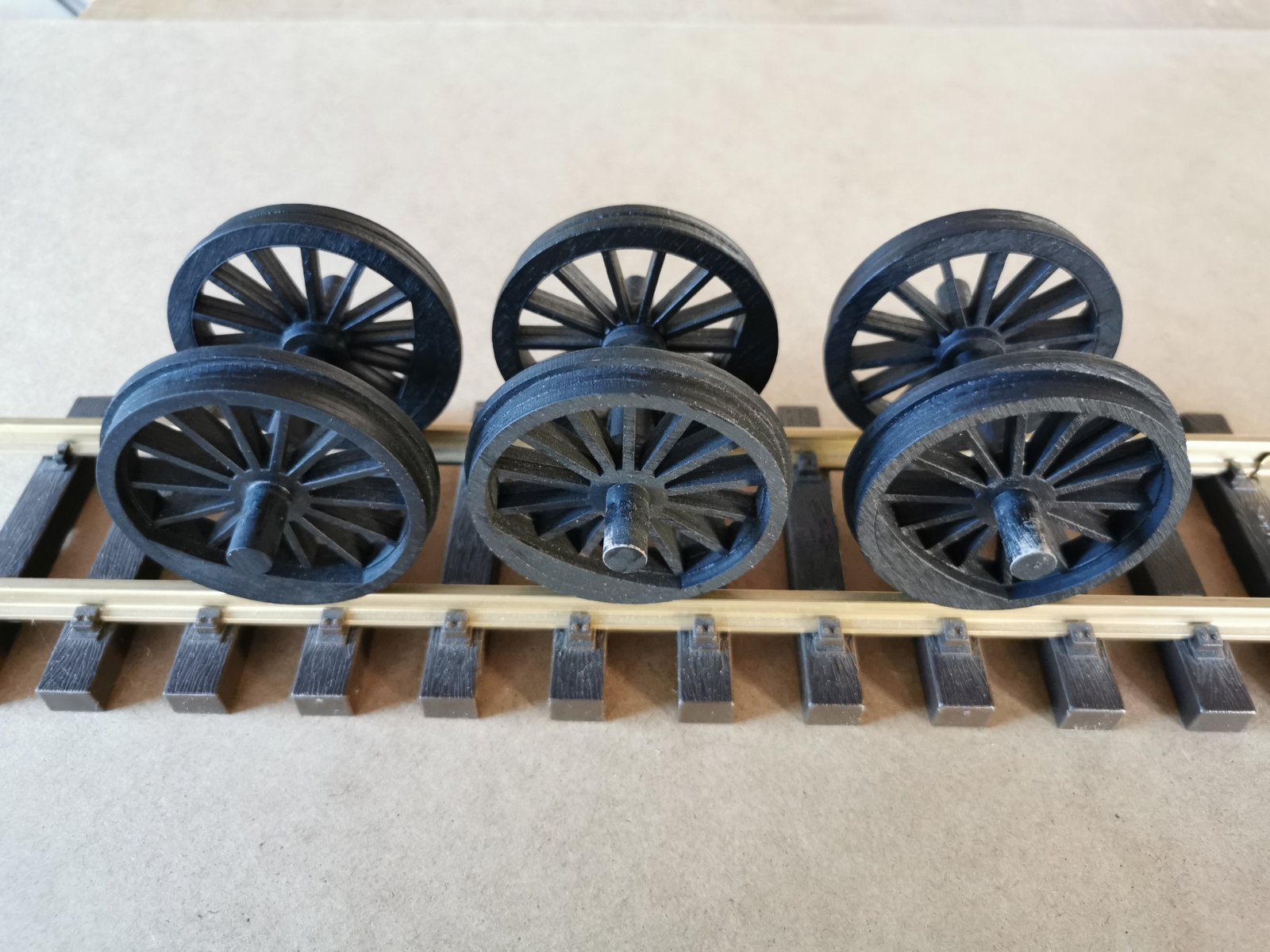

Rear bogie and front pony truck painted black they dont look like wood anymore, not easy to get good photo when its black, As I go along I am building two more models one to paint and other to proof everything fits.
Yes painted the main wheels and axles as well and they look great be ideal on their own outside an engine shed etc

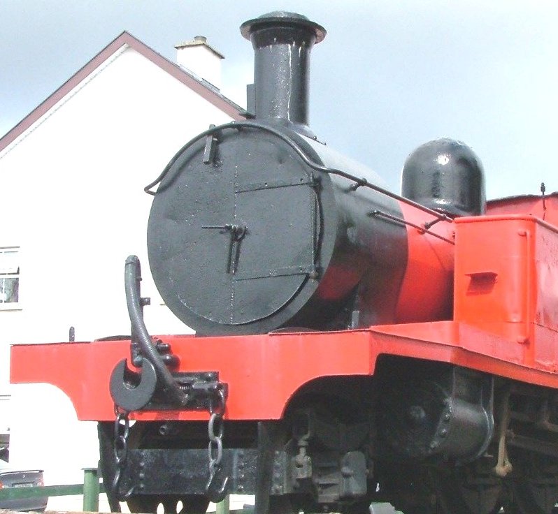

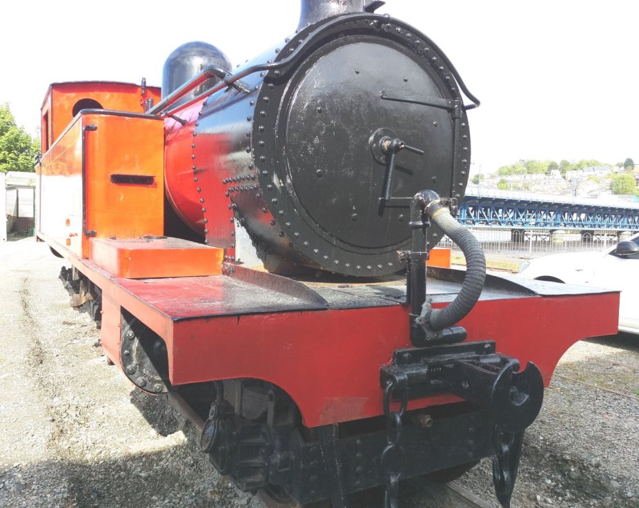

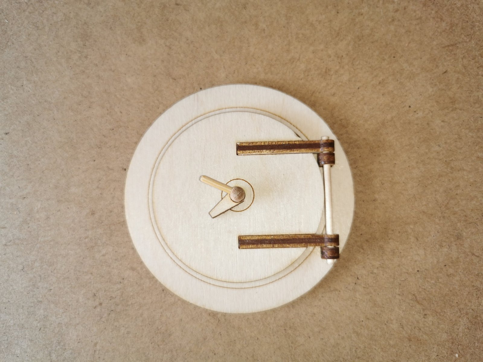

Smoke box door, wondered for a while how to do this then when working on something else it came to me, I could have made a dummy door but wanted it to open, so below is the method I came up with, 2mm dowel (tooth pick) for hinge,
There are some variations in the 3 class 5's that are left and one is Drumbow dosnt have any rivets around from of smoke box, which makes job easier

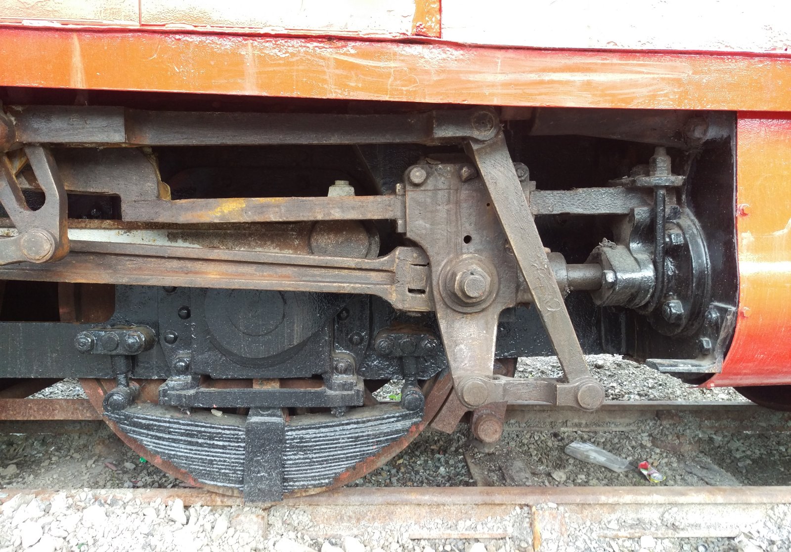

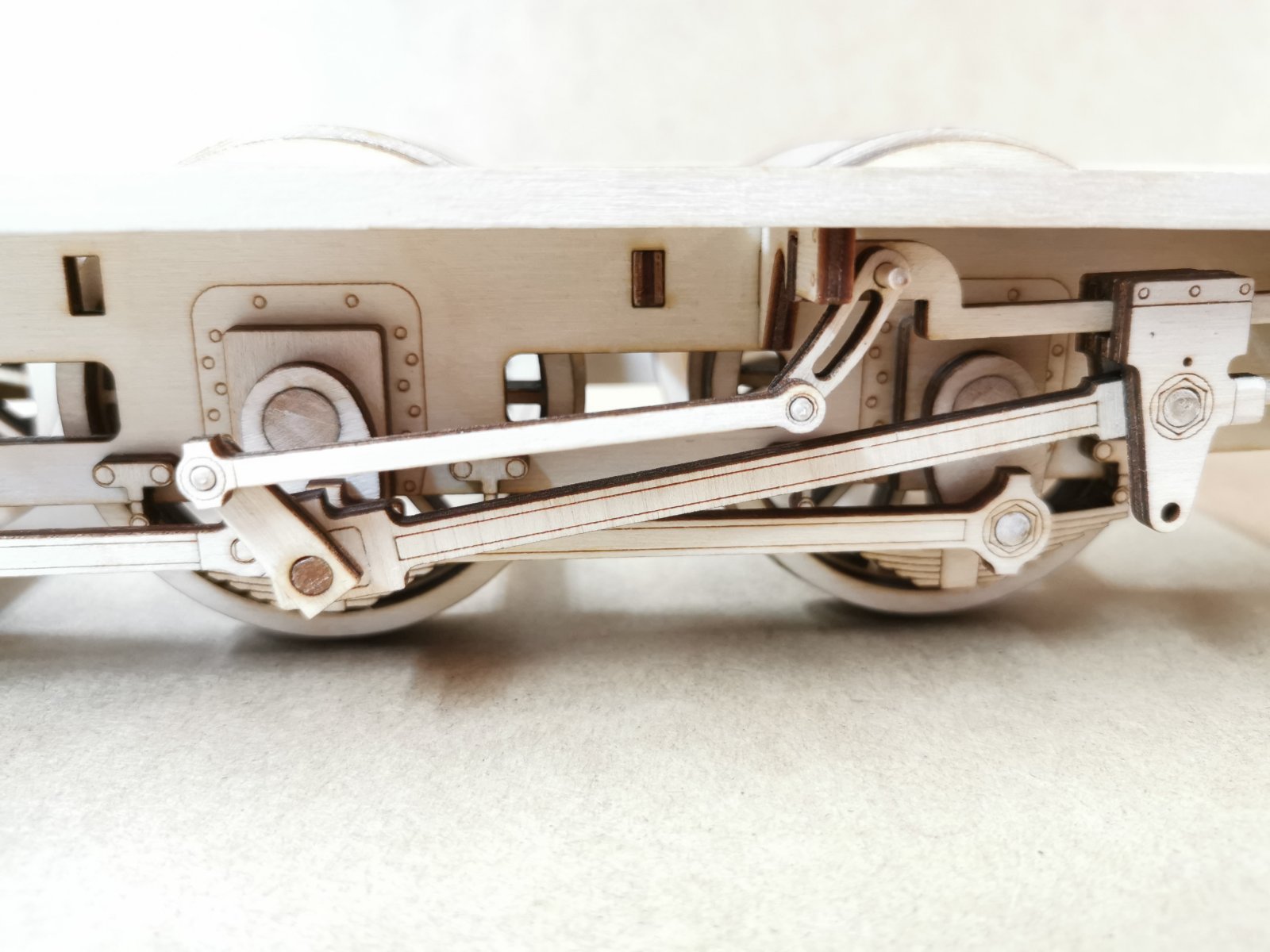

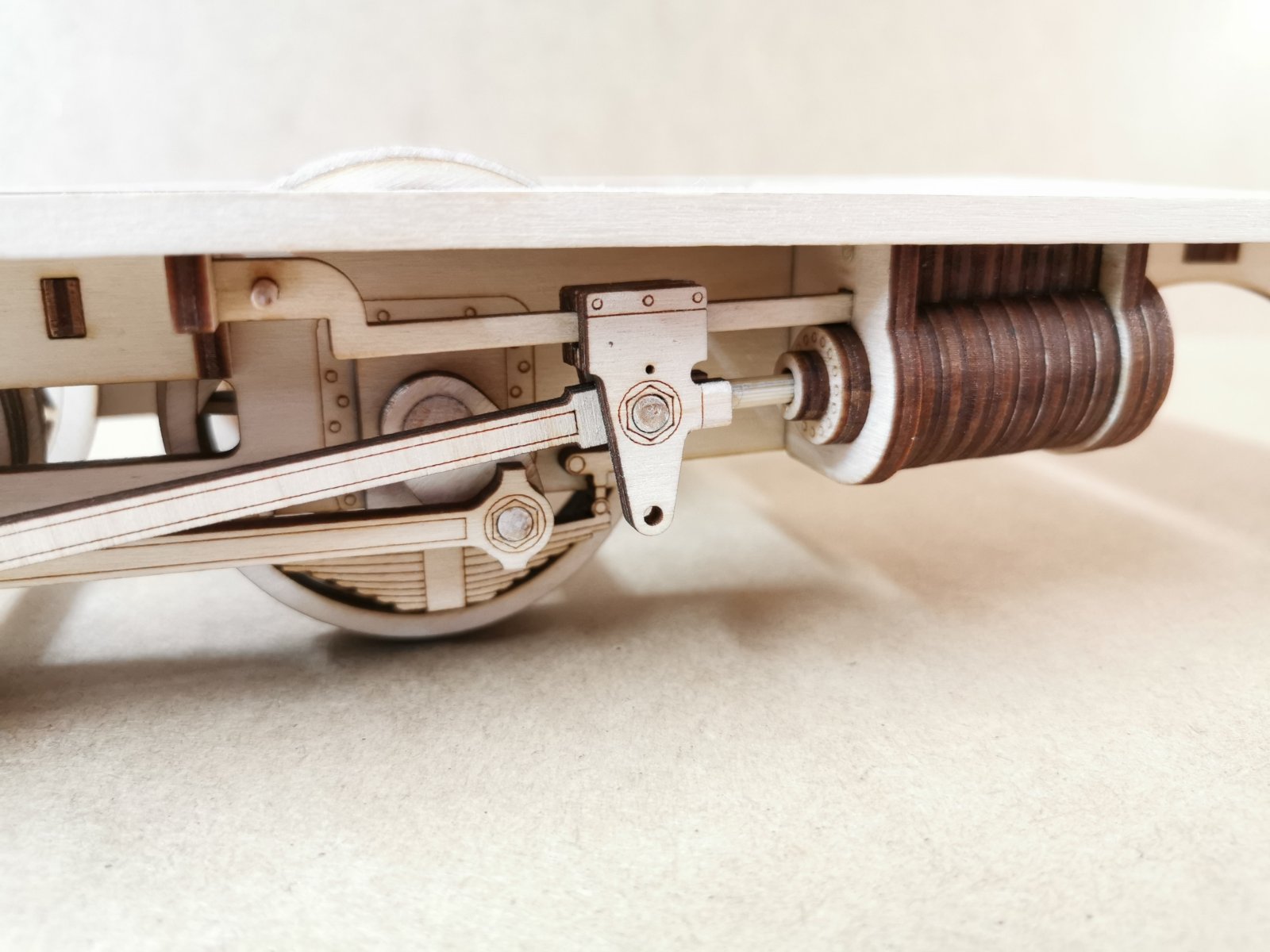

Back to the drive gear, made the cylinder as it looks under the cover, its slightly angled down as can be seen from the crosshead slide, I wasnt certain on what angle but made it when the centre drive wheel crank was horizontal, the connecting and the piston rod are inline, and this looks correct.
The piston rod is free to move in and out with the con rod and I made the crosshead so it does slide up and down the slide, took a bit of figuring out but my dimensions from Meenglas scaled down are fairly accurate.
Thanks drawing it in autocad from measurements taken from fullsize makes all the difference, I have found a few measurements that autocad basically says that is not correct, and then when I go next time to the foyle museum to check on meenglas I realised I wrote it down wrong or measured it wrong and autocad was right !

Eccentric crank, rod, and expansion link next, the eccentric crank is located on a flat on the crankpin to keep it in correct "timing" position I just glued it, once all the lengths were correct everything moves ok, no binding.
Will probably redo the expansion link as not the correct shape, but now I have the hole spacings correct easy to change.
As you can see I dont have the link running in the slot have a fixed hole at the top, and the missing upper half as such of link wont be noticed once I add the dummy radius/valve rod.

Final bit of my linkage/drive gear is the crosshead link and combination lever, they were easy enough one I figures out making a dummy radius/valve rod, its fixed but hornby does the same so thats good enough for me
Have done a short video of the whole thing working, I will see where I can upload it to and post link
