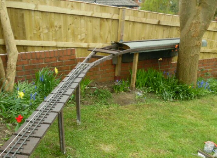

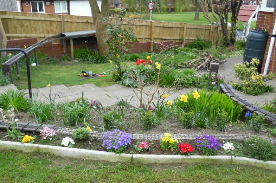

More progress today, getting the other end of the present line ready to cross the path. First off, a quick review of yesterdays efforts.
Its rained overnight but everything looks good and Ive got a reference for the pier I'll be putting in today. First job, build the pier and get it set in position, in POSTMIX again, and checking its level and inline with the existing trackbed.

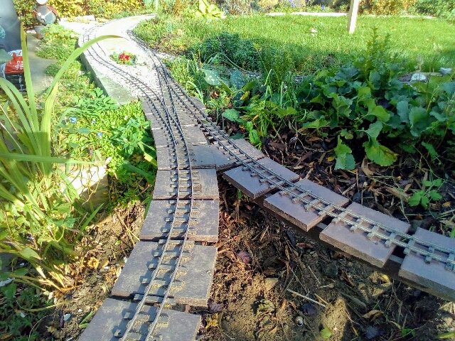

The reversing line comes in very close to this pier so a PECO small radius point was chosen along with matching curves to cut out any problems with dogleg joints in flexitrack, and maintain an even curve. The filcris again went together very easily, Im very impressed, and it wasnt long before the trackbed was taking shape. Single posts were put in around 2 feet apart with the outer rail set a couple of millimetres higher to give a bit of cant and aid progress around the sharp curves. Wheeeee!!!
Again lots of level checking and rail level sighting to get things nice and straight.
It seemed to go relatively easy and soon I had things well sorted and a complete connection. The diesel was fired up to do a few test runs and apart from a slight deviation where the filcris meets the blocks, my fault, I was knelt on the string line!, its looking fine and dandy!
Super elevation I believe?..... Dee Dah....

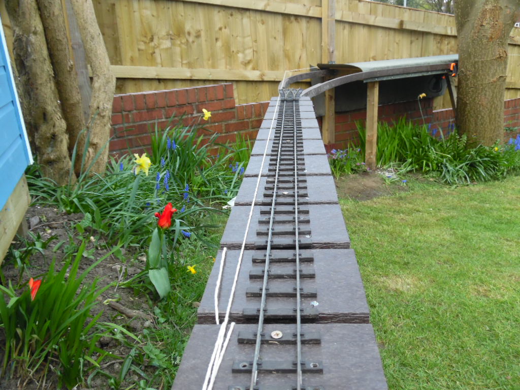

Greetings from the Hollycross Railway Company!! First off, my apologies for the long absence just as progress and interest was bumbling along in tandem, Im back now though and ready to begin the next part of construction, though as some of you may recall, my methodology is somewhat 'unusual' so if anyone who was previously duped
into believing I plan everything meticulously, it may be best to look away now!

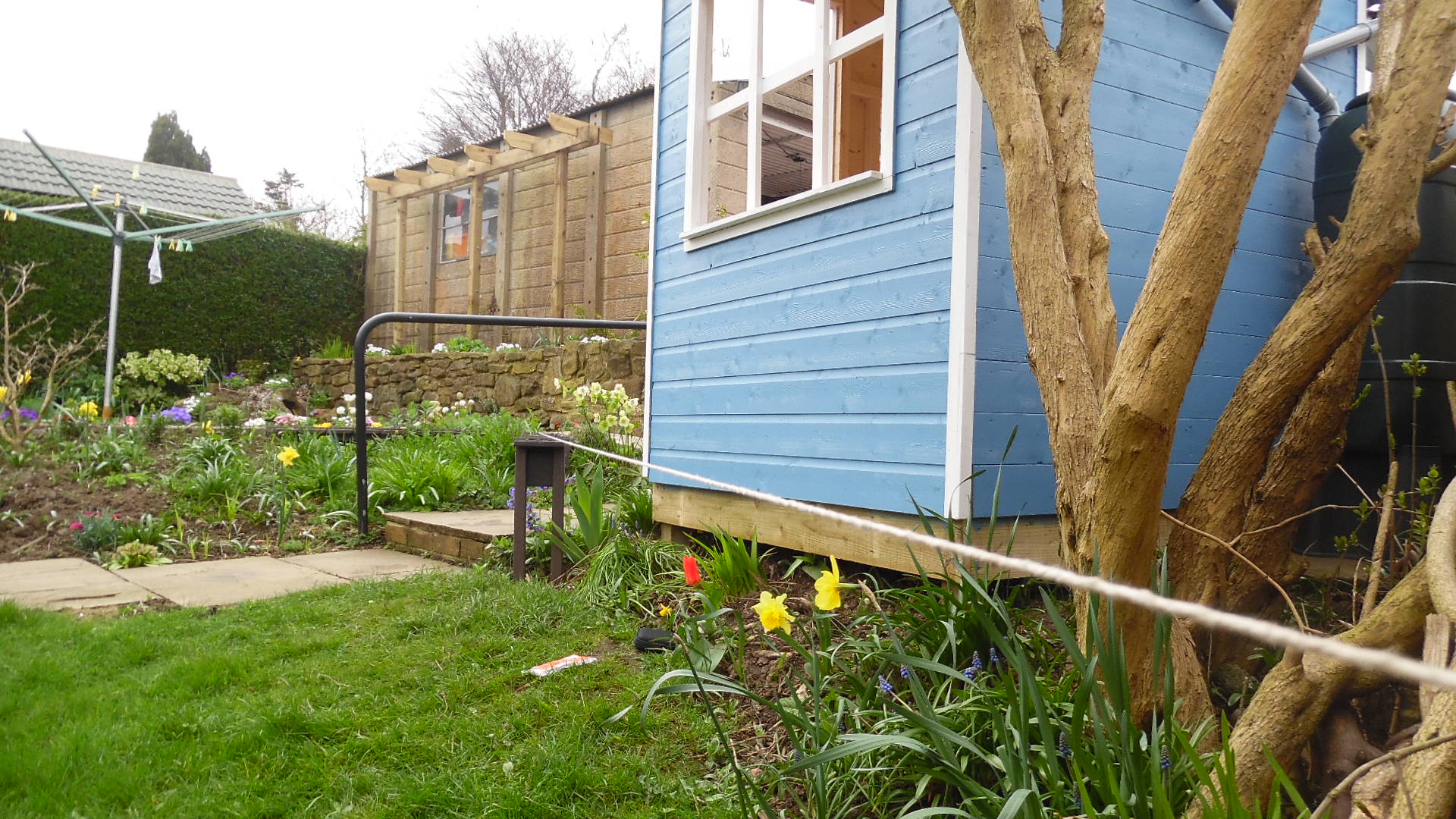

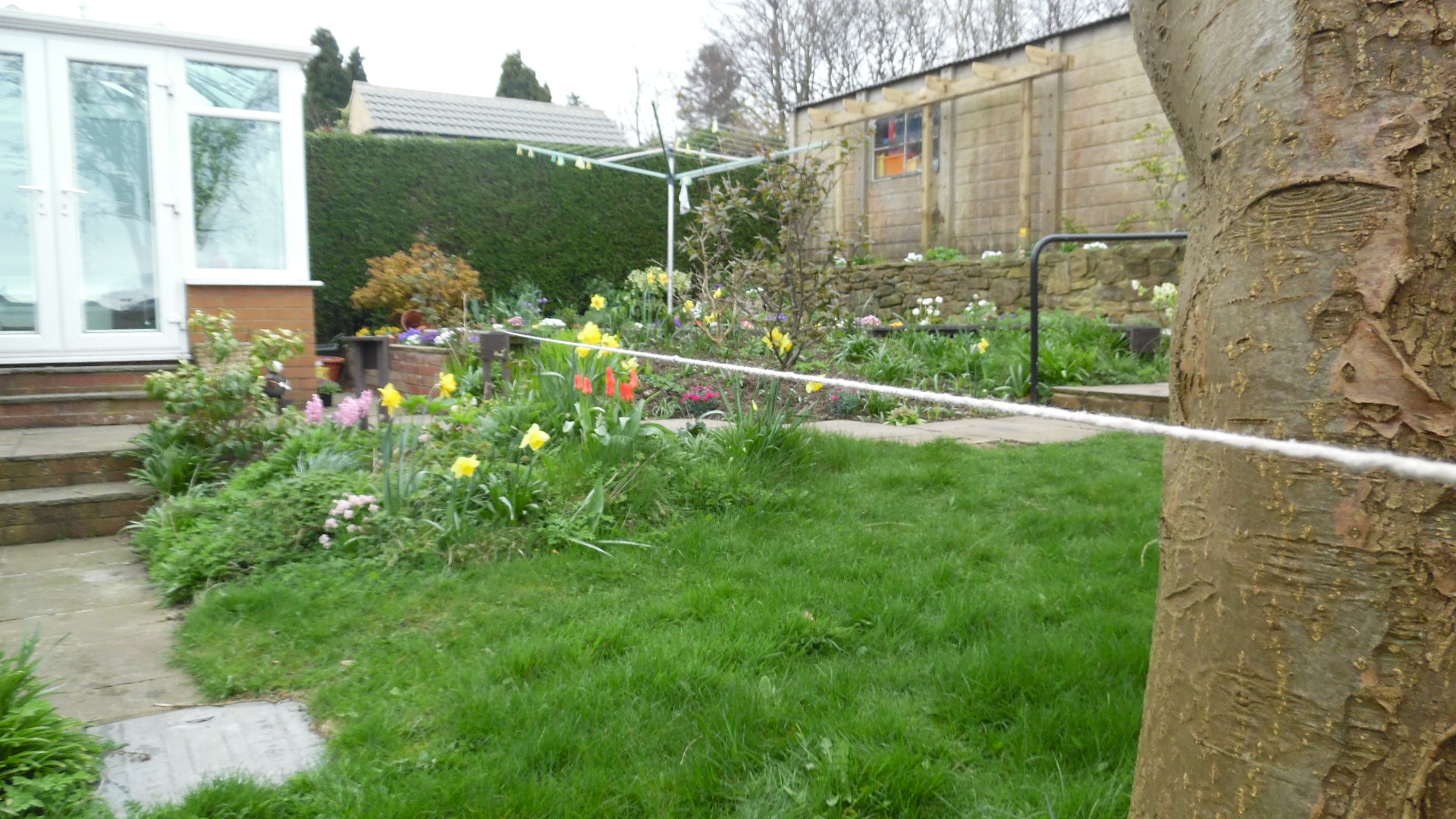

Right, we have 2 sayings in Yorkshire, one is 'Ey up cock!', the other is 'OW MUCH?!', so when Lord Hollycross approaches anything like this, its very much what was good enough for the Romans, its quite good enough for him, Thank you very much! So...

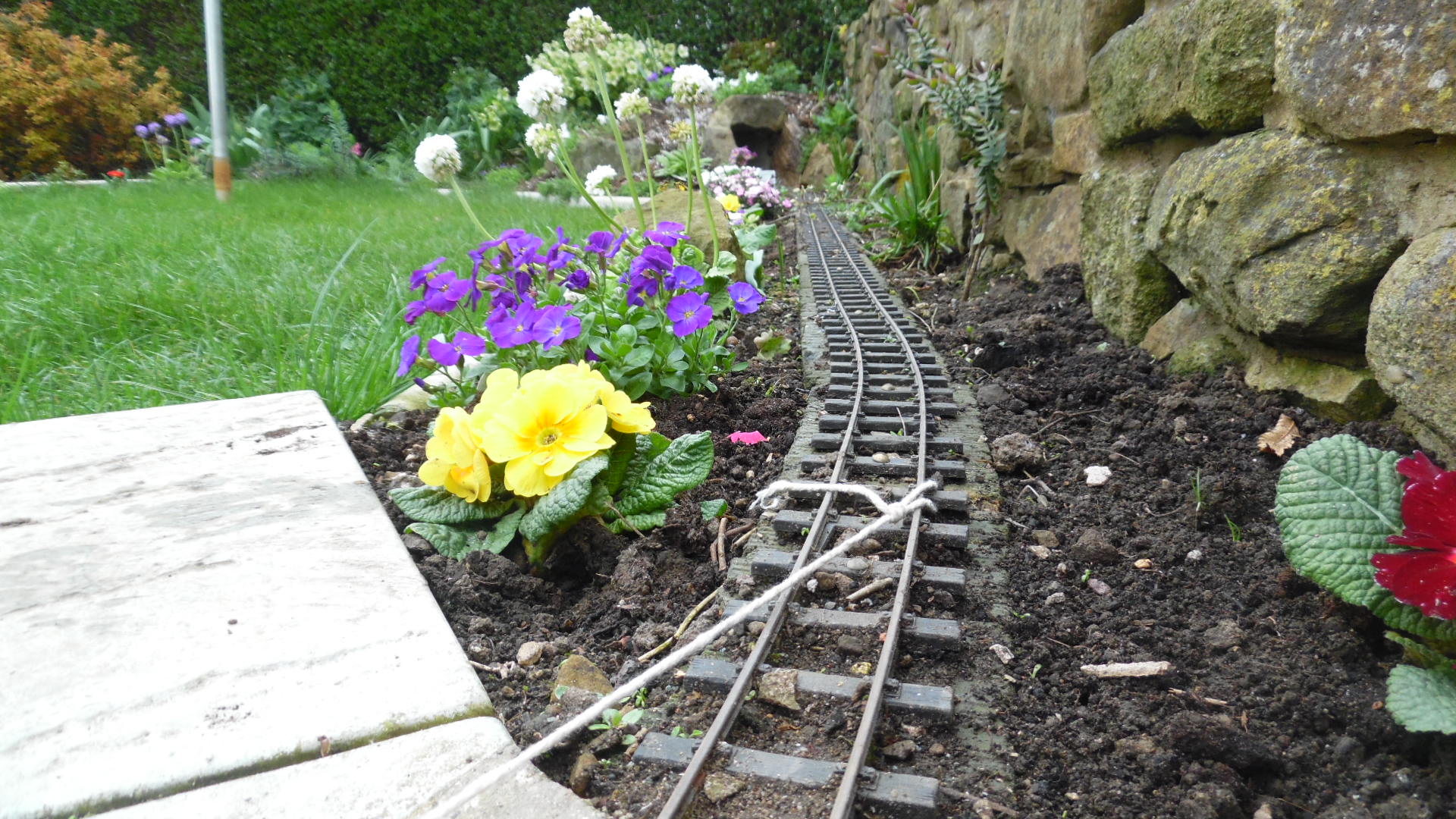

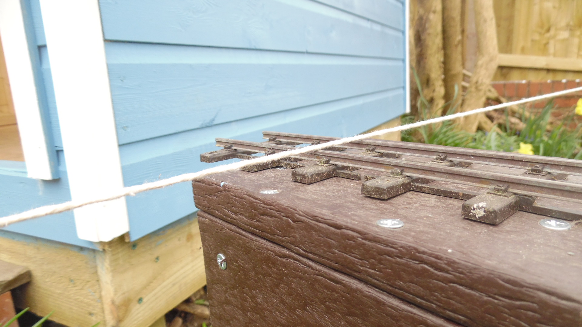

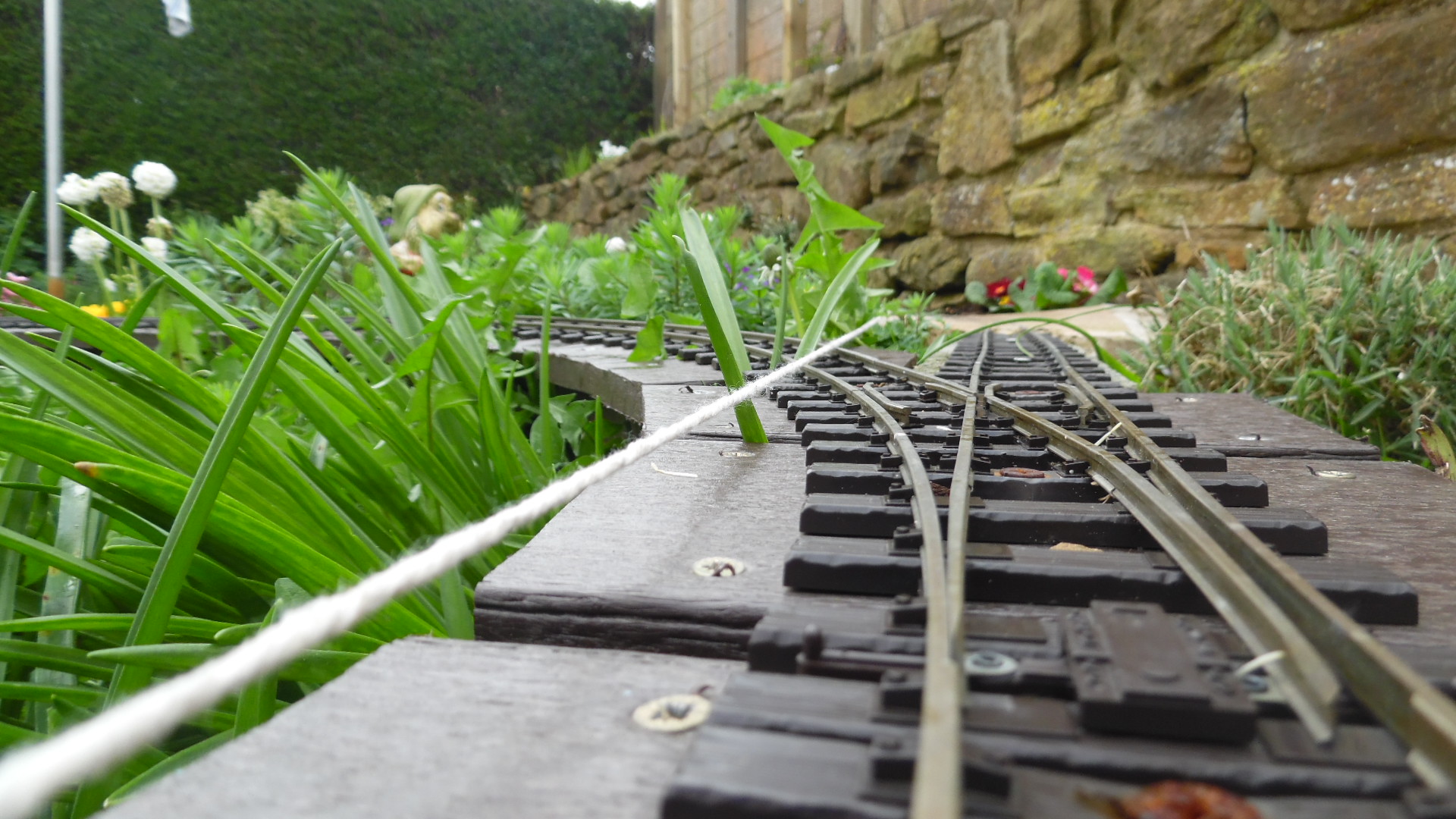

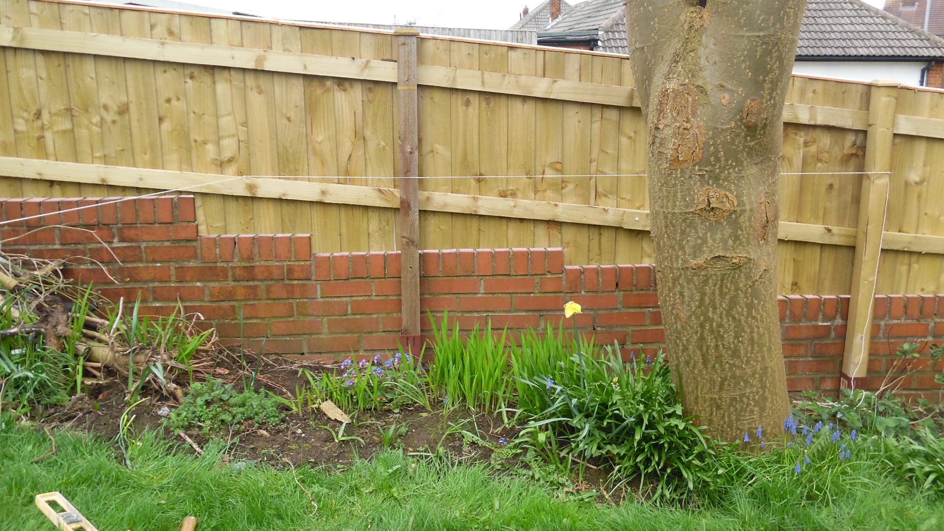

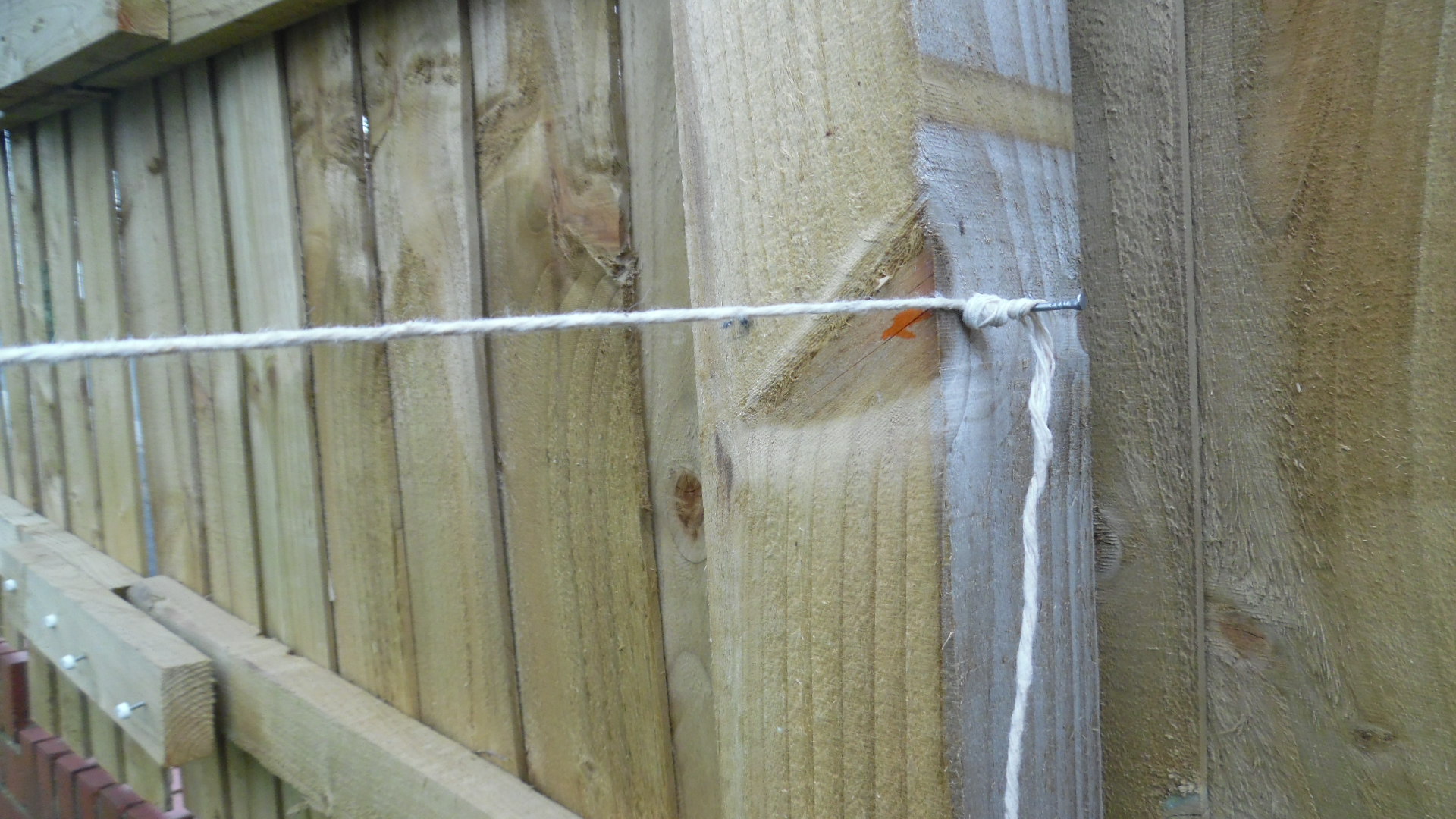

String, in balls, very cheap, very useful and if its pulled tight, very straight and level!....so, if for instance, you tied one end of your string to a sleeper end.... ....then walk along, keeping it tight against the railhead.... ....pulled it tight, looking along it to make sure its straight.... ....then pinned it to a fence, for example.... .... You'd end up with a straight and in-line string line! Fun isn't it? So lets do it again then, from the other side of the gap! ....still with me? So now we've got 2 in-line string lines from either end of a gap, and a fence that wont blow down cos its tied to our railway....lets join em up.... ....and.... Wey Hey Missus!! The wooden rail has been secured between 2 fence posts to help keep things stable, but it really DID end up almost perfectly level!
And thus, Lord Hollycross's team ended up with a well surveyed, non engineered plan, which provided a line of route for the rest of the circuit, an ideal spot for a steam up area/siding area and most importantly, pork pie and beer bottle storage area, and under the shade of the trees. Right, me and the team are off to the Railway Tavern for some recuperation whilst you re-read it all in absolute disbelief and wonder however it all works! It has so far though, and it will. More later, Cheers chaps!
One more shot, because every garden railway project needs a train piccie
so, below, we catch intrepid Top Link Hollycross driver Albert 'Oi loikes t' go faaast' Bracegirdle and his regular steed NOBBY, trundling past with hopper wagons and wondering why there's string hung everywhere, and what was that loud TWANG!......

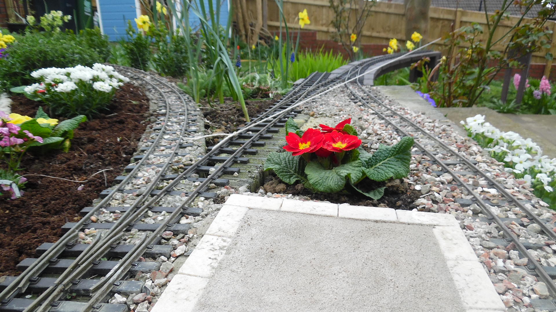

Yesterdays project was getting the steaming bay area in place. Its of timber construction for stability, with roofing felt for added protection, and will see the main circuit running at the back and 1, maybe 2 sidings inside for loco preparation etc. The gangers are aware that theres a tree ever so slightly in the way, and consulted Lord Hollycross about the problem. As ever, his solution was entirely practical and straightforward, " Aye lads, but it's a big b*gger an' it'd take some shifting. Nah, leave it be!" Job sorted! You'll see that the Filcris top framework is already in place, secured where it needs to be, and my next task is 2 'oles, 2 legs, 2 shovels of POSTMIX, then coffee and a doughnut!
Note the simple string line to which everything has been matched! Some matching paving will be put in front of the steaming bay and the lawn and flower beds tidyed up after to keep things nice.
