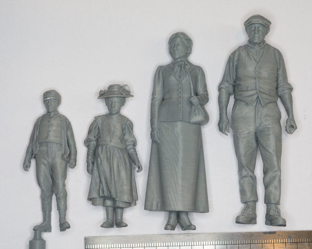

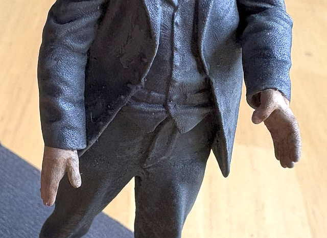

Here’s my progress with my printed and painted Meshy created models. One thing that is obvious with all the models lined up like this is there is considerable variation in the relative sizes of features. Individually the models look fine but put together, the relative sizes of heads and hands in particular vary quite a bit, more so than I think would be seen in real life. Not a big issue, but something I will consider if grouping figures together (e.g. loco crews, passengers in the same carriage, line side figures standing together, etc.).
Posts: 6075
Re: 3D print people figures
Post by philipy » Sun Oct 12, 2025 3:53 pm
They all generally look pretty good to me, although the fella on the left does look a bit unnatural. I guess he will stand at the back!

Durley wrote: Sun Oct 12, 2025 3:11 pmHere’s my progress with my printed and painted Meshy created models. One thing that is obvious with all the models lined up like this is there is considerable variation in the relative sizes of features.
Not sure I'd agree. The three figures on the right in the photos all sit together very well, almost too similar in height if we're being picky.
The figure on the far left looks to have rather exaggerated features, the hands are a bit too large and the high forehead doesn't seem quite right. The way the contrast paint makes the edges of the lapels look so pale exaggerates the feature too.
That it looks rather like Farage would make me dislike it anyway.

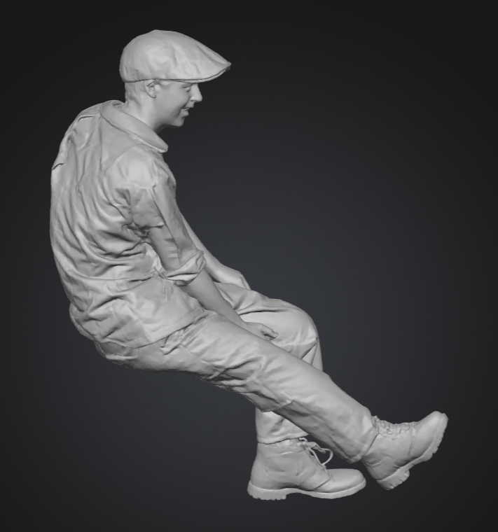

The model on the left started out with this image of GVT driver James Hughes. His forehead is definitely a notable feature but the combination of Gemini and Meshy has exaggerated the size a bit!

Durley wrote: Sun Oct 12, 2025 7:00 pmThe model on the left started out with this image of GVT driver James Hughes. His forehead is definitely a notable feature but the combination of Gemini and Meshy has exaggerated the size a bit!
Given the distortion that can be seen in the track at the bottom of the photo, there's a lot of uncertain geometry in this image. I'd be inclined to reedit the photo and bring the hat lower on the forehead.

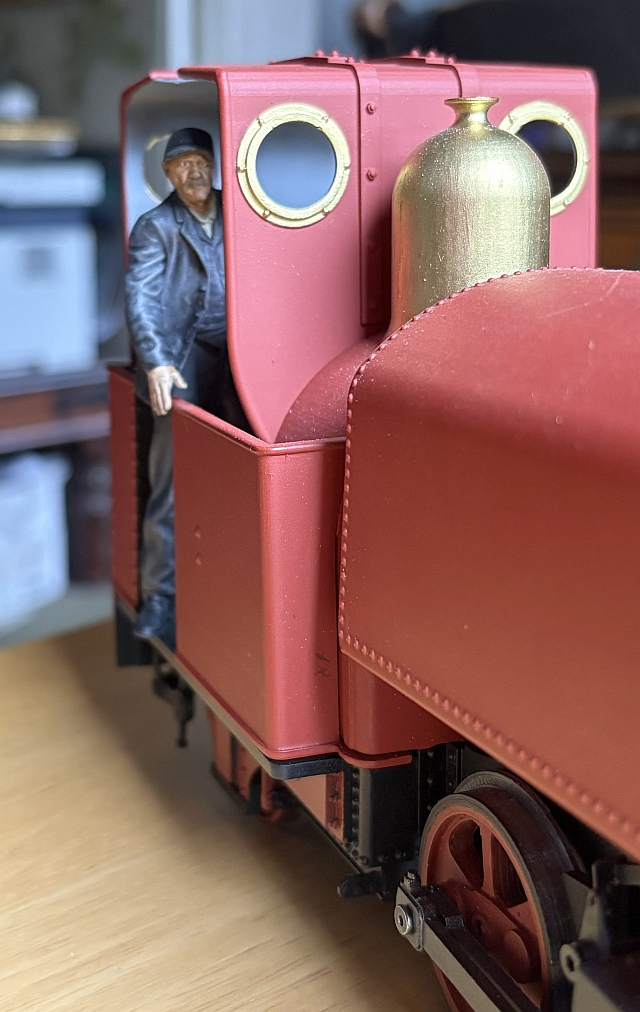

So by way of illustration, these are shots of the driver and fireman for my F &B 0-4-2, both figures started as T-poses from Gemini & Meshy:

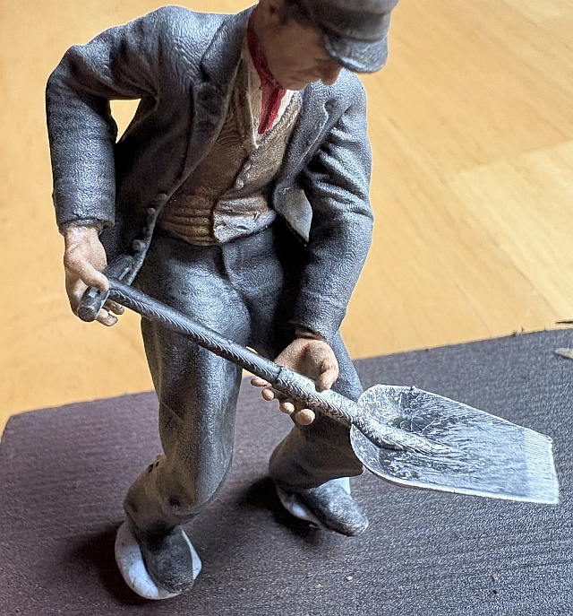

First a close up of the fireman's hands :
He holds a shovel and will be crouched in the cab doorway.
Similarly the drivers hands
One on the regulator handle and one holding the side sheets whilst he peers forward.
In position.
Hope this helps.

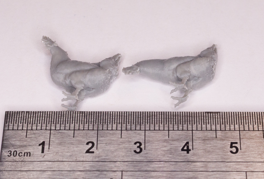

Besides people it’s also good for creating livestock which could be used as scenery or even rolling stock loads. (Although I might taking this all too seriously when I spend time trying to work out how best to print a 16mm scale chicken !)

I’ve also used it to produce a horse.
