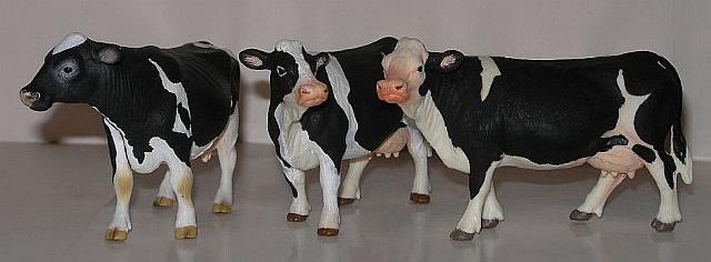

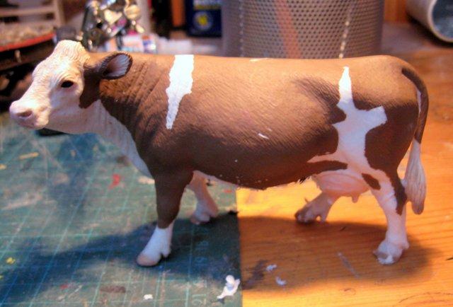

Well as Murphy's Law dictates, while out to buy a new curtain track today I saw these. Twice the cost of the previous ones and less than a third the price of Schleich. They were brown, but a quick paint job(not finished yet) and they sit very well with the Schleich Holstein on the left.
Think the other two will be left for inclusion in an animal freak show if I ever model one!!
Graeme, get down to K-Mart $5 each for these, Schleich $16.99, easy decision.
Tom, yes I could see prehistoric something, dog, and a few other things!!

LNR:119987 wrote: Decided the only breed they remotely resemble is a Hereford.
I'd like to load some of my cattle trucks, but I'd go broke using Schleich Herefords. The only cheap toy cows I've seen locally were some in Big W which looked like Friesians, but stood almost 6' in 1:20 scale.
once packed into a cattle truck, they'll look OK if the size is about right.
Whilst I don't condone any violence or cruelty towards animals, if the cattle (models) are packed tightly in a cattle truck, and possibly with straw on the floor, could they not be altered in height by amputating the bottom part of their legs? As long as the shoulder height remained at the correct level I doubt anyone would notice.
Posts: 1721
Post by GTB » Sun Sep 11, 2016 1:21 pm
Peter Butler:120013 wrote: if the cattle (models) are packed tightly in a cattle truck, and possibly with straw on the floor, could they not be altered in height by amputating the bottom part of their legs?
I did consider that, but the model cattle in question aren't just tall, but are very large overall and only 3 would fit in a cattle truck that should fit 6. Cattle size varies with breed, so they'd probably work out reasonable for 7/8" scale.

LNR:120011 wrote: Graeme, get down to K-Mart $5 each for these, Schleich $16.99, easy decision.
Thanks Grant.
I didn't even know there was a K-Mart in there. Shows how often I get into that part of town.......
Those cattle models look like they'll pass as poll Herefords in the gloom of a cattle truck and a bit of paint is a lot easier than major plastic surgery. ;)

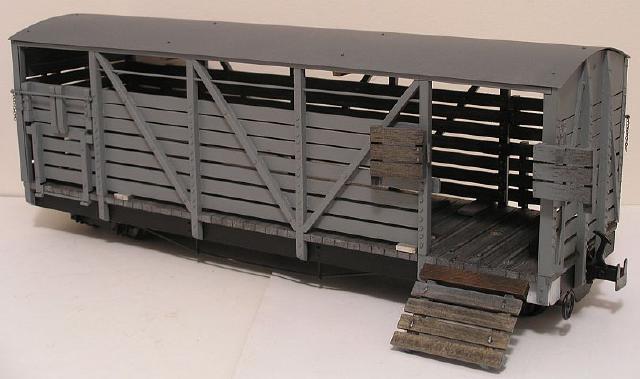

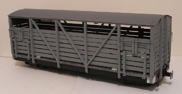

Finally approaching the back straight with this project, some 314 odd fastenings, and a fair amount of thought regarding building order to allow painting of some parts whilst leaving others to be weathered bare.
The four walls are still separable as I intend much weathering inside and out, but it's structurally quite strong being built with a K&S brass frame and of course a removable roof to put animals inside.

Post by philipy » Thu Sep 22, 2016 10:16 am
Superb Grant. A minor detail but I love the way the floor plank ends show at the edges!
Posts: 5731
Post by Peter Butler » Thu Sep 22, 2016 10:37 am
Brilliant detailing, just another 20 or so would make a most convincing train!

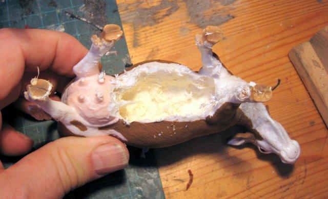

I never thought I'd hear myself saying (or writing) this, but I wish we had a KMart over here. Those cows look just the part - especially after your paint job (and re-posturing). I ended-up hollowing out my Schleich cattle as I found they were a bit weighty for my cattle wagons.

That's interesting Rik, I had wondered about drilling some 1/2" holes up from underneath these. As I will only have the one van I won't worry.
Also of note is the fact that I have come across sheep at 6 for $16 on Ebay, and they appear to be identical to Schleich, made in China of course. The cows I bought from K-Mart are identical to a Schleich Simmental and of Chinese origin, hence my "herd" is all Hereford now except for the Holstein.
Posts: 8052
Post by ge_rik » Sun Sep 25, 2016 7:59 am
Hi Grant
I was a bit more brutal and completely evicerated the poor things
As they're inside the cattle wagons their undersides are not that visible

I do hope that was done under anaesthetic Rik, if looks could kill that last pic. tells me your in trouble!!!
Posts: 8052
Post by ge_rik » Sun Sep 25, 2016 5:38 pm
LNR:120200 wrote:I do hope that was done under anaesthetic Rik, if looks could kill that last pic. tells me your in trouble!!!
She (or her cousin) did wreak her revenge.
Warning: Do not hold cow in palm of hand while drilling holes in her underside ...... Unless you, too, want perforated palm!
Post by Soar Valley Light » Sun Sep 25, 2016 8:30 pm
Those cows are fantastic Rik. I'm not sure whether your treatment of them makes you a vet or a taxidermist!

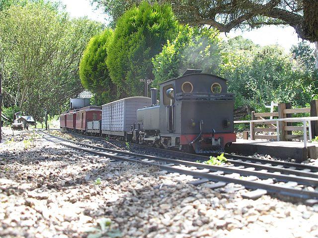

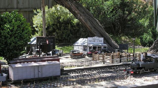

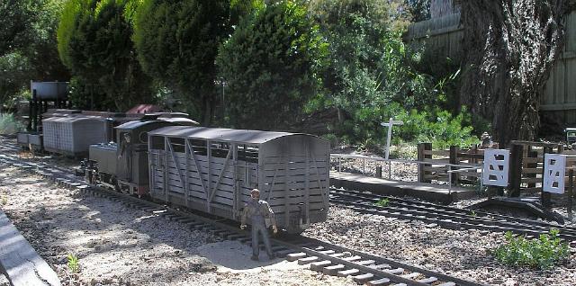

A busy Saturday.
A pleasant spring morning saw the morning mixed head up to Nayook. Being Saturday the town was buzzing.
The crew shunting the yard.
And the train, with a full head of steam ready to return to Leawarra hopefully in time to get everyone to the cricket. Nayook playing Leawarra at Leawarra.
Posts: 5731
Post by Peter Butler » Sat Nov 19, 2016 3:26 pm
Grant, the scenes are just superb, particularly the last one taken at low level, everything looks just right.
Post by tom_tom_go » Sat Nov 19, 2016 9:18 pm
Have to agree with other posts Grant, the pictures you post of your railway are a joy - excellent work...
