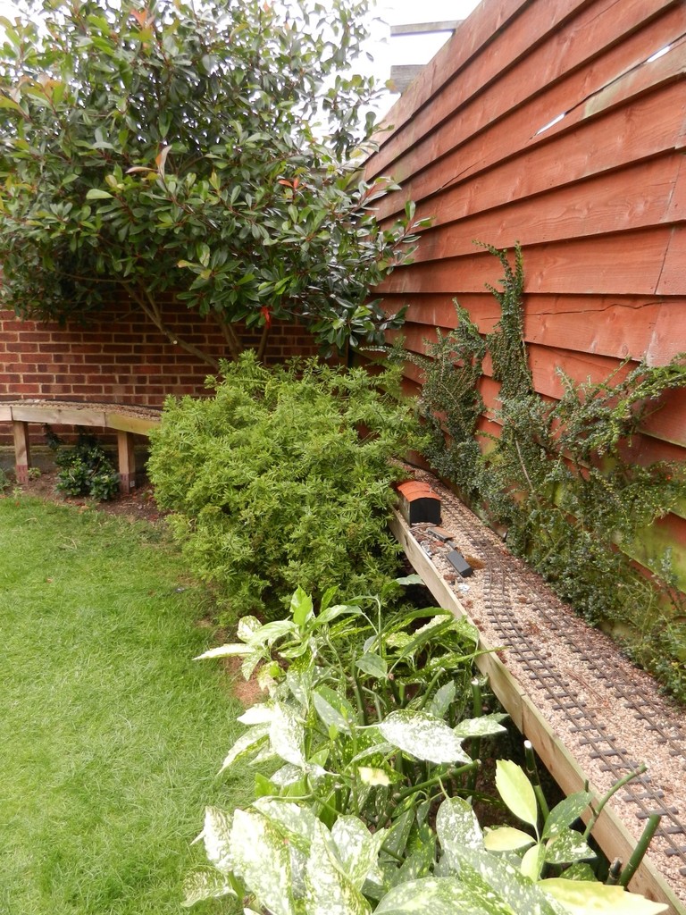

Patio reclaimed!
Here is a new view of the line I have never seen before due to the red robin being overgrown:
Yes that is a cat you saw enjoying her new found sun spot in the above pic :)

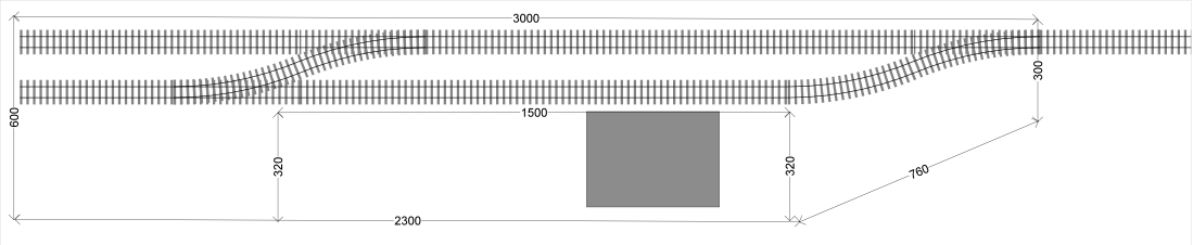

After taking the picture of the line behind the tree I sat there and thought this would be a great spot to sit and run trains although achieving this would mean that I could not have a loop.
So after some measuring I have come up with this idea for a station that fits in the space and allows trains to run round:
Measurements are in mm
I have SSP slomos reserved for when they are released for the Lady Anne chassis which allows realistic slow running needed for this set up. I would not need point motors as the trains will always come into the station the same route and the points will be set in the same position by the use of springs under the track which I have used before on the loops on my line with success.

So here is the final design:
Unlike the previous station layout this set up allows the station building to face forward which you will be able to see lit at night. It also allows trains to arrive at the station without having to negotiate a tight curve.

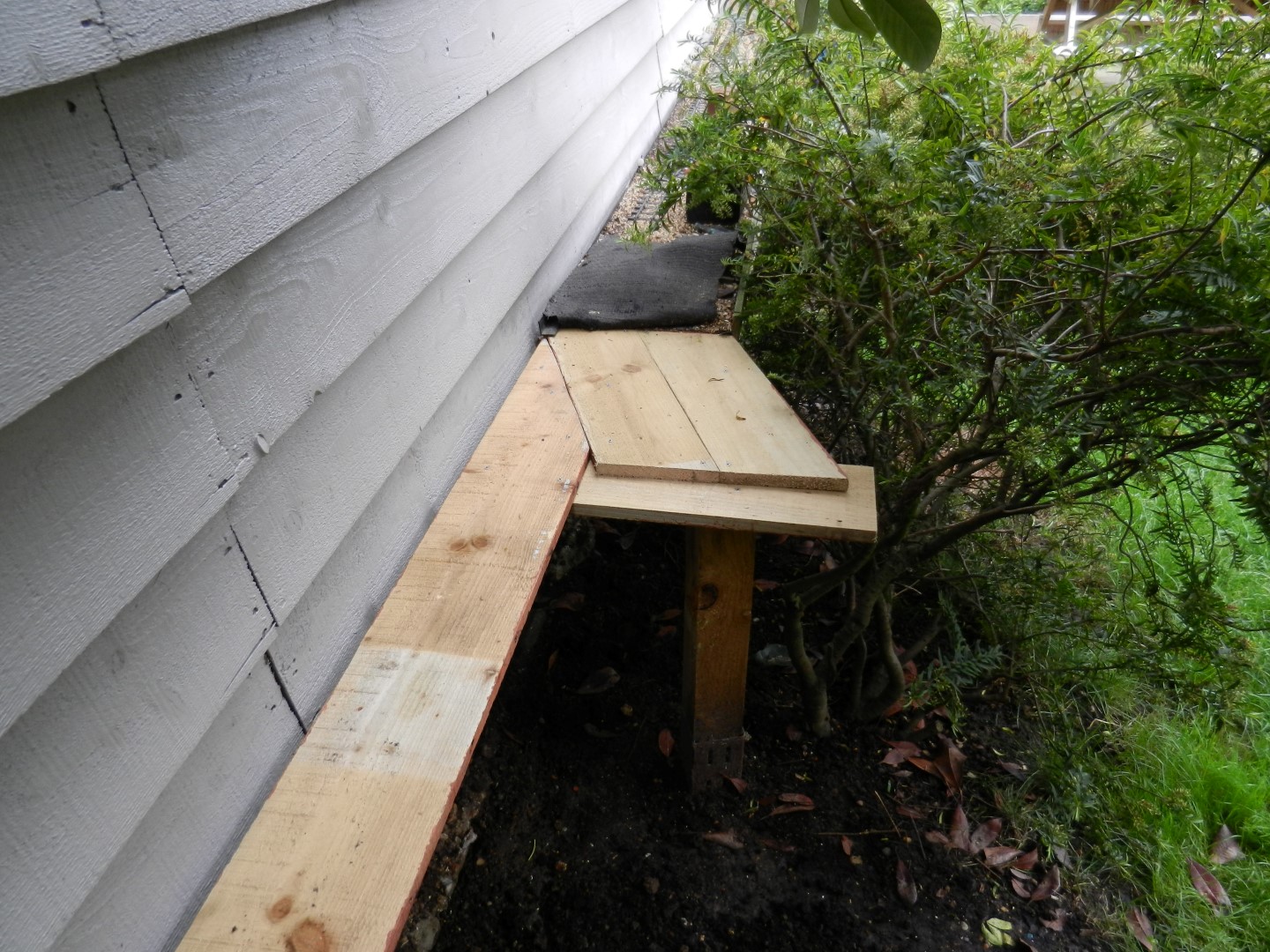

I have tried to reuse parts of the old railway, however, I ran out of wood today so here is progress so far:
This will be the station approach:
Painting the back fence was a pain in the bottom although it brightens the garden up now.

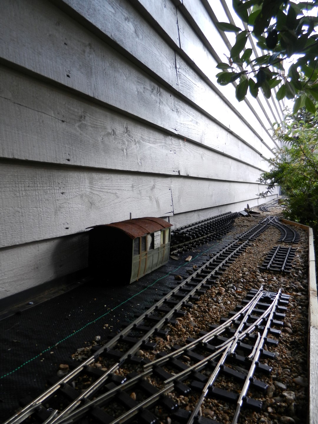

Post by tom_tom_go » Sun Aug 30, 2015 8:27 pm
It was getting dark by the time I finished, however, here are some night shots of the shelf railway restored (minus the track for now):

Post by tom_tom_go » Sun Sep 06, 2015 6:26 pm
jim@NAL:113129 wrote:looking good I love all the rusty bits on your line adds lots of character
I like line side junk. My finest piece will be a Mamod loco on the cheap to rust somewhere ;)

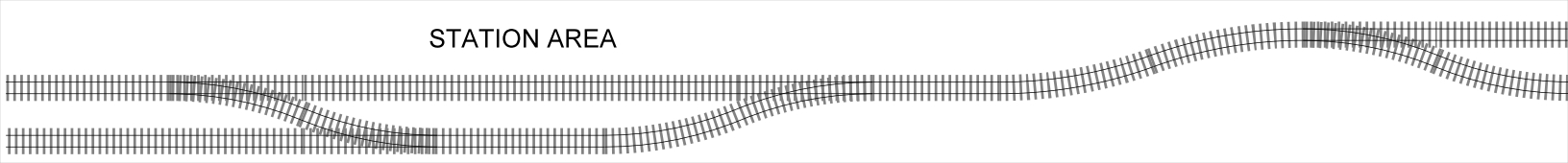

Starting to play around with the track plan and inevitability have changed the design to now include a head shunt so I have another point on order from Track Shack:
The station layout (behind the camera are two sidings as per the original design):
I like what Rik has done using Deltang equipment for remote point operation although if I go down the route I will use servos for slow point throw and realistic signal bounce.
