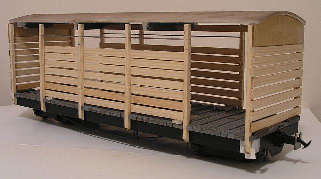

On returning to the workshop with signalling in mind, I saw the second underframe of the two recently built. So began the process of deciding how to construct a cattle truck that was both structually strong, and yet displayed the open airy appearance of those on the VR narrow gauge.
Basic box constructed so far. Roof borrowed from U van to get an idea of the size. Will have a flat iron roof when done. More timber bracing and of course doors, then the detailing can start.
Post by Soar Valley Light » Tue Aug 30, 2016 9:22 pm
That's an interesting vehicle Grant. Bigger than some of our standard gauge cattle wagons by the looks of it! I look forward to seeing it progress. Were the full sized ones fitted with continuous brakes?

Andrew, the only thought process was "oh forgot I still had one to go, better do something about it"!!!
 The real NM's were a little over a foot higher than other van stock on the narrow gauge, but I didn't want to go that high. It still sits on my standard underframe, but is built a little more outside it, as the timber uprights extend down outside the frame. The real ones used steel angle, but cost and availability of K&S brass angle was a bit prohibitive.
Oh and yes, all our VR narrow gauge stock was air braked.

Interesting that they were taller. Was that to make room for the occupants? Your adaptation onto your standard chassis certainly looks like it was meant to be.

The VR narrow gauge cattle trucks were the same inside height as the broad gauge ones. Cattle don't need 7" of headroom, but horses do and most of them travelled in 'cattle' trucks here. Only bloodstock travelled first class in a horse box.

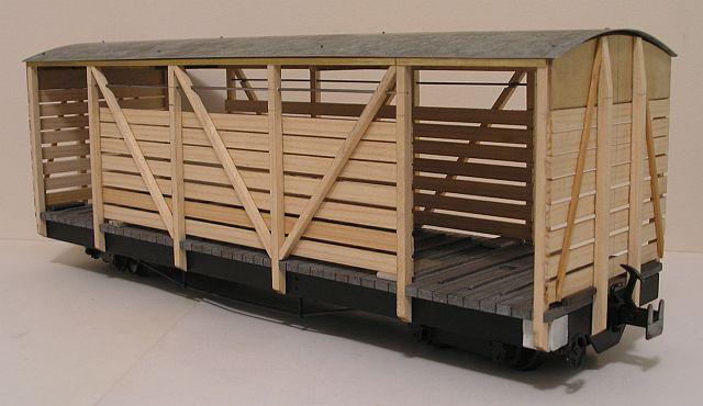

Bracing, brass top channel, and a galvanised iron roof completed today.
Doors and ramp x4 next, ugh!!

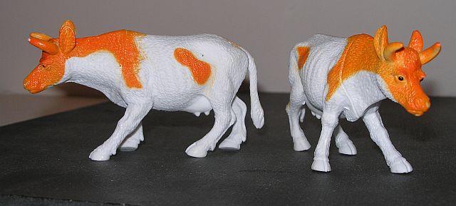

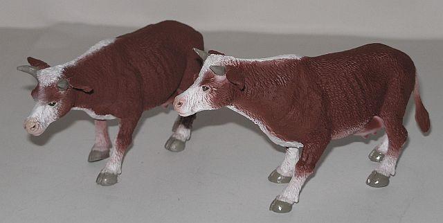

Sick of making hinges and doors, and whilst doing the weekly shop, I saw these strange coloured animals going really cheap in the Reject shop. Thought I might have some fun, as well as good practice.
After sticking pins and wires in them (there sort of rubbery plastic something) to get them standing properly, re-positioning ears and then cutting the head off one to insert a wooden former for a different pose I got some paint on them. Decided the only breed they remotely resemble is a Hereford
Not finished yet, but it was fun and quite a refreshing change.

Post by Peter Butler » Sat Sep 10, 2016 3:07 pm
You can see why they were rejects, but cheap is always good so well worth a try. You have made them stand proud now, much more convincing and worth the effort..... just need a dozen more now!
Posts: 6075
Post by philipy » Sat Sep 10, 2016 3:55 pm
Looking much better after the makeover.
Whatever breed they are, they are clearly show champions, with their polished hooves!
Post by Soar Valley Light » Sat Sep 10, 2016 9:17 pm
Well done Grant, you should have been a vet! They look much better for your attention, much less like crouching tigers and very much like grazing Herefords :lol:

Yes, I'm not sure what animal was in the makers eye but don't think it was a cow. Still keeping my eye out for some more Schleich/Collecta cows. Very hard to get a herd of same breed cattle in different poses. I already have the Schleich Holstein as most do, a large framed beast in real life, and hard to match up to. These two if used will have to be in the middle of a group I suspect, small mixed herds being common here in Australia in the era I'm modelling.

What height are they at the shoulder Grant?
I'd like to load some of my cattle trucks, but I'd go broke using Schleich Herefords. The only cheap toy cows I've seen locally were some in Big W which looked like Friesians, but stood almost 6' in 1:20 scale.
I agree I've never seen a cow that looks like the ones you have, but once packed into a cattle truck, they'll look OK if the size is about right.

I like what you have done with them Grant as the original versions looked like a botched attempt of a Triceratops dinosaur...
