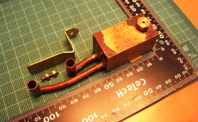

Probably the first meths burner made for the Mamod SL locomotive was this Merlin Works one (from 1981).
It has separate tubes to the 2 wicks. However the wick tubes are not very tall so that restricted how much meths you could put in the tank. I am extending the wick tubes with some brass tubing which will make this burner more efficient and allow more meths in the tank. Disadvantage of fitting this burner is you have to remove the chassis spacer plus the screws & nuts that hold the bottom of the cab floor to the chassis frames.

The chicken feeder in the Pdf file is a nice design and with my Salem coal bunker I can hide the fuel tank there. Quite some work, but I like alcohol better than gas. Alcohol is cheaper and it's silent. (besides the Saito vaporising burners) I so dislike the noise some gas burners make! A steam engine shouldn't sound like a jet engine, especially if you paid thousands of Pounds for it. :?
