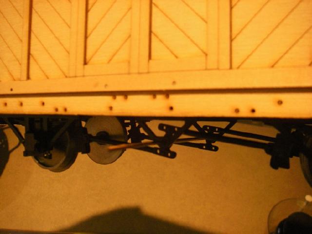

The body of the wagon is pretty much like other IP kits, with plywood sides and plasticard roof. The Laser cutting is good and the parts fit together well without having to shave or sand them. Of course I will sand the whole thing a little before painting. The external bracing is an overlay that glues over the solid panel. The solid panels have planking lines etched into them.
The axle boxes are cast white metal. They are pretty detailed and I didn't have to file them very much to get rid of mold lines or flashing. They were very clean. There are the standard little brass bearings that push into them.
They fit into a notch on the solebar so there is no measuring required here.
The kit comes with a drawing of the real wagon to refer to.
The brake gear has lots of little parts. Again they didn't require very much dressing with the file and they all fit nicely. I haven't installed the handle and bracket yet, because I'm going to paint the body first.

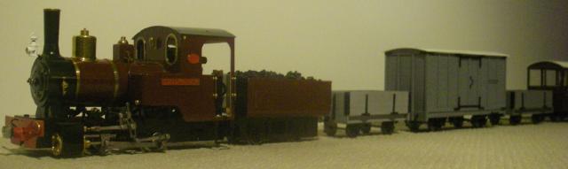

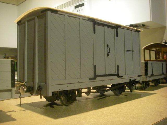

Well, the wagon is finished. I'm pleased with how it turned out, pretty much just like the pictures on the I.P website.
I built a little frame inside to hold a cylindrical tea canister, which I filled with rocks. That way the wagon will provide some load for the locomotive. The wagon is quite large, but looks good with the roundhouse locomotive and also matches the 16mm scale wagons I already have. It's a little taller and a little wider, but for some reason it makes the whole train look more "right", it reduces the apparent size difference between the RH loco and the smaller IP wagons.
Sorry for the crappy pictures. It's dark here.
