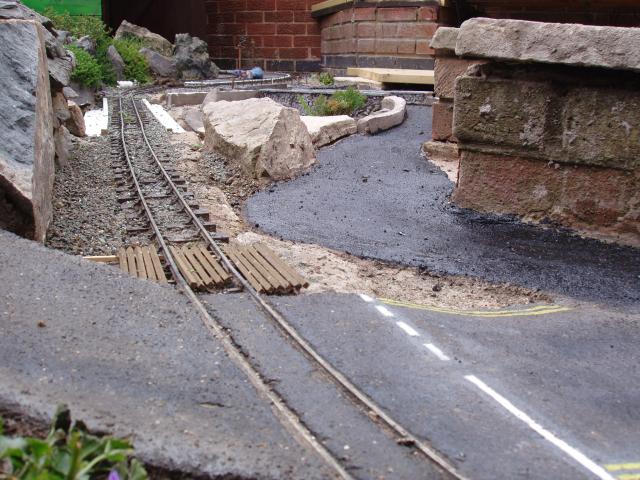

As the project continues it was decided to put in the level crossing at Tanygrisiau and with some modification to bordering patio and rock border. Still to complete it will have flashing warning leds and audible two tone siren with the necessary signing. Walling is coming on and a new two week contract has been tendered to get the job done quicker.

brilliant! what have you used for your roads? how did you get them tarmac colour?

Yeh, I need to know how you got the tarmac colour too! Very convincing.
Also, what size strip have you used for the cattle grid? (That'd save me a bit of trial & error :roll: )

Ok chaps ! The road surface is first laid with a mix of sharp sand and cement and left to set then a smooth surface laid on top with red sand and cement not necessary but smoothes out perfections.
I then swept my local street of its loose grit and sieved this giving me a fine dust. This was then applied deliberately whilst the cement was wet. Tamper it down and leave to go off and when dry apply waterproof PVA and again sieve more dust on to it. Once dry I applied external black gloss paint as tarmac. Again this was finished with a dusting. By applying a mixture of black and white paint various greys can be achieved and I diluted this with white spirit to give a washed appearance. Remember a real road as grit at the side of it skid marks pot holes and the dead squashed hedge hog. I will have some horse droppings to add to mine from a passing horse and rider. So go where your imagination takes you.

The stripwood is about 2.5mm square!
