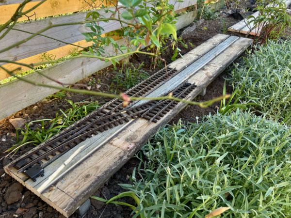

I’ve cleared a load of decking and anything that might get in the way and started on the trackbed, reusing some of the redundant decking, despite my previously stated commitment to avoid wood. It’s being supported on recycled plastic posts and not actually in contact with the ground. I think that’ll be OK for a few years. Height above ground will vary with the terrain.
I’ll cover it with cheapo, thin, roofing felt and screw painted UPVC window trim (it’s way cheaper than wood and doesn’t rot) along the edges to secure the felt and contain the 6mm chippings to be used as ballast, as before. It hardly represents realism, I just think it looks better than ‘bare track’. For curves I’ll use R5 and R3 recycled plastic boards, mainly from the previous garden (and no felt).

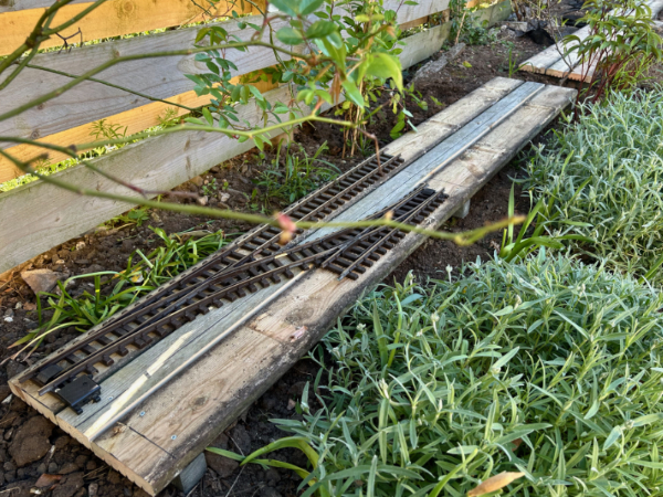

Inevitably, things haven’t gone entirely to plan, though I’ve done much of the track laying in ‘stage 1’, the raised bed area of the garden. I now have to do some brick laying (not one of my core skills) to reinstate a step into the raised bed (for weeding and track access) and then knock up a simple lift-out bridge to run across it.
It was forcefully suggested to me, by a (relatively) younger member of the family, that the opportunity for continuous running had to be an absolute priority, even if it could only be achieved with small tank engines and short rolling stock. So return loops would be necessary at both ends of the (as yet far from complete) relocated, garden railway. I’d thought that within the limited space available at the raised bed end of things, it would just look too tight and too naff. I’ve had to concede however and include a R2/R3 return loop. I’ll have to attempt to camouflage it with judicious planting, which is desperately needed anyway.
An unexpected annoyance has been the volume of bird droppings ending up on the trackbed, which is messing with my planned ‘loose ballast’ notion. It would make cleaning it off unpleasant and difficult. Not yet sure what to do about that.

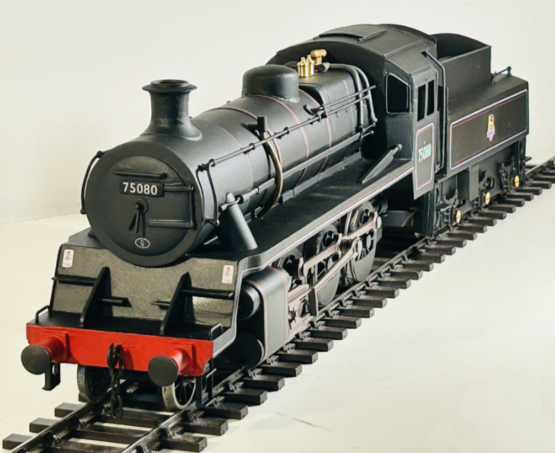

A bit like a BR Standard (but not too much)

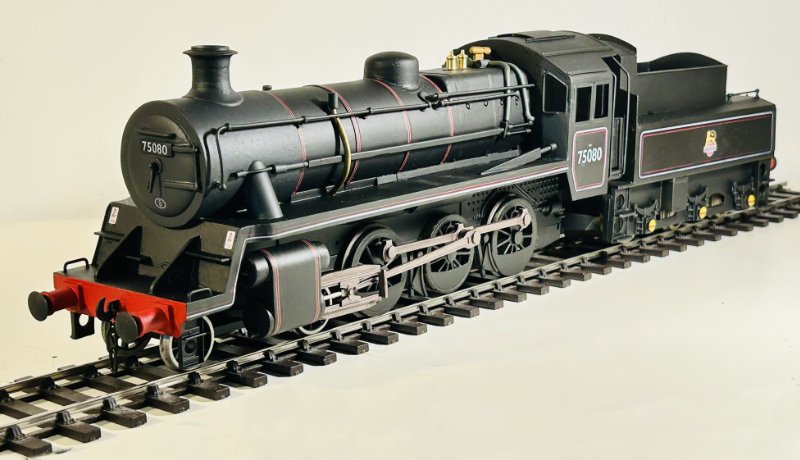

A few months later, I’ve at last got round to painting it (I was busy) and, after several failed attempts, getting a set of DIY waterslide decals that worked. It took ages to figure out it was the spraycan acrylic varnish at fault (wouldn’t cure?), not the new inks or decal paper. A new can and it was all OK.
I now have to somehow secure the battery in the smoke box and then screw it all together. Somewhere I’ve got some suitable crew too — I boxed them up 18 months ago, before the recent house move and haven’t yet stumbled across the right box.
I’ll do the glazing when something arrives in appropriate packaging. Hopefully, a cake
- Posts: 8048
Wow!!! That looks brilliant. The finish on the paintwork is perfect.
- BertieB
- Posts: 435
- Location: Scotland
Thanks Rik. My guilty secret is spraycan Railmatch Matt Enamel Varnish on gloss paint (mind you, I don't show the scruffy bits that don't look so good).
