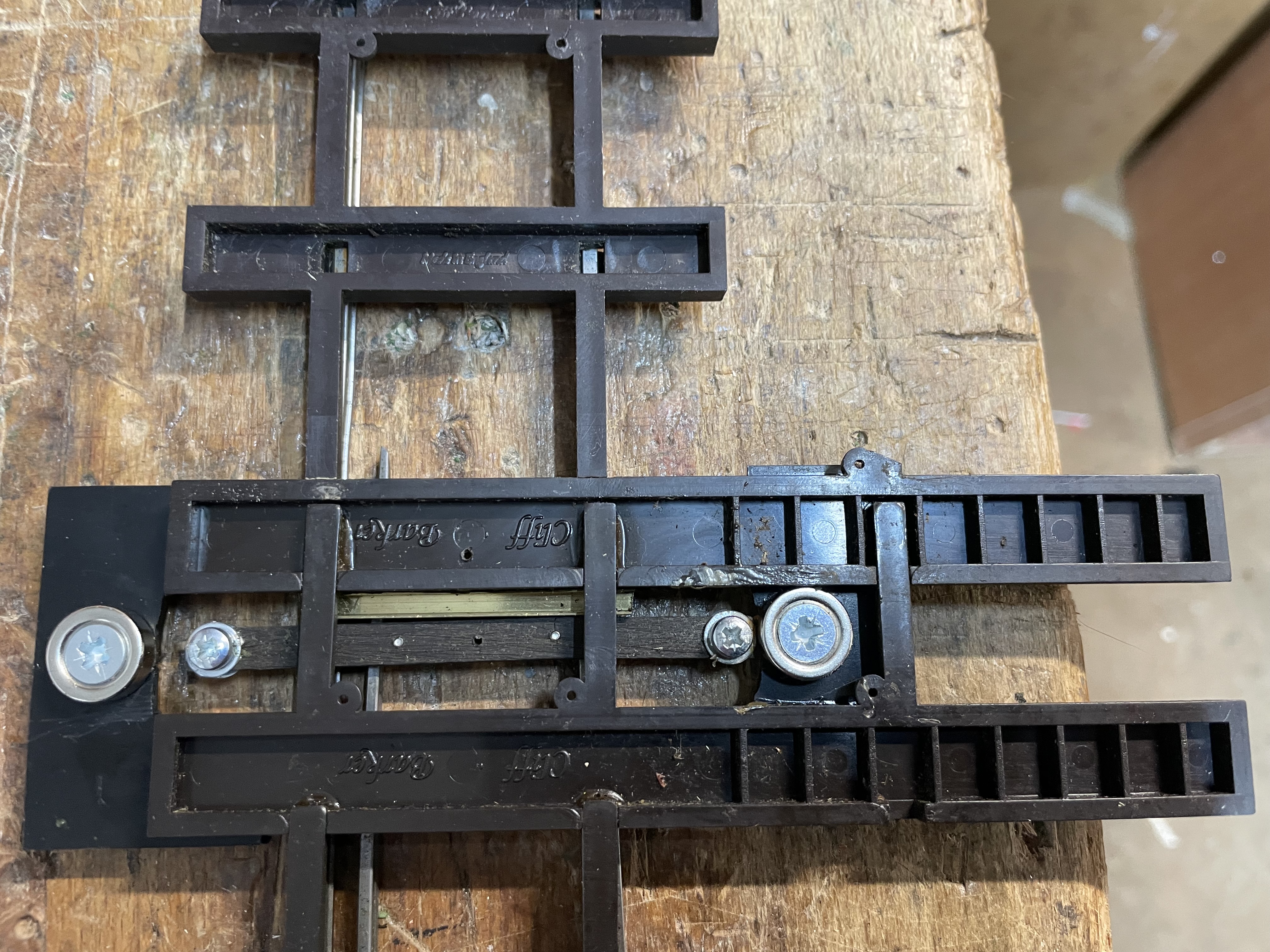

When I went to run the freight train a few days ago I noticed that several of the magnets I had glued in place to hold the CB points in the normal or reverse positions had come loose from the plasticard they wrecked fixed to. This was done as reported last year with superglue holding the magnet initially then a fillet of epoxy resin adhesive around. The epoxy appears to stick neither to the magnet nor the plasticard for long!
Back to the drawing board. I ordered some countersunk neodymium magnets 12mm diameter and 4m thick with a pulling force of 2.5kg on the circular faces hoping there was sufficient pull on the edge for my purpose. There seems to be:-
shown from underneath. An M4 6mm csk machine screw and nylok nut hold the magnet to the plasticard. They should not escape now. There is enough pull on the bolt in the tie bar to snap the switch rail against the running rail from about 2mm away,

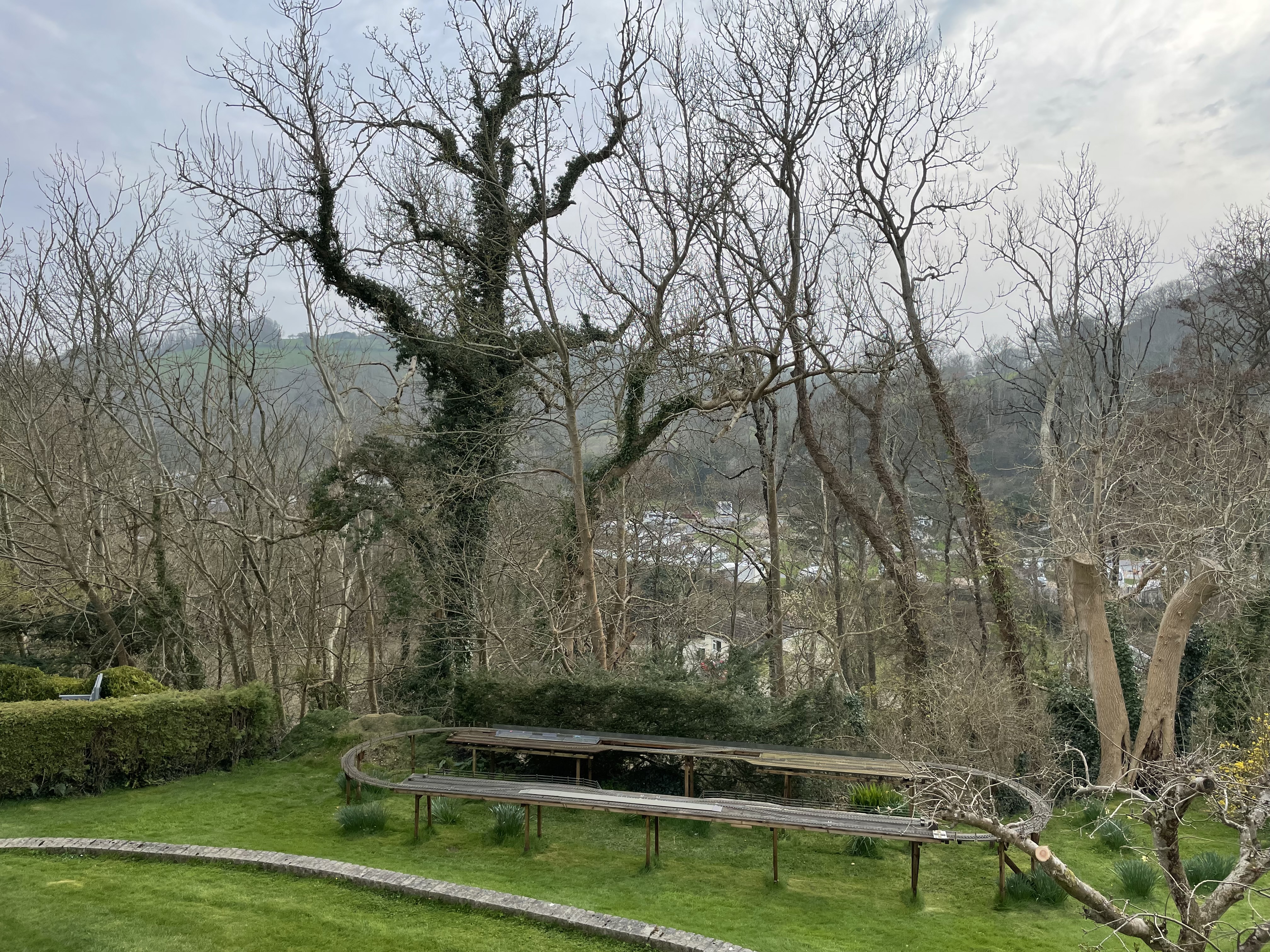

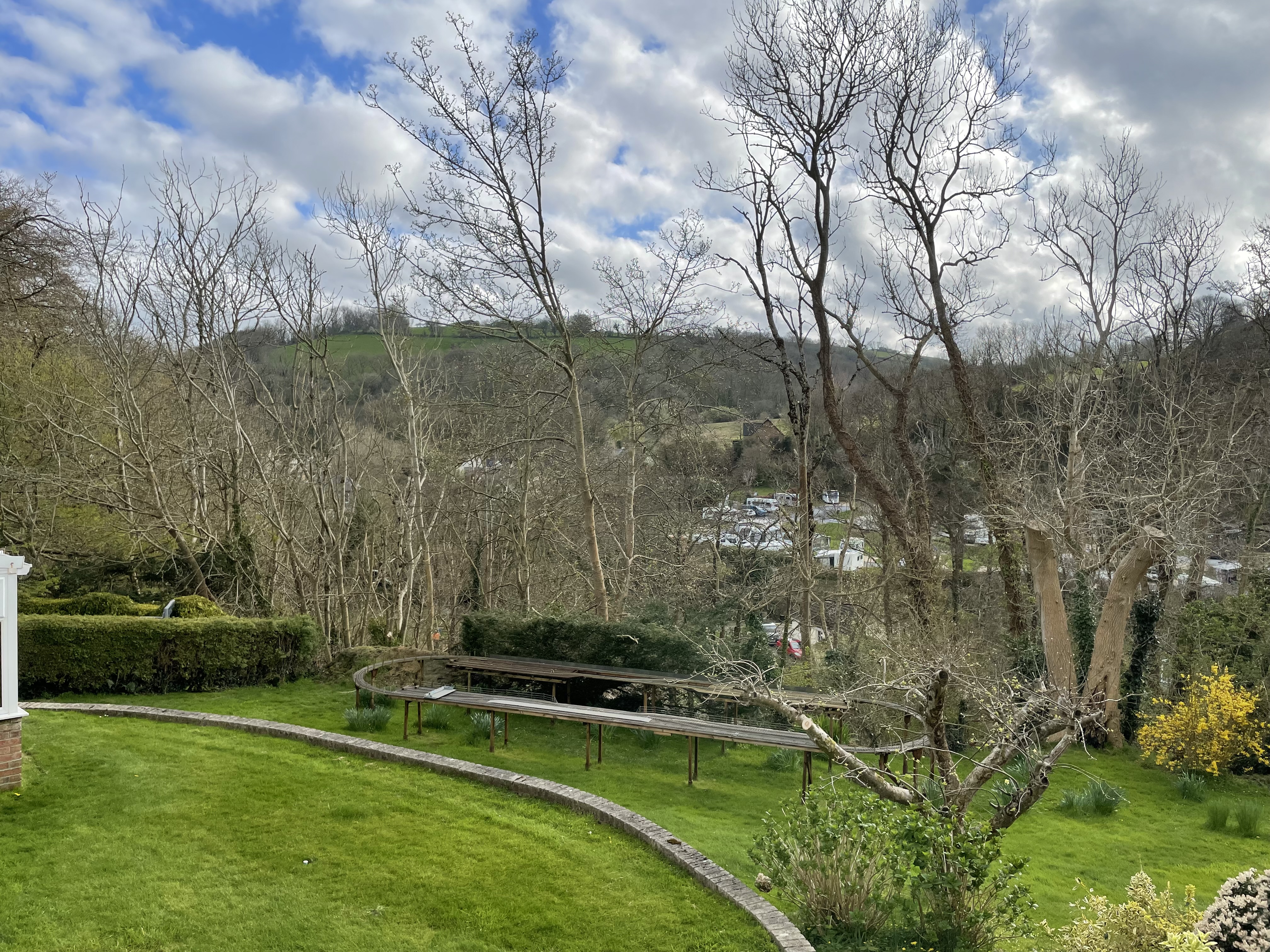

There have been some changes round here.
This is what my garden used to look like:-
Then much to my relief a couple of weeks ago two ash trees in my neighbours property immediately below mt garden were felled and it looked like:-
The only disadvantage to the railway is that the recently named station 'Tan yr Onnen' is no longer threated by the 'Onnen' and so it is not 'Tan' it. Never mind plenty of stations are named after things that are no longer there.
For non Welsh speakers 'Tan yr Onnen' means Beneath the Ash.
