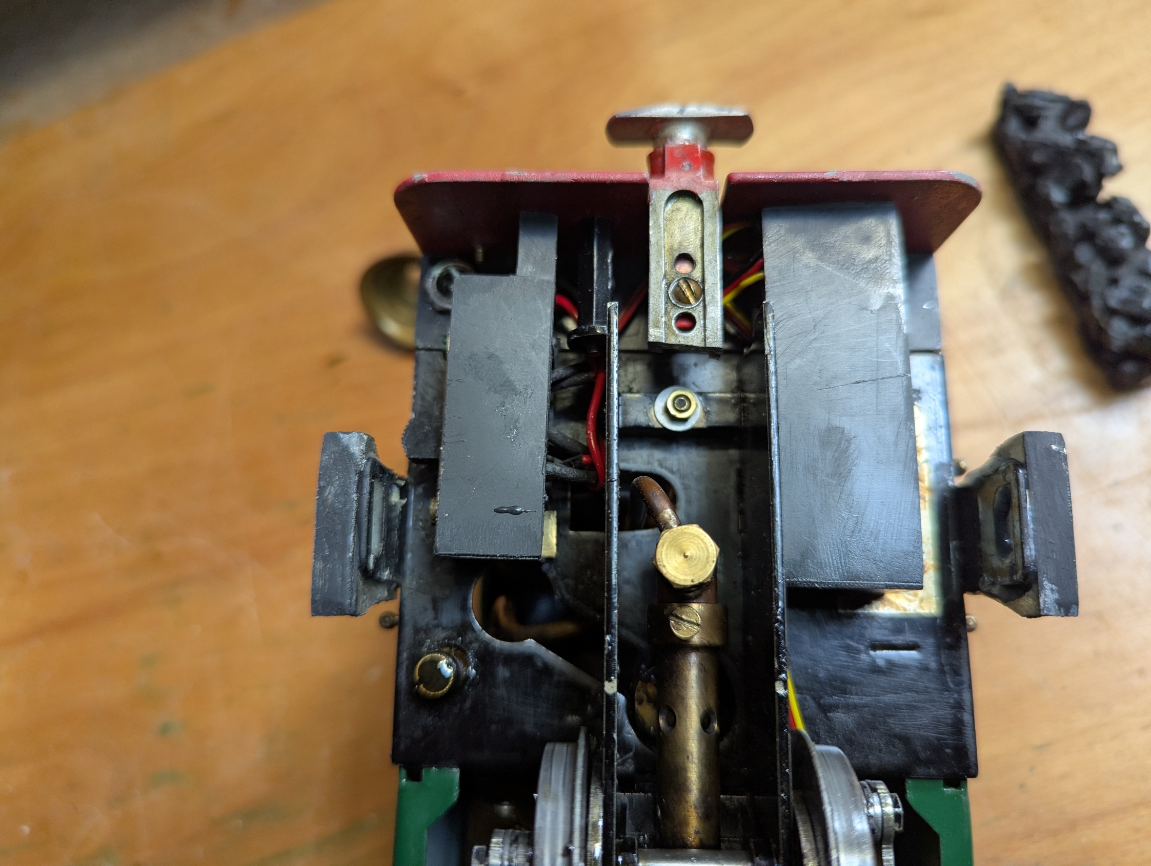

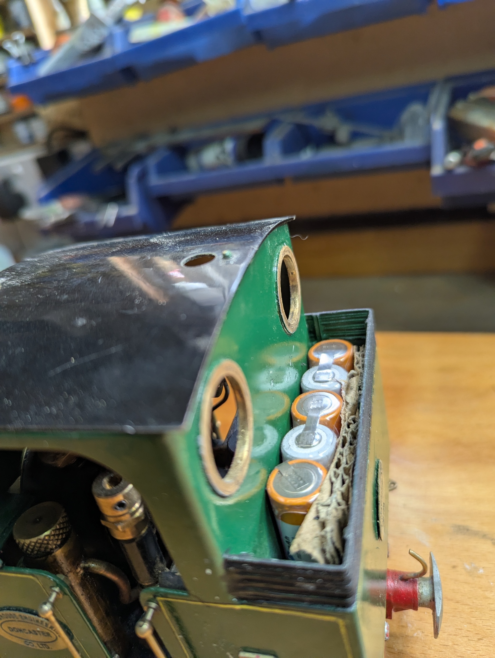

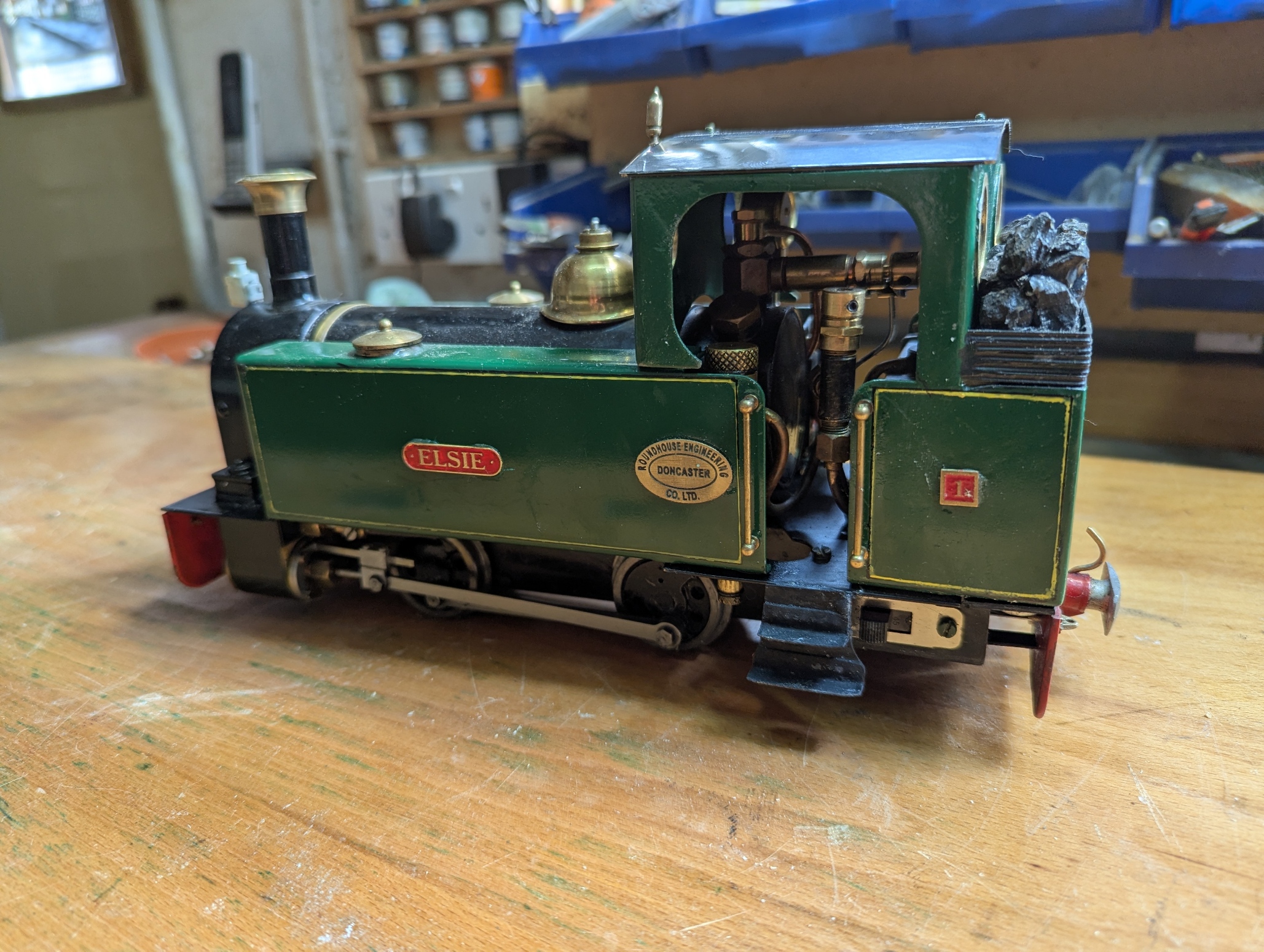

This is my Millie. It was bought second hand and came with a cab. The loco was manually operated when I got it but I have extended the cab to form a bunker where I have located the NiMH battery pack from Strikalite. The servo controlling the regulator is in the conventional Roundhouse location . The receiver and switchgear are in simple Plasticard "boxes" under each side of the extended rear. I hope the attached photos make everything clear.

Clever modification. Looks very in keeping with the original loco. In fact, if you hadn't pointed it out, I'd have assumed it was part of the original design.
