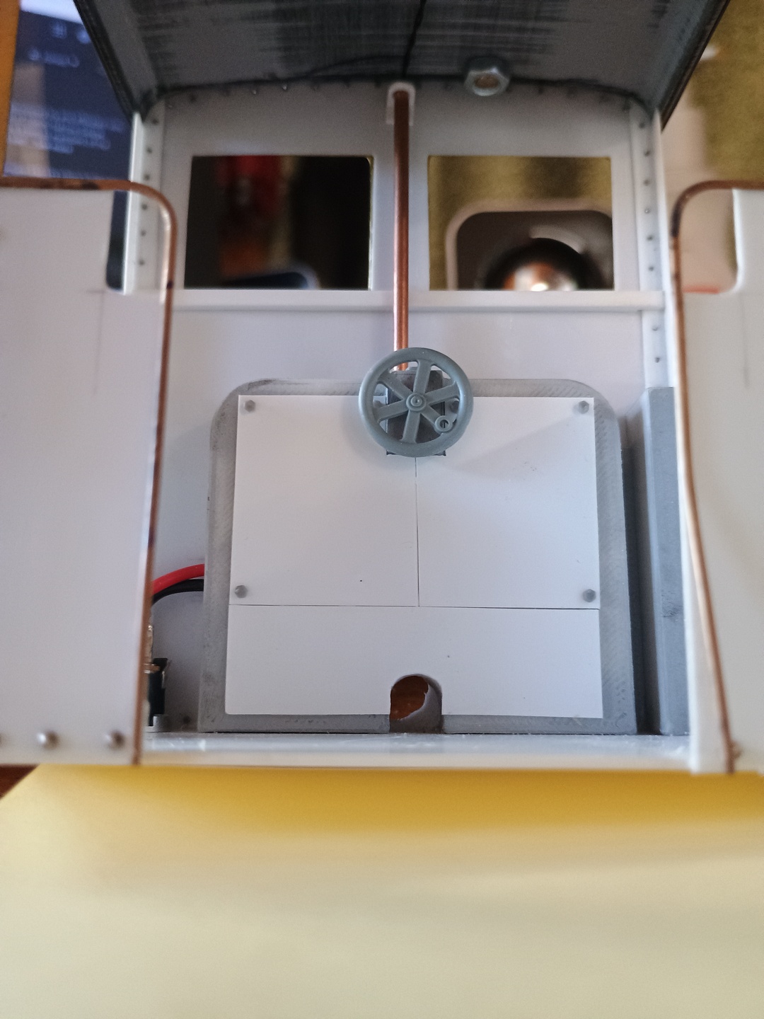

21/10/25
Inching toward completion.
One of my least-favourite jobs is wiring, and integrating it (hiding in plain sight) with the model. This includes tiny plugs to allow the cab, bonnet and battery pack to be disconnected from the loco.
The dashboard has been partially hollowed-out for the rear headlight and charge socket wiring to pass through. It's been fitted offset to the right side of the loco, as the printed RH sandbox is too narrow.
The fix would be to make a new sandbox to the correct size, as I've done for the LH side (not yet fitted) to hide the charge socket.
Can't be stuffed with that, the offset dash is barely noticeable; and I'll call it a "mod" to suit what is by this point in it's life, a loco re-engined with a diesel anyway.
Detailing is more enjoyable. I've also made the sliding window frames, but most of that will be fitted after paint.

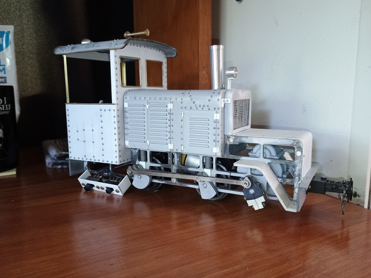

12/11/25
Further detailing ensues.
Still needs various caps made for the radiator, sandboxes and perhaps some internally-relocated diesel tank squeezed in under the bonnet somewhere. Also brake shoes, cab controls and the transmission linkage just ahead of the front right bonnet corner.
For better or worse, I've elected to fit the charge/run and headlight switches in an easily-accessible place, disguising them in a large "battery & tool box" under the footplate. I'm trying to make my locos easier to operate by keeping them out of their tiny, fragile-detailed cabs, without impacting appearances too much..
21/10/25
12/11/25
- Tiny door latches;
- Mesh cut from a cheap kitchen utensil, attacked and distorted to dent it up. Still needs a "core" fitted behind before painting..
- 30s style car headlights from the batch turned during the Essel Fowler project.
- A new mill-workshop fabricated chimney turned from aluminium.
