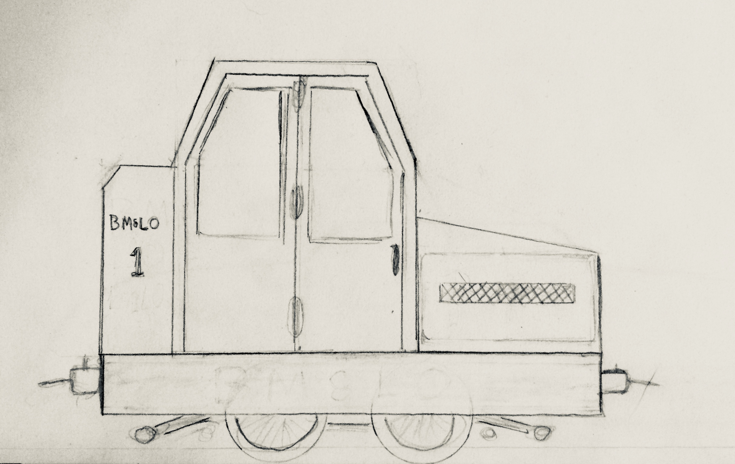

This is what I've decided it's going to look like...

A great little centre cab loco. Cleverly hides the workings.

That looks pretty cool. It exudes that narrow gauge industrial feel. I'll be interested to see it 'in the flesh'😊
