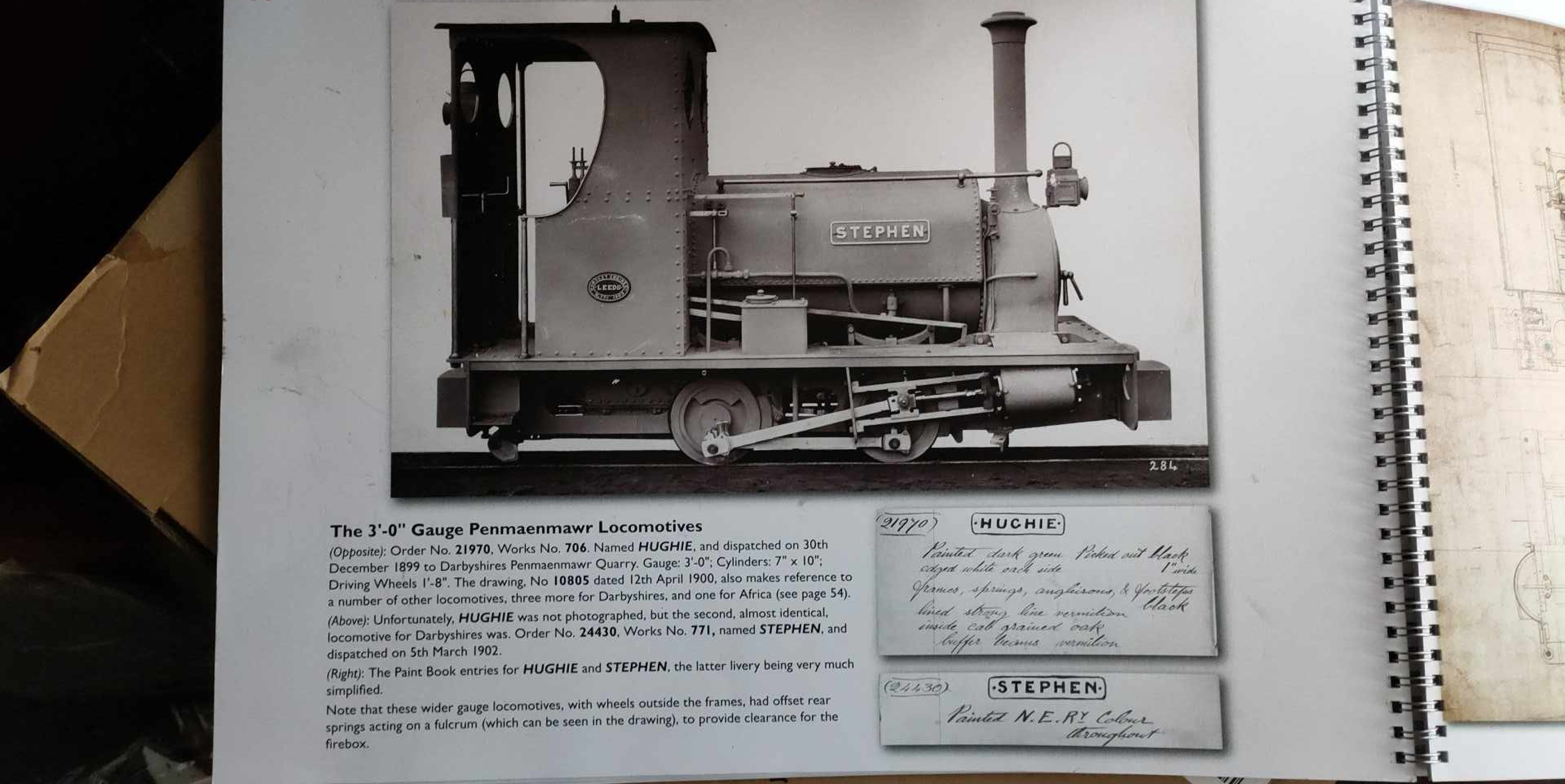

Ah I didn't realise you ran on 45mm gauge, anything over probably 2ft 4" and a QH would have to be inside framed, of which I've only found two places that had such examples. There was Penmaenmawr granite quarry which had four of 3ft gauge and Mancetter Quarry, which had two of 2ft 8" gauge.
Hunslet Oldbury (3).jpg (223.58 KiB) Viewed 125365 times
Mancetter Quarry Hunslet 'Mancetter'.jpg (637.34 KiB) Viewed 125365 times
Penmaenmawr Hunslet 'Stephen'.jpg (997.05 KiB) Viewed 125365 times
