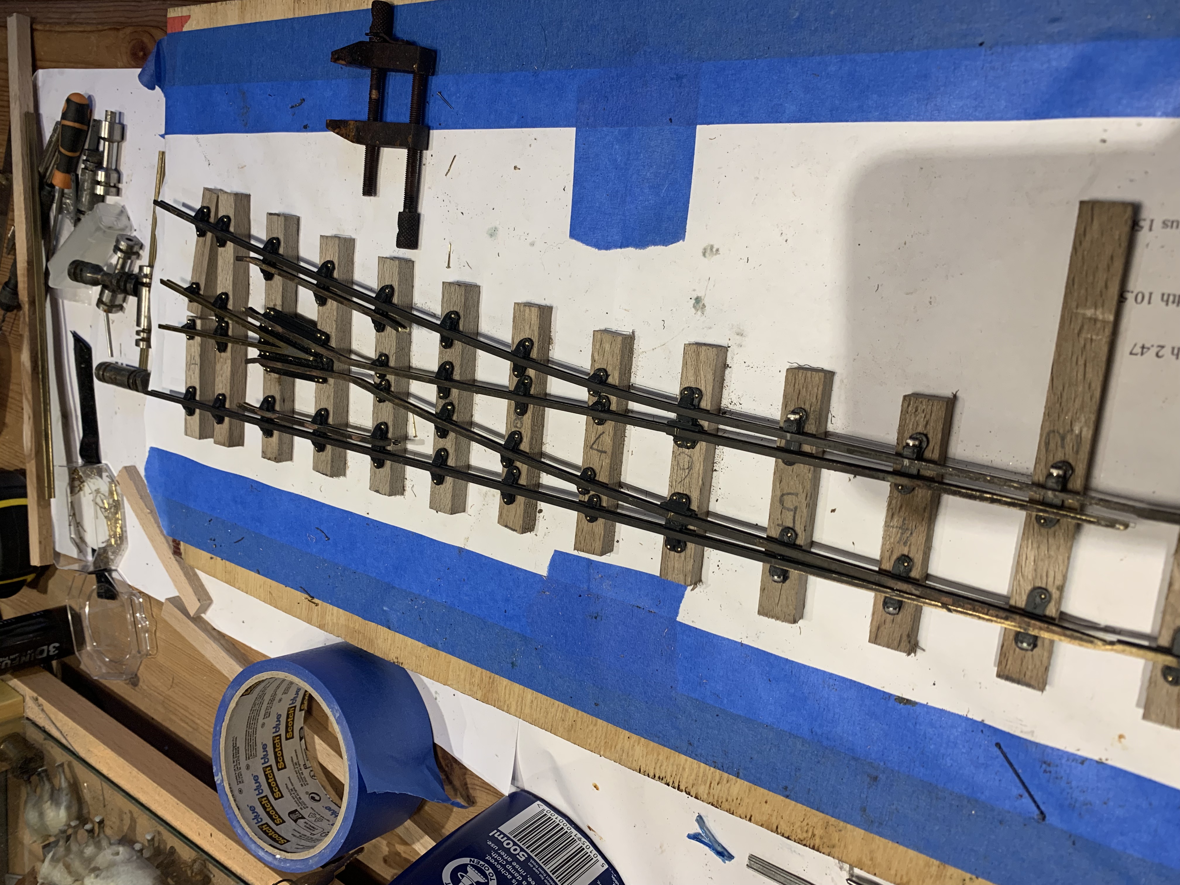

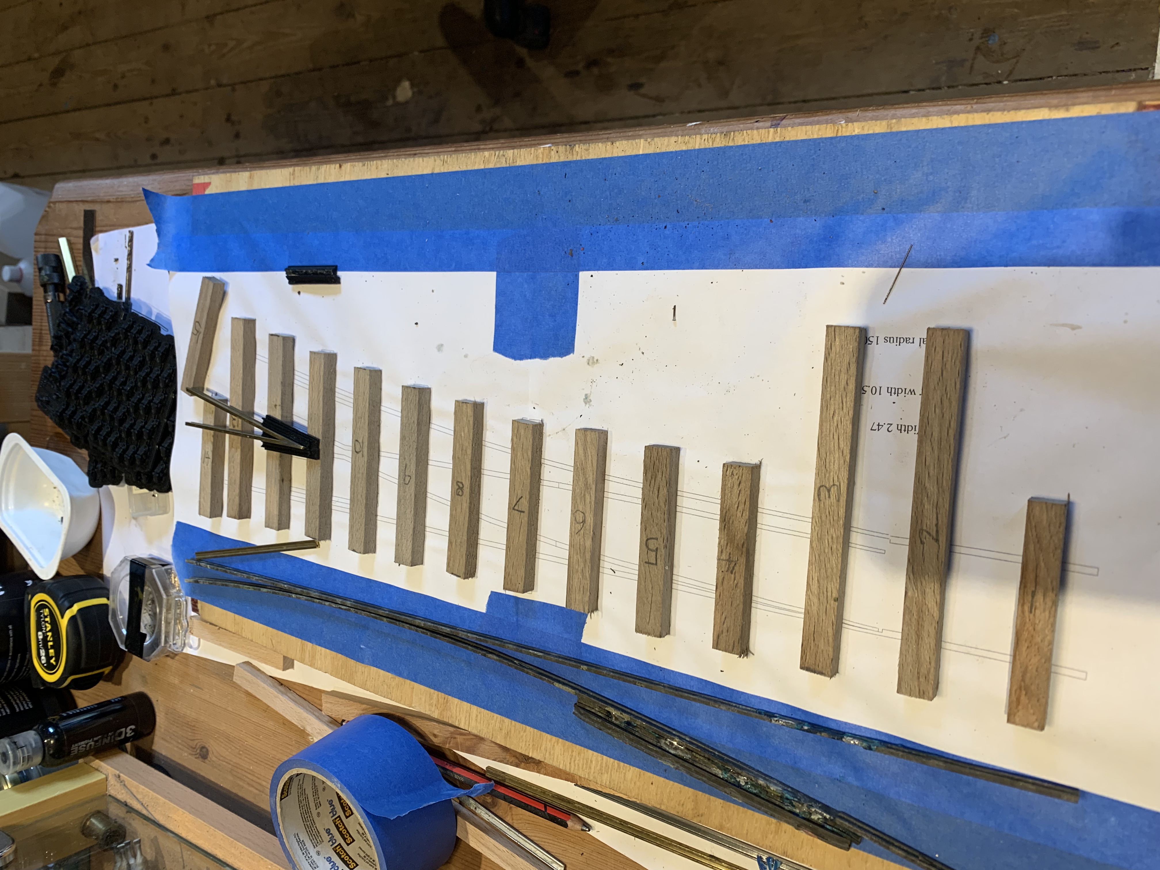

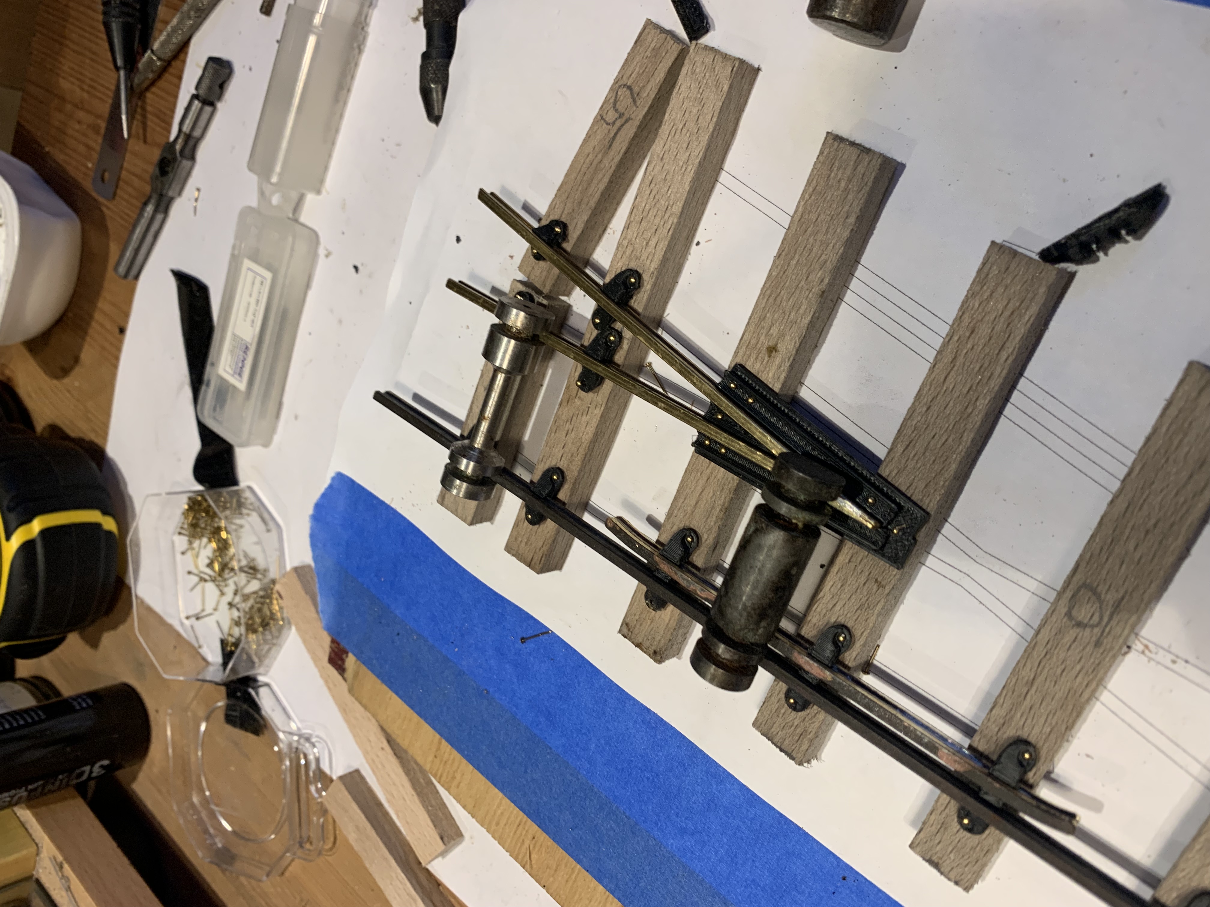

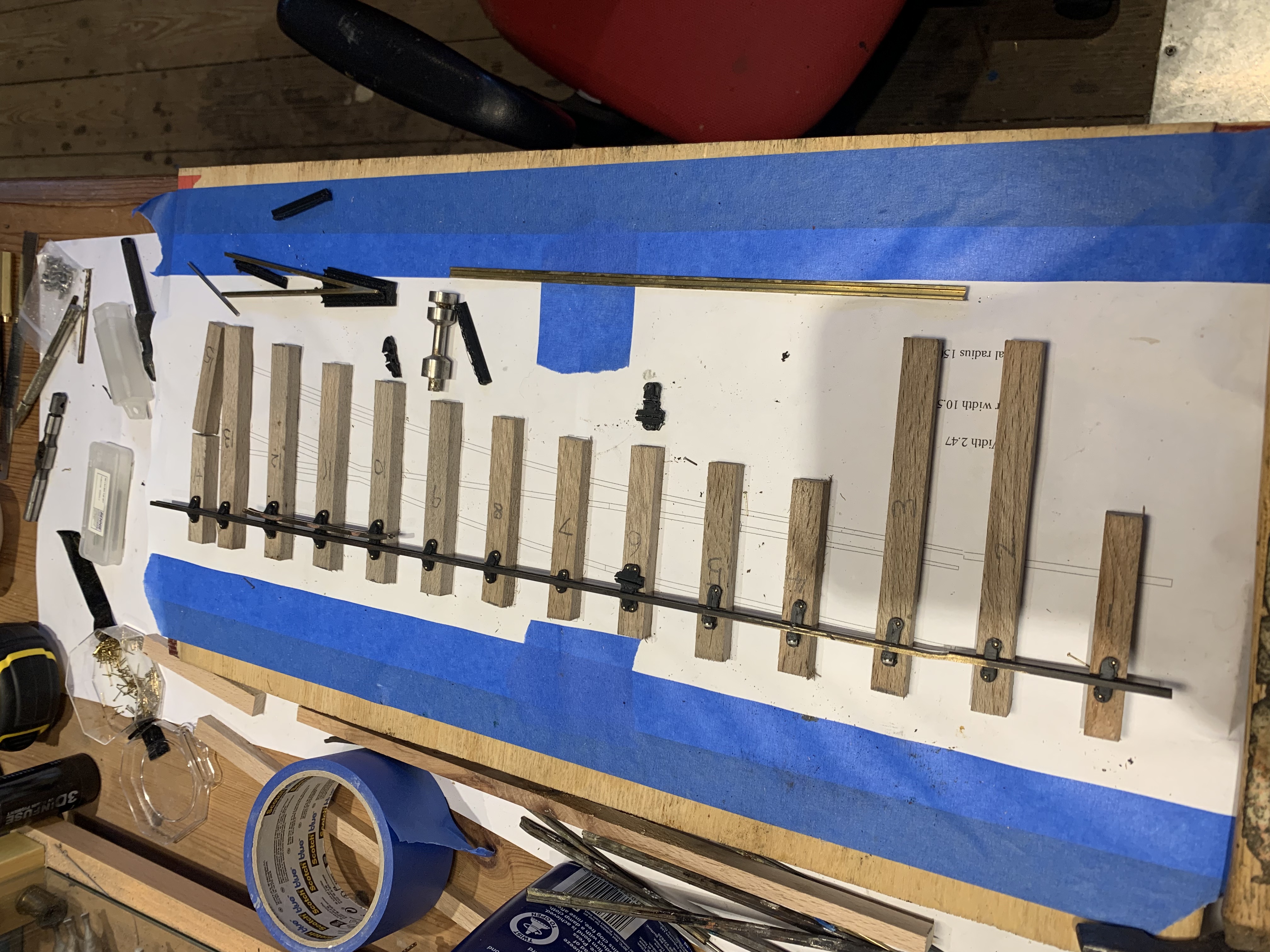

Building the points. I have downloaded templates from the 16mm Association website. I have used the template for the 4ft 6inch points in the past - in fact the other side of the building board has a jig set out to that template permanently set up. I now prefer the 1.5m template - partly because it has a more "narrow gauge" sleeper spacing, and also because it makes a slightly gentler curve, which will suite my articulated locos better. A copy of the template is taped onto the board, and a set of sleepers have been temporarily glued down. The sleepers were soaked overnight in preservative, and dried before use. The beech sleepers were kindly provided by Phil:
I have decided that silver soldering the frog and the brass plate is not a perfect solution. It has the advantage that the wing rails can be soft soldered to the frog unit afterwards, but the disadvantage is that having annealed the brass rails and plate by heating them up sufficiently to silver solder them, it has softened them all. So they bend all over the place - and it is still difficult to soft solder the second wing rail on without releasing the first wing rail.

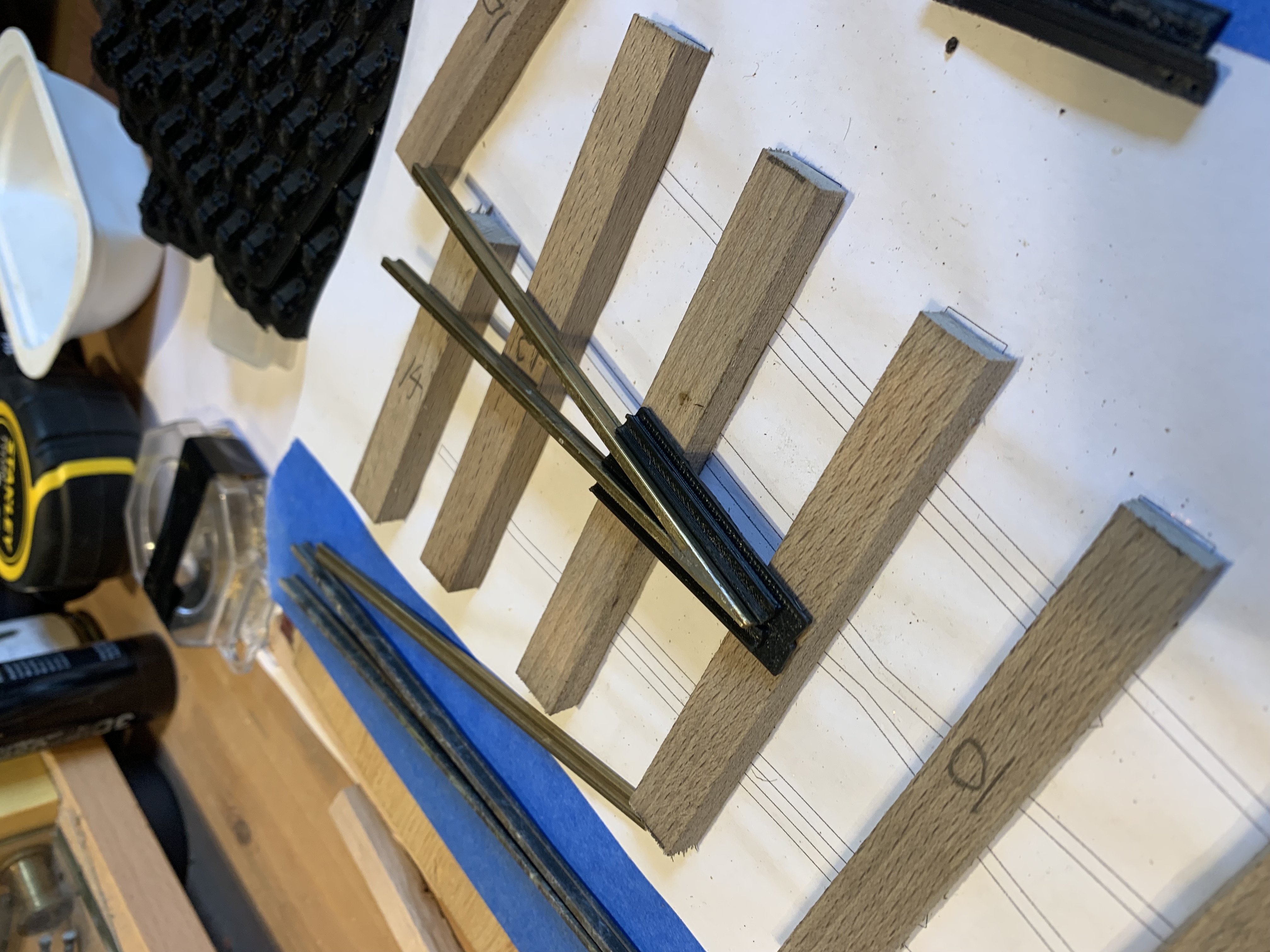

Hence I am going for a largely solder less solution. I have created a 3 D printed unit to support the rails which form the frog. I have recently learned how to accurately file these rails so that the meet correctly. I will come back to that. So this shows the two rails pushed into the unit which holds them in place at the correct angle: The wing rails fit up alongside the plastic spacers and are held against the frog rails at the correct spacing by separate printed pieces. That will become clearer as this progresses. It is an almost solder less solution - but you can see that I have soft soldered the two rails together. A small clamp held them tightly together while I quickly soldered it. It doesn't seem to have damaged the ABS plastic.

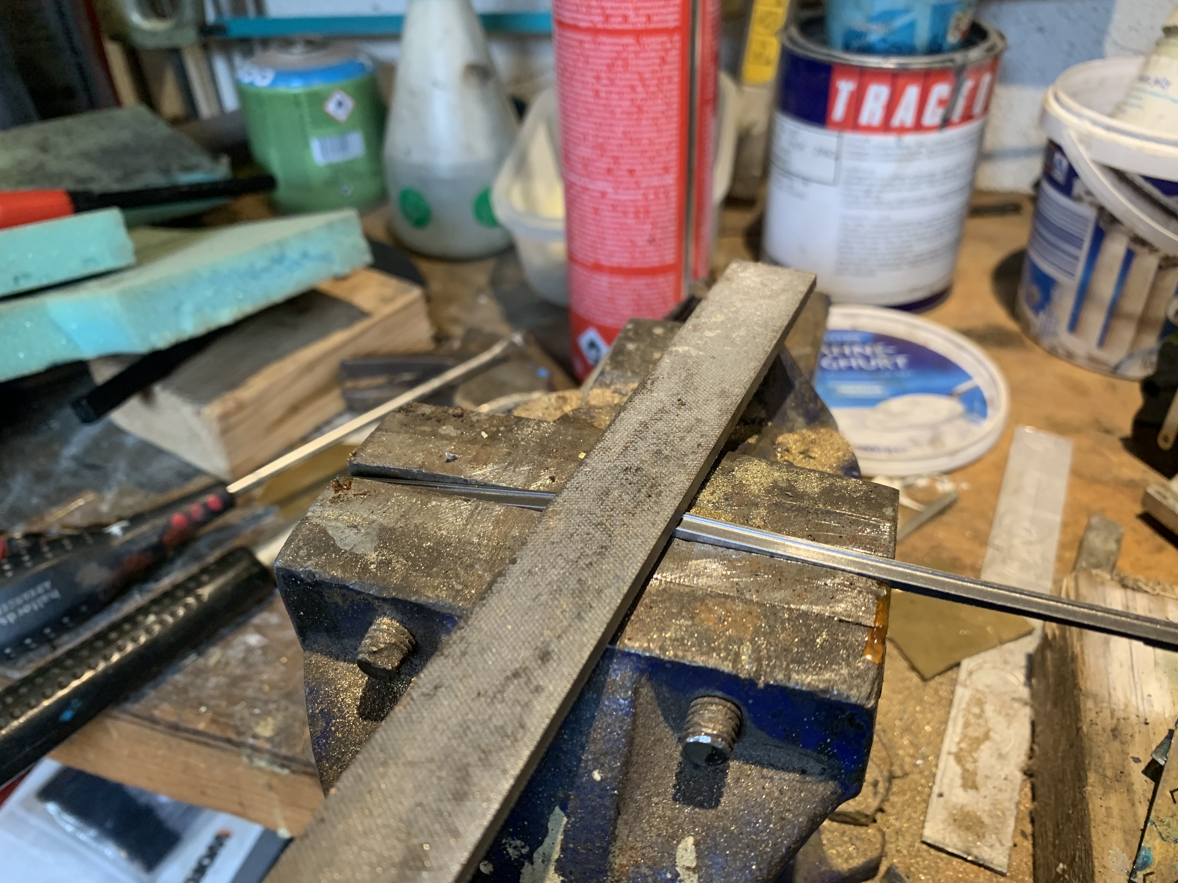

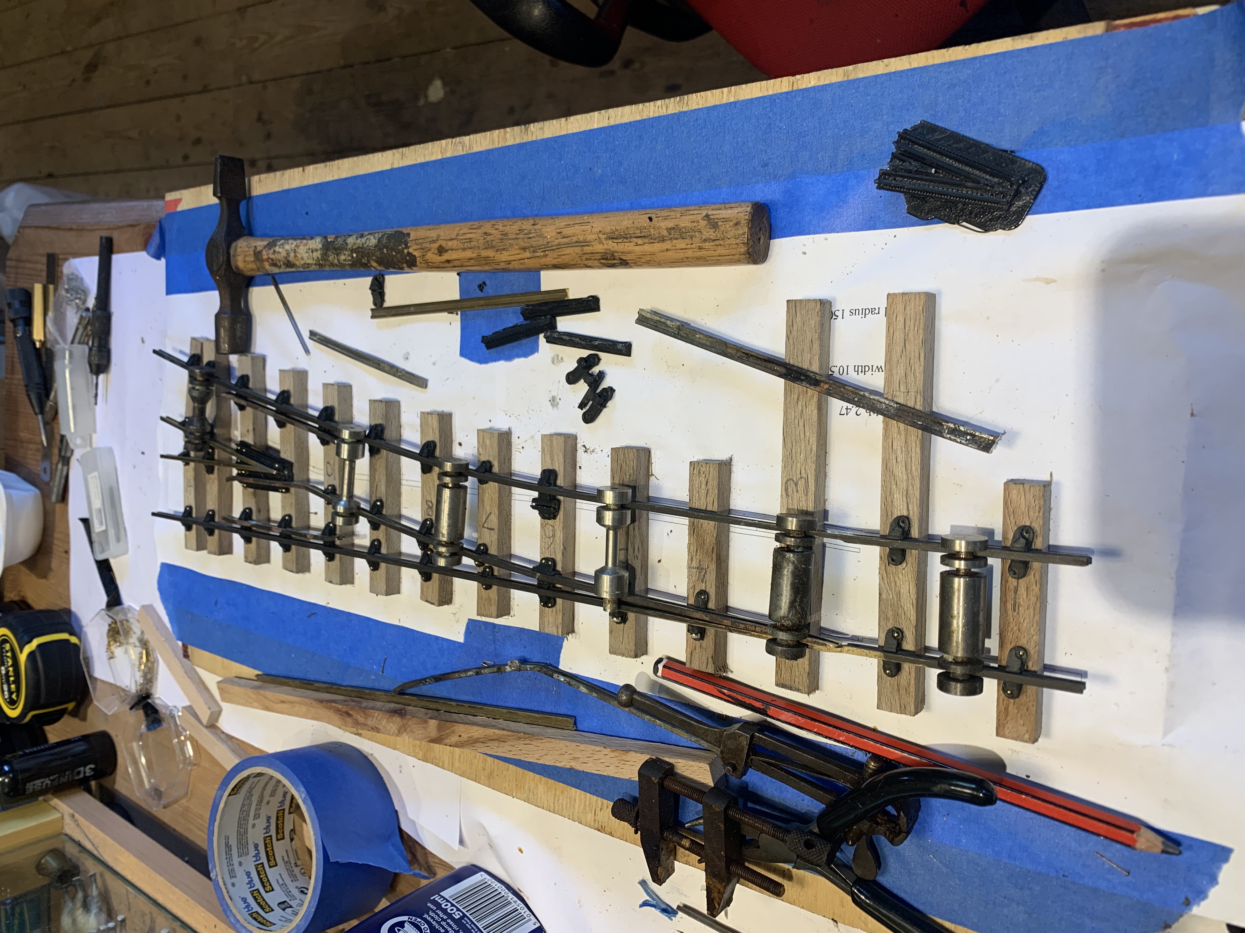

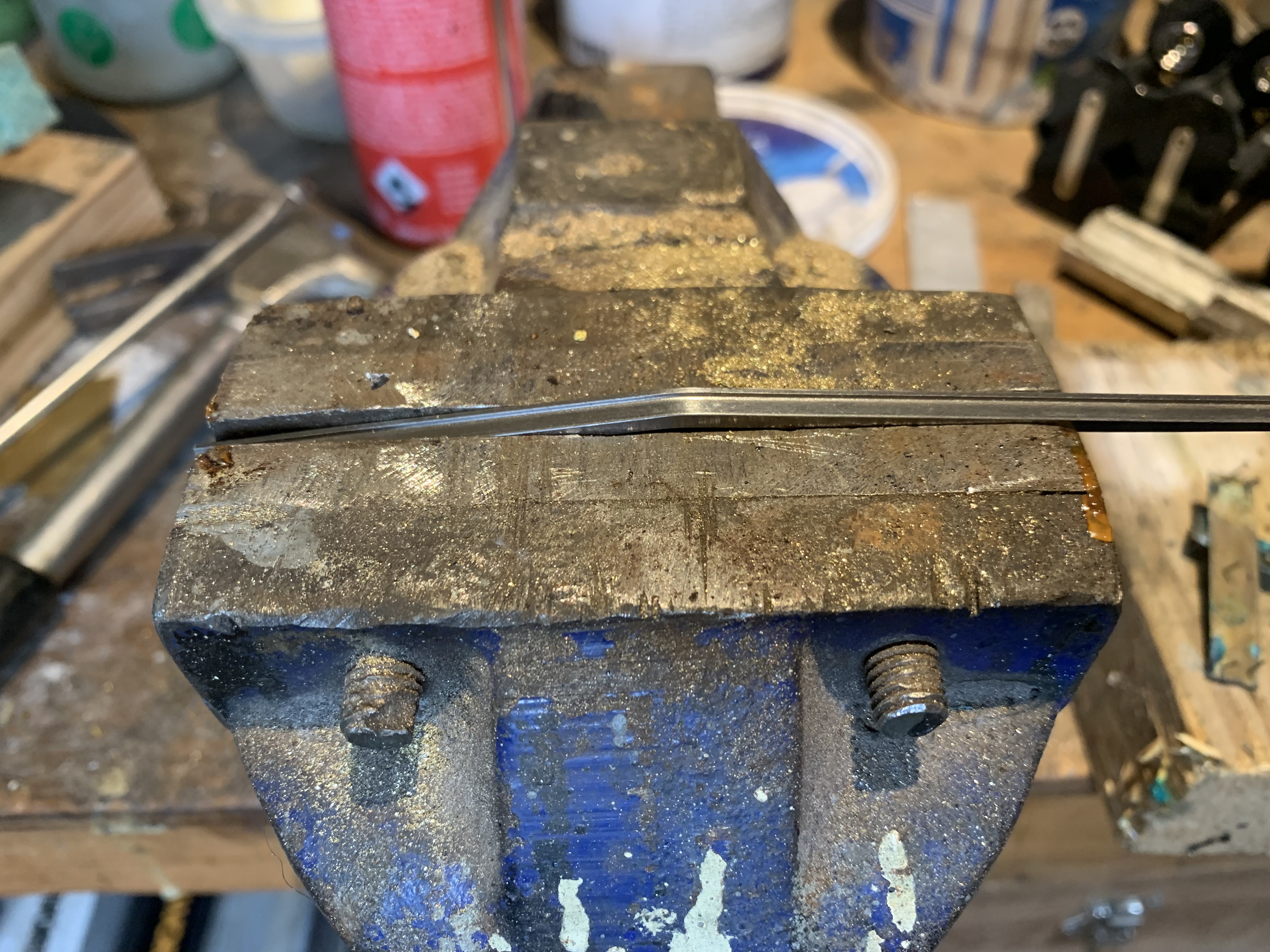

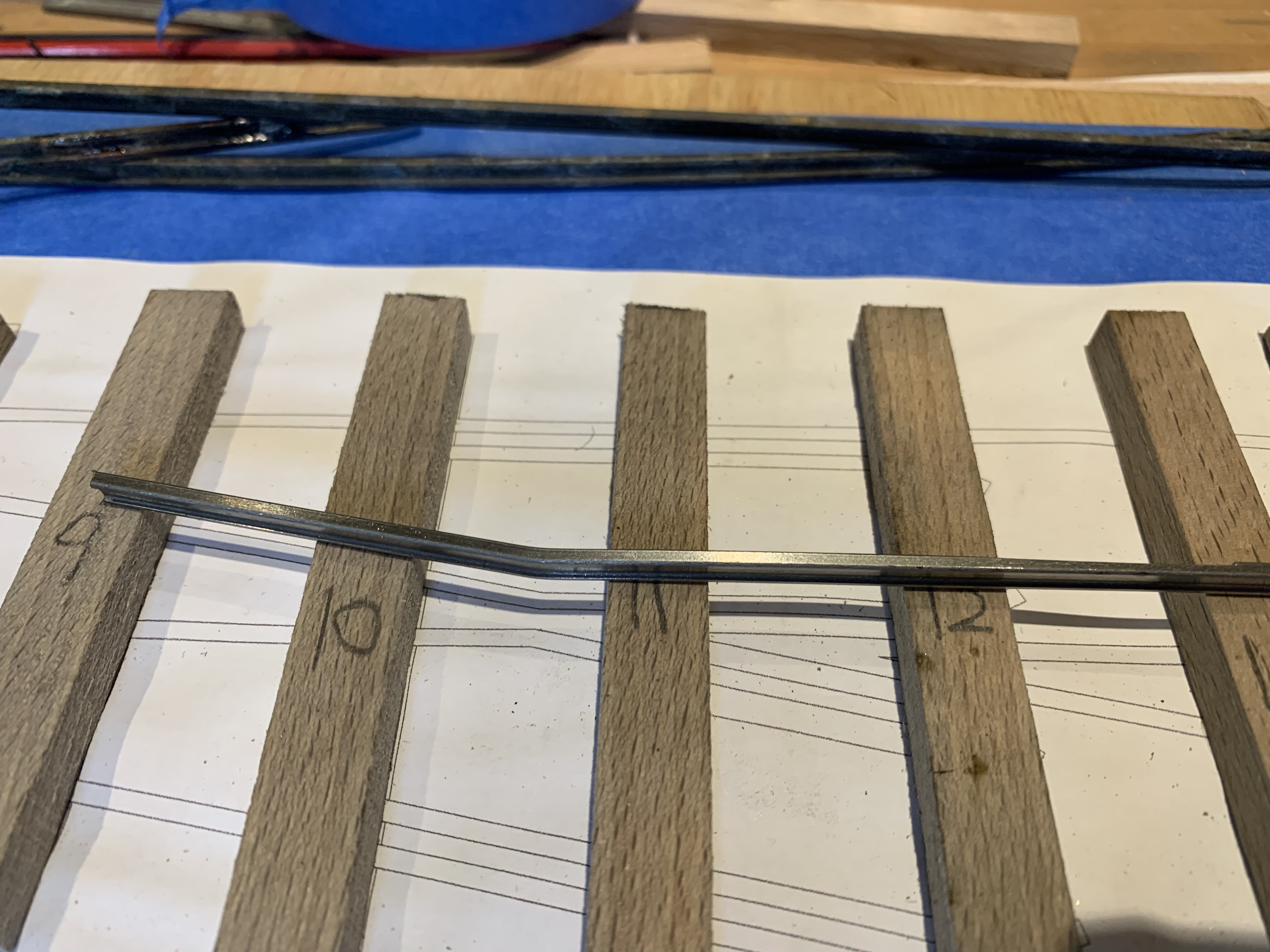

Filing the frog rails to the correct angle
Firstly bend the rail to the angle required for the wing rails, using the template as a guide: :
Then mount in a vice with the kink upermost: now file the kink out, trying to file evenly either side of the kink, until the file goes almost all the way through so that the two parts are just hanging together: The two parts can now either be separated, or bent right around so the two filed parts meet. I separated them so that I could push each part into my frog guide/support unit.

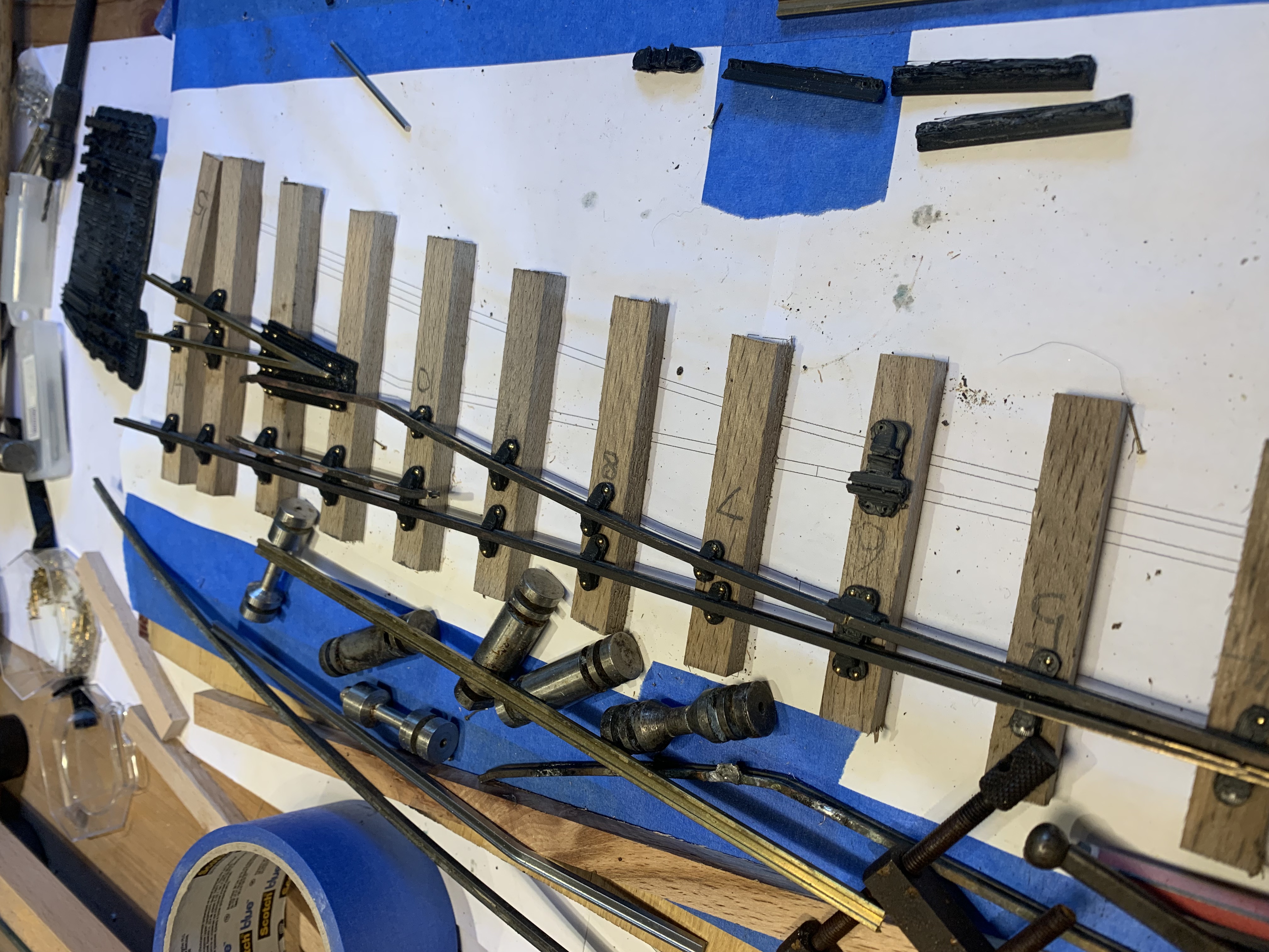

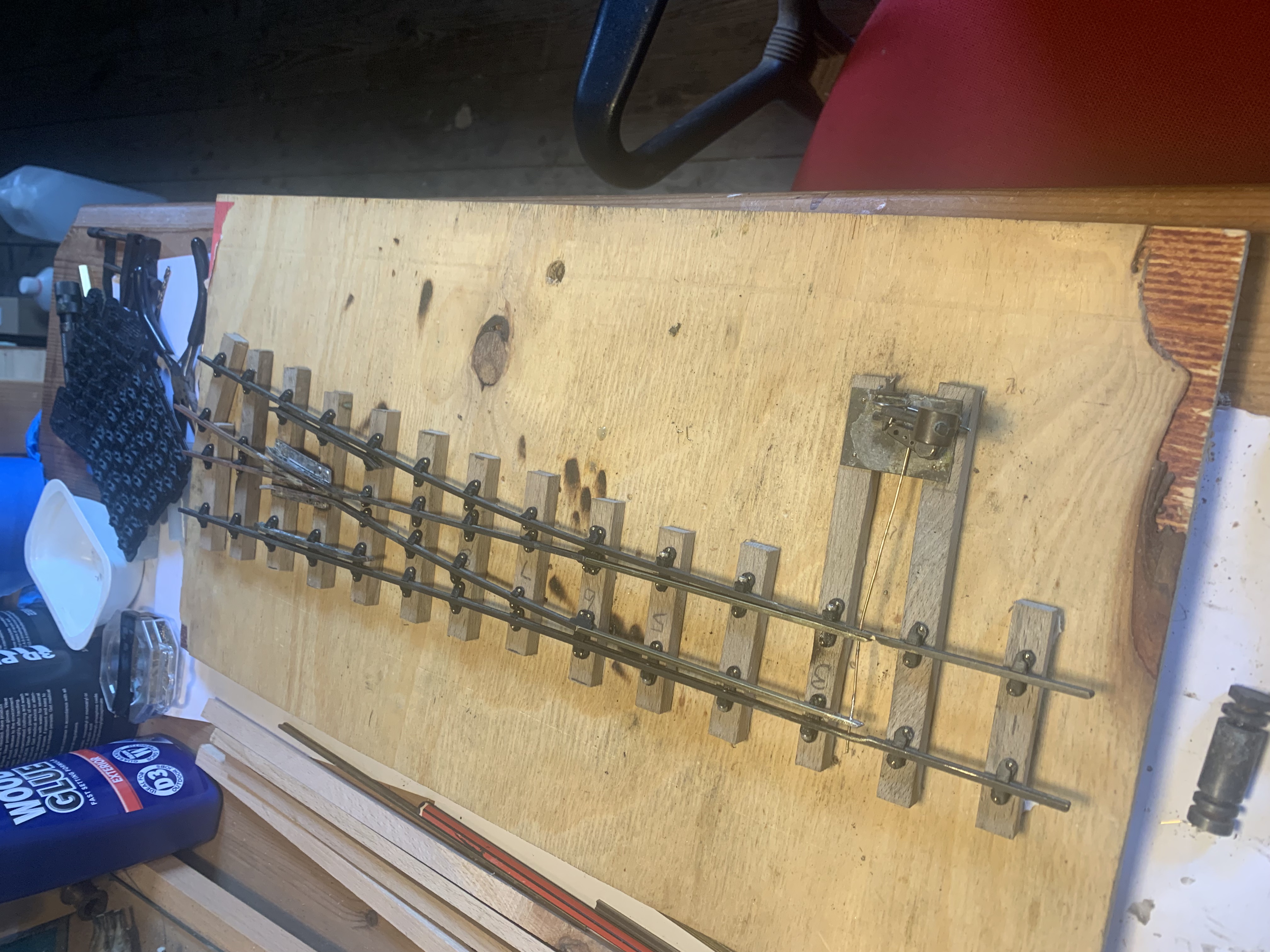

The first part of the point has been fixed down onto the sleepers:
Note the joggle in the rail where the blade will sit. That was created using an offcut of steel with a slit cut into it. With the offcuts fixed in the vice the joggle was formed with the rail inserted into the slit and bending the rail by hand. The check rail was cut to length and the bends in its ends bent before it was assembled. The check rail chairs were slotted onto the check rail first, and then the running rail was pushed through the chairs. All of the chairs were added to the running rail in the correct order before fitting to the sleepers. You can see that the sleepers are numbered, an aid to putting them in the right order after they went into the preservative. Sleepers 3, 4 and 5 have the blade chairs bolted to the rail, sleeper 6 has a special chair which supports the end of the blade and sleeper 7 has a short chair, because the wing rail passes very close to this rail.
The next stage was to add the "frog unit" which you have already seen: The roller gauges hold the rail at the correct spacing while the holes are drilled into the sleepers and the chairs pinned into place.

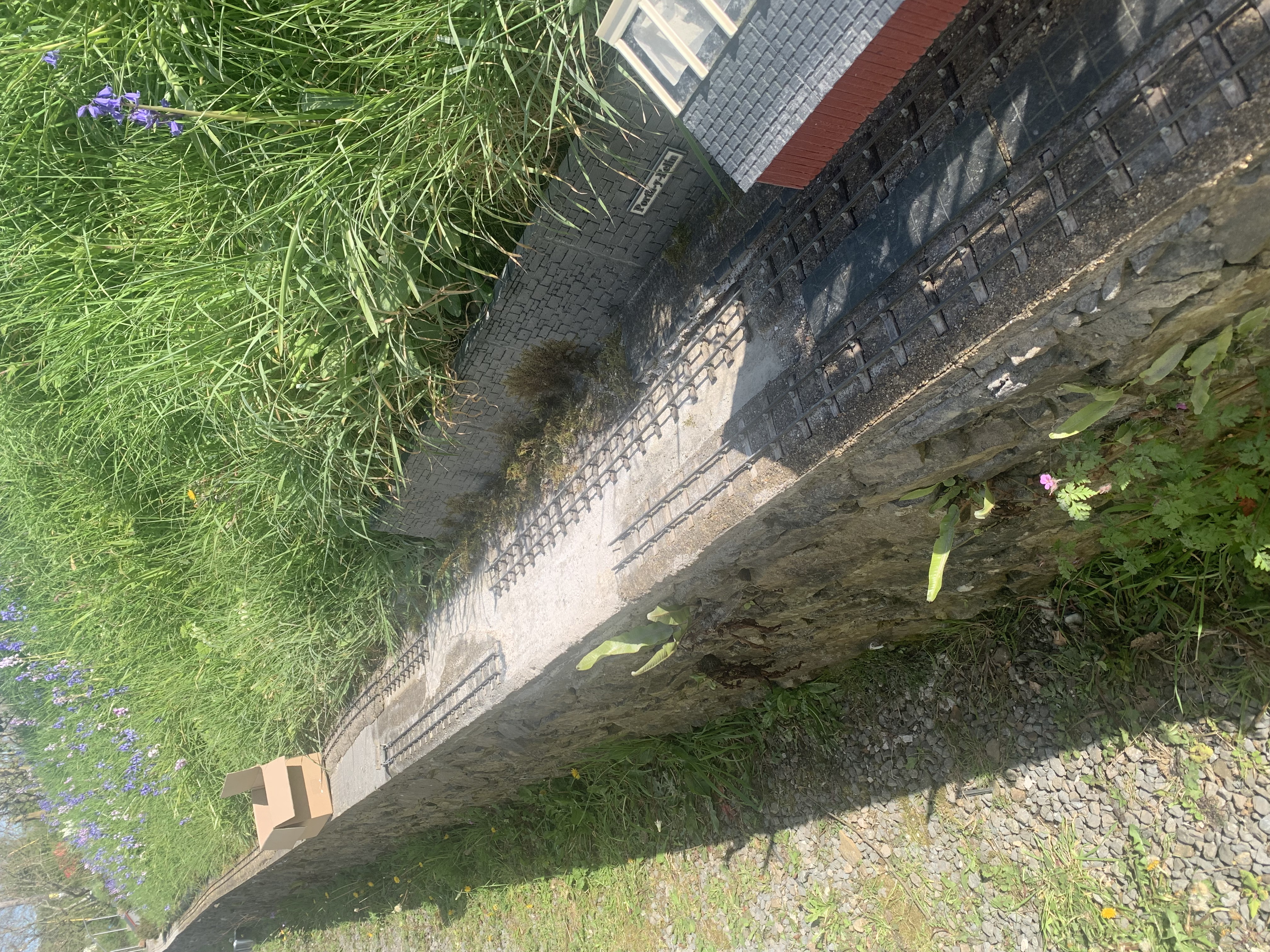

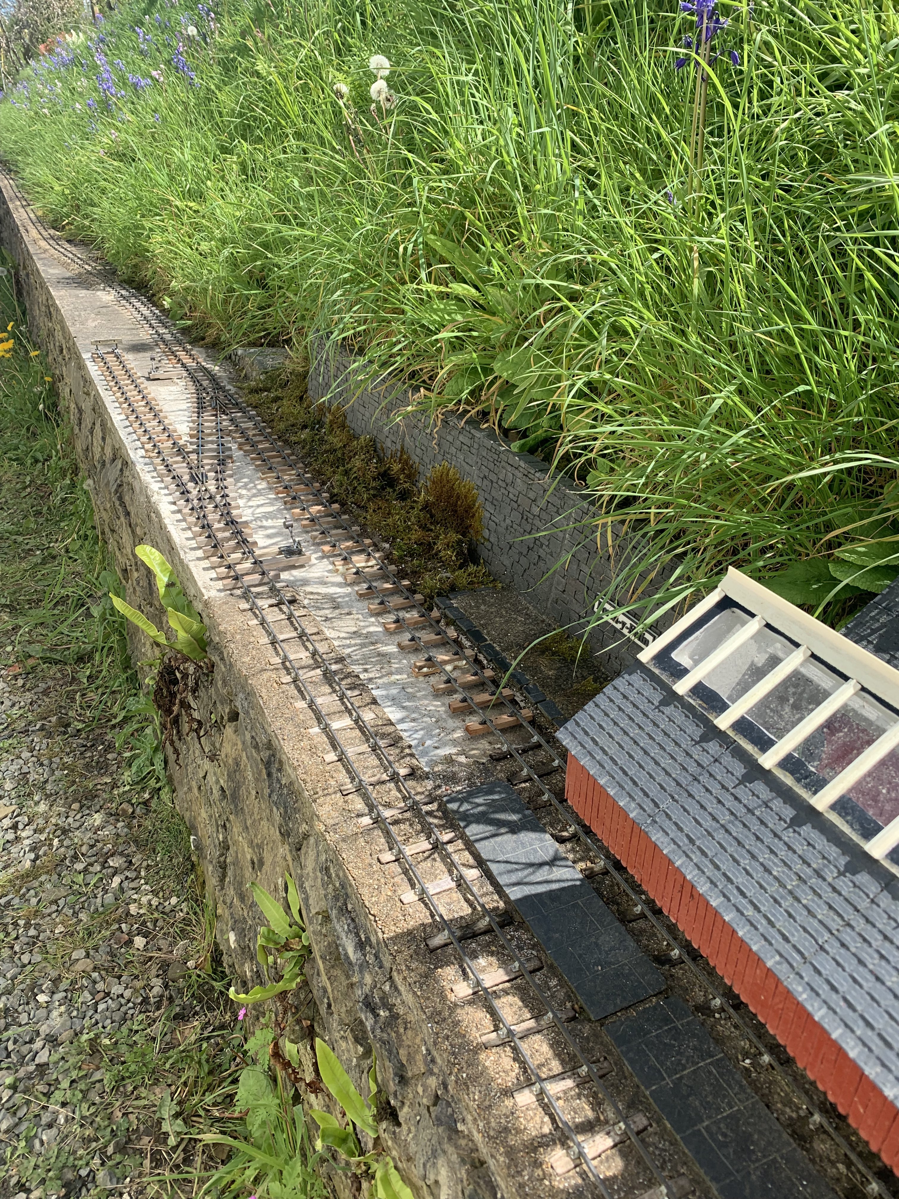

The refurbished points and their track have now been relaid:
Because of the way I had laid the track in the first place I had to put spacers under the trackwork I was relaying to bring it up to the same height as that which was already there. Luckily sleepers were the correct thickness to act as spacers. That just means the ballast will have to be thicker than I am using elsewhere on the railway - but that does enable me to put off re-sleepering the rest of the track in the station until later.
Changing the radius of the points also meant that a short section of new track had to be fitted to join the two points.
So back to wall building!

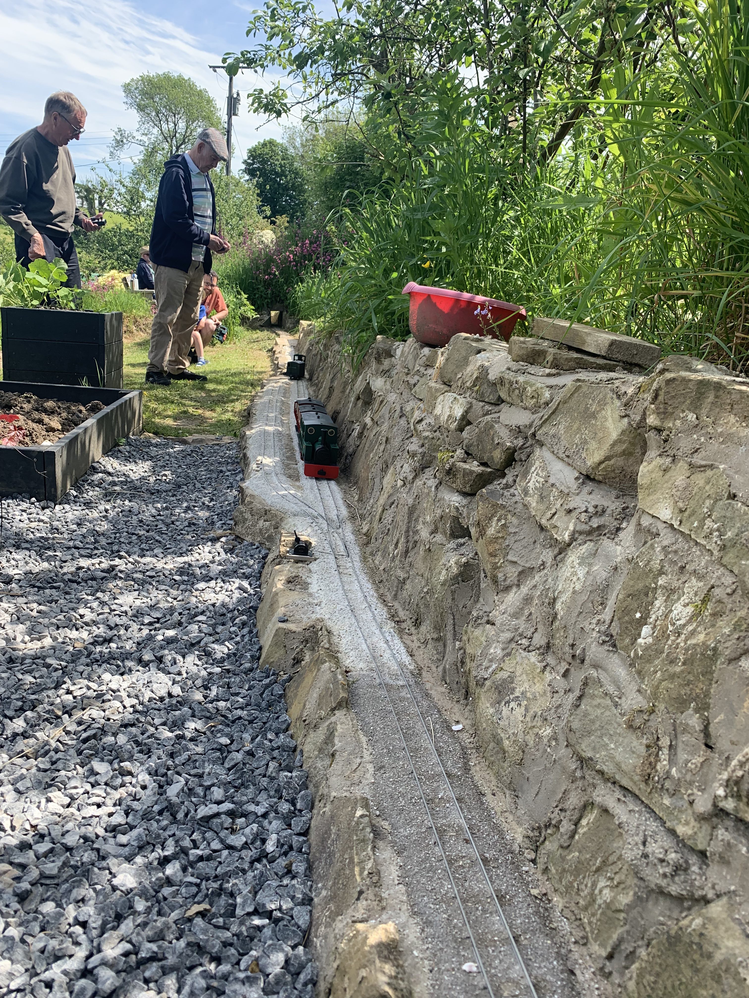

The South West Wales group of the Association of 16mm Narrow Gauge Modellers visited to run trains yesterday. So a pause in extending the line to clear up after a long wet winter, and we were running trains in the sun!
Peter's Double Fairlie crossing the bridge:
and the latest extension, laid, ballasted and running:

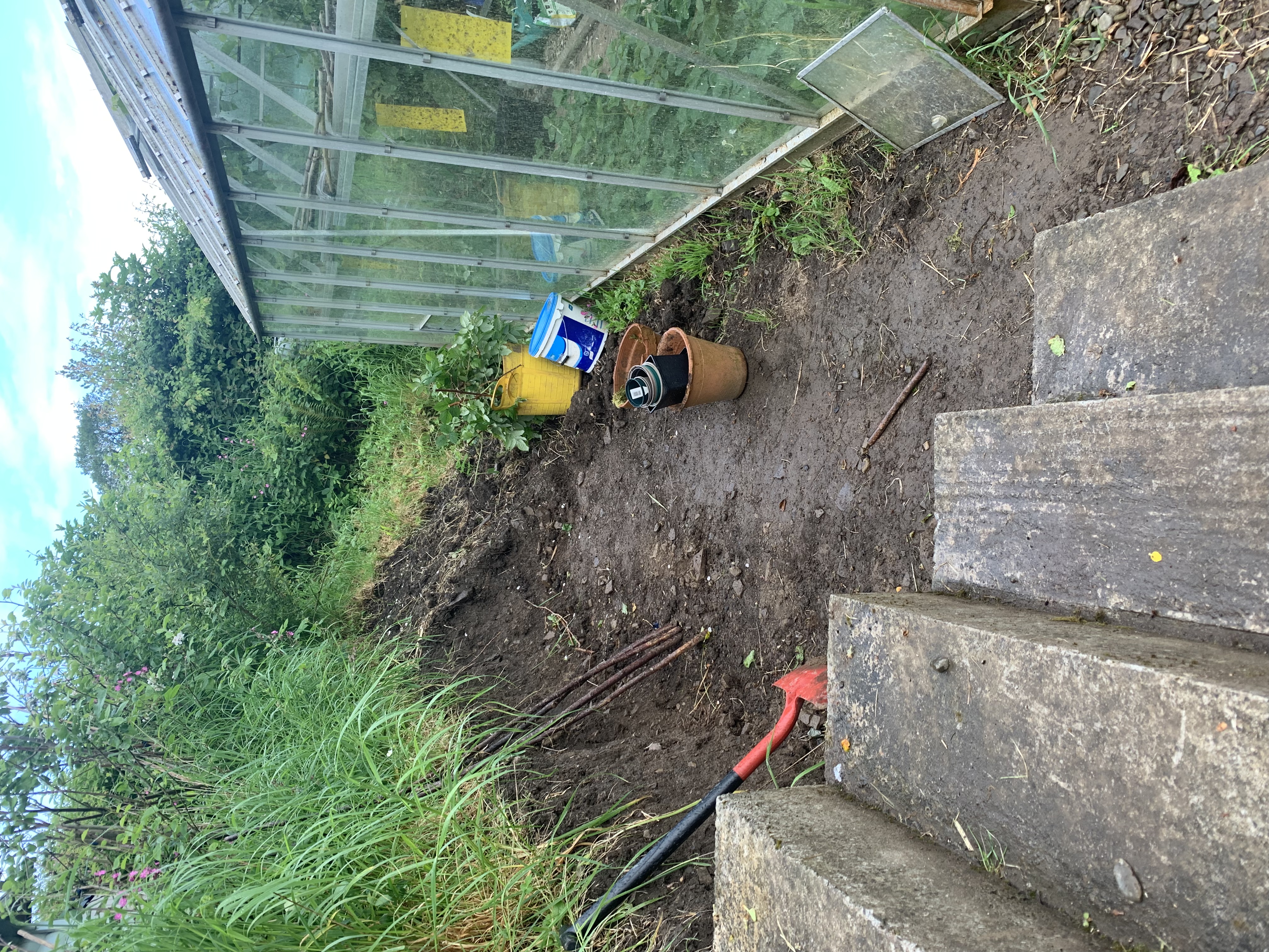

The next step is to make a tunnel under this set of steps:
I am going to try to dig it out without disturbing the steps first. If that doesn't work then I will have to dismantle the steps to dig it out before remaking steps.

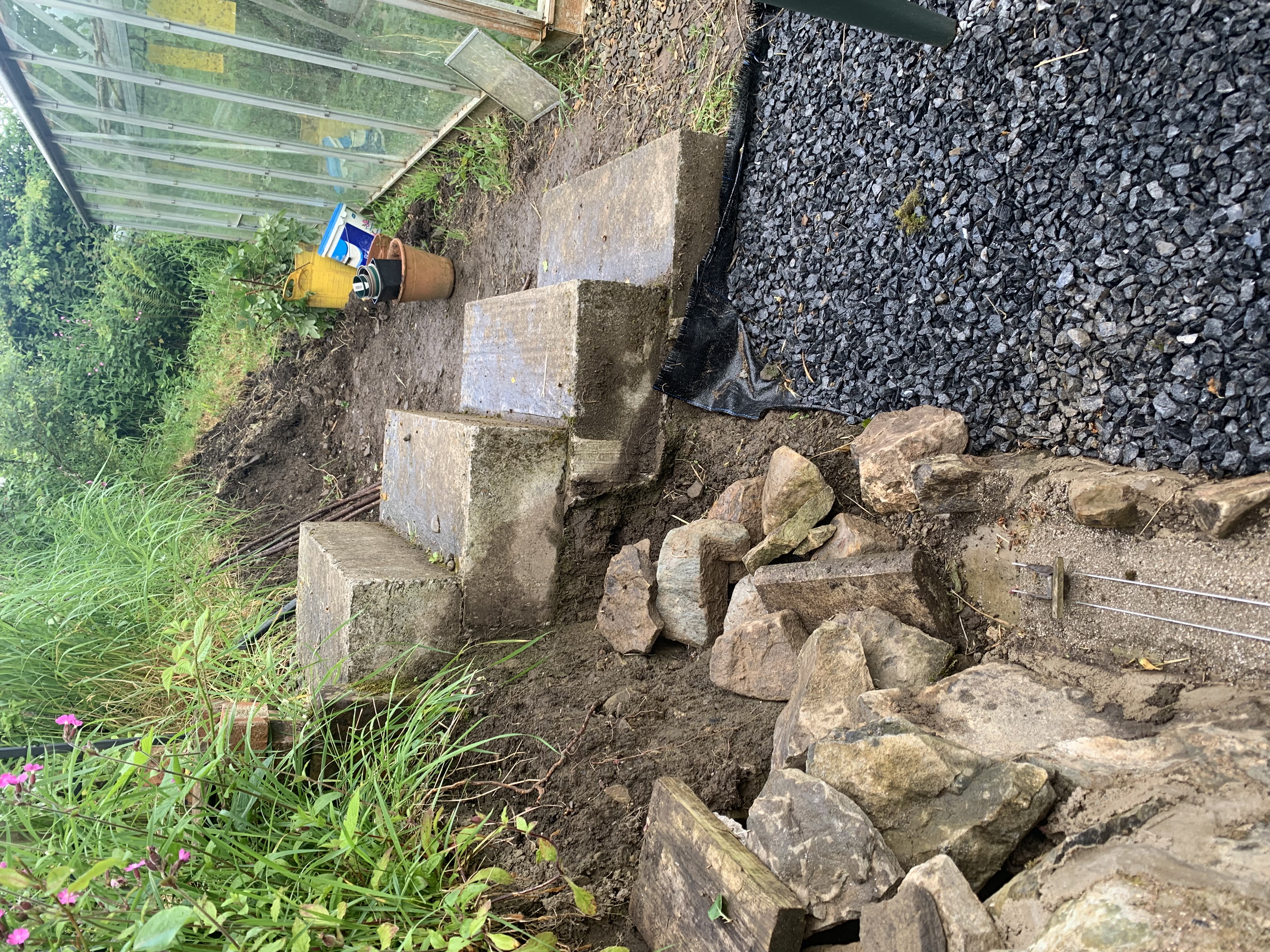

The area where the terminus is going is here behind the greenhouse, and two thirds of it has been drug out:
I would like to create something with the "flavour" of Duffws, the original terminus of the Festiniog railway. That would involve a model of the station building, the goodshed with its double track, a run round loop, two sidings and a shed for the quarry workers train. When I started to try to draw this out, reality soon set in - there just isn't enough space.
Reality might allow the run round loop and 2 sidings - hopefully with a backdrop of a row of terraced houses, and a low relief model of the station building. I am contemplating a traverser to enable locomotives to run round trains standing in three of the the four roads. Totally un-prototypical but practical for a day like yesterday when there were 23 people here.
