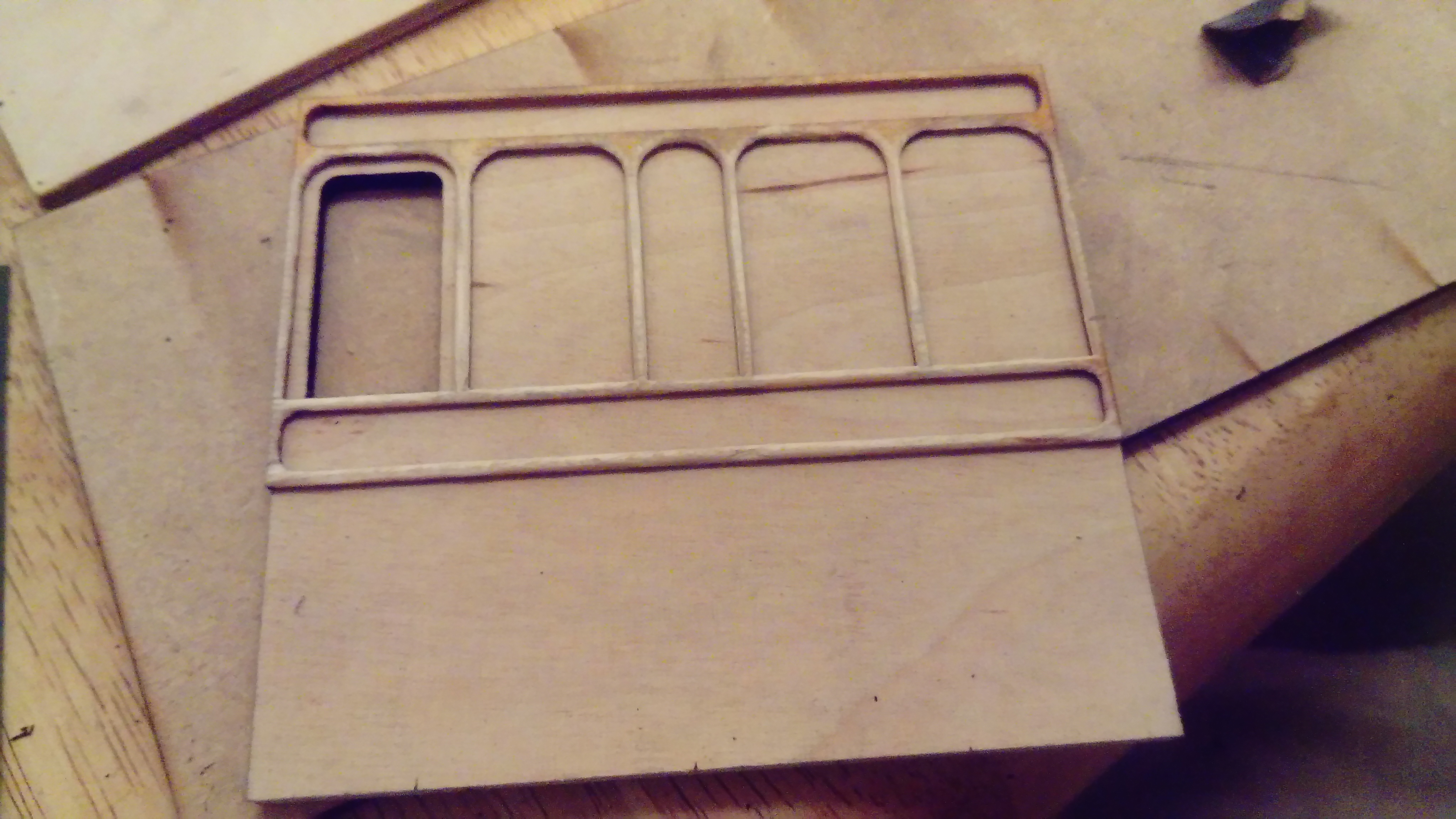

Greatings all,
Term is over and I have a few days off before the students return. I've got an old brandbright carriage kit which came with cardboard panelling.
Becuase I don't ever want to actually finish anything I decided to make my own paneling from LASERply. I re-designed the carriage to stratfordise it,then I decided to make the panelling half round in profile, and add the interior detailing... and opening doors. *WHY DO I DO THIS TO MYSELF*.
Now that everything on this is wood, a varnished, teak, finish, rather than painted, will be possible. However, whenever I have tried this in the past, the squeeze out from the glue used to adhere the panelling to the body shell resists the varnish and ruins the finish, seemingly no matter how well I try to clean up the squeeze out.
Does anyone have any tips for adhereing paneling so that a varnished finish works?
Many thanks in advance!

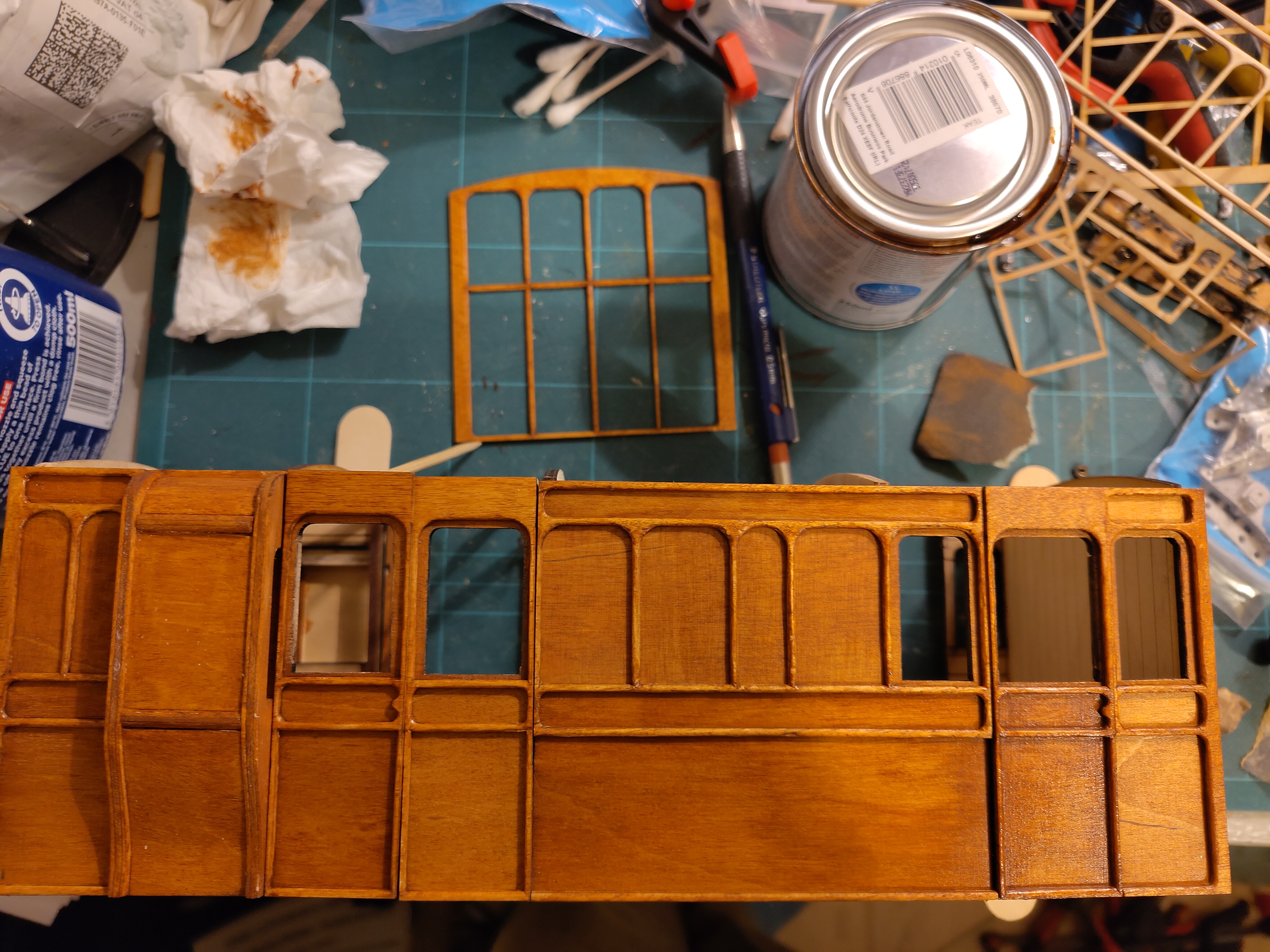

That's an interesting idea Keith. I've already progressed using Peter's suggestion but I might try the varnish as adhesive on a test piece. Thanks Peter, I've pressed on and have ordered some canopy glue. Here's where we are up to so far with the panelling just laid on for now. I've tried to get some grain lines going in the correct directions using 120 grit sand paper and am trying to get a little variation in colour between panels. I've swapped the doors around to break up the grain in the plywood to make it look less like it's made of a single piece. The stain is ronseal exterior teak applied thinly, flatted back and applied thinly again. I'll go over the top with a pale gloss varnish. I'm very pleased with how it is turning out.

Looks good to me, Zach. You can't beat varnished teak (or its equivalent) .....

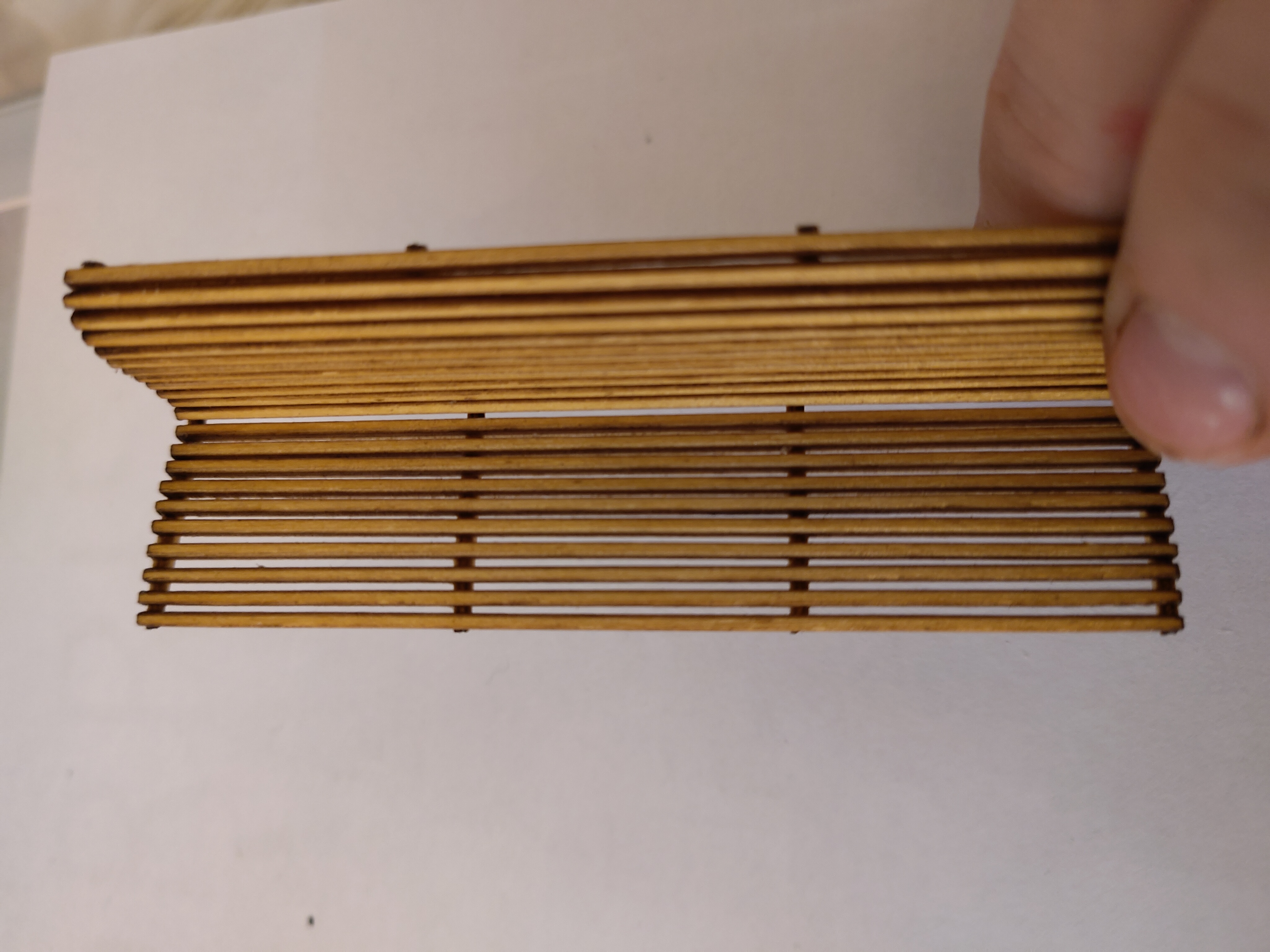

I'm continuing on with the carriage, working in a similar way to how I used to when I was at my most productive in 16mm, at secondary school. Designing a bit in CAD, cutting it out with the LASER cutter and assembling, then evaluating the design and designing the next bit stepwise. A process which I am remembering how much I enjoy.
Here's the seats for the passenger compartment. 1.5 mm slats glued onto the formers individually using a piece of thin card to get the spacing right. I need to find some of those posh cocktail sticks with the turned heads for the legs of the seats.

The seat is very nicely done and will look perfect inside the carriage. With such fine detail it is important to make every one match.
- Posts: 8007
Re: Varnished finish
Clever idea to use the posh cocktail sticks as legs. I've been wondering if there is a use for them after recently buying a pack

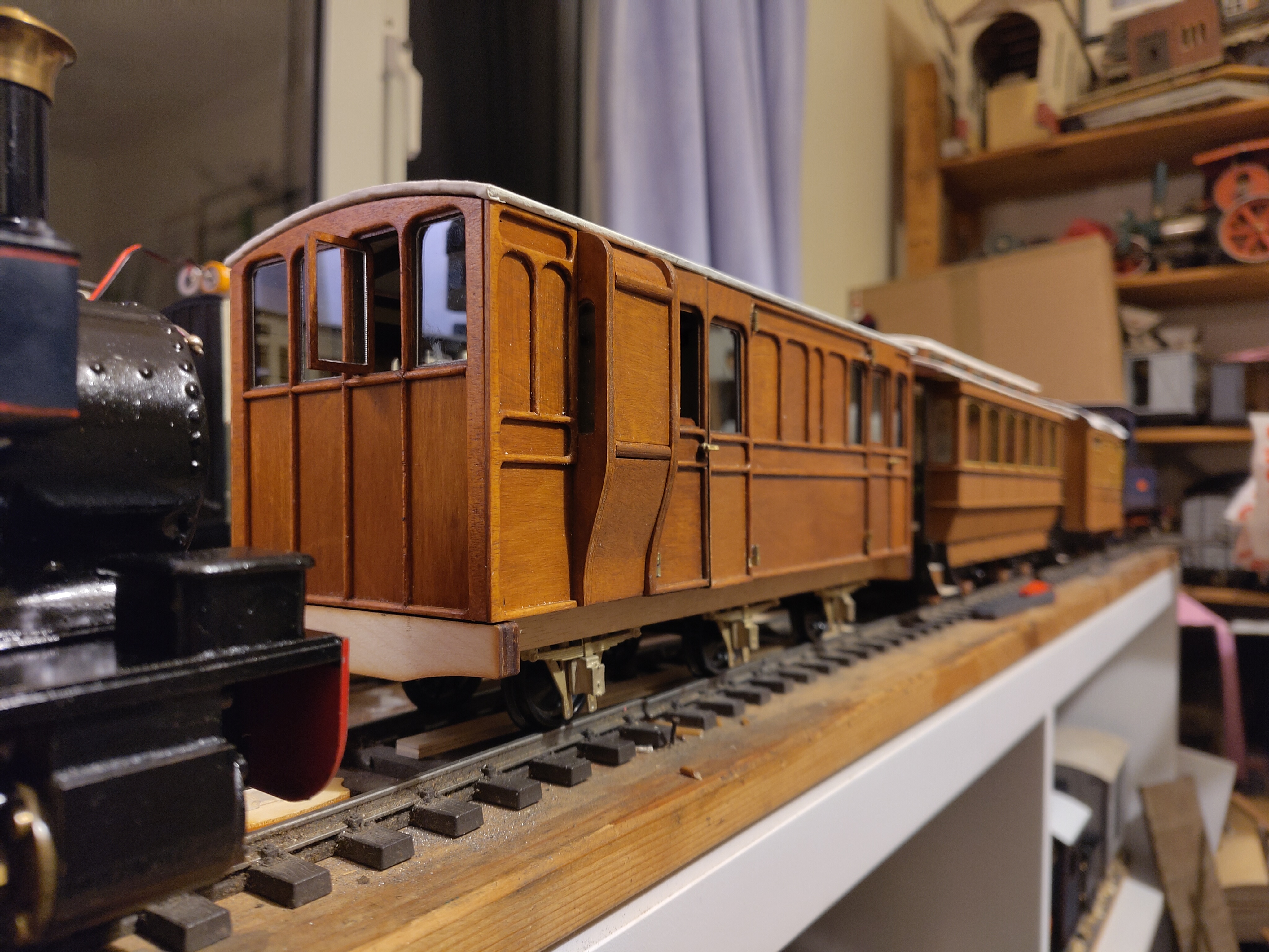

Things are slowly progressing. The carriage is now assembled and glazed. The windows are individually LASER cut from thin acrylic. Each is a tight fit but secured with canopy glue. I'm thinking about underframes and quite like the idea of seeing how it looks mocked up on three axles.

Very nicely done; the woodgrain effect works well and the colour is very good.

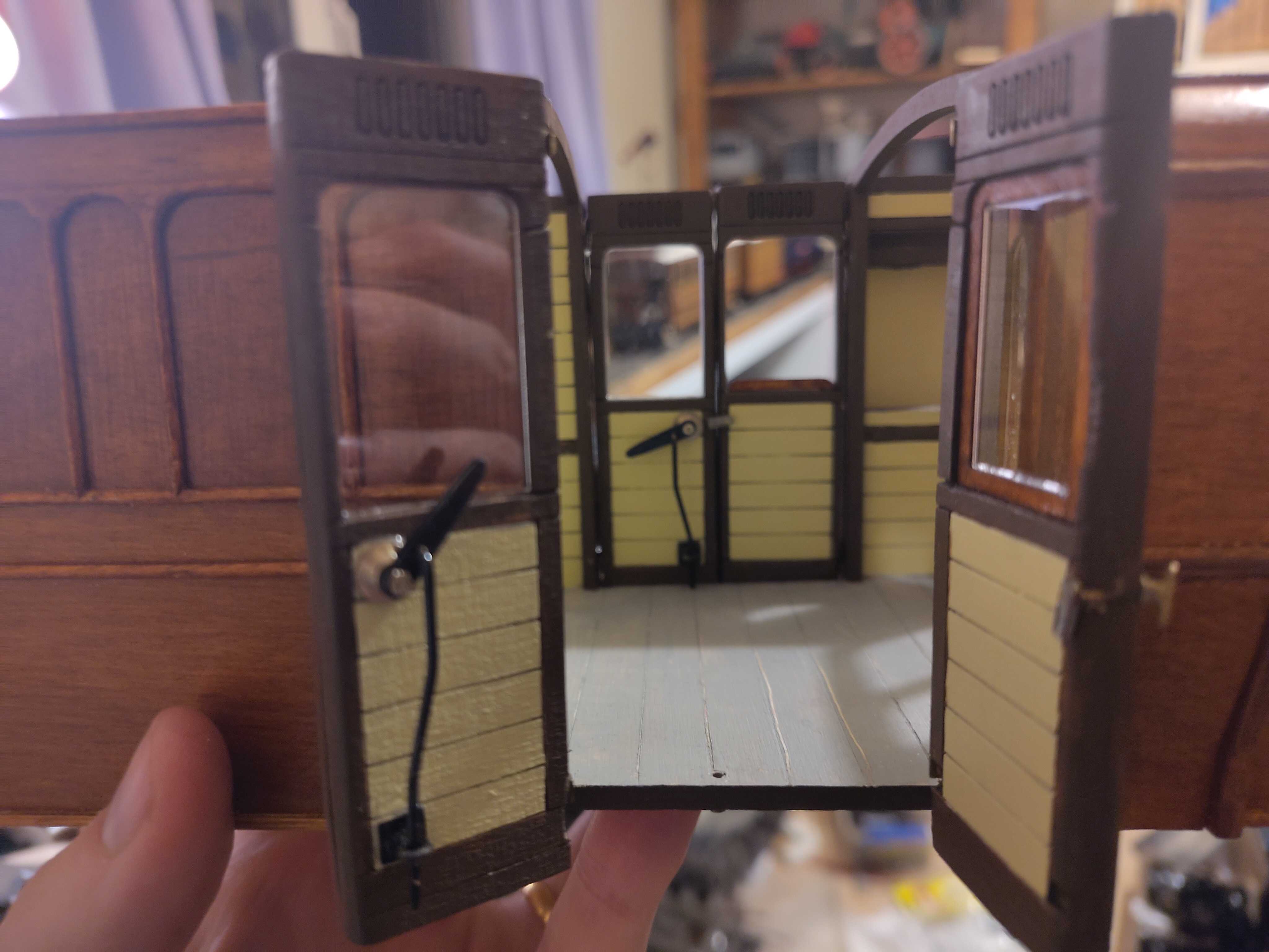

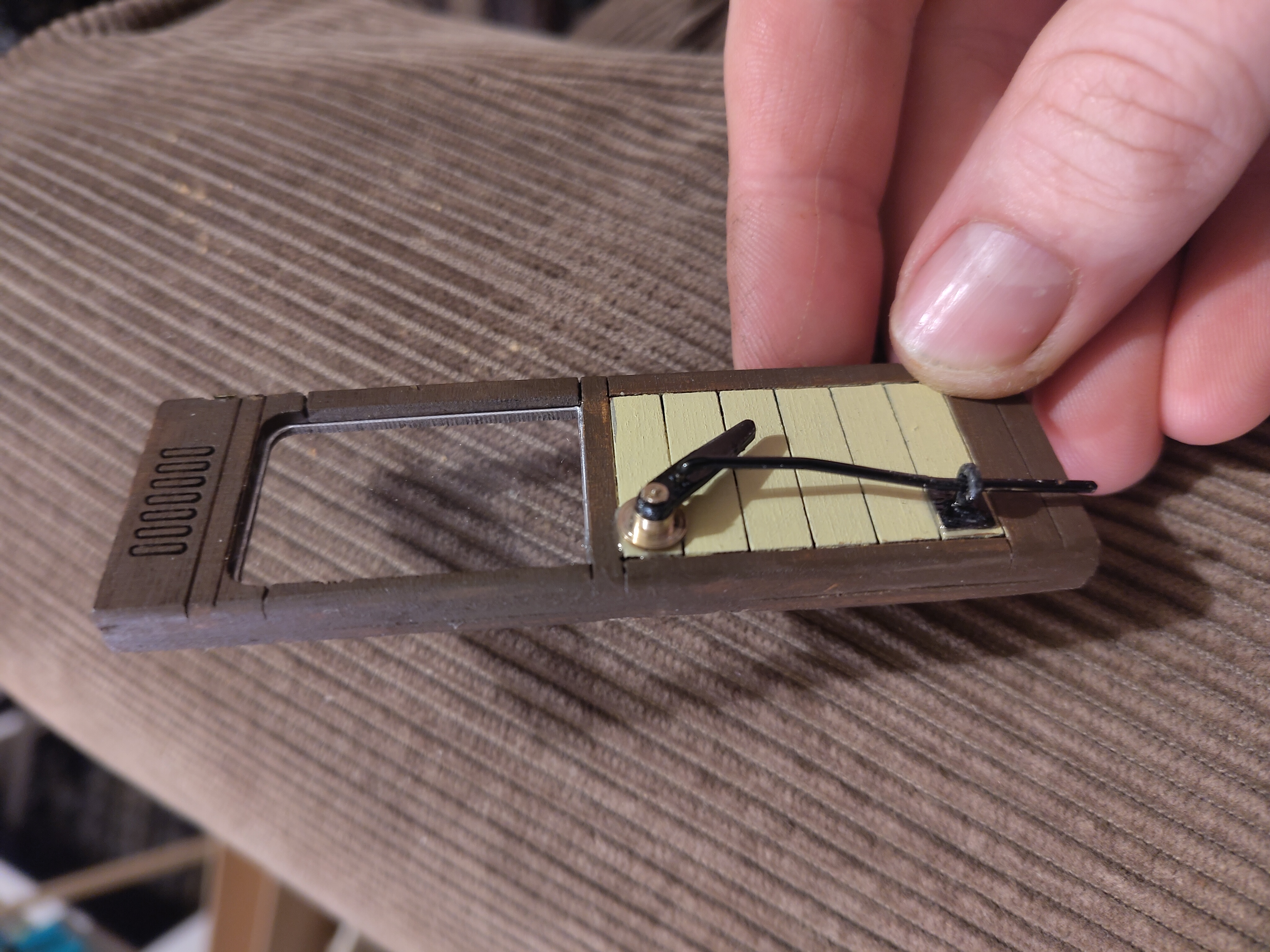

An update about the opening doors too. I spent the weekend making the components for the bolting mechanism for the guards double door sets. They are completely functional which is very satisfying. Just the sort of working details that I find immeasurably satisfying to work out how to make.

Couldn't agree more, and those door locks are exceptional. Many is the time I have found it easier to model the way the real thing works, thanDr. Bond of the DVLR wrote: Tue Nov 25, 2025 6:39 pm Just the sort of working details that I find immeasurably satisfying to work out how to make.
replicate something that just looks like it. I am jealous of your paneled coach too. Is it to get full length steps?

That is an absolute work of art.
How did you make the hinges?
